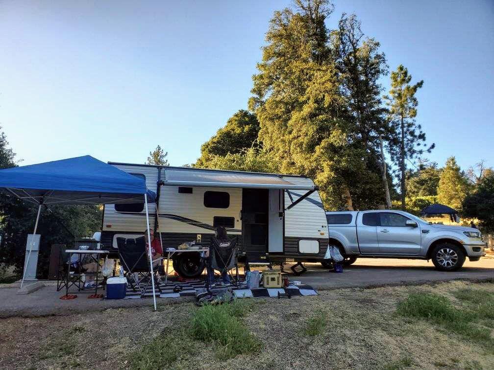

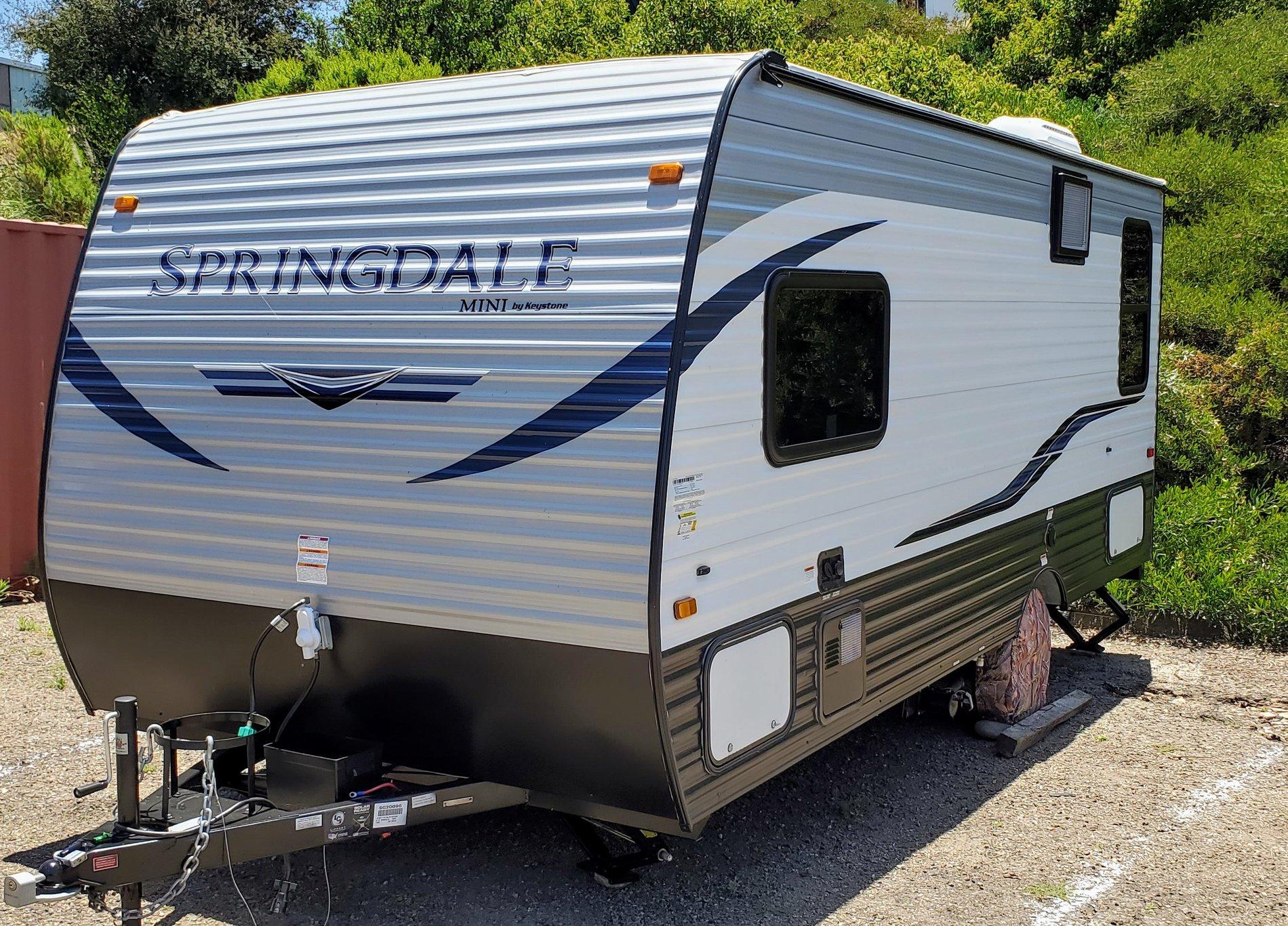

We had looked at larger heavier trailers before settling on our 21ft single axle. 3400 dry, 4000 a bit over 50% towing capacity loaded.
Our Ranger yanks it around no problem, accelerating uphill on steep grades like a bat out of hell getting 13.7 avg towing so far.
Hitting the mountains next Monday for a week and will see how the mileage does with no real highway driving.
Well we hit the local mountains about 50 miles east of San Diego going from 220ft ASL to 5000ft and the Ranger didn't miss a beat ?upgrade we were able to keep at 55mph (speed limit there) all of the time and didn't need to use the turn outs. Used the tow/haul when in the mountains and its exceptional on steep downhill grades.
Over the 140 mile round trip we averaged 16.8 mpg! Our Ranger and trailer rock ? ? ?

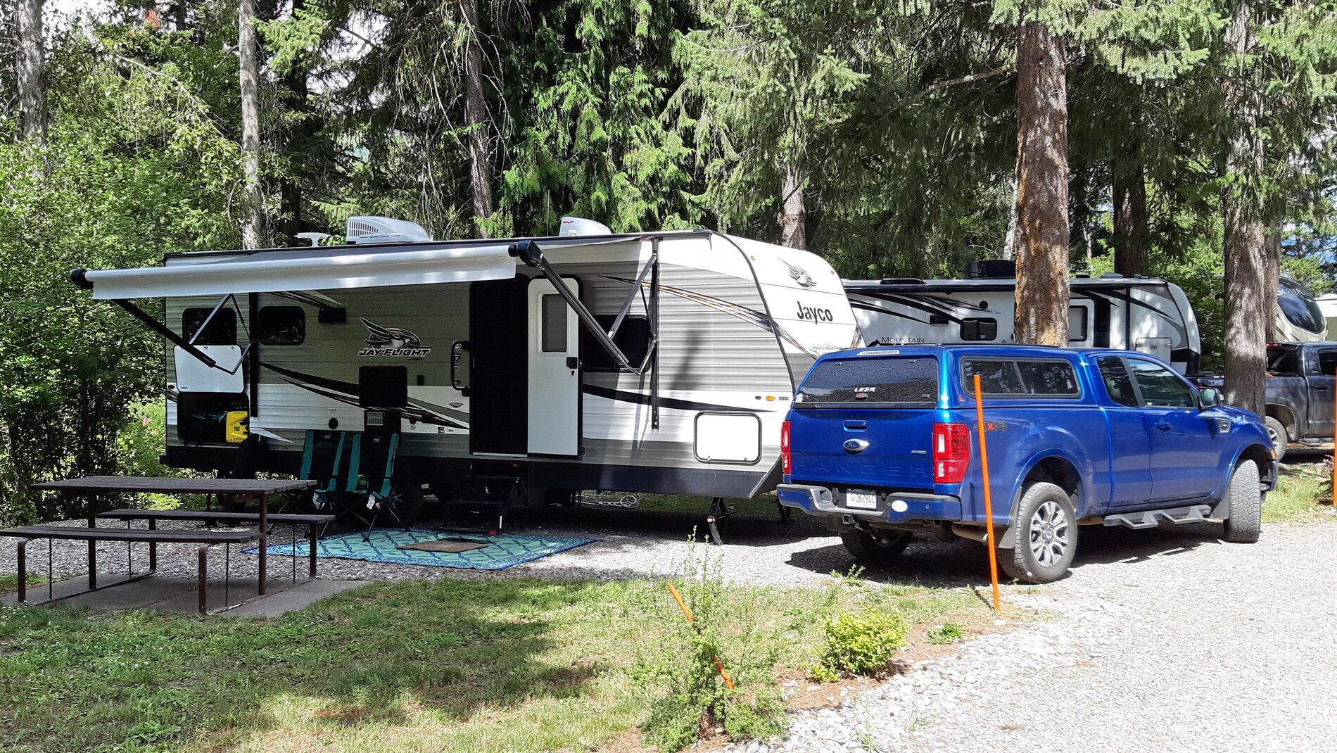

I think you're going to love towing that size of trailer with your Ranger. Our SuperCrew FX4 just did its maiden (trailer) voyage with an older hybrid Palomino trailer that ran 4250lbs dry/5150lbs gross and paired with a new Blue Ox SwayPro + Curt Spectrum controller, i would say there was plenty of 'go' and more importantly, even more 'stop' when I needed it. For reference, it was about a 1400km (875mi) round trip. Enjoy!
