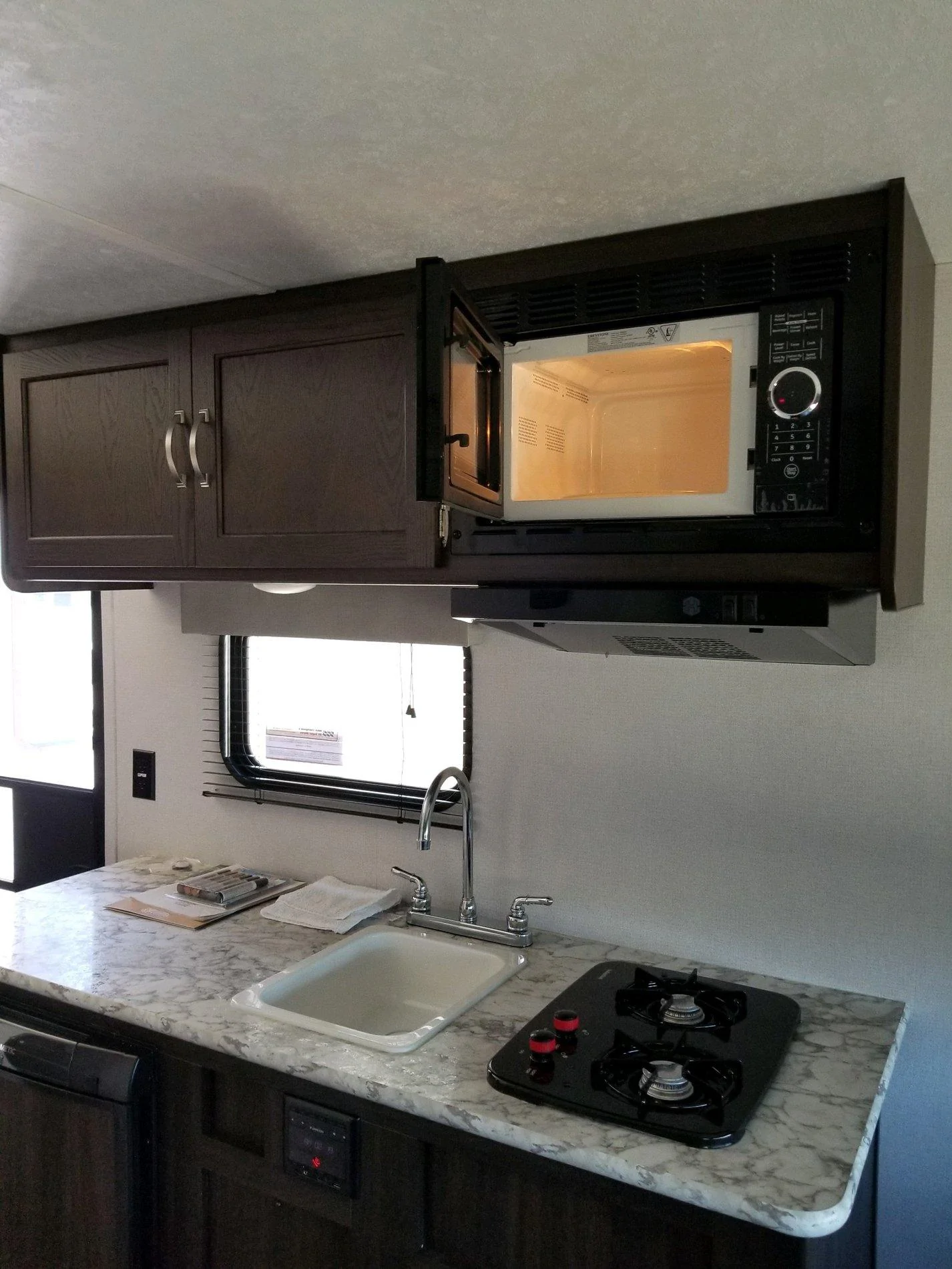

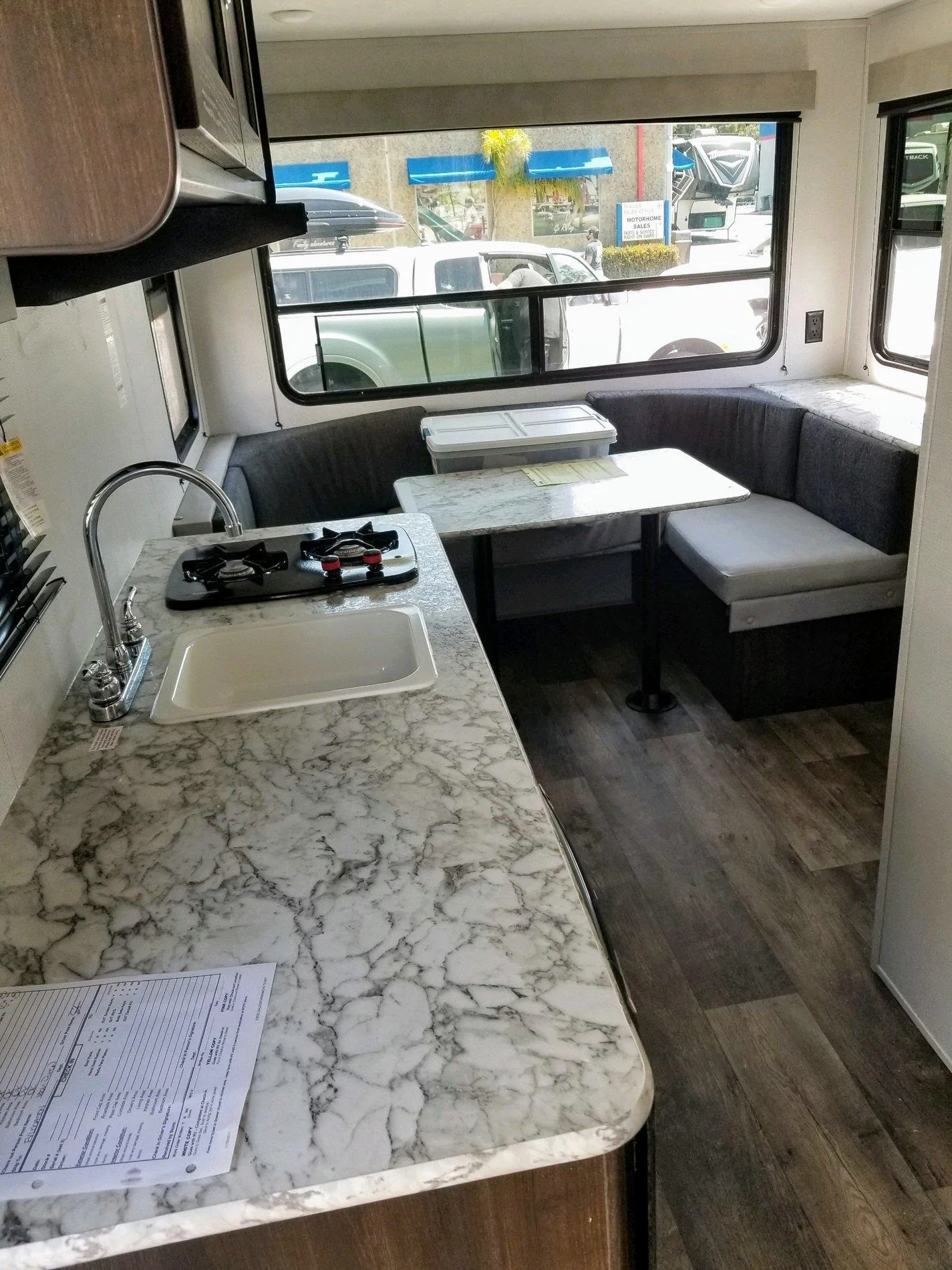

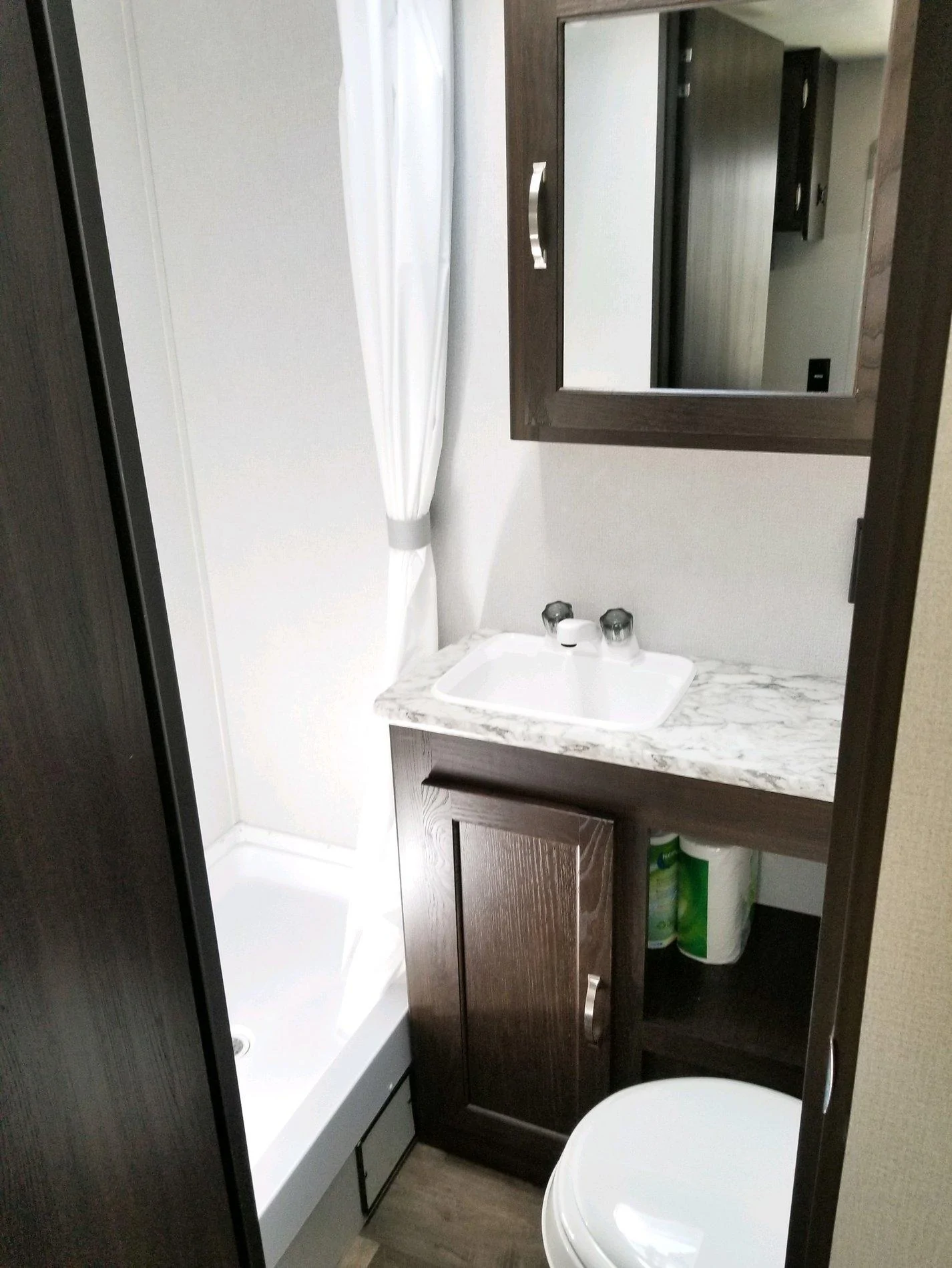

Nice Camper, looks to be the perfect size
Thanks, its a Springdale 1750RD and its affordable at around 16k
Front queen, bathroom, fridge, stove, microwave. Entire rear is U dinette/second queen all glass big views
