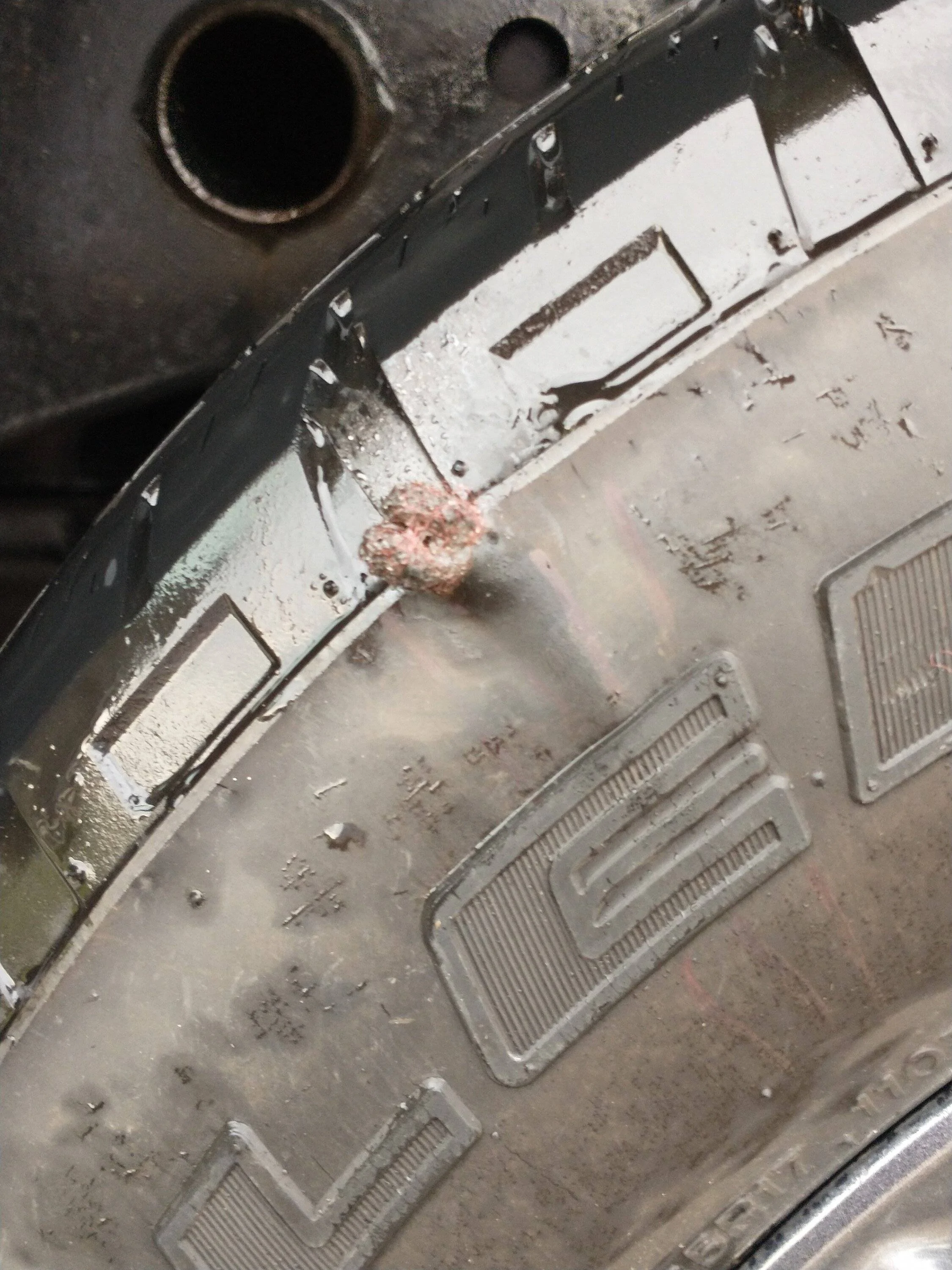

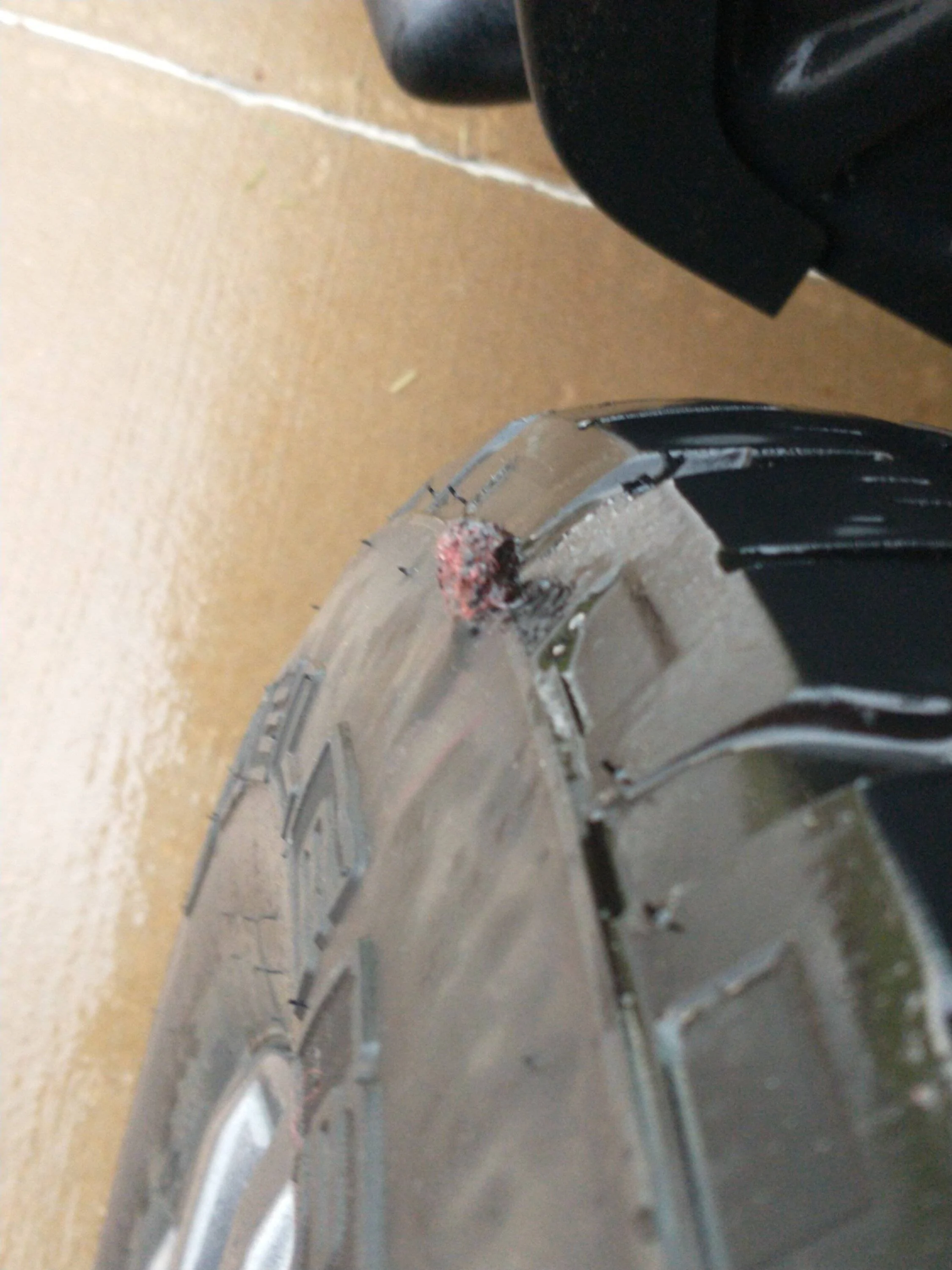

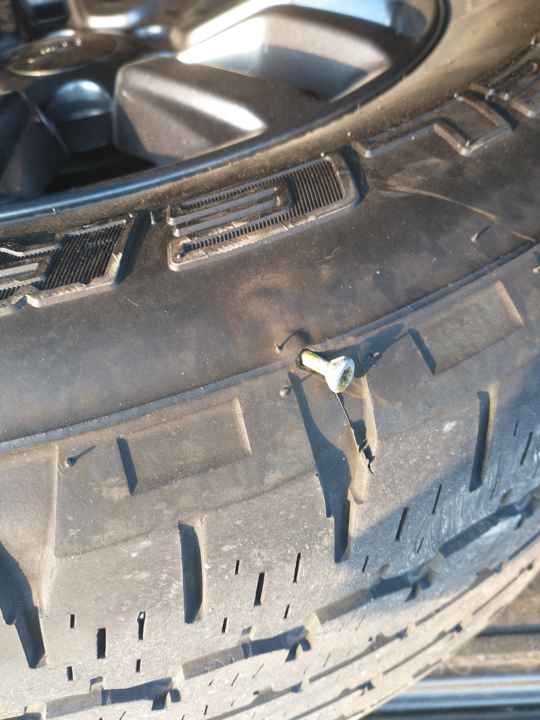

Memorial Day weekend road trip had me putting the spare on.
Picked up a wood screw, entering at a shallow angle into the sidewall -- bad place for a screw.
Small town independent repair shop said its not patchable (I knew he'd say that because of the sidewall).
I told him I'd plug it so I could use it as a spare for the rest of my trip --unless he'd be nice enough to do it for a fee. So he did -- used rubber cement, and even used a butane torch to melt the plug a bit -- he said it helps seal the plug.
And he recommended driving my plugged tire rather than the spare for the rest of my weekend trip since the spare is rated for 50 mph. So I put the plugged tire back on (drivers rear).
I put about 700 miles on the plugged tire over the rest of the weekend, with a lot of it 75-80 mph Interstate highway driving.
I still have the stock tires on my XLT Sport, 5/32" to 6/32" tread, 40,000 miles. 255/65R17 Bridgestone Dueler A/T
The repair guy recommended I buy a used OEM tire off ebay, and run that until I need a new set--gets more use out of the other 3.
I don't tow, or haul loads.
Should I:
1. Run the plugged tire for another 5,000ish miles until the stock tires are wore out
2. Buy a used OEM with ~ 6/32 tread to finish the life of the stock tires
3. Buy 4 new now
Here's some pics (the red fuzz on the plug is from the Tommy's drive-thru car wash yesterday)
Thanks in advance.
Sorry I'm late to the conversation.
Sidewall punctures are the worst. Don't take any chances...I recommend replacing the tire.

Replace, that's a sidewall blowout waiting to happen.

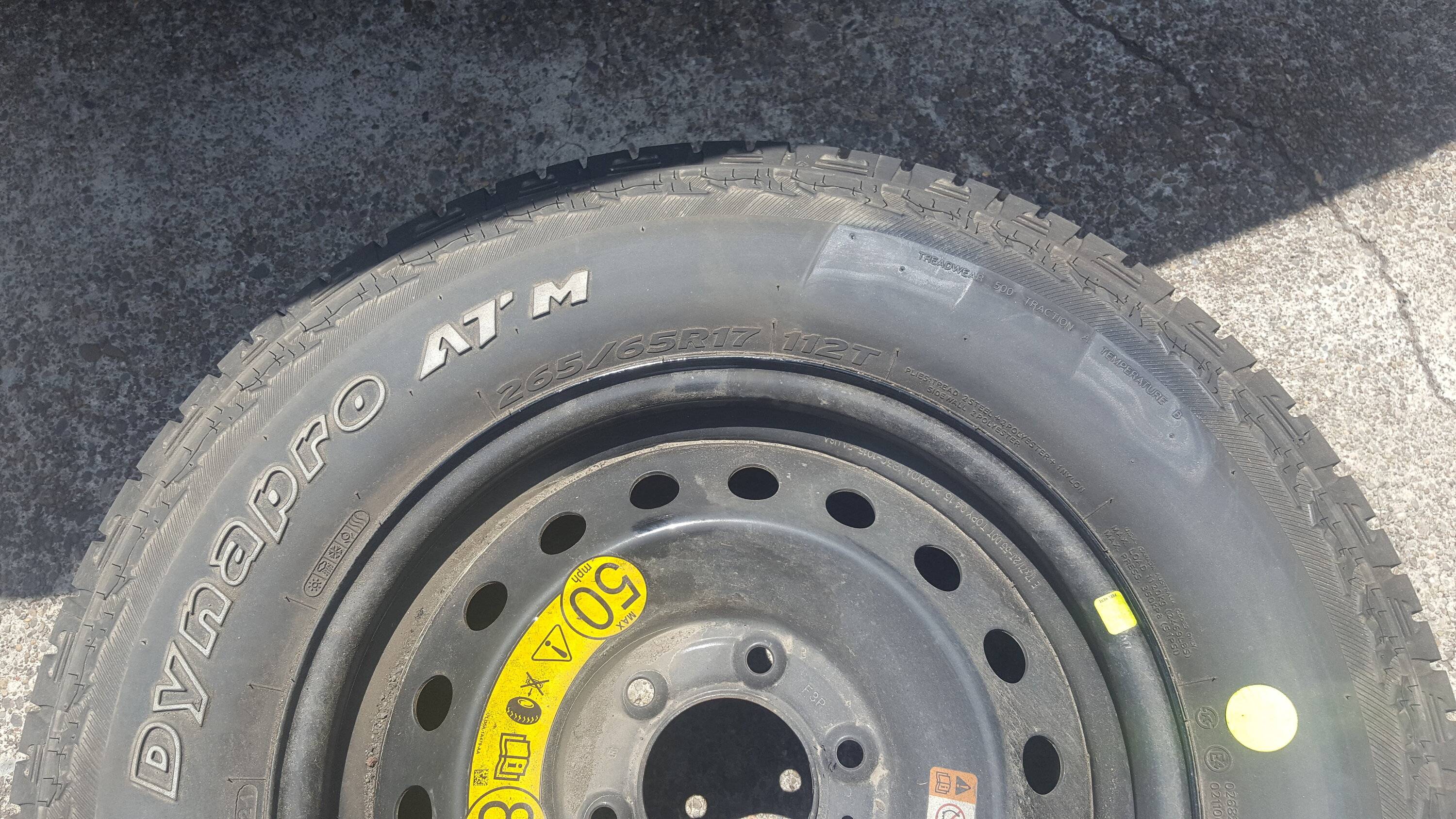

When I discovered I had mismatched tires from the dealer on a new truck, I had to send them pictures. Sure enough, my spare although the correct size but P rated vs. LT rated.

Thanks for all the great advice - didn't want to hear I need to replace the tire, but I also understand its the right answer.
