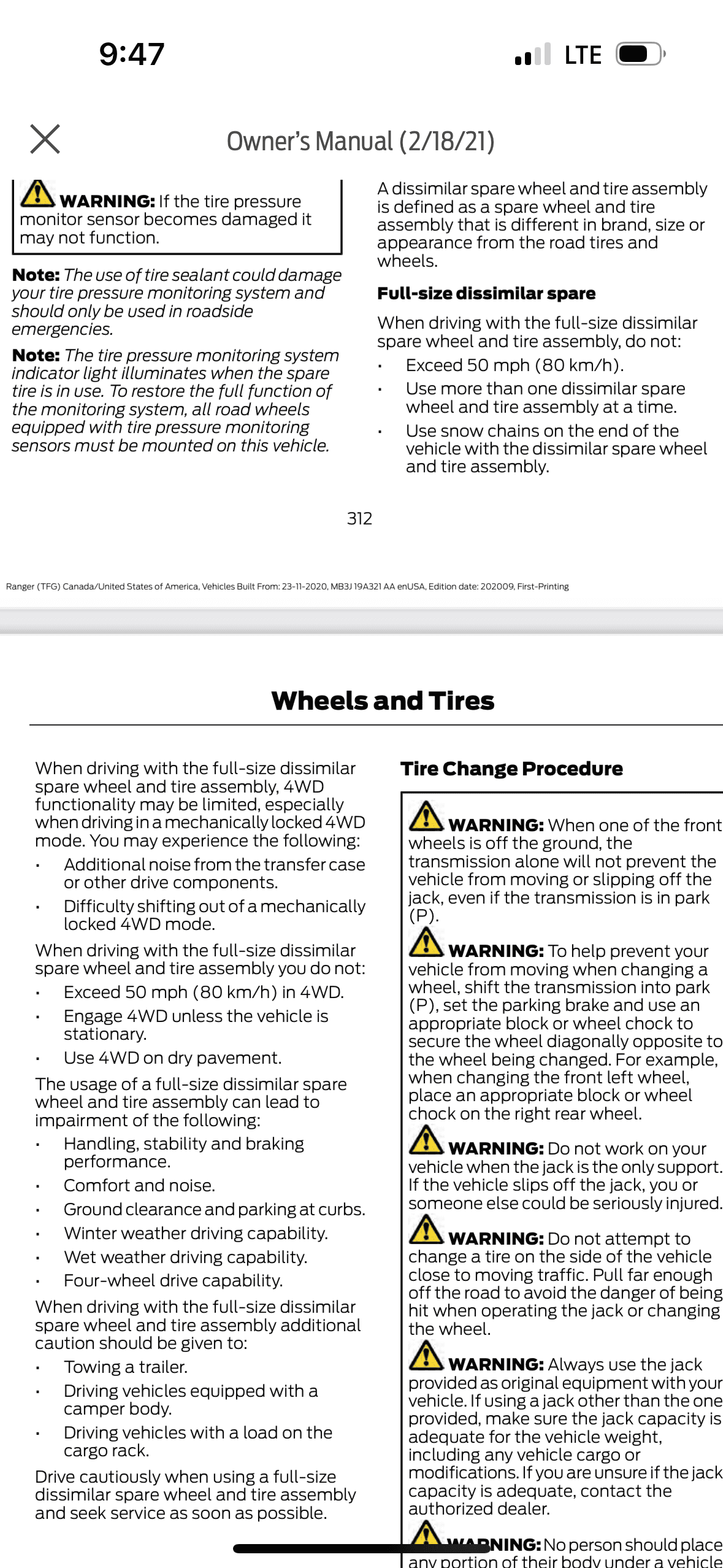

Well, I’ll be…. From the manual:
If the spare is a special type and compact then that usually applies and is usually listed on the tire. Full size spares are usually about the same at the regular tires.and can handle the high speeds
I believe the bigger issue is the potential for the rotating mass to be different, which could be significant enough to cause an issue. No doubt a lawyer has molested these warnings. And I am equally as confident that a farmer could make this work in a pinch.

Yes, the Spare is a full-size spare, but you could have a 16 or 17 in steel wheel with a tire size height comparable to your stock wheel and tire size combination.
The dissimilar wheel that the manual is referring to it states that for safety and vehicle control purposes.

I bought a set of 5 bronco steel rim wheels and tires. The spare on the Bronco did not have the 50 mph sticker like my ranger spare, but was the exact same rim as my ranger spare. The only difference was that the Bronco spare had been balanced and had weights attached. I'm guessing the only reason the Ranger tires have the sticker is because they never balanced. At least my spare on the ranger isn't. Or maybe the caffeine hasn't kicked in this morning.

If you have one of the dis-similar spares just save one of your tires and purchase a matching rim that's on your Ranger. Mount that tire and replace your dis-similar spare with the new one. That way the 50mph limit is out of the way!
