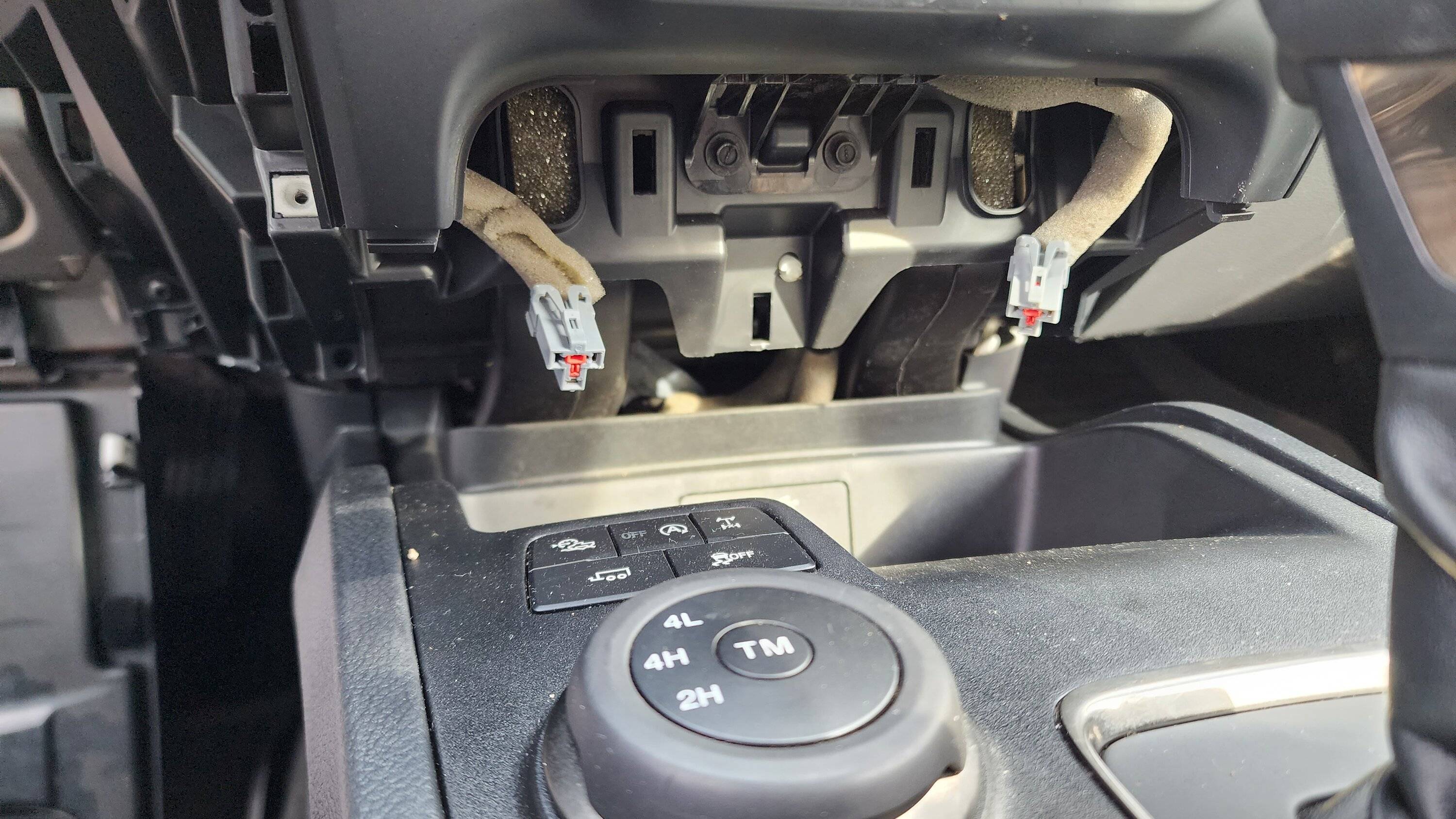

Yes I should have grabbed a picture. That connect is where I need to tap for the paddles. But that connect can be seen, but cannot access it. The cup holders literally sit ontop of it. So it looks like the console may have to be moved to access it. Argh
Sadly, without a picture I'm not sure i follow :p It just seems like you could attach a mating cable to that connector and snake out a cable to play with.
That connector was mounted to allow clearance for connecting to, and even if not for some reason, seems like it could perhaps be shifted slightly by popping off of its connection point to make space to install a connector.

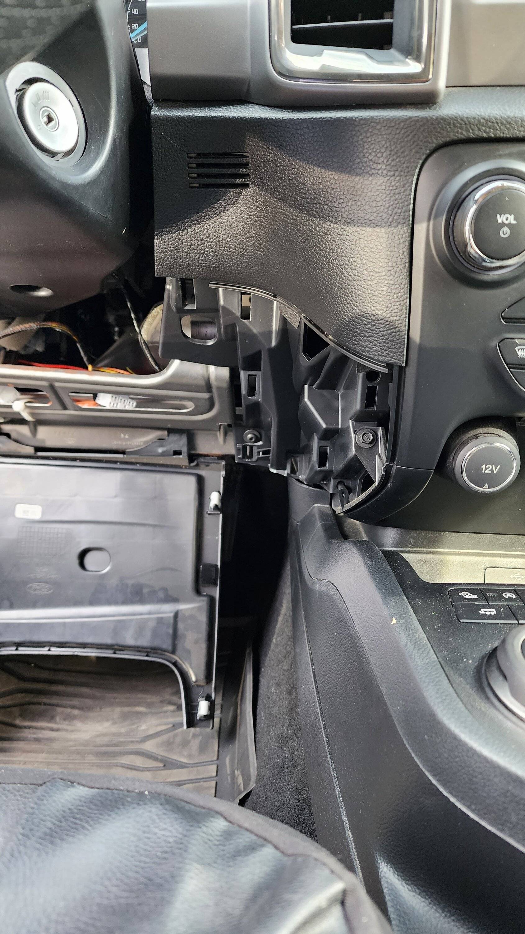

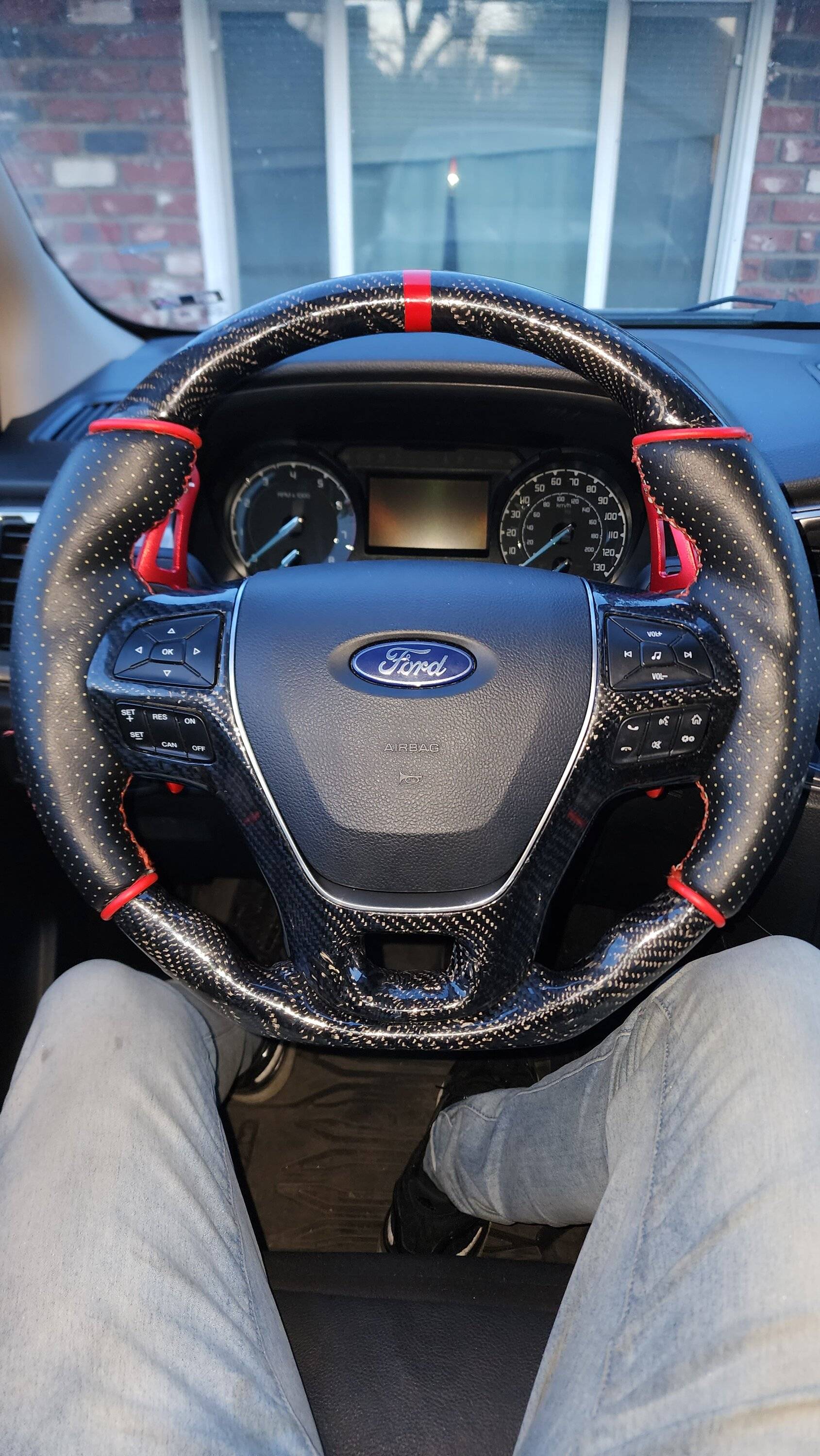

Update for everyone, I successfully installed paddle shifters on my ranger, using the info you guys posted and an explorer steering wheel, this can be done with the ranger steering wheel as well, you'll have to cut holes on the rear steering wheel cover and run the wires from the clock spring all the way down to the shifter assembly, I'm working on a guide on how to do it, I just finished my project today.

Did you connect to the connector at the shifter? Remove the console to access it? Can't wait for the write up!

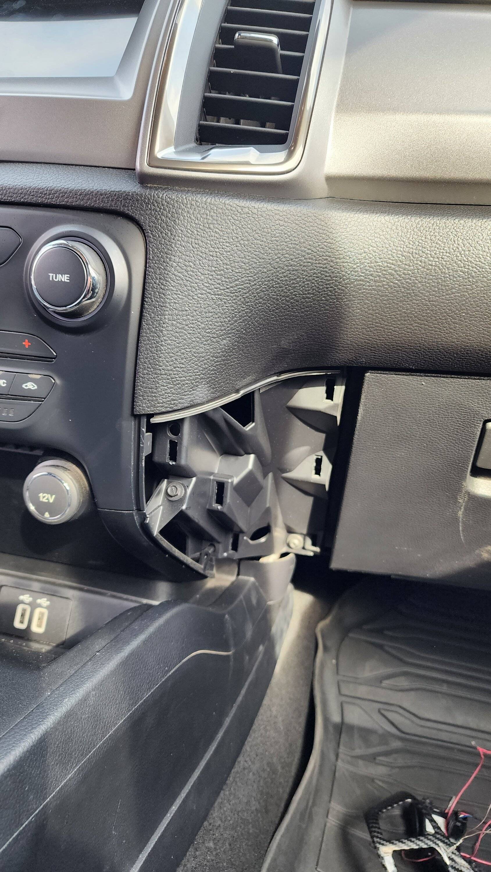

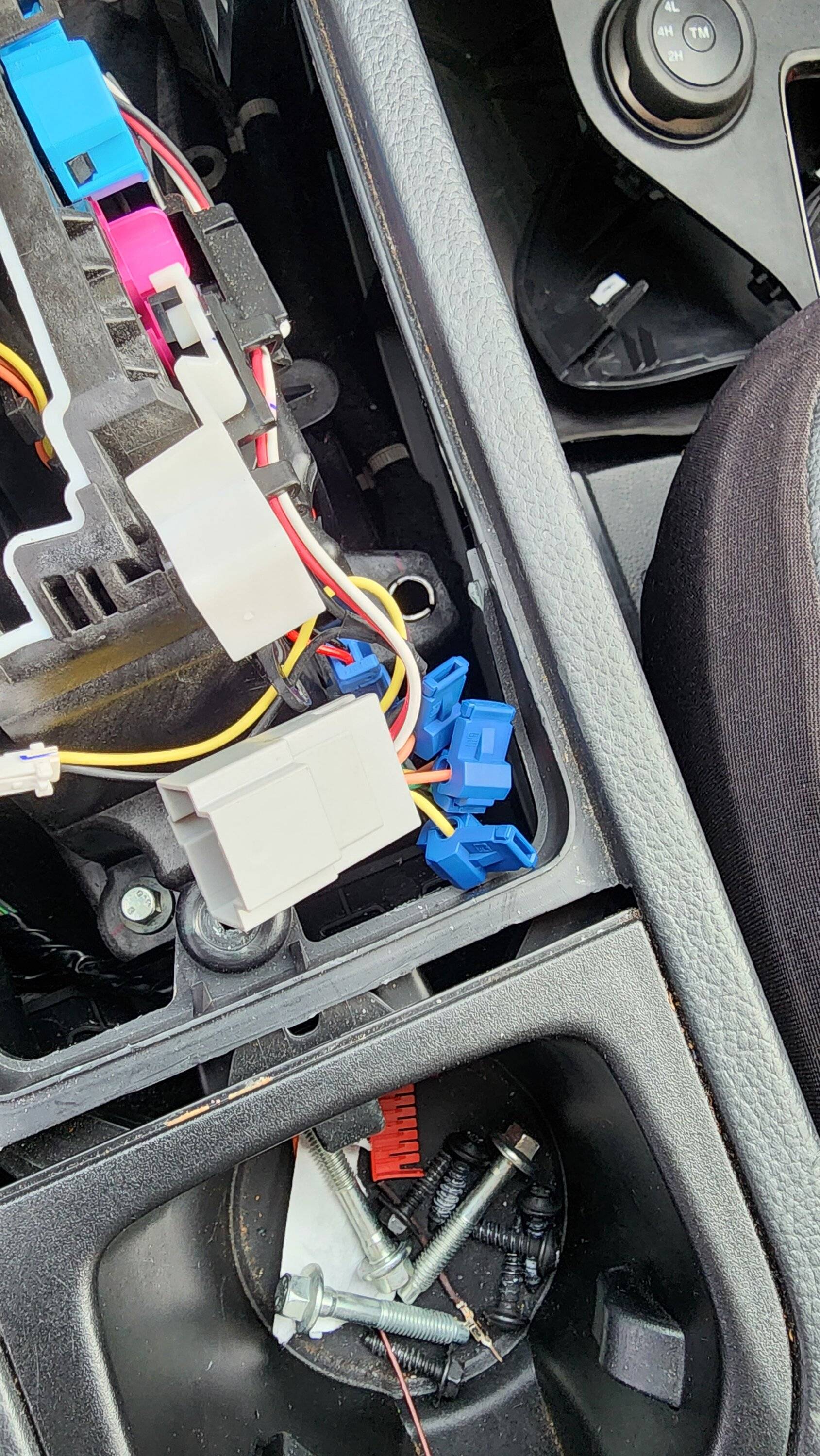

i didn't have to remove the console entirely, just the panels in the pictures and remove the bolts from shifter assembly to have more room to work, I used t tap connectors, but I'd like to improve it by making a proper pigtail connector
Wow, yeah I couldn't even get my hand into that connector. It's under the shifter and decided the console would need to come out, but wasn't up to it.
I just wanted to do a proof of concept to see if it was even possible.

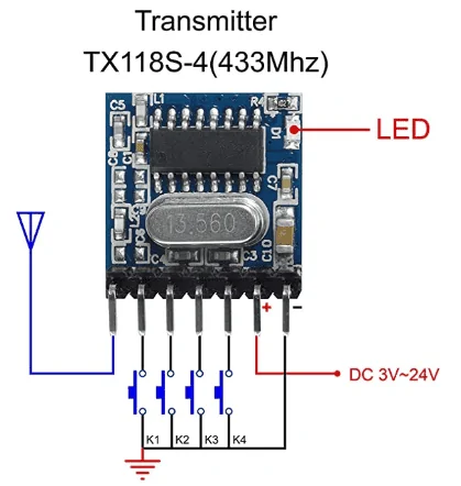

I bought a Explorer wheel with paddles and I also bought some inexpensive 4 channel wireless switches, thinking I would try the wireless route instead of dealing with the clock spring. I originally thought MAYBE there were 2 spare connectors that went all the way through the clock spring. But not sure, there are certainly spare connectors places, just not sure if Ford wired them all the way through. Anyway there are small, the transmitter would go at the wheel and the receiver at the shifter, easy.
Are you tapping the same wires that do the up/dn shifting on the side of the shifter?

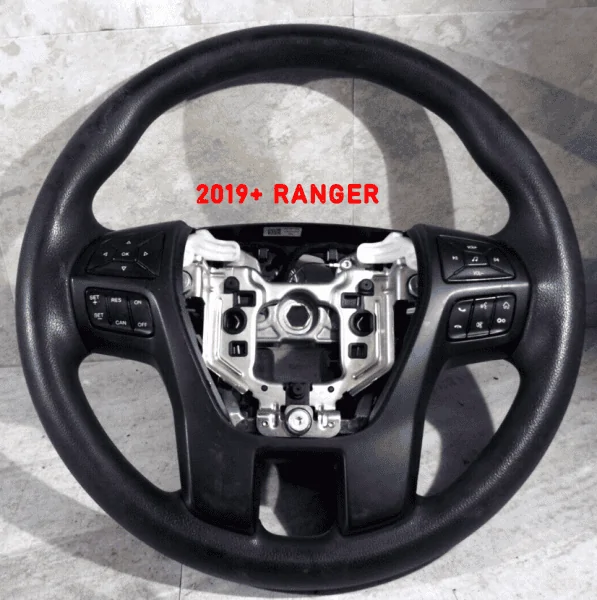

I love this project. I am FBO, big turbo, E85 and HP tuners offers a trans brake. But, to initiate the Trans Brake you need to have paddle shift (hold - + simultaneously) while pressing the brake and taping the throttle. Also, would prove useful in roll racing. Your photos and pinouts will prove most useful! My question is, do you have a specific explorer steering wheel you purchased. I don't want lose my Lariat button layout/functions OR a paddle kit that would bolt on after you cut said holes and a Clock pinout? Thank you for any help!
daczone
daczone
Dec 22, 2020
34
404
645
2020 Ranger

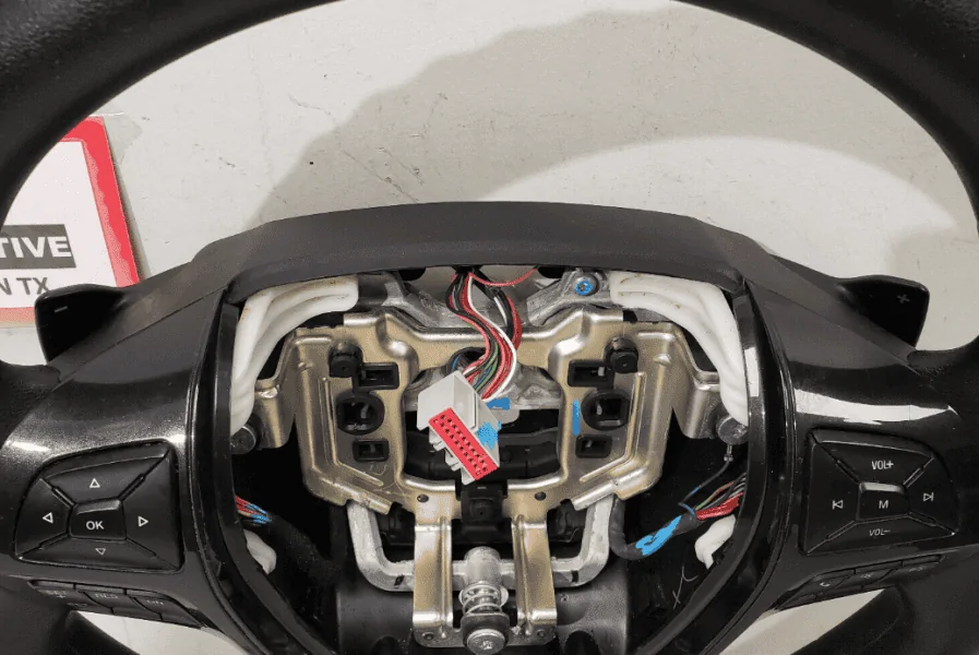

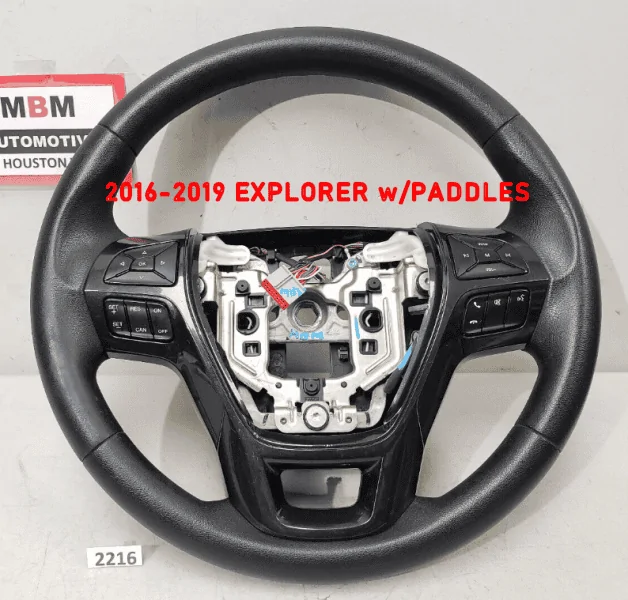

2016-2019 Explorer steering wheel with paddles (They don't all have them, as it was an option). The Steering wheel is REAL close to the Ranger wheel, but the airbag is indeed different. Which makes it not a direct swap. However my 2020 Ranger does indeed have the drilled and taped holes for the paddles. My plan is to just move them over and get real good with my dremel to cut the plastic in the back of the wheel.
Paddles on the back of the steering wheel / seen here:
