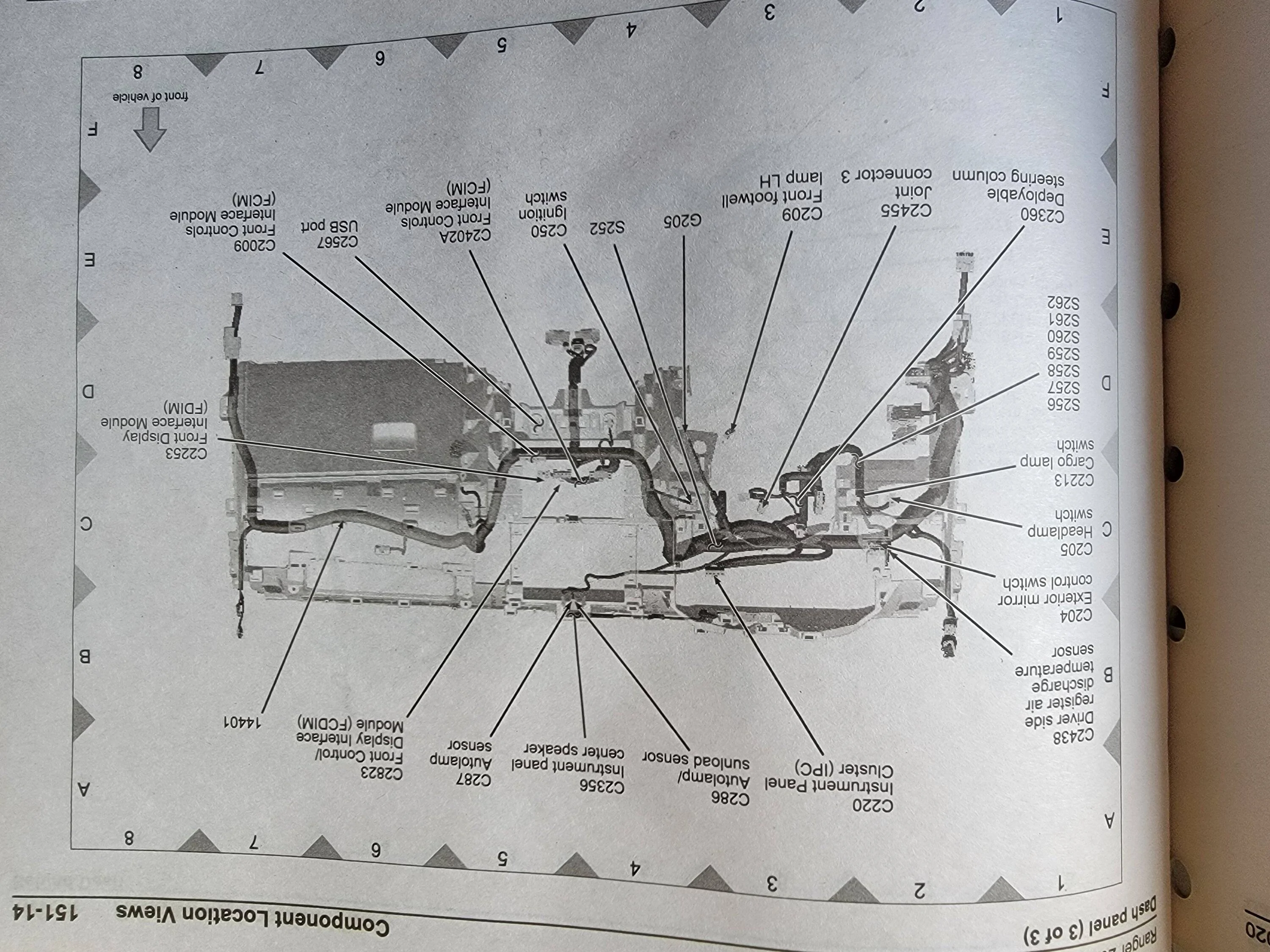

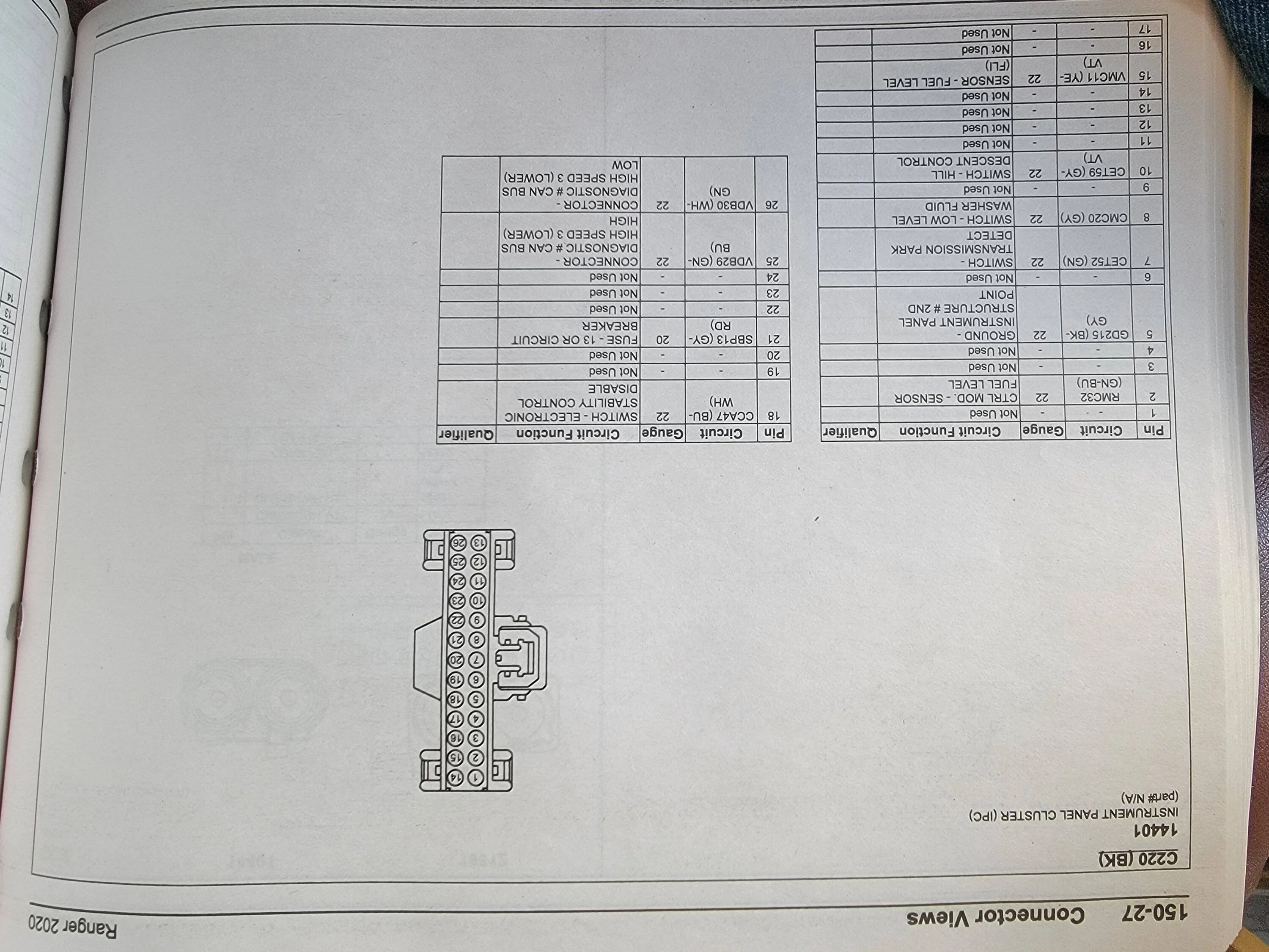

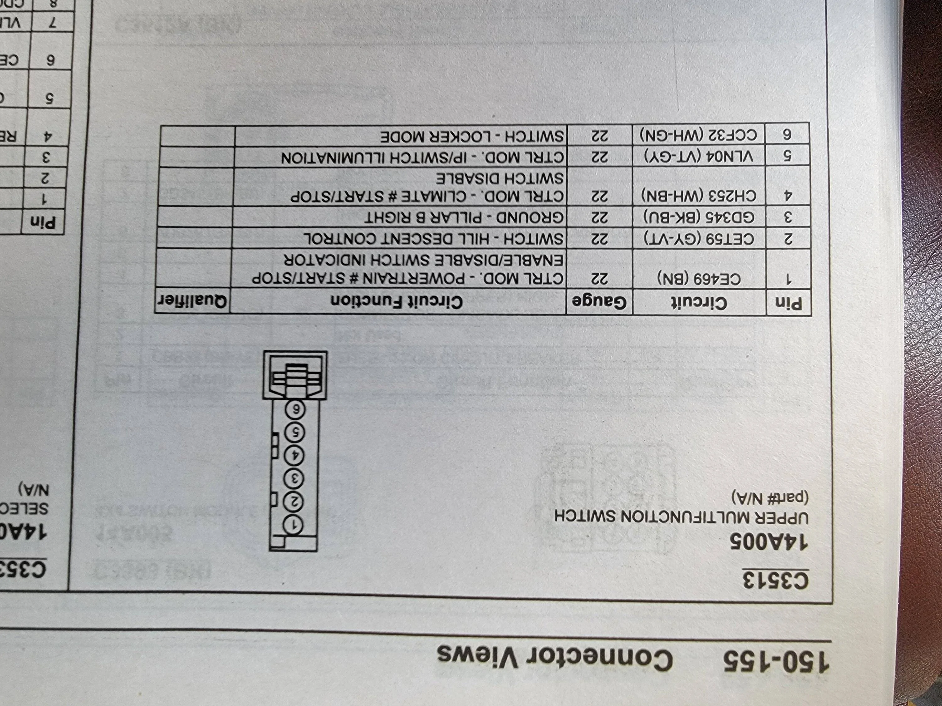

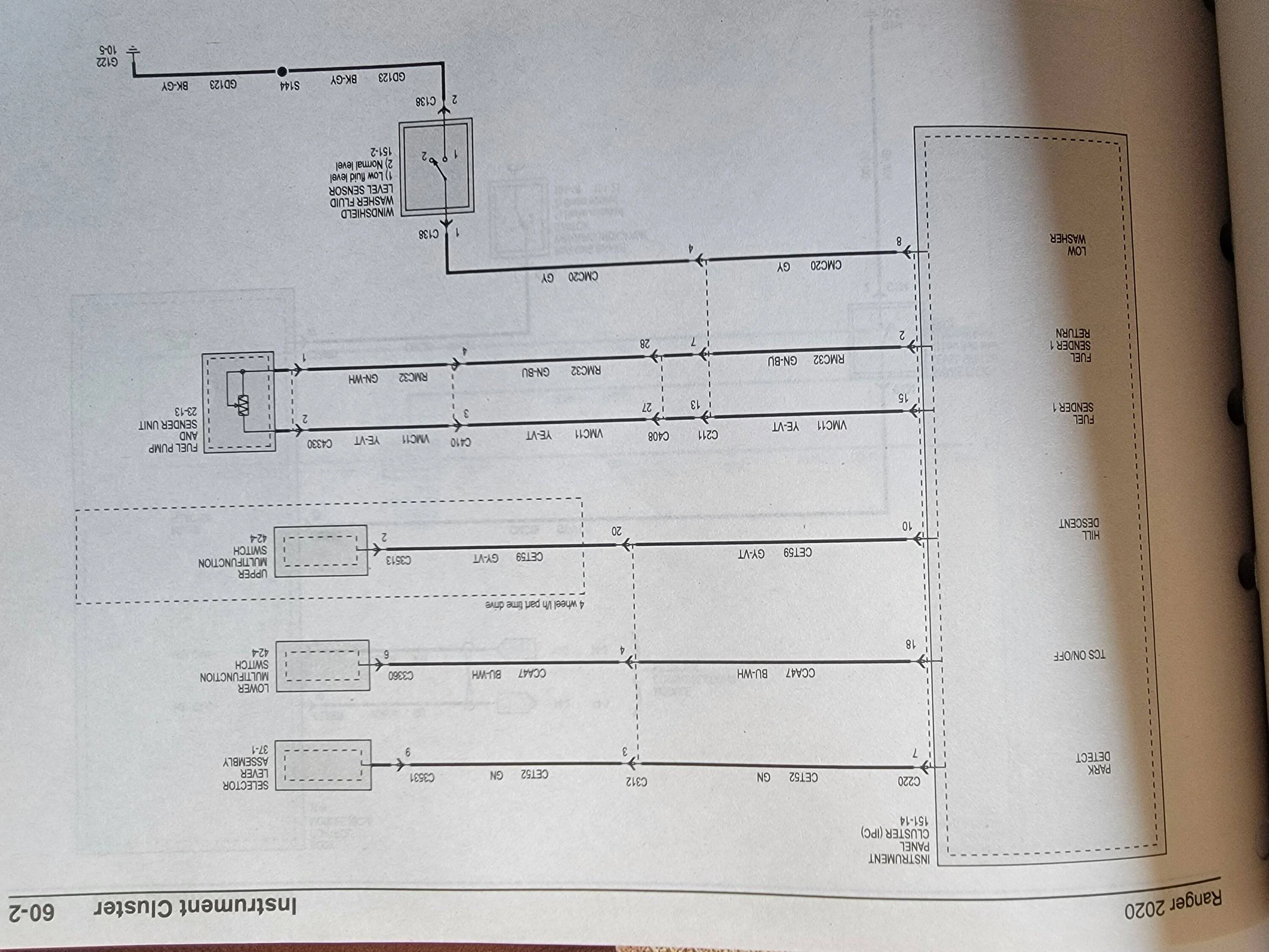

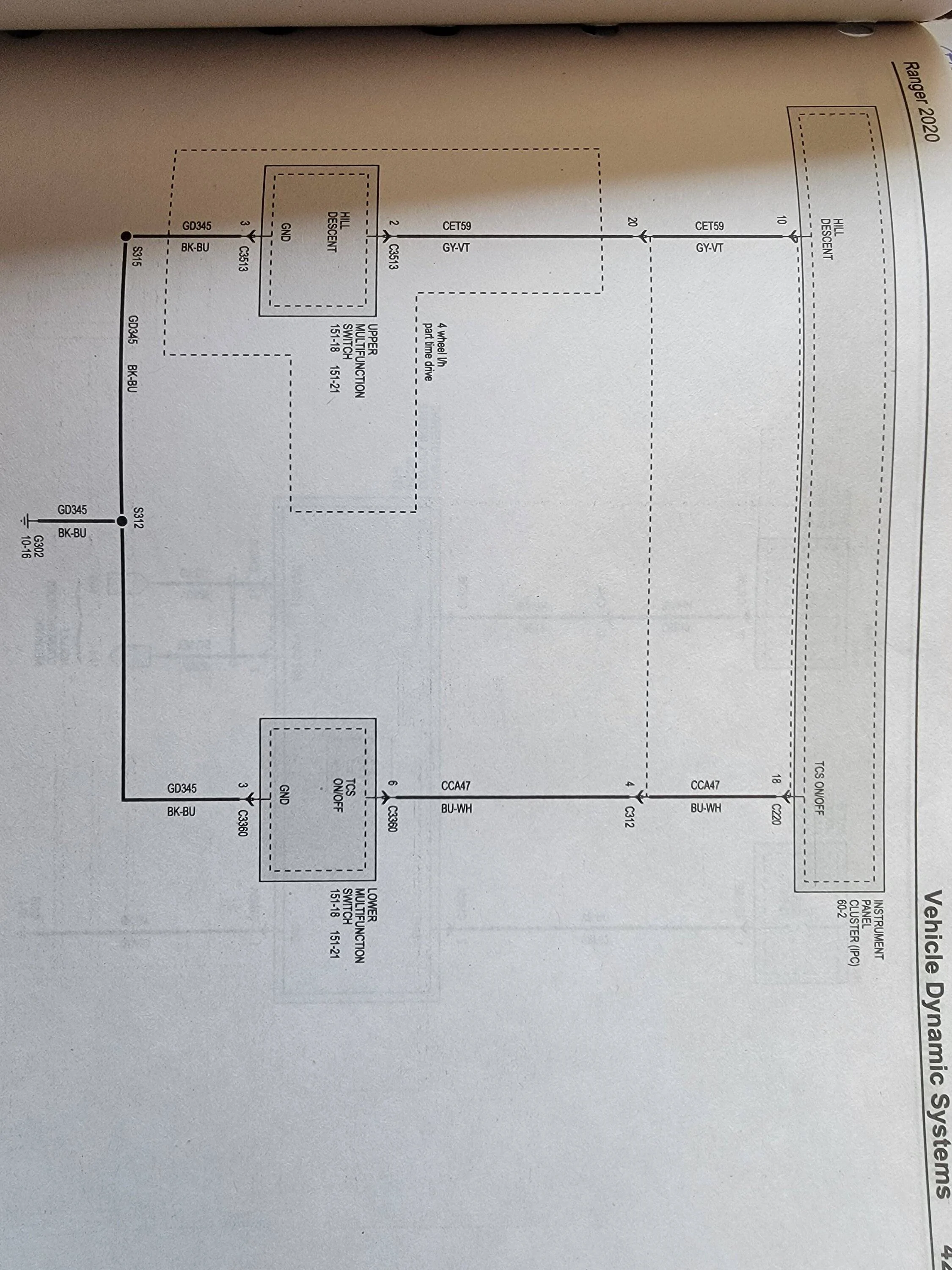

I am looking for the pinout of the IPC (Instrument Panel Cluster) and possibly the Instrument Panel Console Switch Assembly.
Specifically looking for the circuit for the hill decent control/trail control.

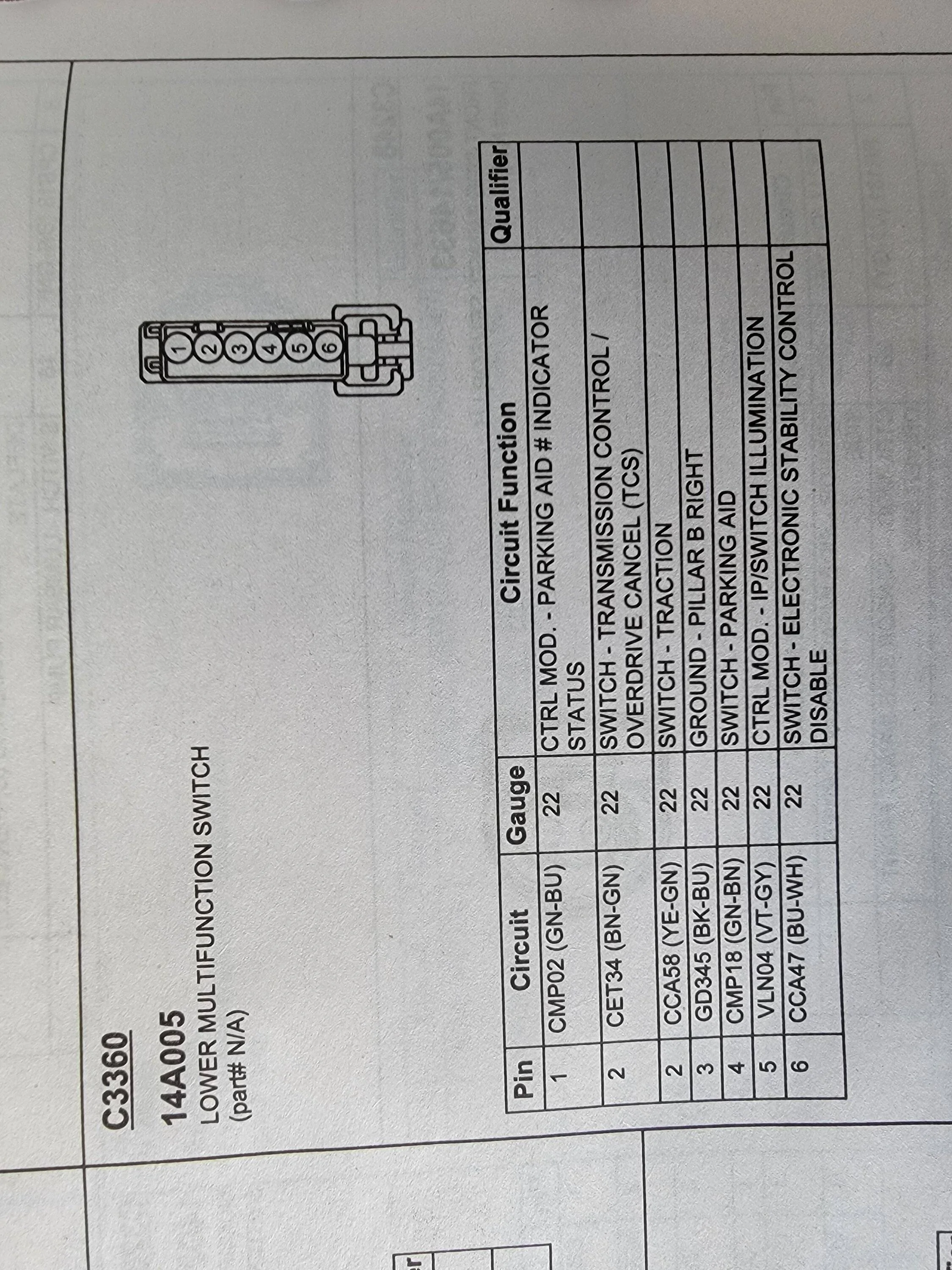

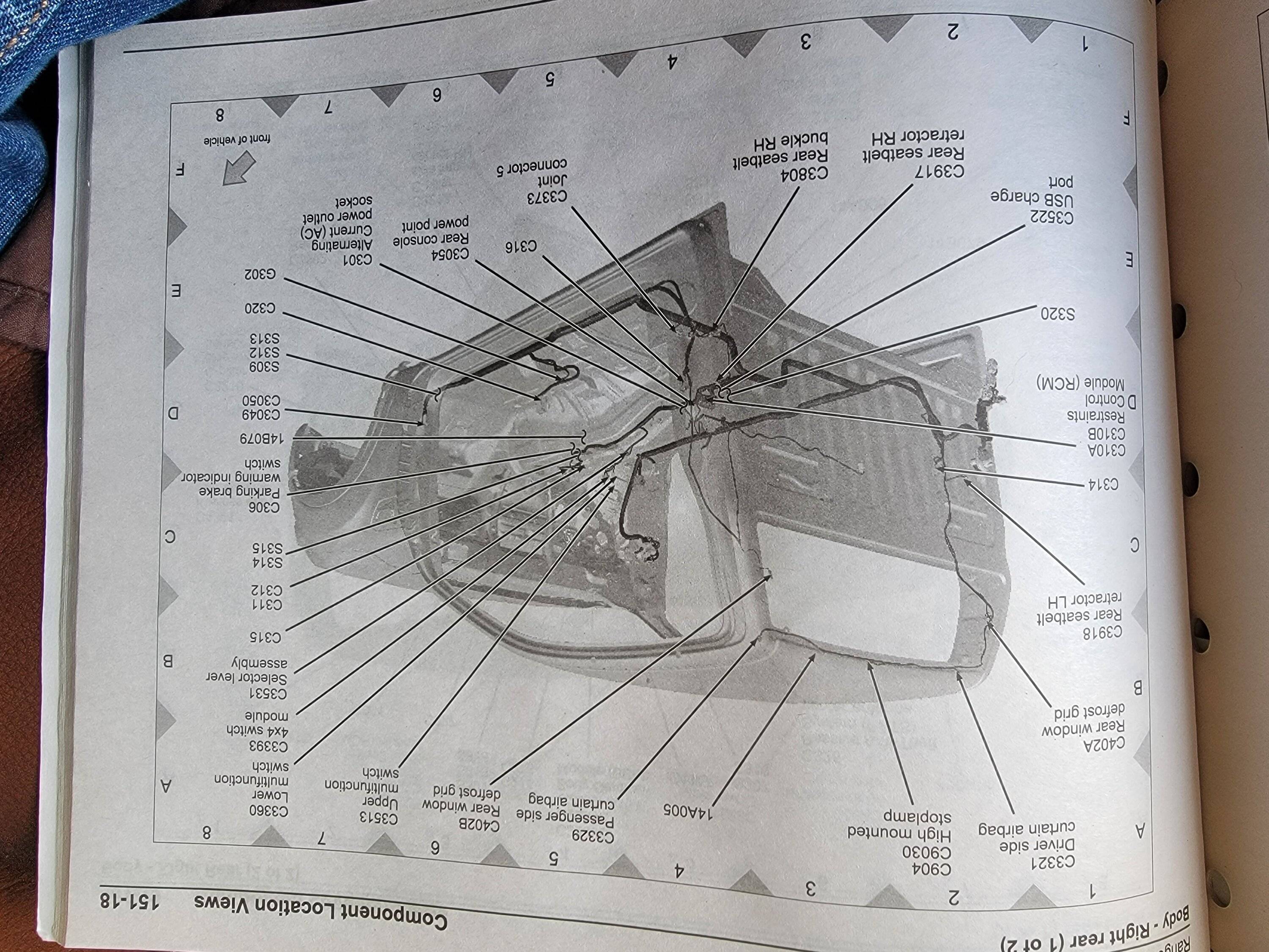

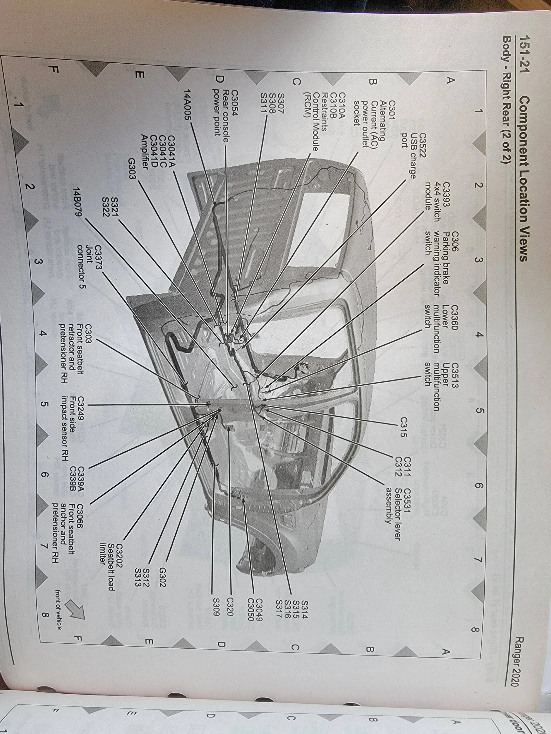

2020 Ranger Lariat FX4 SCREW
Not sure what year you have. This is from a 2020 manual. I'm guessing not much has changed. This is all I've found for it. Hope this helps :like:
