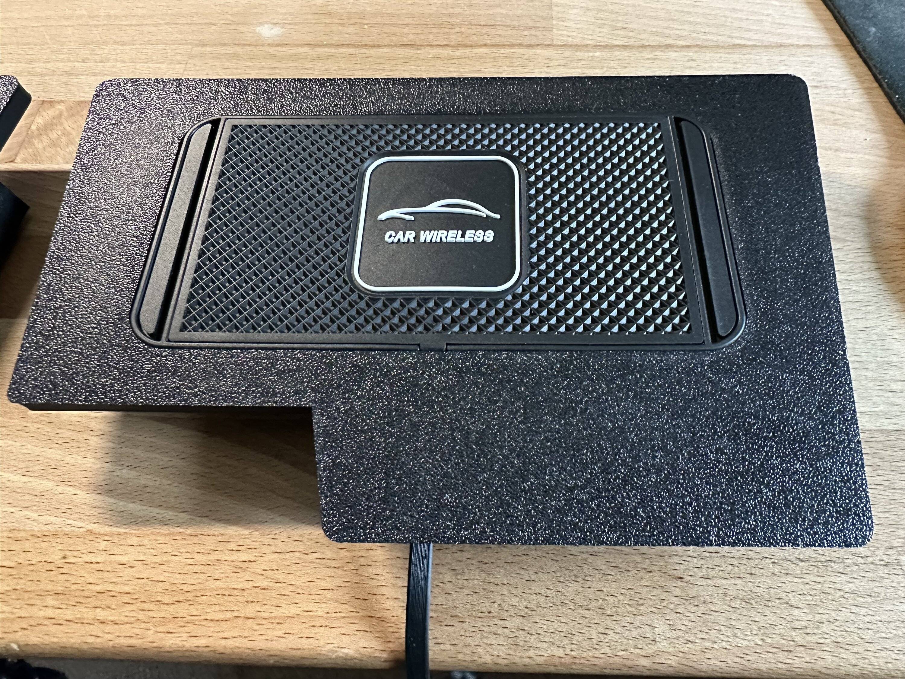

the charger recommended earlier in the thread wasn't available when I bought mine, so I got a different one that looked very similar.
I'm also using an Otterbox Defender Pro case that's rated to be used with wireless charging, if that makes a difference.
anyone have a current known reliable wireless charging pad link available so I don't have to dig through 22 pages of posts for it?

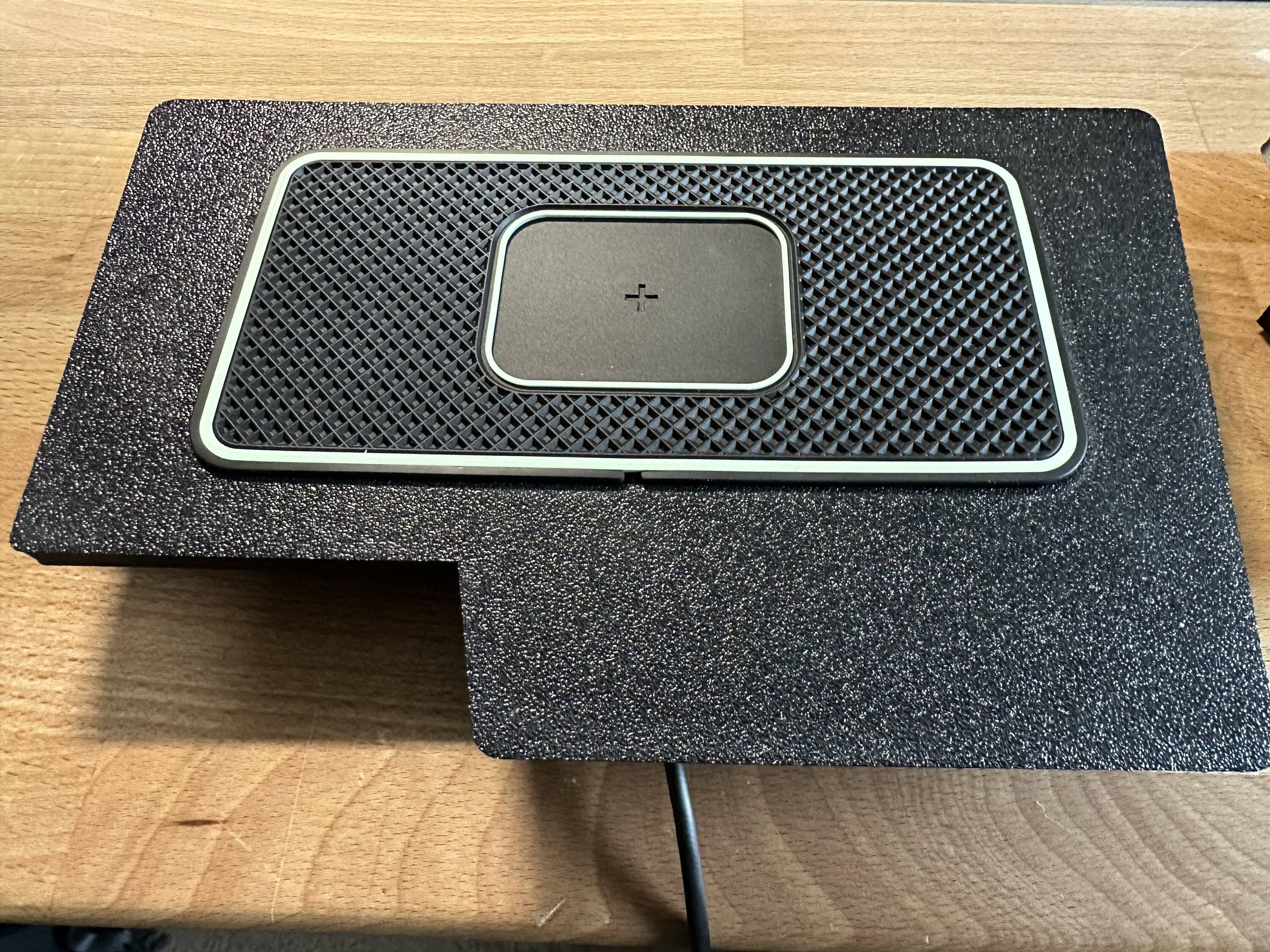

Ivā€™e used this one with Dirkā€™s tray since July. I didnt like the little car logo and the ring glows green in the dark. I also wired in a separate power supply for faster charging and use an iphone.

Dirk's tray is 1000% worth it. Perfect fit and looks great! The charging pad was the only weak point. I have an Otterbox case and it works just fine with all of my wireless chargers in the house, but for some reason, I was having trouble getting the phone into the sweet spot on the Car Wireless pad. I had already purchased another pad from Amazon (Sanmido) that appears to have a slightly larger coil area within the pad. It also fits snuggly into Dirk's tray. No problem with the phone charging on it. I will find another use for the Car Wireless one.

so I bought this charger, hoping that the larger charging pad area would help with the overheating issue, at least. time will tell on that.
it doesn't help with the BT interference/restarting problem I'm having, though. I think I'm going to try relocating my AAWireless puck. It's currently hiding beneath the charger in the tray, but I'm going to try putting some adhesive velcro on it and sticking it to the underside of the center stack to place it above the phone/charger. might help with the interference issue?

I changed over to the Sanmido a few months ago and last week did my first long road trip with it. It's marginally better than the car wireless one. when the phone is running AA, it adds a little bit of charge over time, but it's not what I'd call fast. biggest thing I noticed with it, though, is that my phone doesn't get so hot on it. so that's a big plus.
I also wired in the higher powered usb port. I may wind up just putting a cord into that port instead of the wireless charging pad so I can actually get a decent charge fairly quickly.

I have a Samsung Galaxy S22. Reportedly will do wireless charging up to 15W.
Whatever it gets from the charging pad, it's barely more than it's using when running AA (and with the car wireless pad, it seems about equal - except the phone gets too hot and shuts down).
