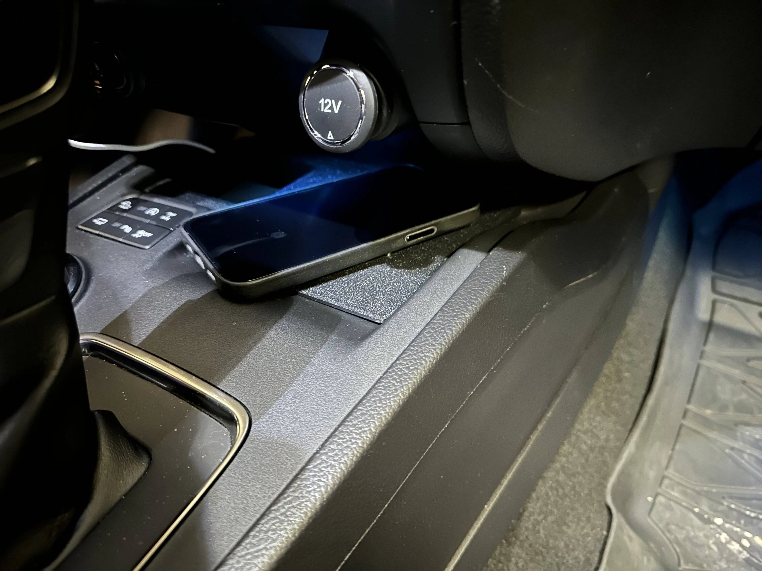

Possible. Heat kills electronics. I have an iPhone and I think they charge more slowly than android. My pad might produce less heat with my phone. I have the Bluetooth module taped to the bottom of the tray and it’s only slightly warm. I’d relocate yours like you plan.

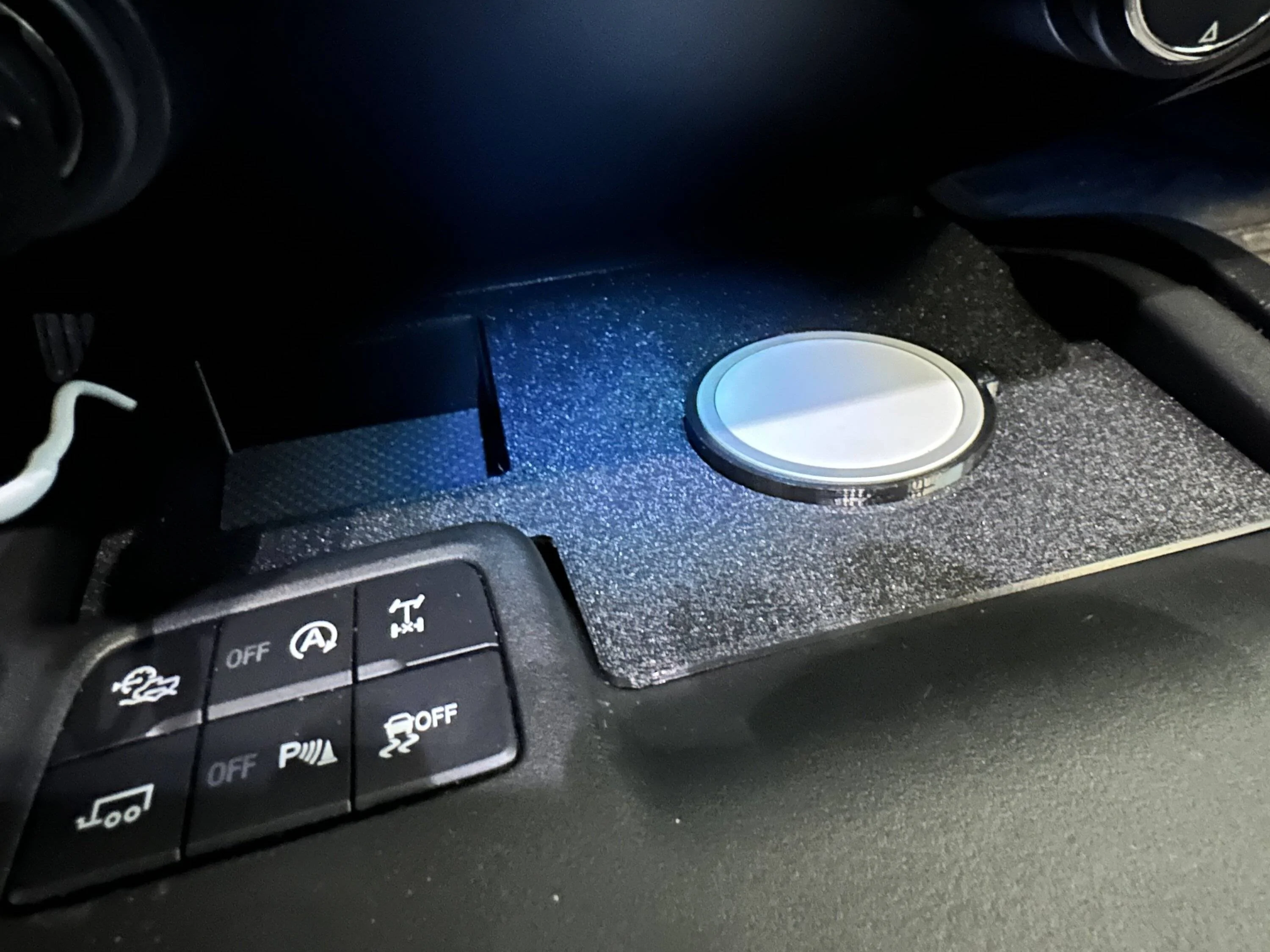

Looks like your question has been replied to but I just saw this and what the heck, might as well post a picture. I’ve been using it continuously since installing it. Still love it.

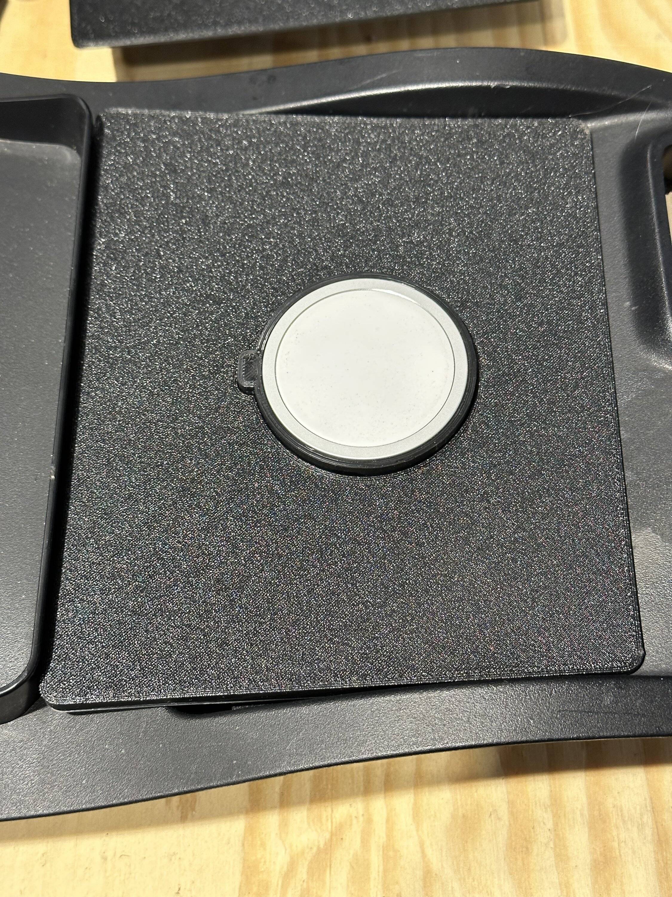

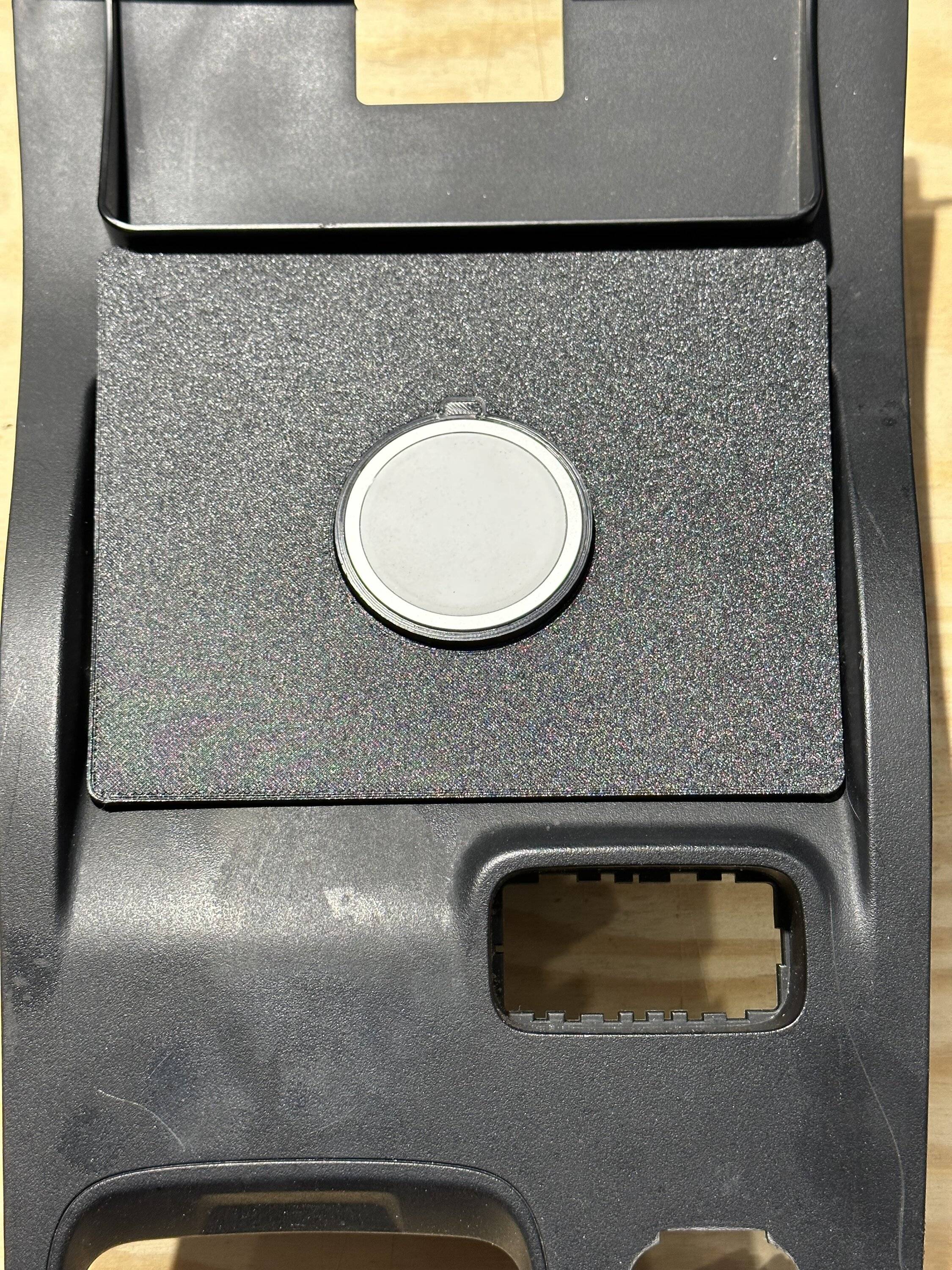

The only way to avoid the overheating is MagSafe for iPhone 12 and newer (or the upcoming QI2 standard for this years Androids), MagSafe always holds the phone in the best position on the pad and allows charging with 15W without too much overheating, I have done 6+ hour drives with Apple Music playing and Google Maps navigating and my iPhone 13/14 Pro got barely warm.
I'm playing with a new idea where the phone sits on the right side of the console (and it has a little coin/stuff box on the left) but that won't support the Max models.
Even on an angle, the phone is still perfectly positioned.
MagSafe also fits the RHD bracket

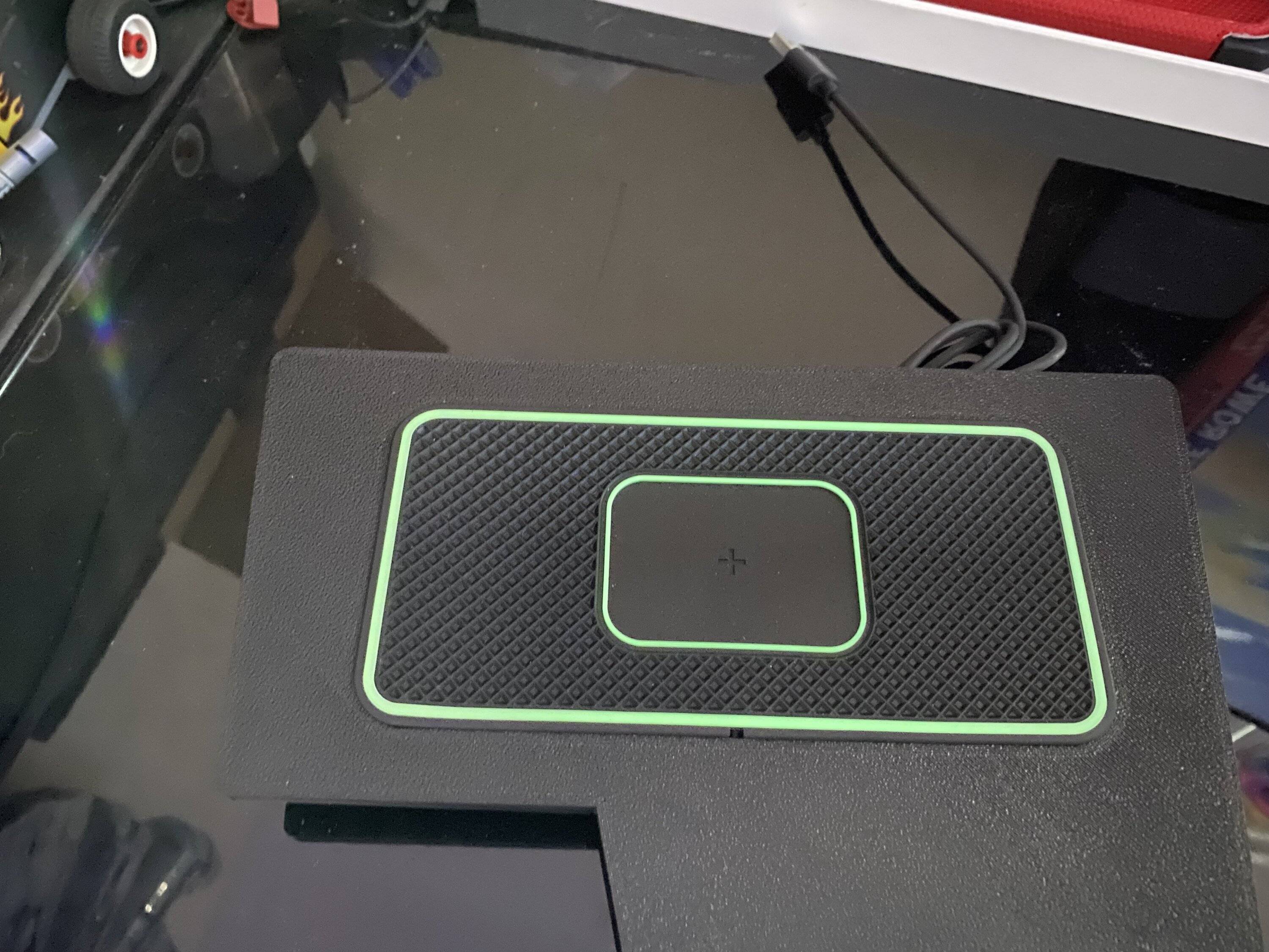

So I bought the other pad - now have both the Car Wireless and the SANMIDO.
My observations and feedback(Opinion!)
  1. As Dirk showed it does fit as is in his tray but stands taller.
  2. Charging wise its the same as the Car Wireless - I had thought the CW was only 10W as stated on the Amazon page, but it is labeled as 15W and did charge my pixel at 12-13W. S22 is still only 10W due to phone limitation. I get same watts measured for both and charging times are reported as the same also.
  3. When not in use the idle current was a little more with the Sanmido.
  4. I didn't do any heat measurements, others have reported the Sanmido is cooler.
In the end I am sending the Sanmido back to Amazon, as for me there is no compelling reason to change it. Maybe I should have done some heat testing, but I think my hat problem was the fact I had the module taped under the pad.
