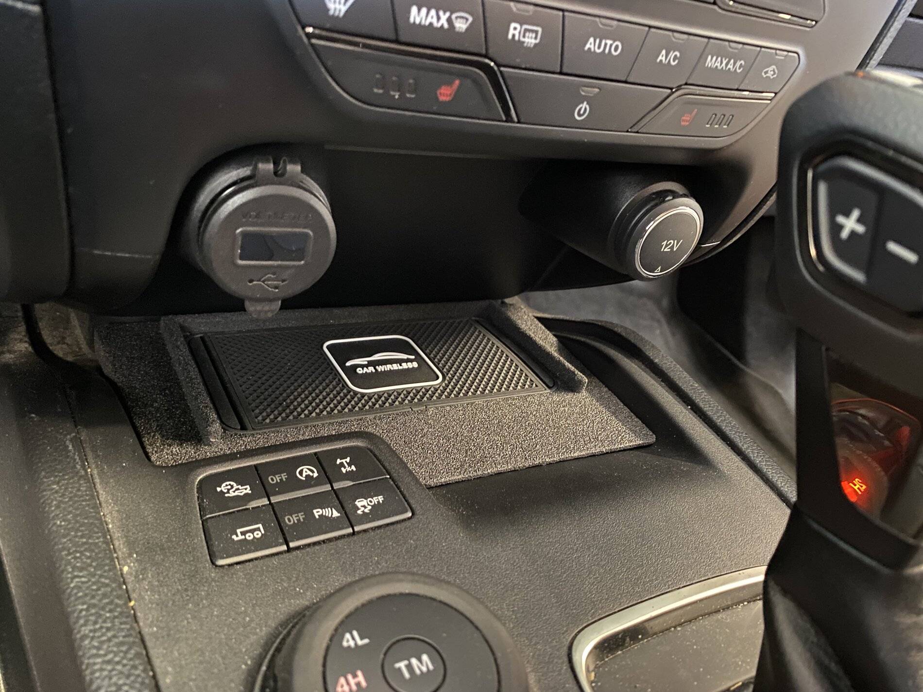

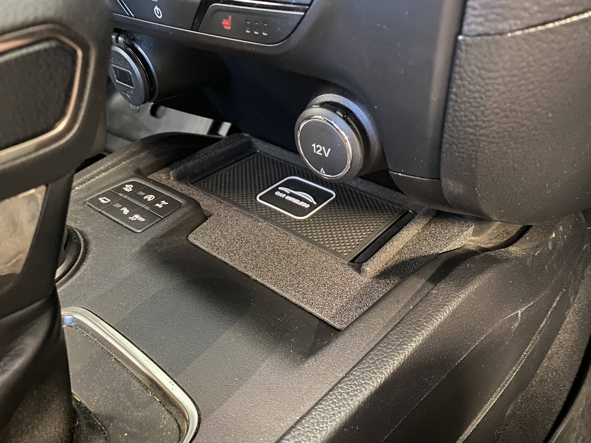

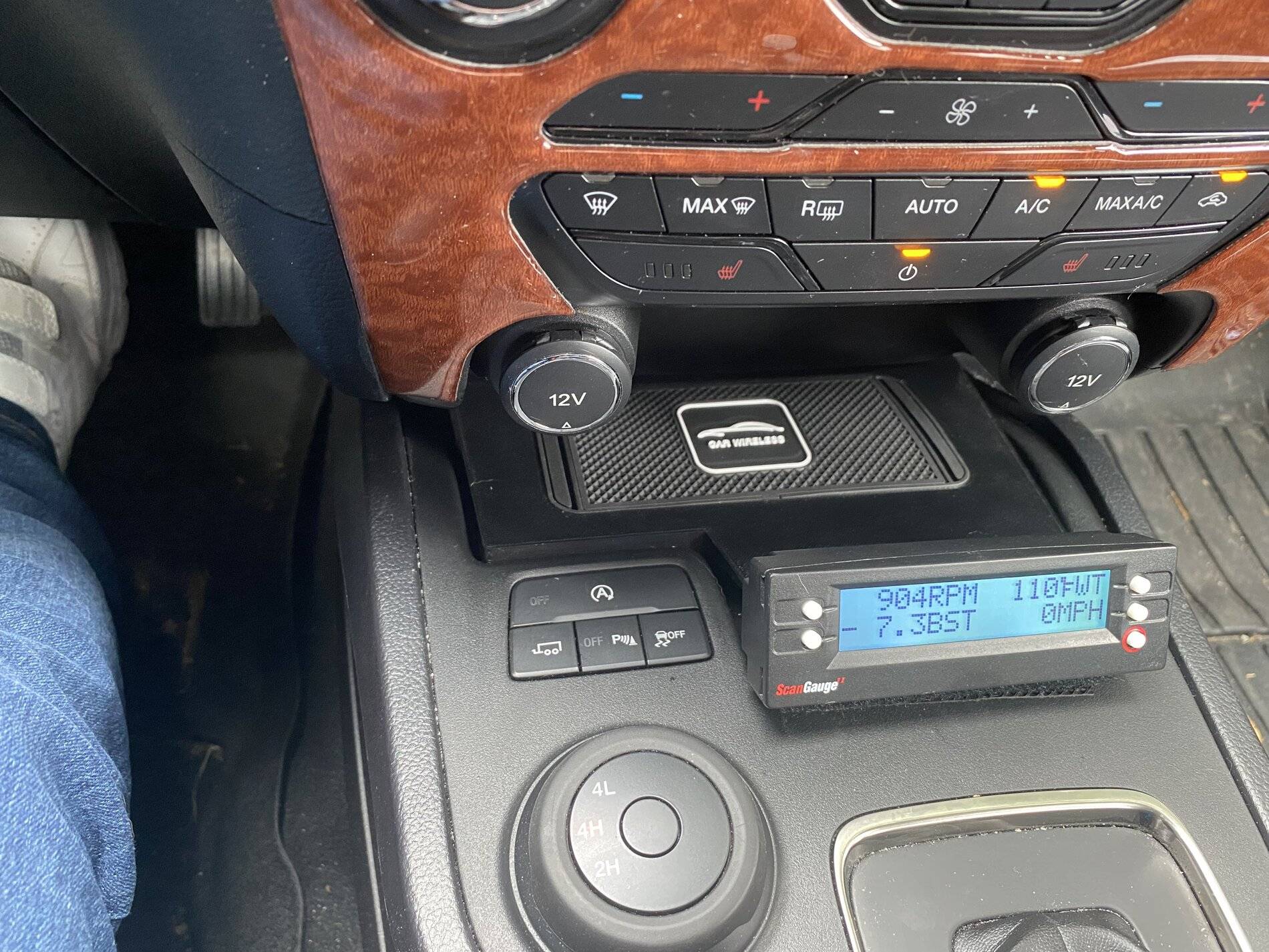

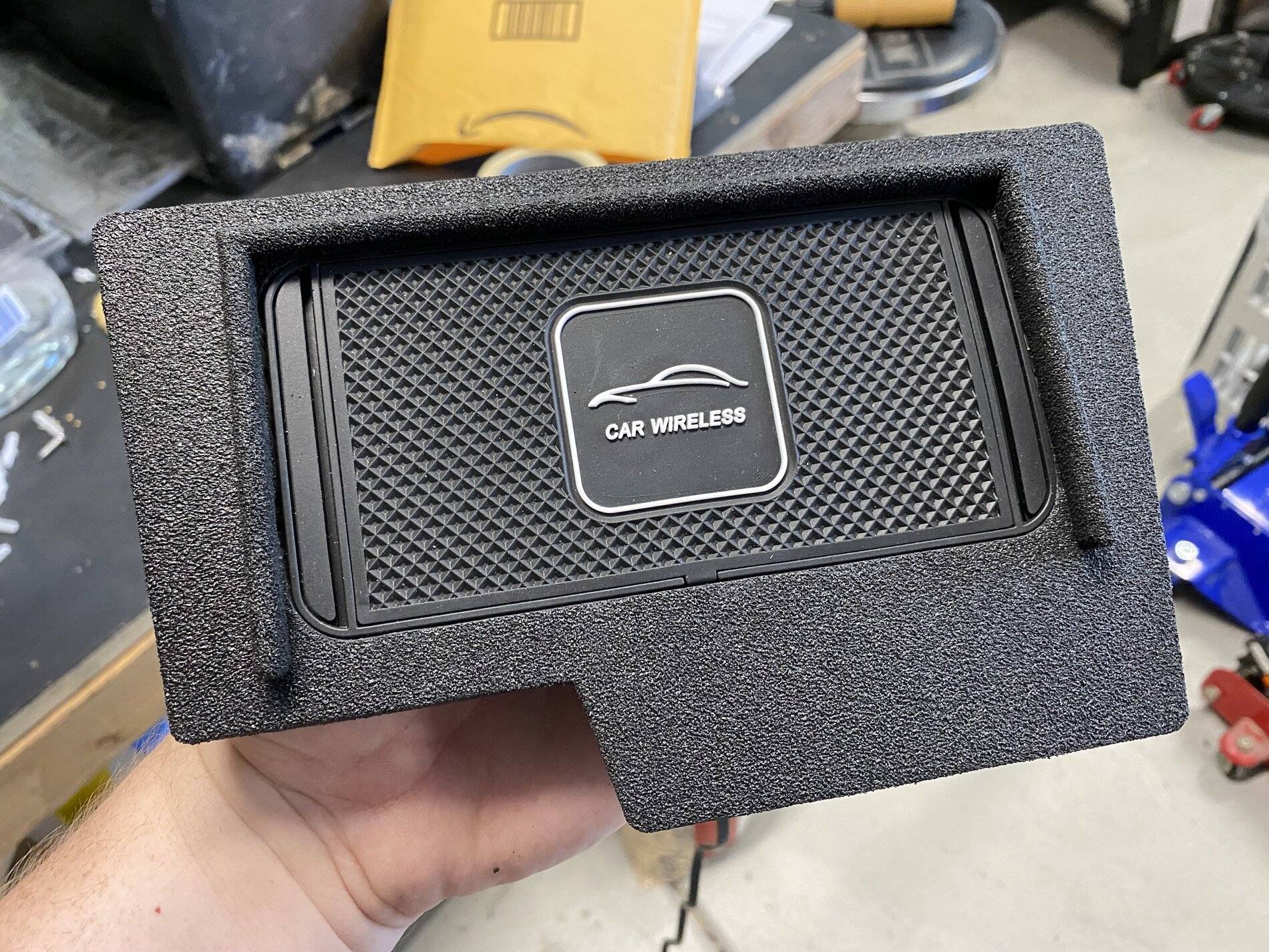

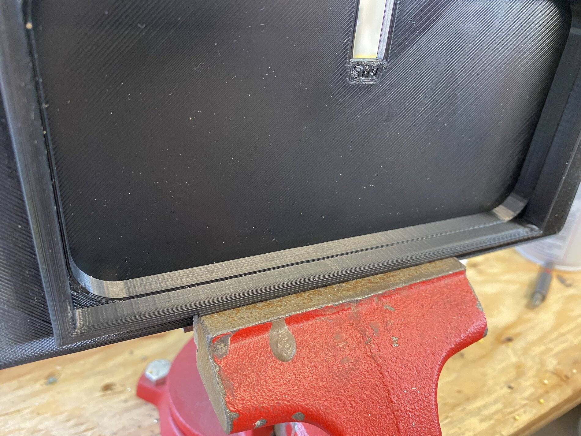

I received my insert and charging pad a few weeks ago from @DirkM - it fits really well, and charges my phone perfectly. I also added a wireless carplay module from Amazon and that has worked very well too. I never plug my phone in anymore in the truck - just hop in and toss my phone into the charging tray and off I go. Super convenient.

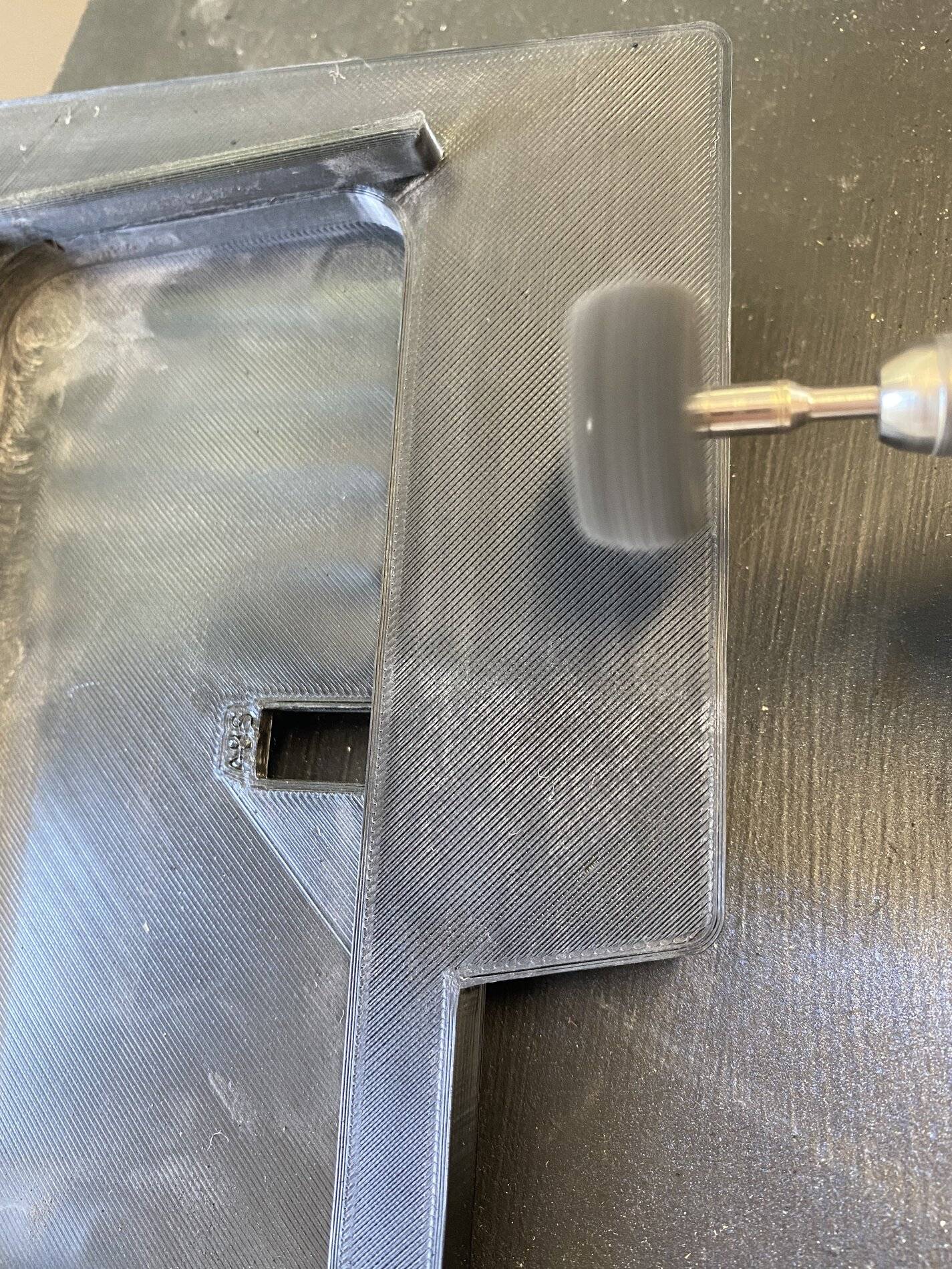

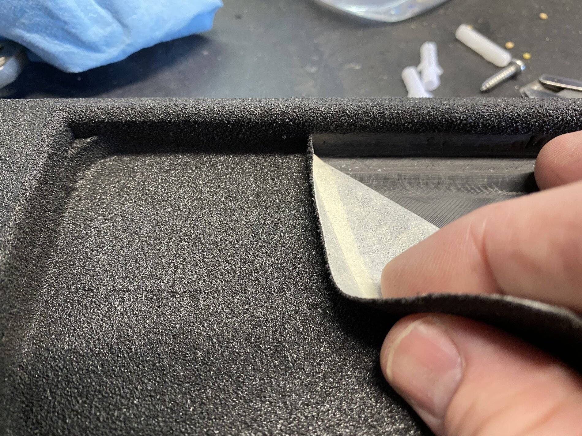

I also did not really love the crosshatch of the 3D printer, so last weekend I took the time to pull it back out, sand it down, and paint it with truck bed liner. Here are a few shots of the process and result:
First, here is the finished result:

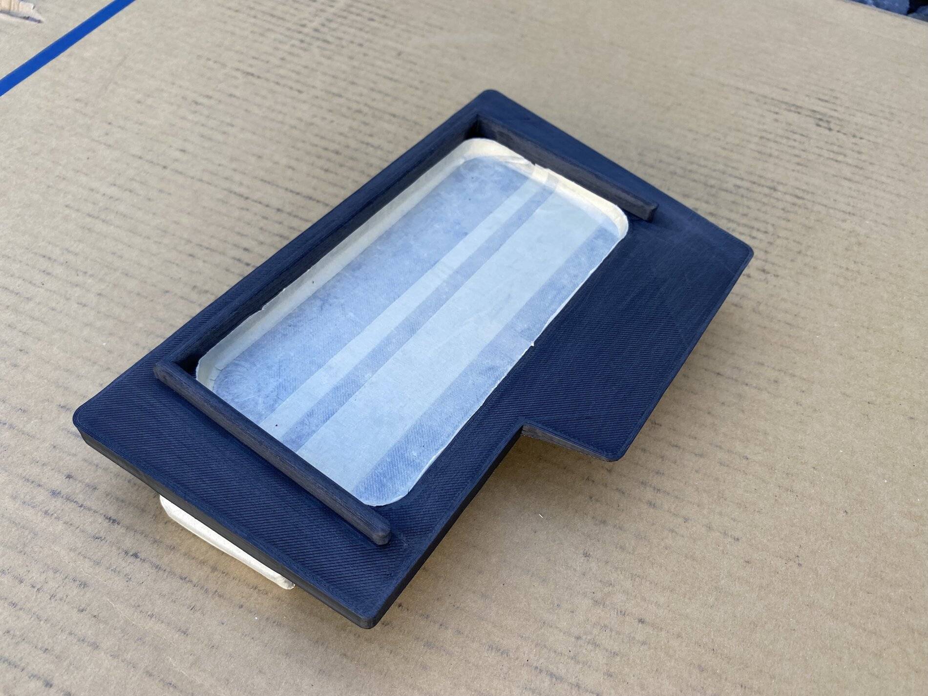

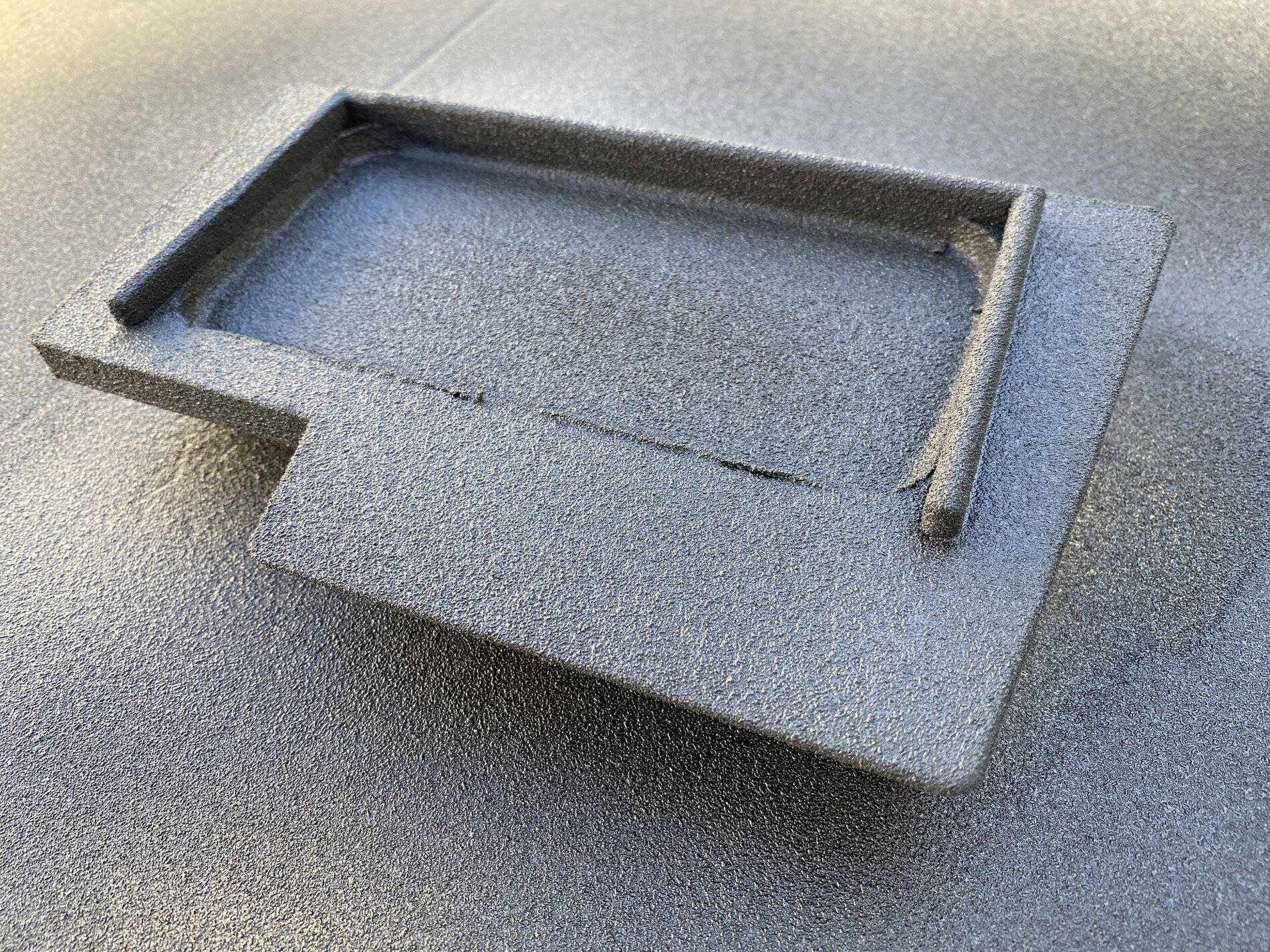

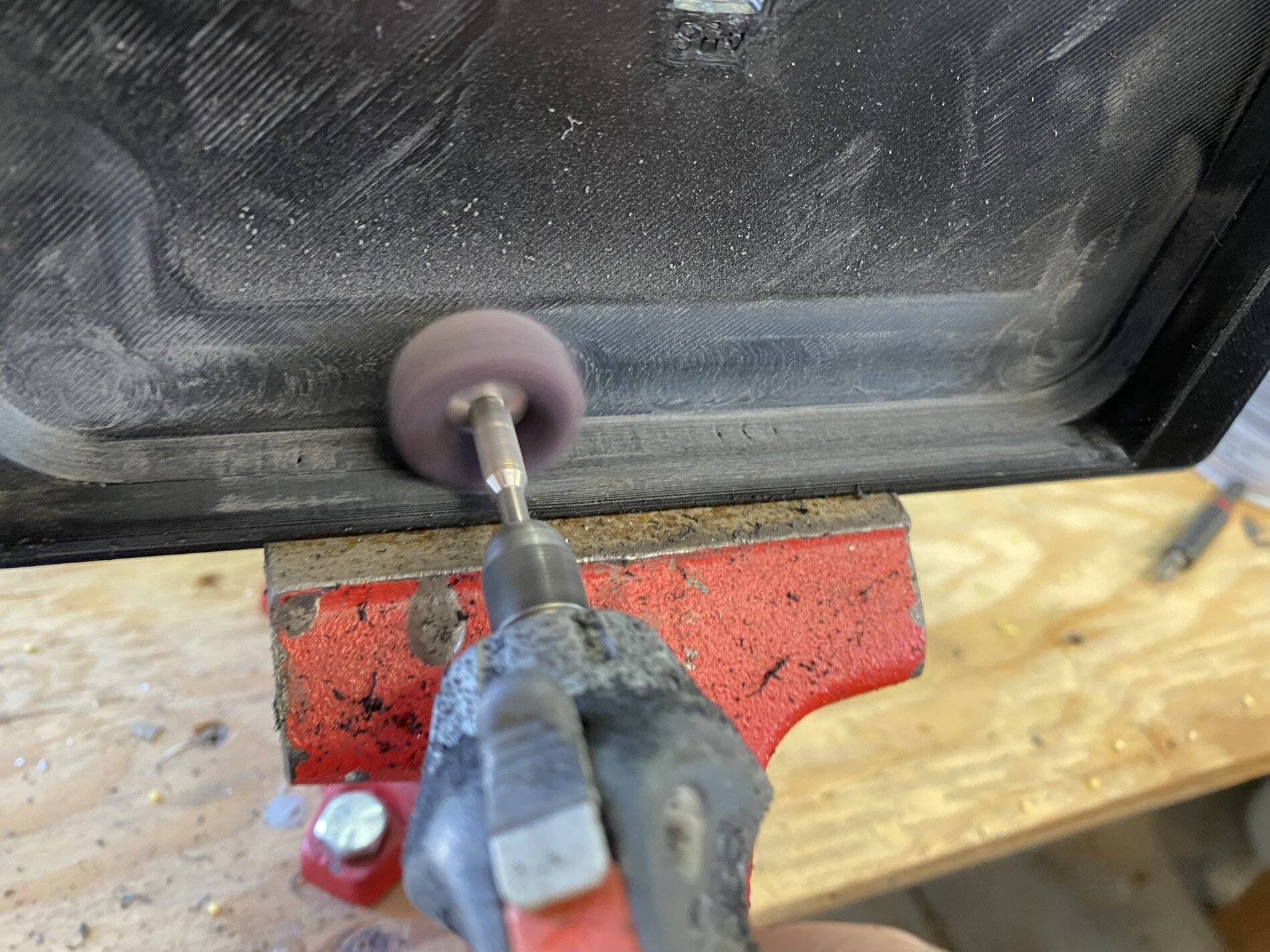

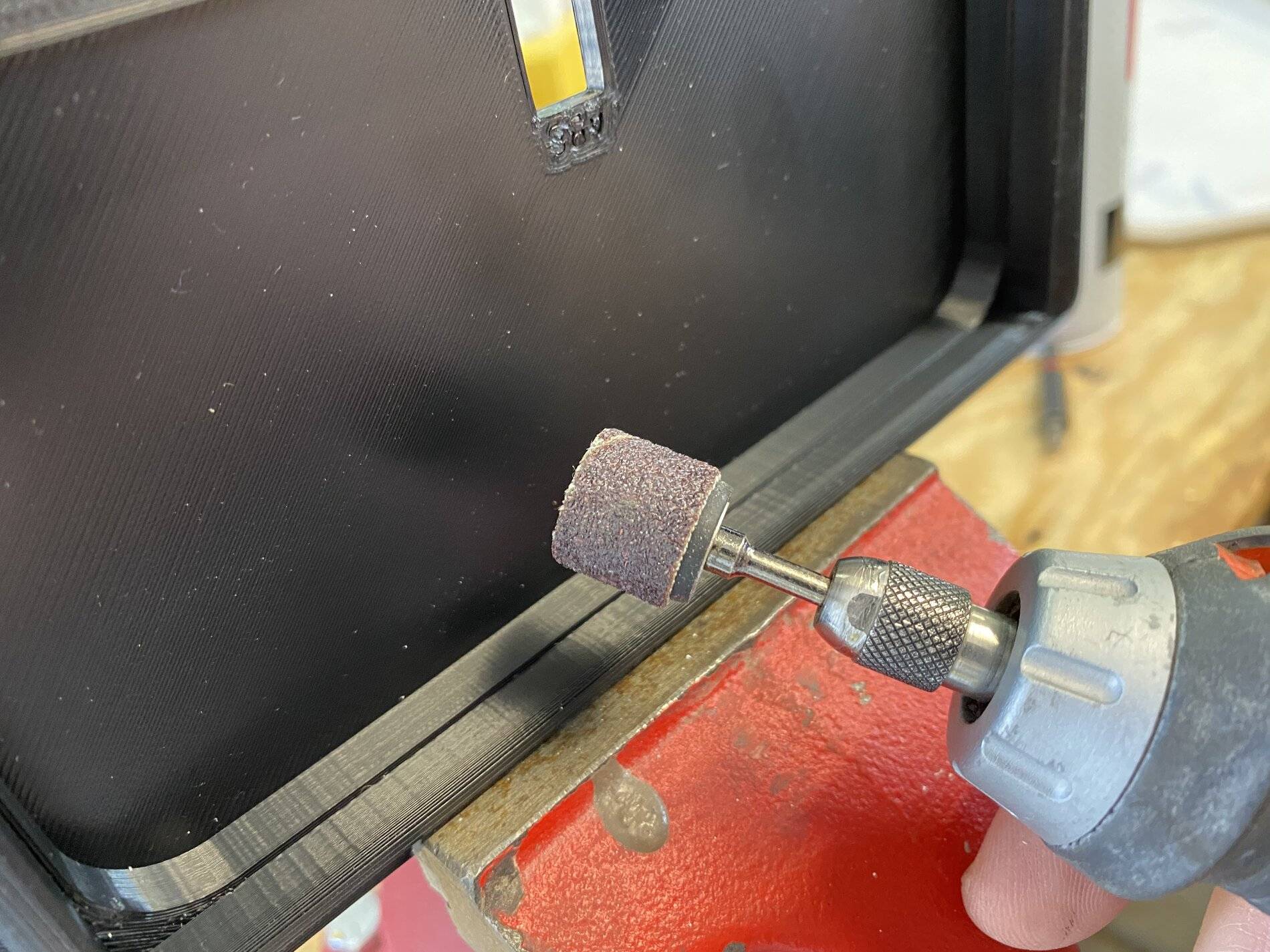

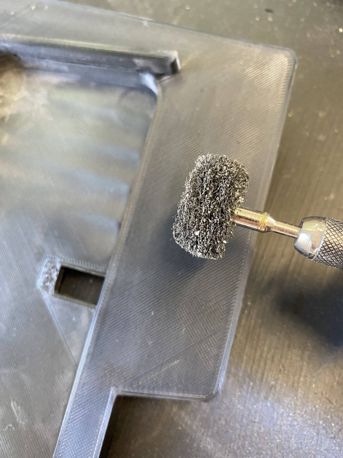

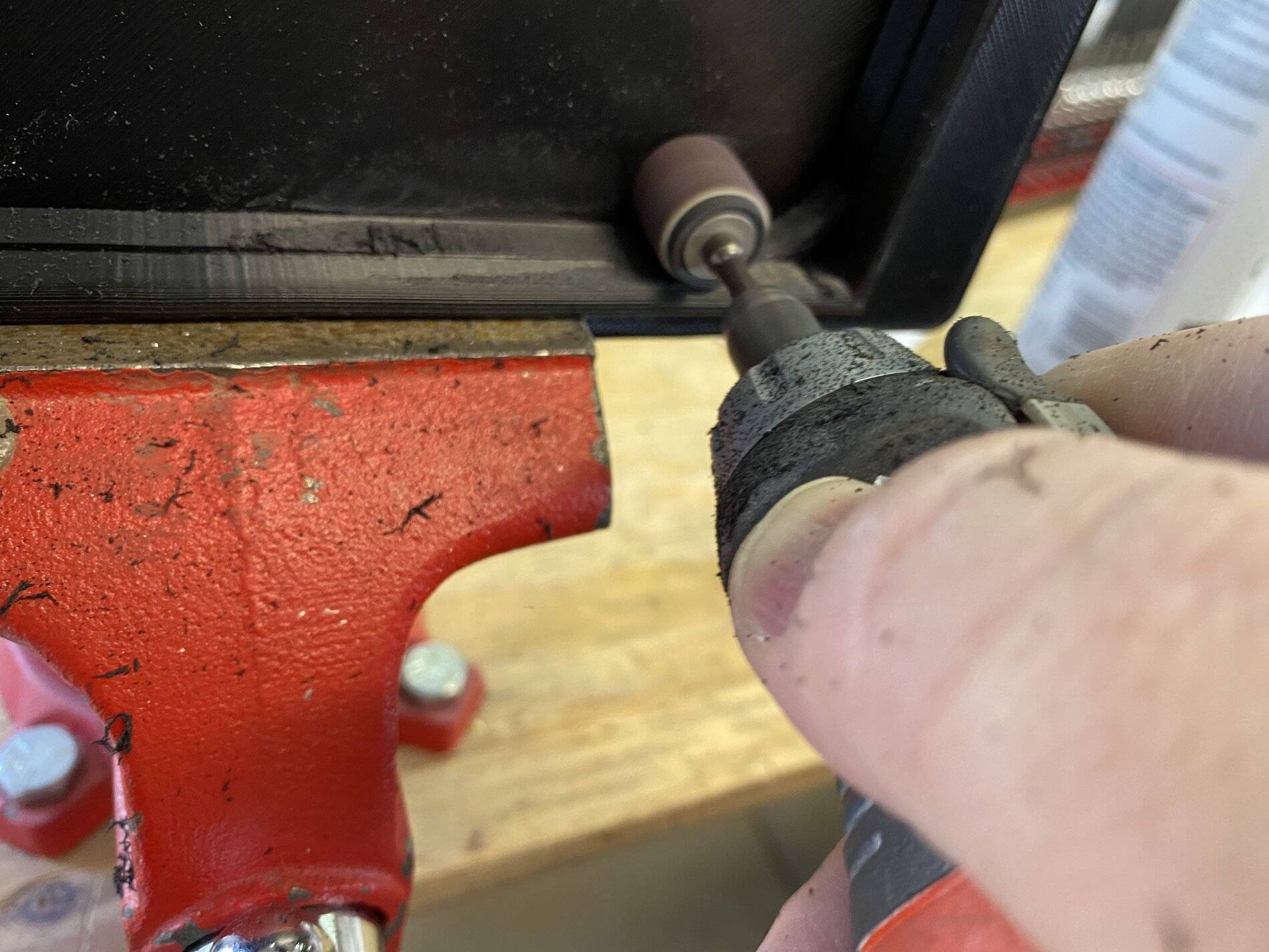

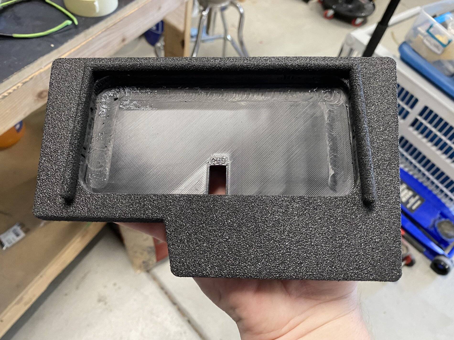

And here is how I started. The charging pad was just *barely* too snug for the hole, so it didn't fit perfectly flat, and sort of folded up a few millimeters in the middle. Certainly not a problem, but not perfect enough for me. I started by clamping the insert in my vice and using a dremel tool to open up the cutout for the wireless charging pad just a touch to eliminate this problem:

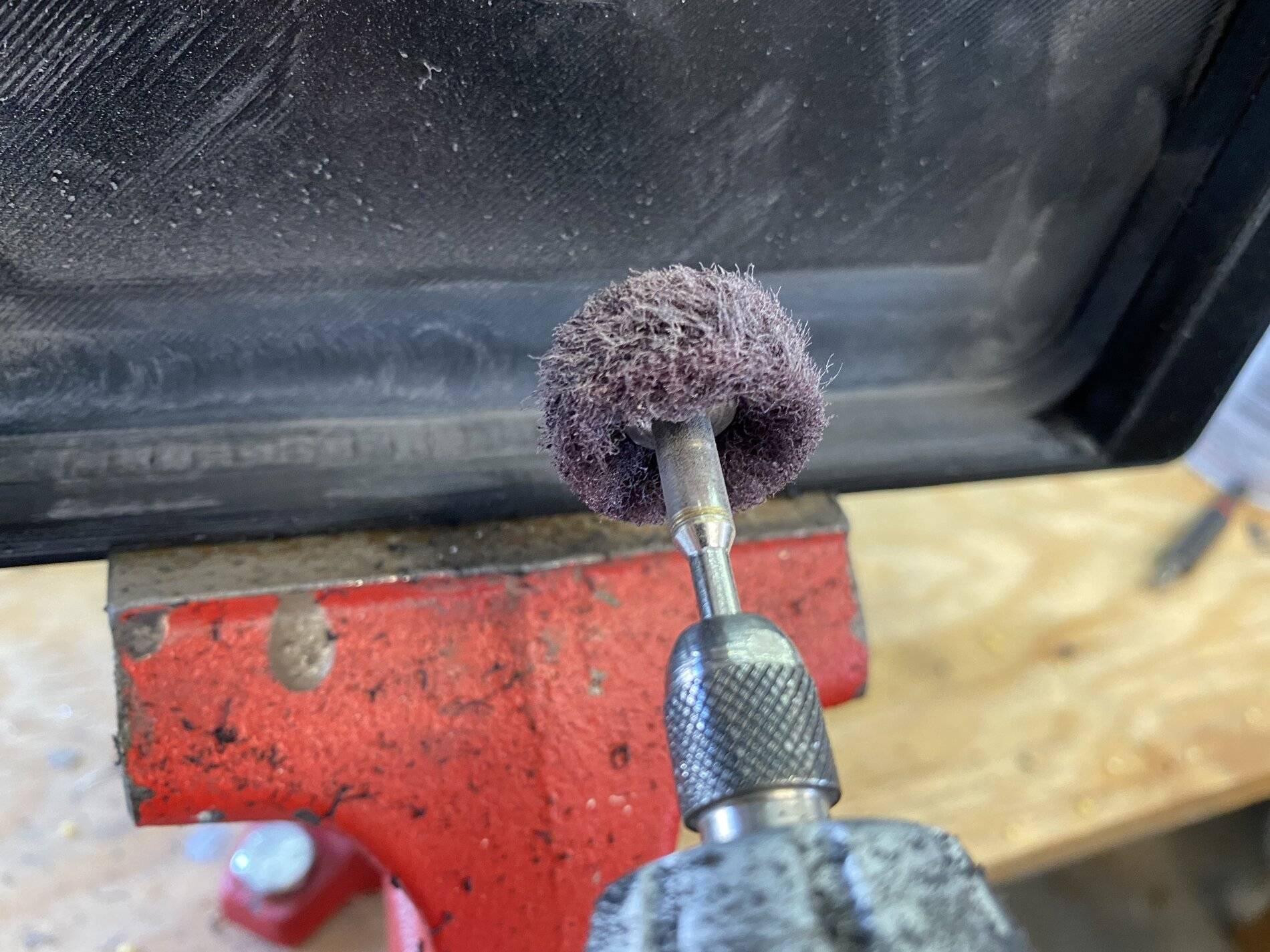

Then I changed to some sanding heads on my dremel, and smoothed everything out (and cleaned up some of the rougher parts left from my more aggressive sanding attachment) a bit more:

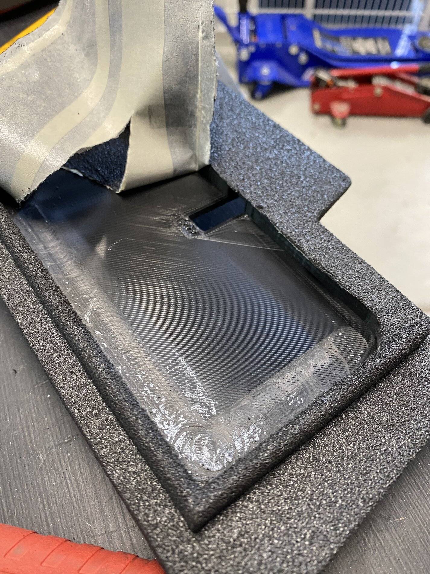

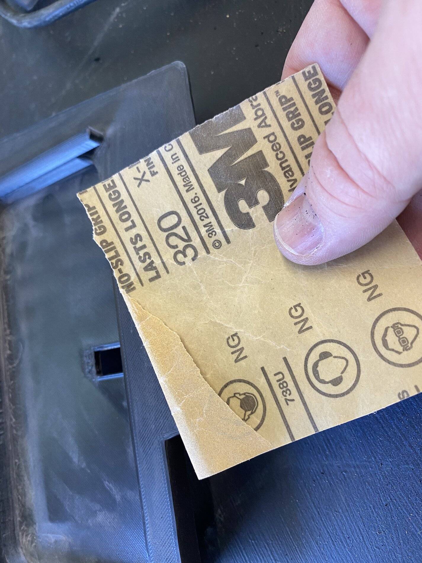

Then I switched to hand-sanding, first with 150 grit, then 320. When the sanding was finished, I masked off the interior area where the charging pad sits, and wiped it down as final prep for the paint.

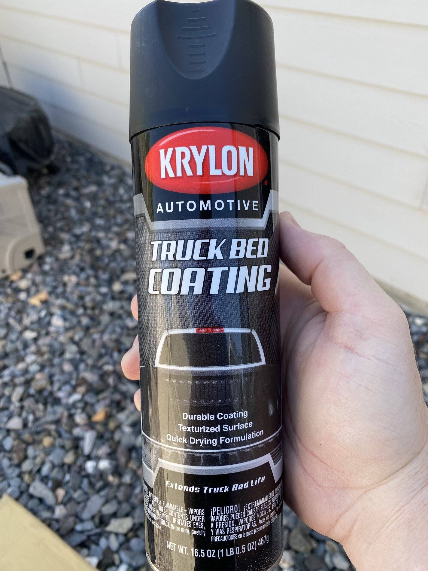

Here is the paint I used - this goes on REALLY thick, so spray it from farther away than you think you should, and do very quick passes.
Here it is, just after adding final coat:
Peeling off the masking after the paint finished drying:
Masking removed, ready to re-install charging pad:
Charging pad installed, ready to put back into the truck. The pad fits perfectly now, and while the texture of the paint is a bit more aggressive than the texture of the rest of the interior of the truck, I like it. If you are contemplating picking up one of these setups from @DirkM, I highly recommend it. It's great!

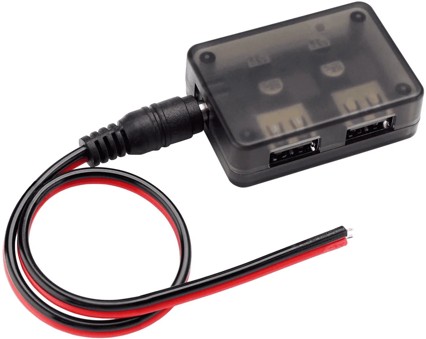

I ordered one of these last week: https://www.amazon.com/gp/aw/d/B072JC1DQF?ref=ppx_pt2_mob_b_prod_image
I see out of stock at the moment but thought it was pretty neat as it already has everything to draw power from wherever you like with the fused link, and you can then run the female USB connector in under Dirk's bracket for the charging pad.
I wanted to thank you for this idea. I combined it with a ATR fuse tap on fuse 35 to easily add a 3A 15W USB under the steering wheel.
