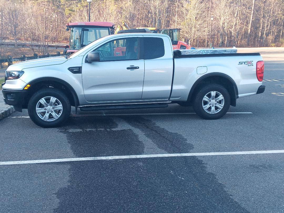

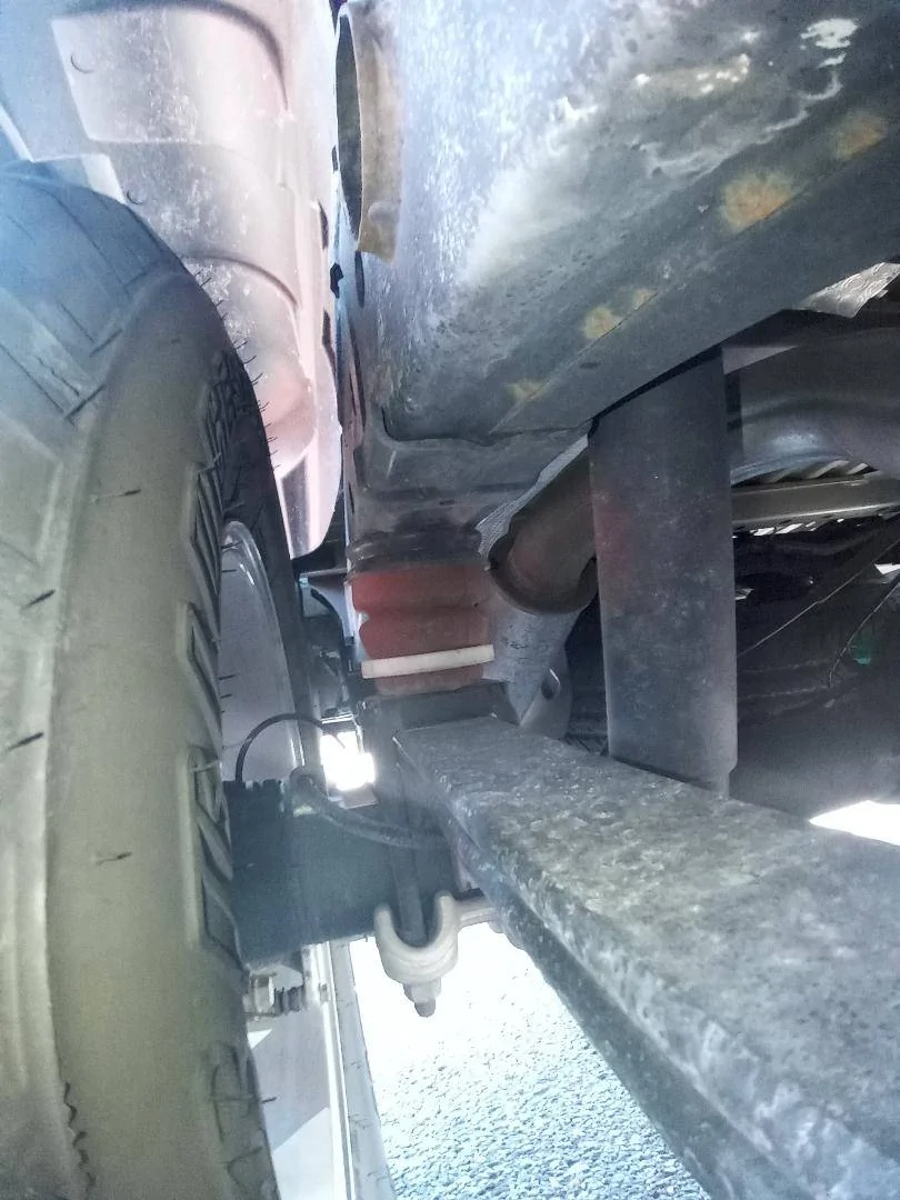

Muffin1
Sep 24, 2019
37
673
1,258
NJ
I picked up the vinyl flooring in 3 trips, 32 cases each trip @ 43.44lbs plus wooden pallet, so approx 1,420 lbs. Door jam says 1,696lbs so i was at about max payload(including me).
I definitely felt it but did not feel unsafe, I didn't realize it was on the bump stops till i got under and looked and took pics and i guess that's why i felt that bottom out feel when going over low points/dips on the highway.
It pulled amazingly getting on highway from the on ramp (i didn't push it to hard) and at one point i looked at the speedo @80 (wow) riding very nice i then backed down to 70, as for stopping it was ok, braking earlier and a little more pressure, it looks level now haha, so overall it handled it very well.
