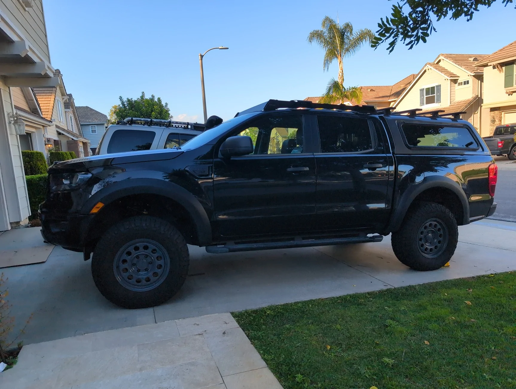

Got an alignment done, it seems to have settled well. It was crazy that I got 1.75" of lift between measuring it with the OME and then again as soon as I sat it back on the ground with the 5100s.
I'm assuming the ome springs had settled in.
On another note, with the icon uca's, caster is at 4.5°, equally on both sides. Anybody else find this strange?

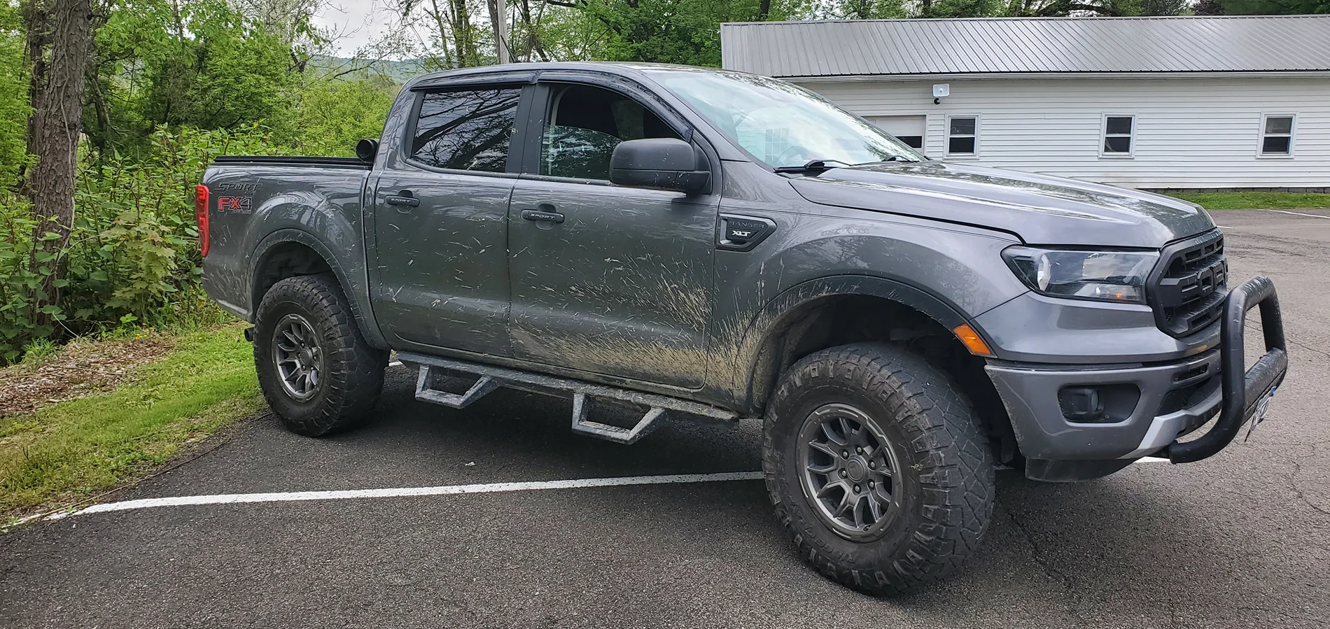

Hahaha, I'm on the cusp at 41. In my defense, I measured before and after, expecting a .1" lift and it was legitimately almost 2" taller 👀
I panicked before taking it out for a drive and parking it level. Getting an alignment right now, hopefully it's within spec since it looks great
I have noticed the first few miles after being on a lift it looks like the front is taller too?

Original OEM springs, I had maybe 20,000 mi on them when I took them off for the ome setup. I actually love the way the thing rides. The front is pretty level with the rear though now, which is not my jam. Makes me wonder if the ome standard rear springs have settled. Might be time for a little shackle lift in the back.

Greetings,
Wore out my OME suspension and just finished installing 5100s (with the stock springs of course) and icon ucas.
I have the 5100 set at the 2.5 in Mark, now installed. The truck sits a solid 2 in higher than the measurements I took before starting this job. 👀
