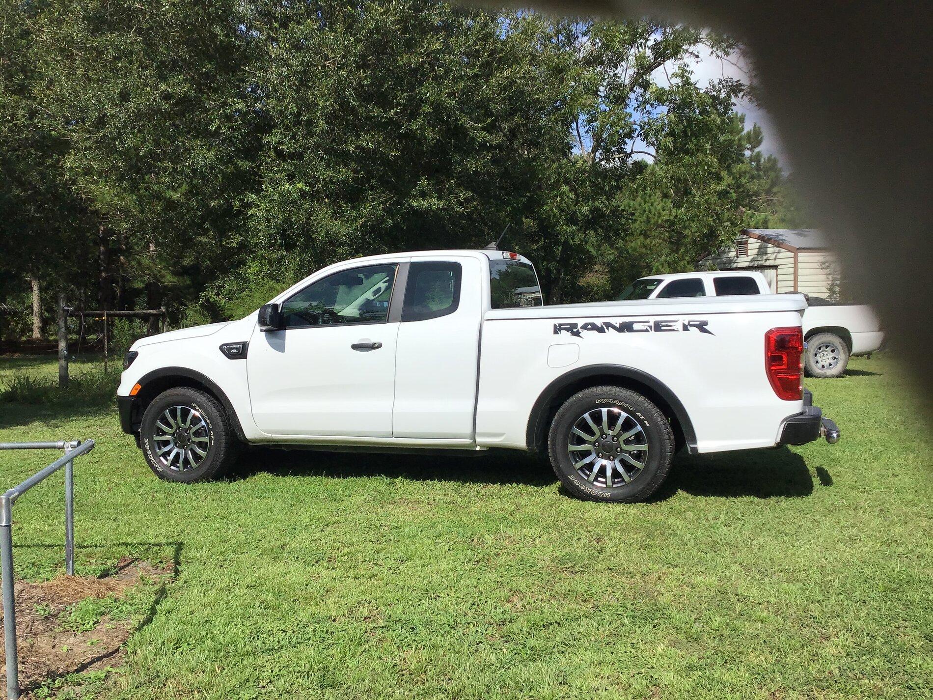

Speaking from experience, the 2" front, 4" rear lowering on my RWD 2019 is fantastic!
Much better access to the cab, bed and my euro Wildtrak roof rails.
And to my eyes, looks better too.

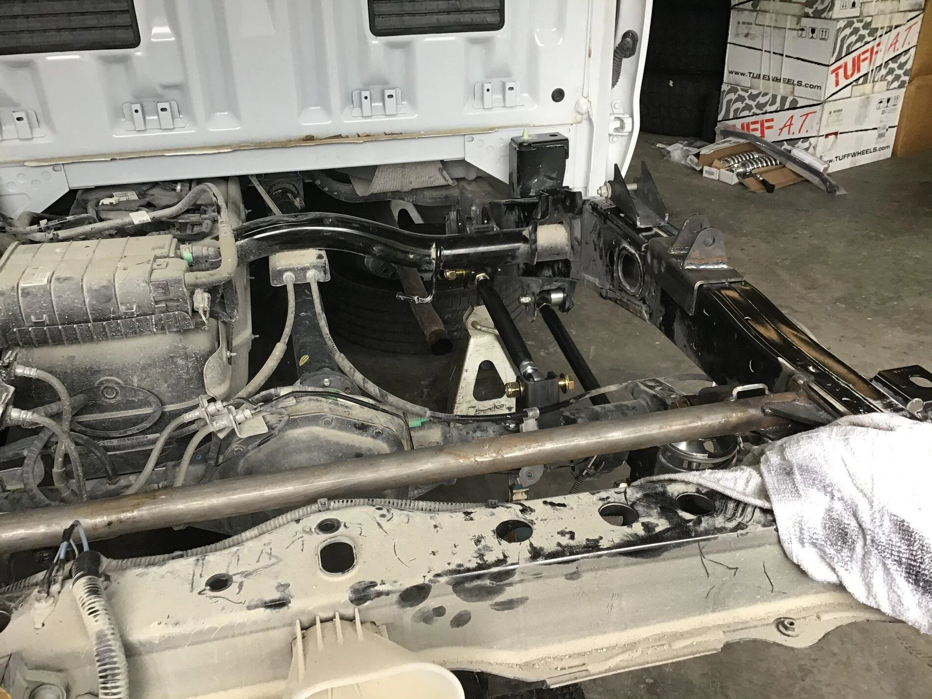

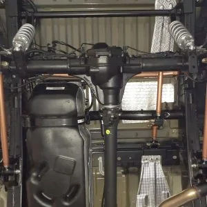

With the 4" drop, the original foam bump stops were resting on my "flip kit" and getting eaten up by the u-bolts even after trimming the stops by a few inches.
I replaced the OEM bump stops with Timbren rubber springs spaced off the frame by 19mm using HDPE I cut from a partial sheet I had. I get about an inch of sag before the Timbrens start taking any weight.
I've towed a couple fairly heavy loads including 1000 sq ft of sod and other than the lack of torque to get the load moving, had no issues. With 4500 lbs of sod on a 1500 lbs trailer, the tongue weight did give the Timbrens something to do but no drama.
If hauling that kind of load often, or over long distance, a weight distribution hitch would be preferable, but that goes for the Ranger lowered or not!
At least if still using the original springs, I don't think lowering has a negative effect on towing ability.
