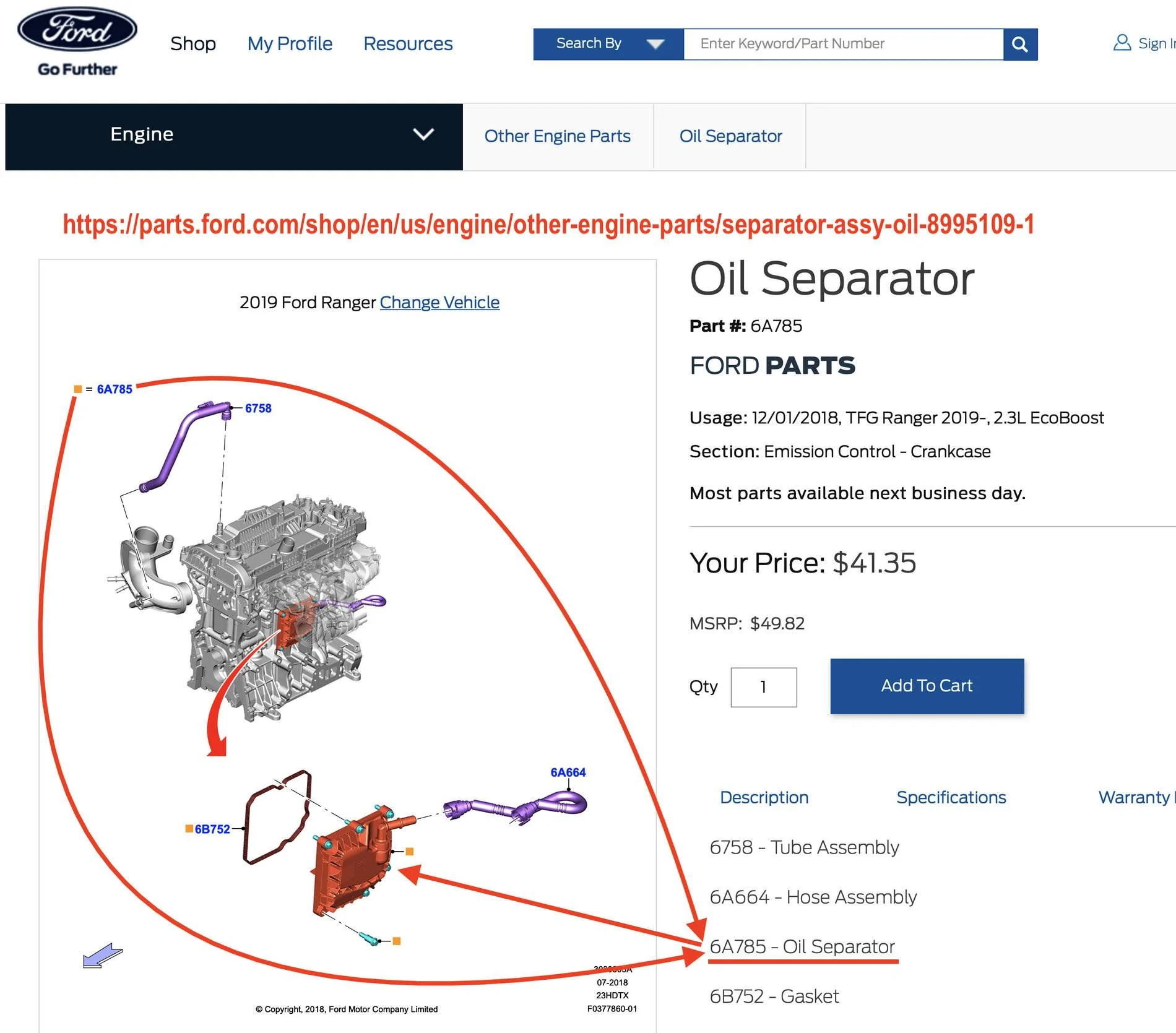

Then why is the catch can not standard equipment. I'll wait...
There's one on the drivers side of the engine, it's empties into the oil pan when it fills up. How great a job it does is the only thing up for debate.

That may be an oil separator, but I can tell you now that my UPR catch can catches a whole lot of stuff that comes directly from that port. If I am not mistaken that port is the built in PVC system as well. I actually own that part in my stash. And after looking at the service manual, it will be a bear to replace tucked up under the intake manifold.
It was hard enough just swapping hoses for the catch can. Very tight area to work in.
I'm on your side, I have a J&L downstream of the built in separator before it goes back into the manifold and it grabs a little of everything.
Some fuel, some condensation, some oily gunk... none of which do I want sitting on the top of my valves.
If it's a snake oil product why is there one built into the side of our D.I. motor? I'll wait.
