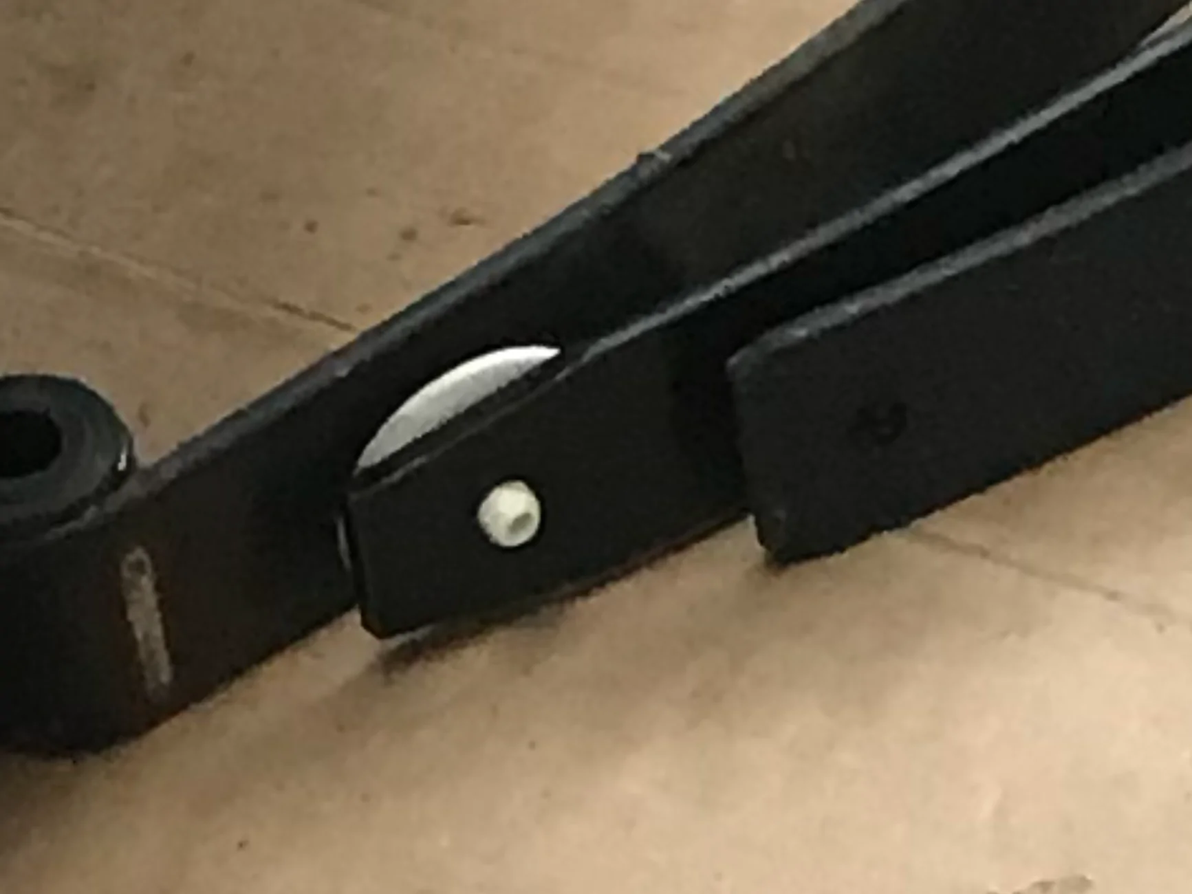

I'm running ICON Multi Rate Leaf Pack with the "Add a leaf". Don't run them, I bought them prior to seeing all the reviews about them squeaking. All they do is squeak non stop. It doesn't matter that they're torqued to spec it doesn't matter if you torque them lifted or not. Doesn't matter if you grease the hell out of them. They will squeak with every slightly bump or wobble of the vehicle. Parking lots sound like I'm driving an old rusted beater around.
Aside from that they work perfectly...
Someone on here tried to warn me but I'd already received them and others said they had them and that they were fine.
When I have a bit more money that I don't want to spend on other bits of kit I'll swap them.
If you want functional and quiet go with Old Man Emu leafs instead.
