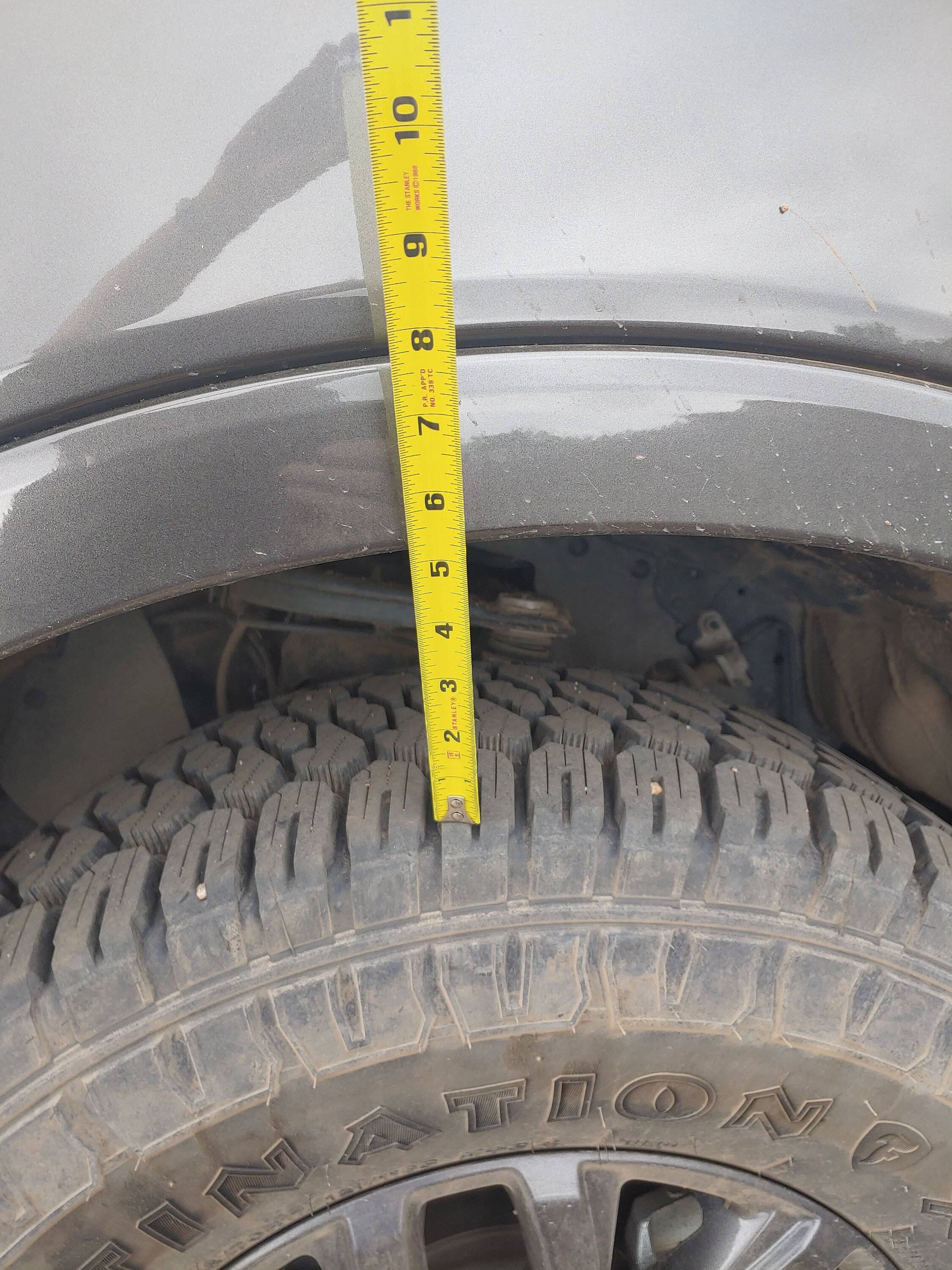

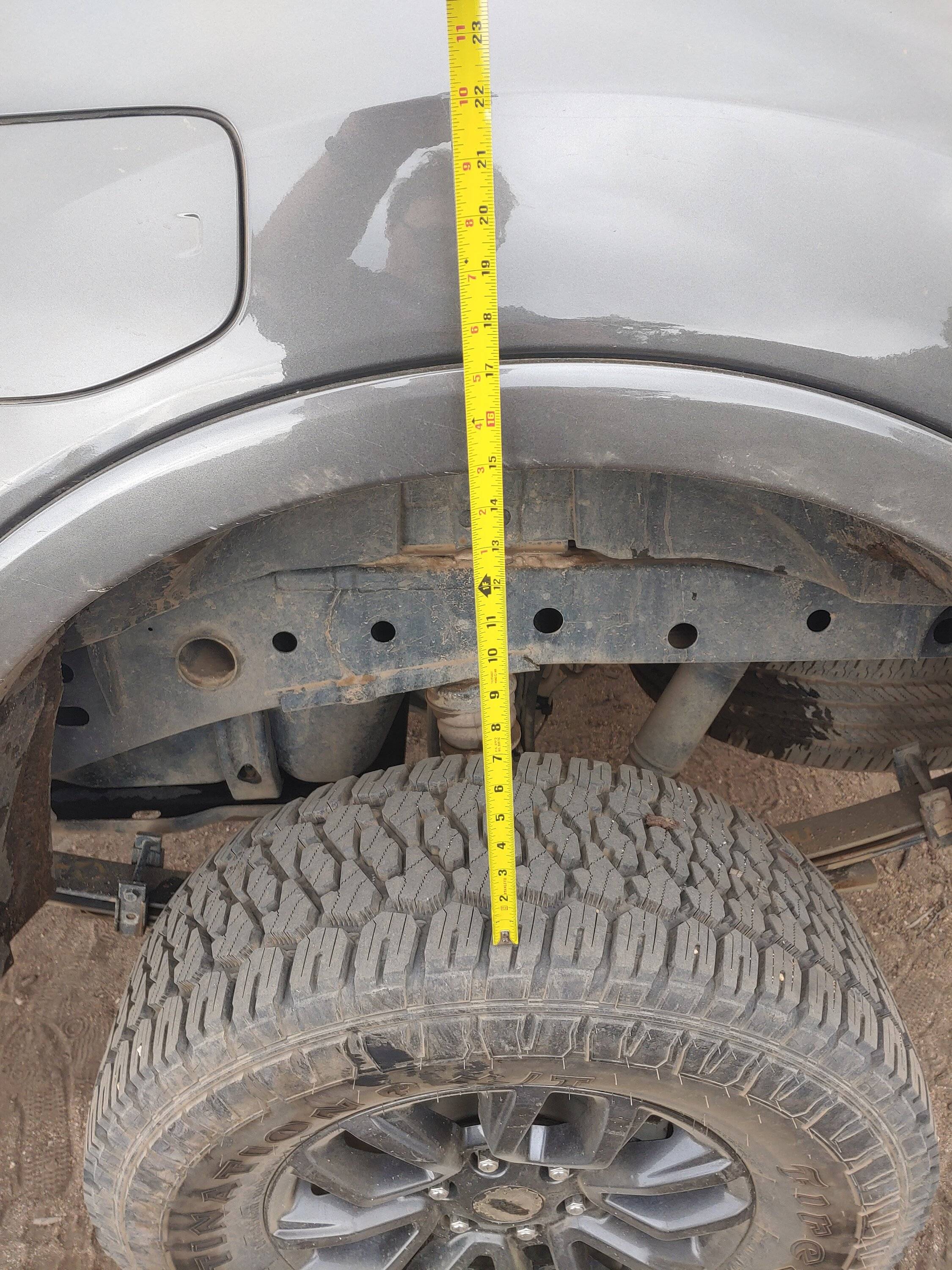

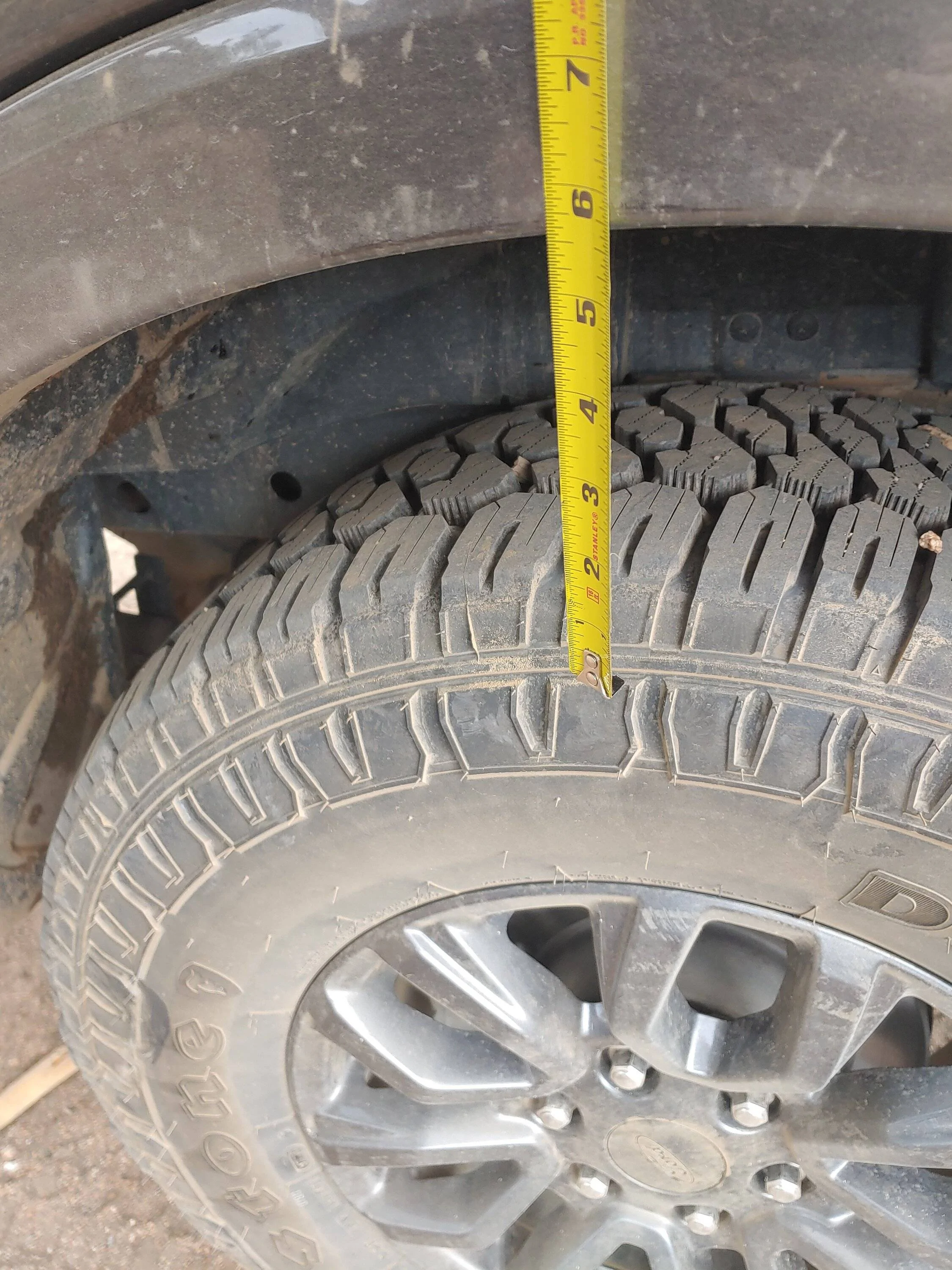

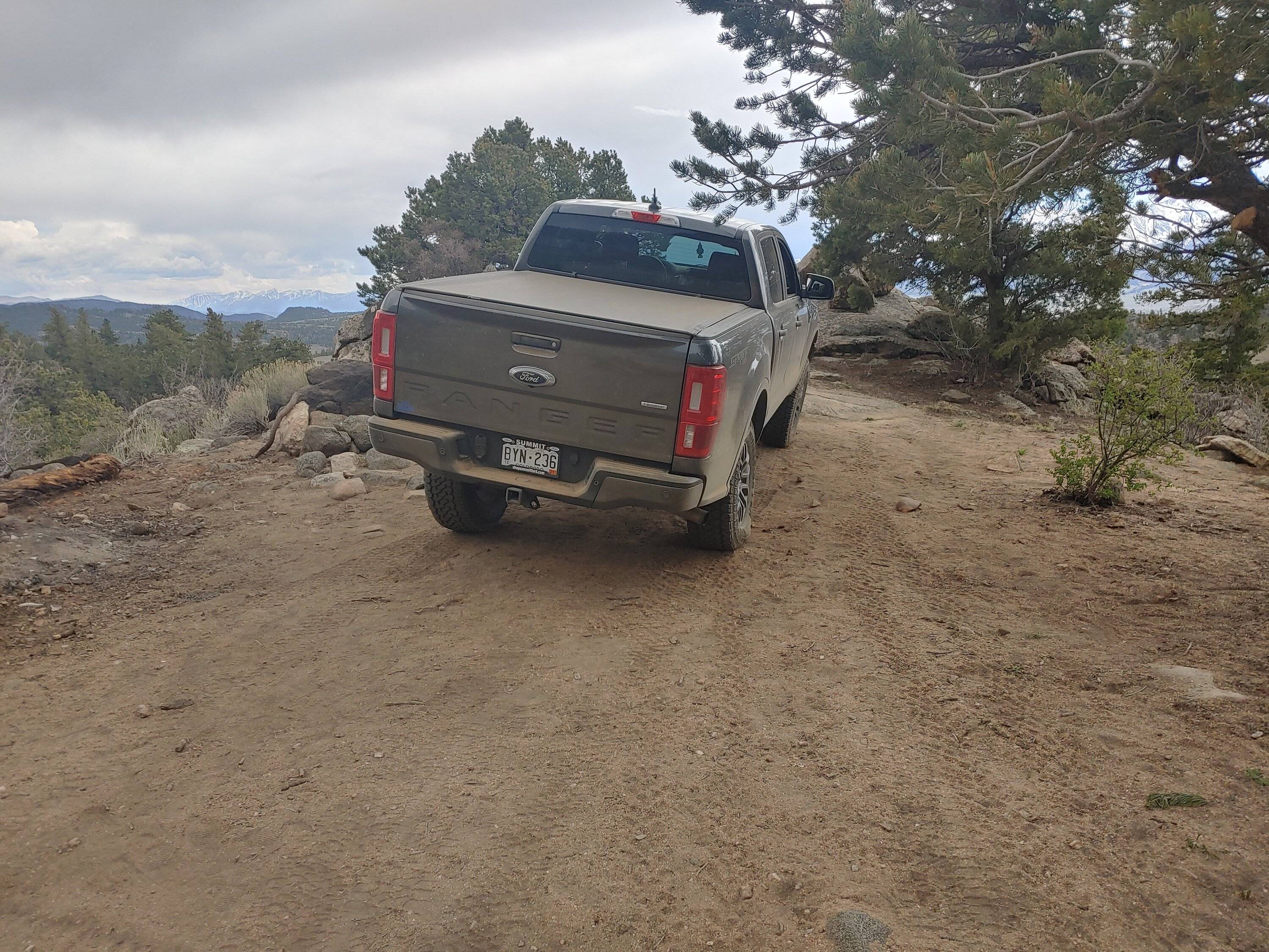

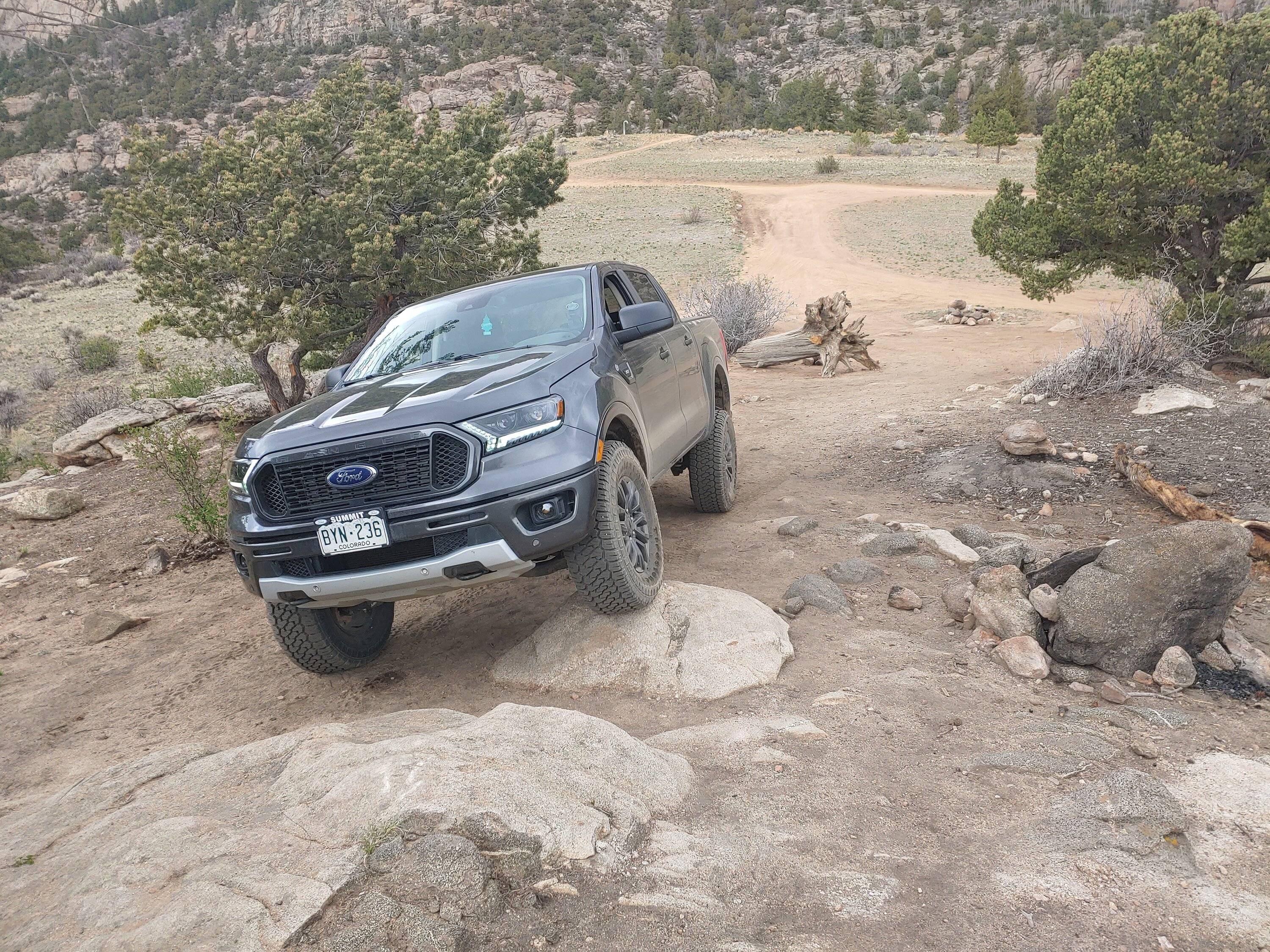

Now that I'm thinking about it since you want proof, here are some pictures of my truck damn near fully flexed with all 4 touching the ground(and a rock). Enjoy!!![]()
I will also add one more thing. The leafs in the deaver leafs for the Ranger are the same thickness compared to the OEM and Old Man EMU. Different material? Possibly, but they are the same thickness per leaf. That put the OEM leaf pack at 1/4 inch, Old Man EMU basic at 1/2 nich and Deaver at 1 1/4 inchI'm just curious what you are basing these "facts" on. The benefit of thinner lower rate leafs in a pack gives a better ride quality and also allows them the flex up and down better. Now these rangers may have something else the could limit that down travel as I'm not 100% sure on that prt as of yet. Like I said once I have the deavers in hand and do the install we will see the numbers. Every other vehicle I have had deavers on not only rode ALOT better on and off road but also flexed and had more down travel. The lack of arch on them doesn't negate the fact they can't droop out on down travel.

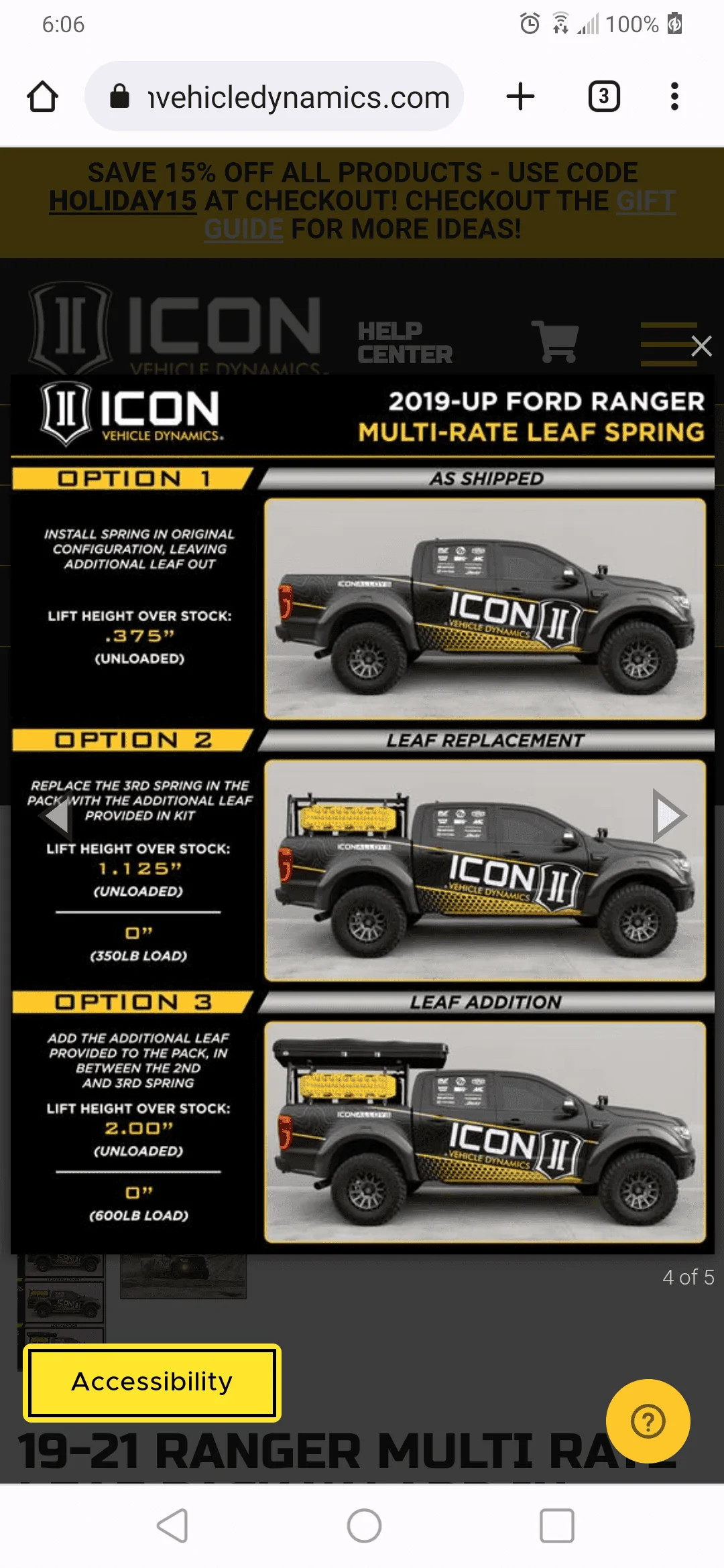

The graphic you posted says that when outfitted with all it's leaves the Icons will provide 2" of lift unloaded OR sit at factory height with 600lbs of load. It does not say that 600lbs is your new payload capacity anywhere. AT ALL.
