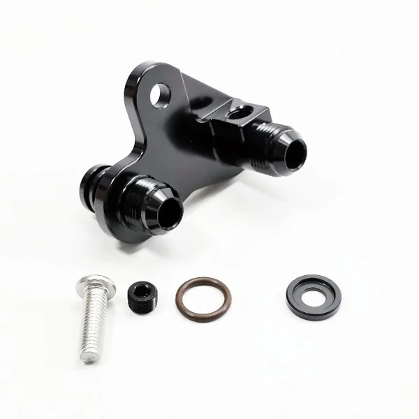

The sump will dump around five quarts, leaving seven quarts in the T/C etc. The flush seems pretty unintrusive. The cooler assembly is removed and an adapter plate for the flushing machine is attached in its place. ...looks pretty monkey proof. I'm willing to take the risk to get a clean, flushed valve body before I add my LubeGard Platinum.
I just paid $350 for a flush. I saw that adapter but wasn't sure if it would work. If you try it keep us updated.
