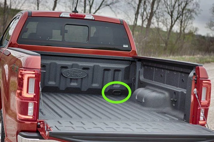

The dealer I bought my car from sprayed right over the bottom drain holes of the bed while installing the spray in liner. I tried to cut the liner and pry the covers off and ended up breaking the plastic clips. Does anyone know a part number for the plugs for those holes?
Keith
Photo from online for reference.

They are not drain holes.

If it has the Ford logo on the bulkhead, it was done at the factory.

Also that is not a dealer spray in. That was done at the factory. It has the Ford logo on the bulkhead.
That's not my truck, just found a image online to use. I have a black truck with a dealer spray in. Regardless of what the hole is called, does anyone know a part number?
Thanks for the information. Do you know what it is called or used for so I can search for the part? Admittedly I'm not as handy as some of you guys on here, still learning.

Threaded Cover Plug
Part #: 99277B76

$15.76 for 2 and free shipping, if you register on parts.ford. Just pried mine off after bed coating. May be reusable as most tabs are ok. Drain plug covers as they are called in some photos or Threaded Cover Plugs(threaded??) give access to help cleaning out space behind bed panel from leaves, mulch, etc. That and a long fiberglass rod!
