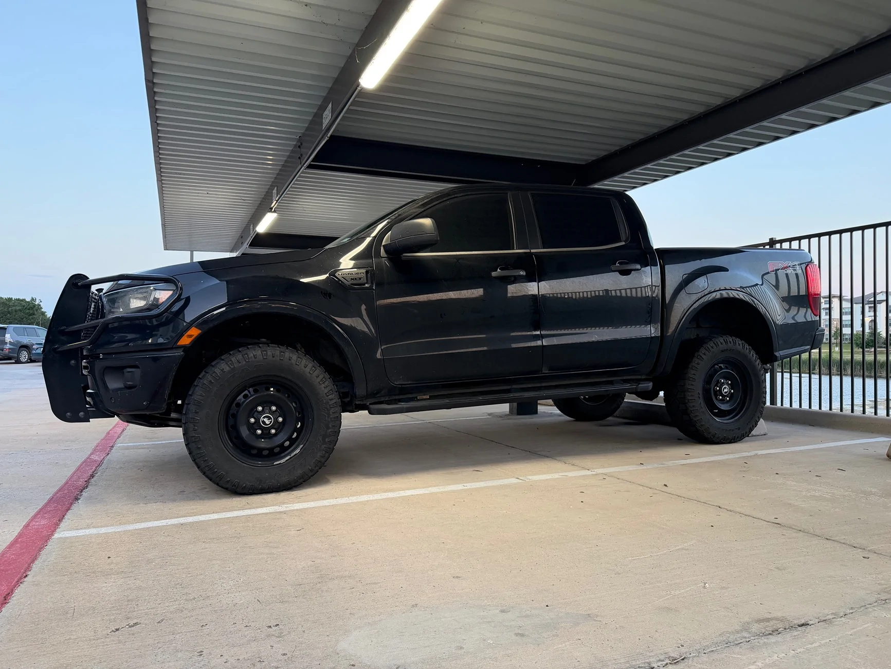

Contemplating an upgrade the stance/ tire size
Currently on:
6112 Bilsteins up front (2.9” Lift
5160 Bilsteins in the rear w/ the icon leaf pack (2” Lift)
265/70/17 Goodyear Wranglers
17x7.5” 55mm offset Bronco Steel Take offs
I’m thinking of going to a 3.5” shock in the front, maybe an Eibach Pro Truck coilover. As well as stepping up to either a 285/70/17 or 295/70/17 tire. Is anyone here currently running the Eibachs?

33s would look pretty cool. Plenty of folks on the forum run those shocks and swear by them. Solid choice. Always a best practice to do all four corners when upgrading shocks. What UCAs do you have in mind for that 3.5” level?

I have an aluminum spindle on the passenger side and my factory cast spindle on the driver side. So probably the uniball Camburg ones since they work with both types of spindles

You won the lottery. Your truck is a unicorn!
You have the actual truck where they made the change from aluminum to steel knuckles. What was your build date? You think Camberg will sell you a set with one UCA of each type. The taper on the ball joints are different.

It's an early 2020, sat on the lot until late 2020 when I bought it. Got in a minor wreck in May of 2021 that broke the passenger front oem wheel and suspension. Ford was dealing with supply chain issues. They only had the aluminum knuckles available, and I needed the truck back on the road, so they stuck it in there. Would be great if someone would sell me one of each... It's really the only reason I haven't upgraded the UCAs

Update: Ordered the Eibach pro truck front coilovers
