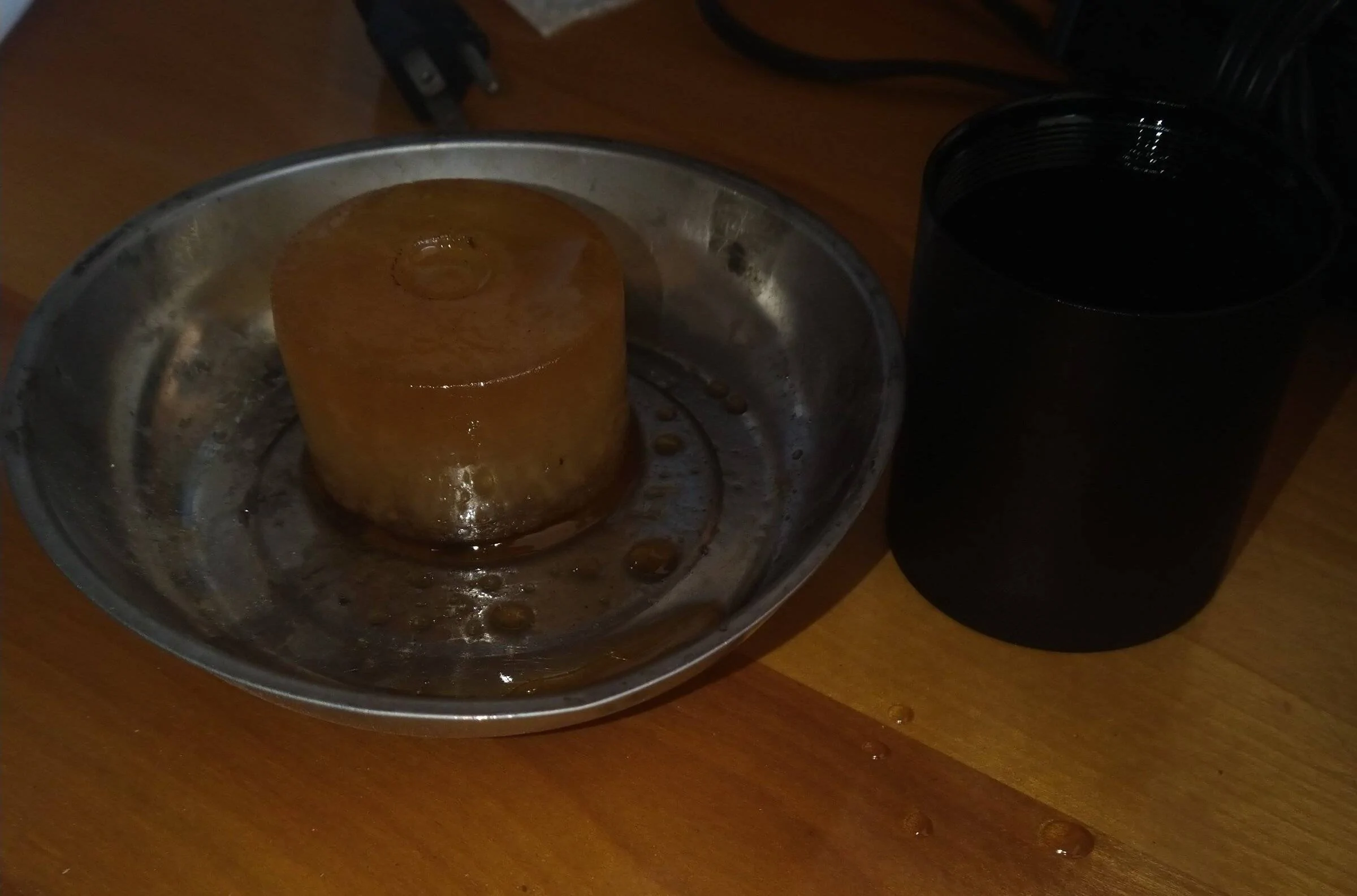

Cleaned a nice big chunk of frozen schmeg out of the catch can. I'll be happy when the nicer weather hits and I can get this thing off my truck. Great idea in theory, but not the best IRL.
Frozen? So, it’s catching mostly water vapour? Help me understand Jim - I get the idea behind these things but I’m curious about that frozen “puck” - see what I did there?

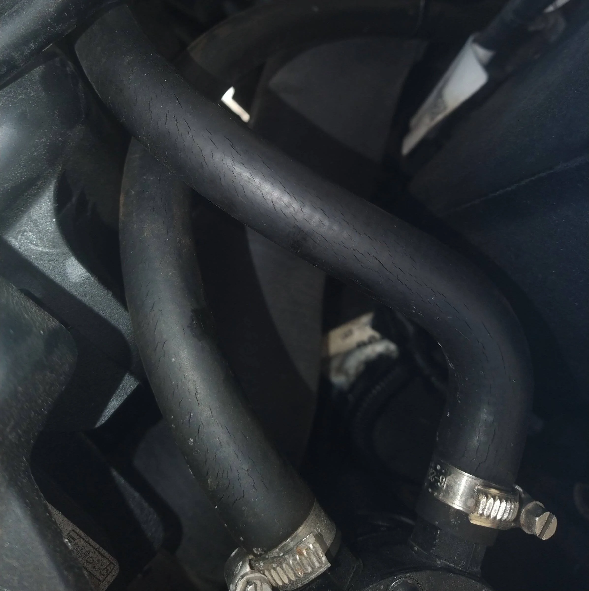

Yes, winter gas in Canada will fill the can over the course of a single tankful, primarily water/gas mix. Summer gas yields next to nothing over several tankful's. Plus the hoses are cracking and will need to be returned to stock. Like I said, solid theory with poor execution.

It would seem so. Strong fuel smell but it's still frozen after being in my garage like that for about 22 hours. There is a little oily residue which didn't freeze.

You can't easily see where the hoses go, it's kinda behind the LF wheel just inside the frame rails. Nightmare job. If you are thinking about one, my advice is to reconsider your position. The hoses haven't made it to their first birthday on the truck and are failing. It's not worth the aggravation.
