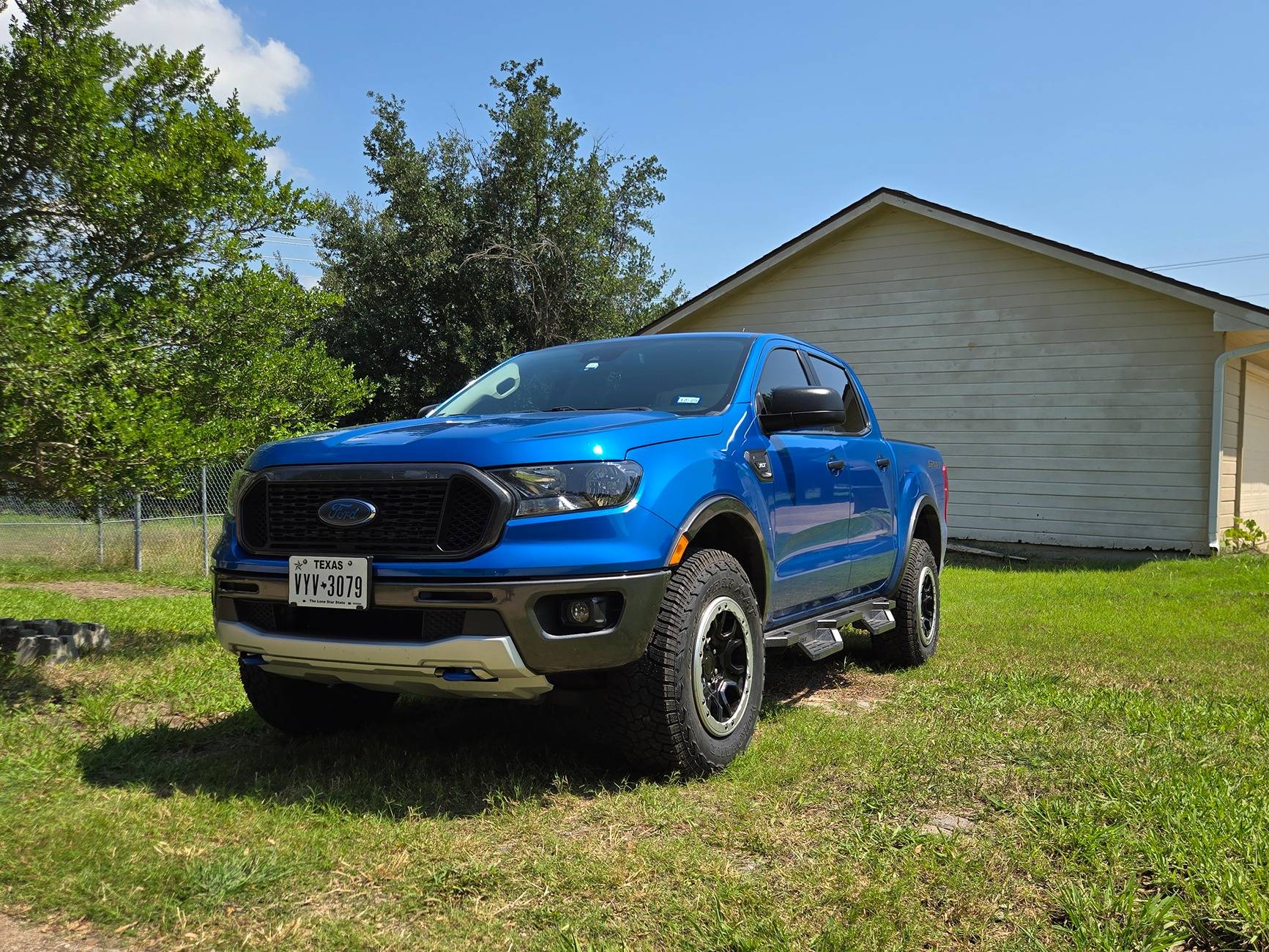

After reading wayyy too many tire size and wheel threads, I installed a new set of wheels and tires today.
Method MR 703 - 17 x 8.5 +35 offset
BFG KO2 265/70/17 LT load range C
I have stock FX4 suspension, and I had the slightest rub on the drivers side at full lock in reverse. I loosened and nudged the crash bars forward, and no more rub.

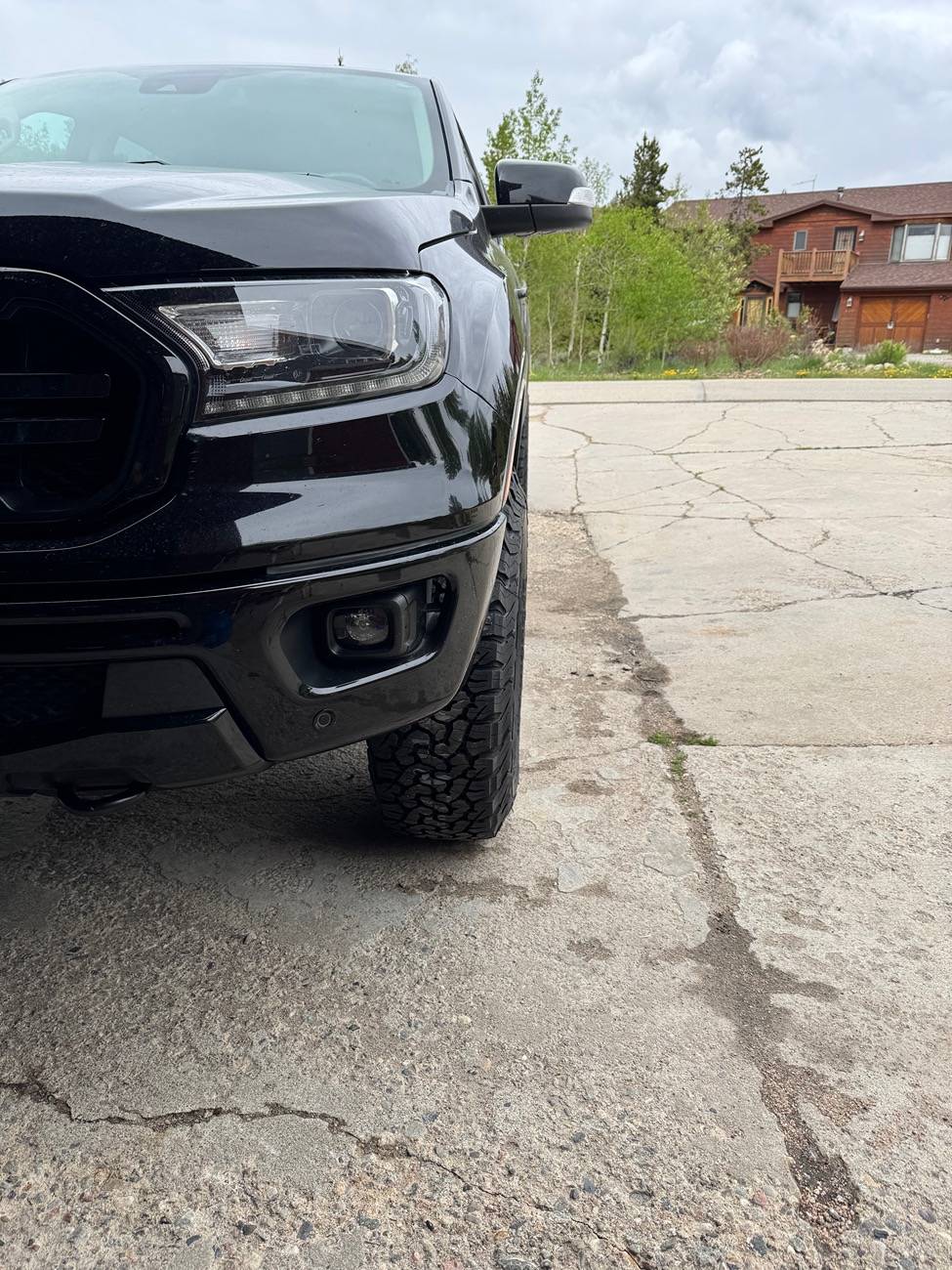

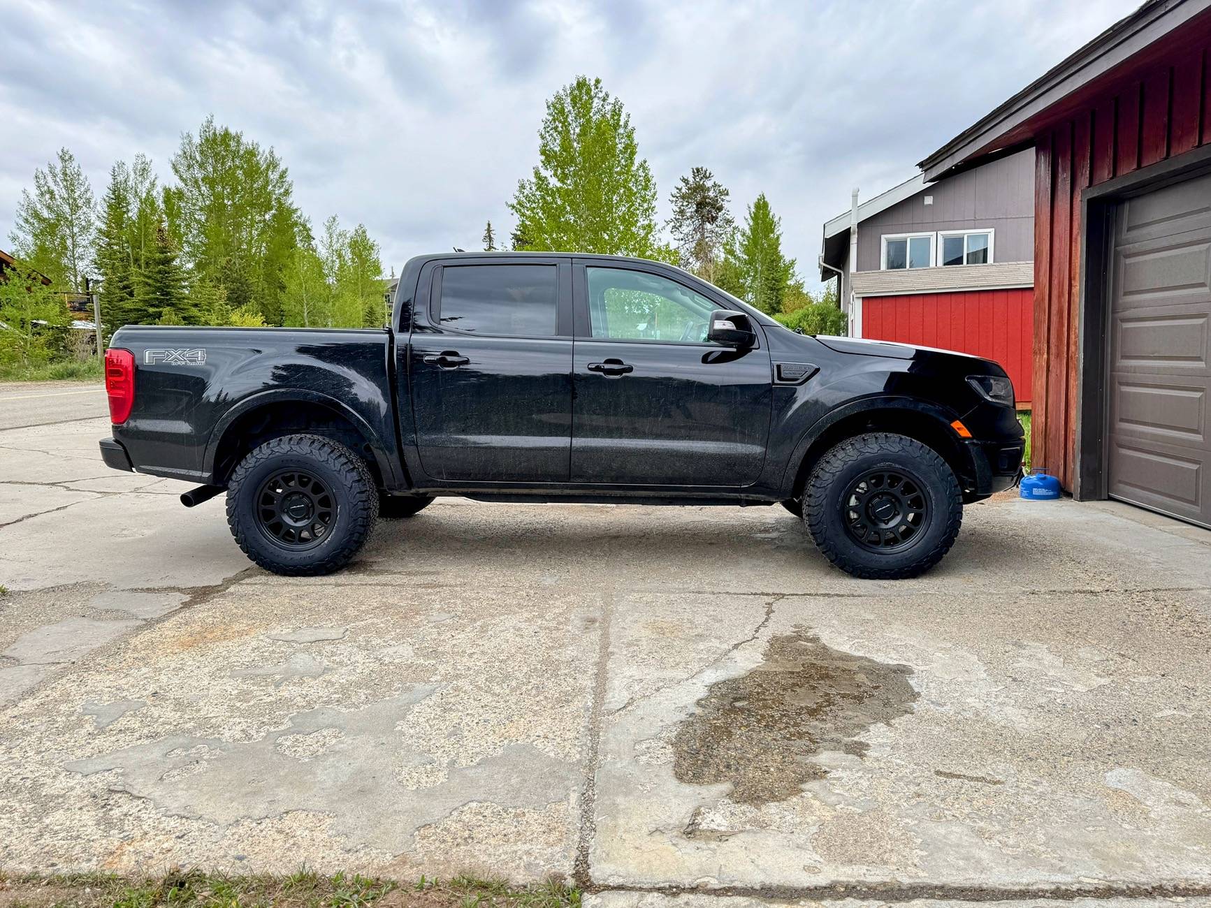

Wheels are on and I must say they look damn good. Surprisingly the tire only just kisses the crash bars at full lock.
I highly suggest getting the aftermarket crash bars. You'll most likely find that as the truck's weight shifts as its moving while you're turning you'll get a lot of interference. And I found pulling in and out of driveways while turning was really bad.
After a few days of driving I have had no issues. I know I can loosen them and move them forward, the passenger side is already moved forward because it has more clearance.
As a test, maybe try pulling over a curb as you're turning.

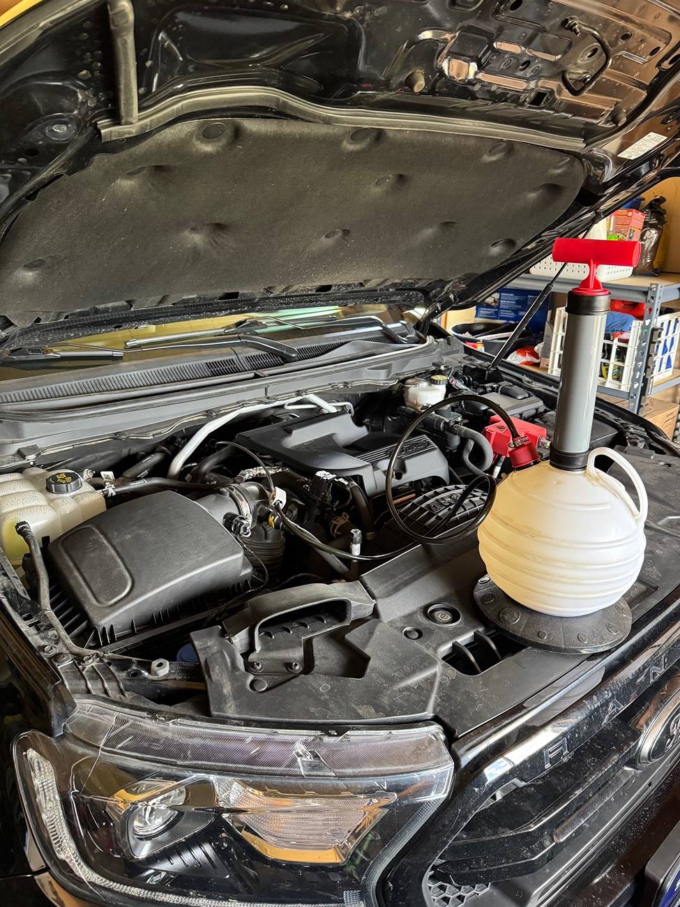

Finally got around to installing my FitzStick transmission dipstick today. High quality and easy to install ?
After that, I did my first transmission drain and fill - replaced 6qts - piece of cake.
