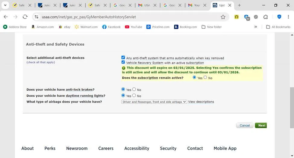

I re-certified with my insurance carrier USAA that the location mode is still active on Ford Pass. They give a discount for a Vehicle Recovery System in case the Ranger is stolen and they need to locate it. Also have their Safe Pilot app that tracks (God forbid!) my driving habits (such as braking and phone use) which I can get up to a 30% discount on the insurance premium with a good score.

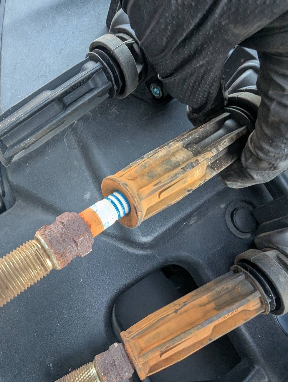

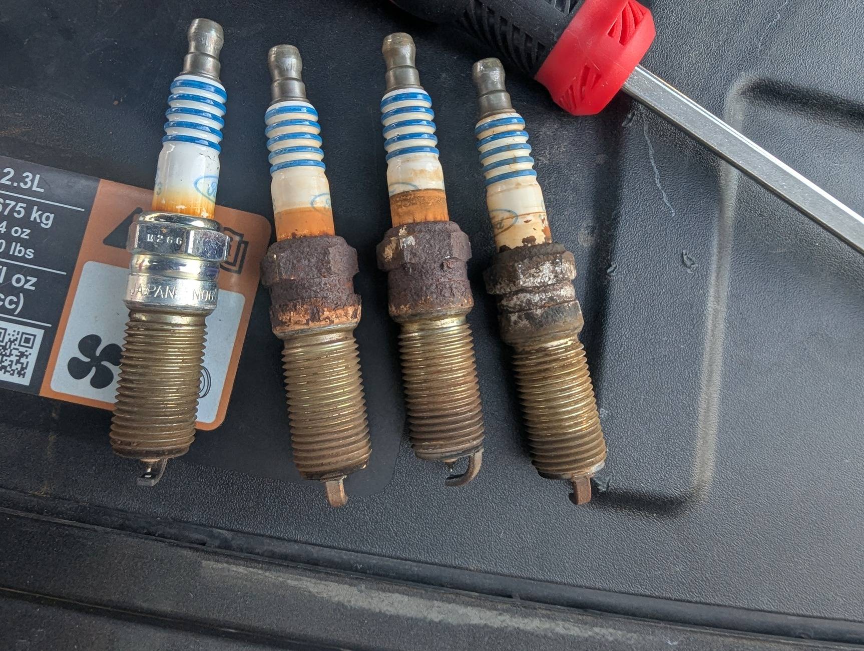

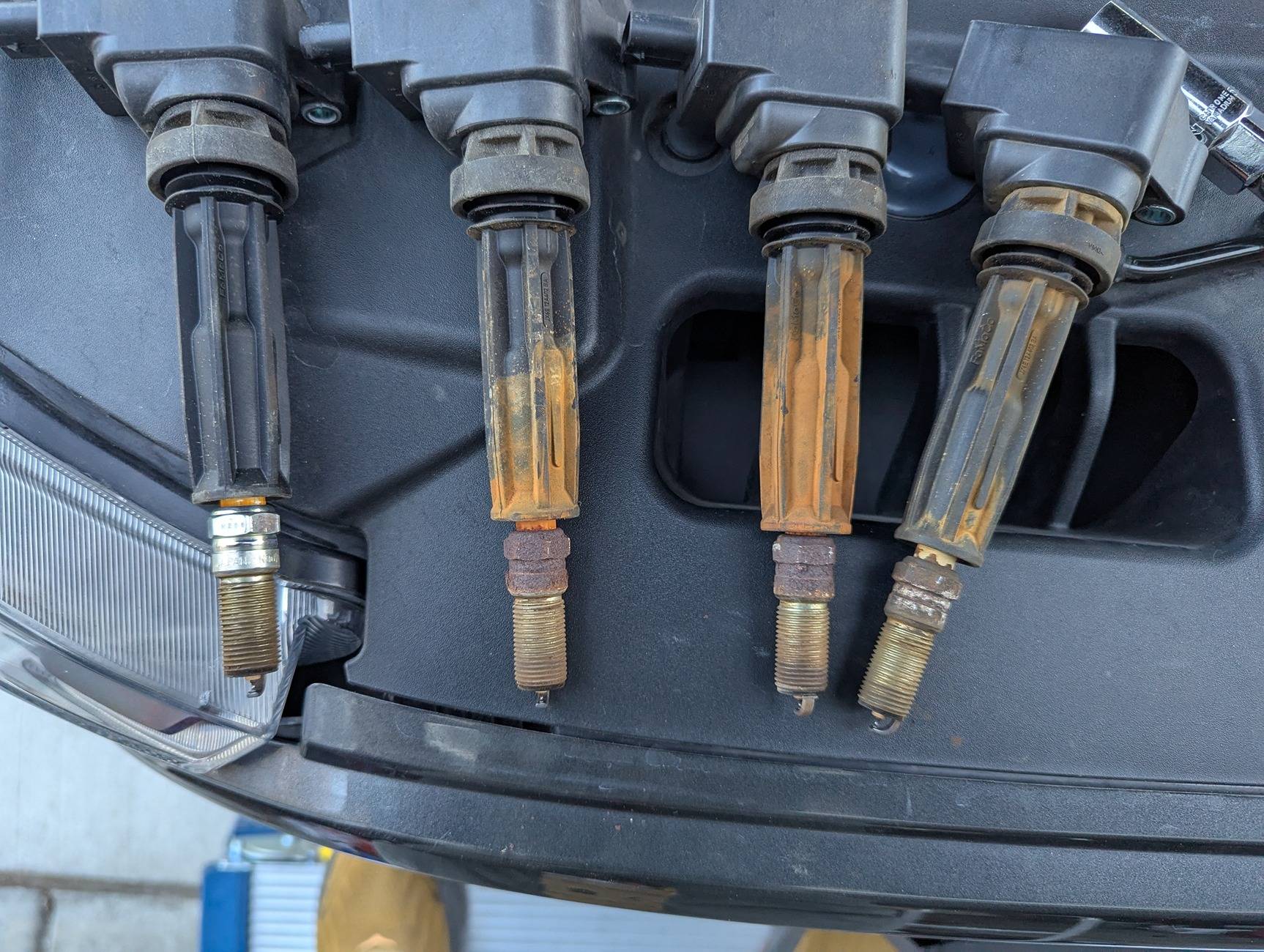

I did a thing. 28,974 miles.
Tomorrow I pick up a used engine cover locally.
Plugs and boots are laid out with cylinder #1 on the far right.
Plug 4 being behind the water dripping entry was in the best shape (looked almost new).
I also used this as an opportunity to purchase a platform thing I've had my eye on for a while. (it's on sale at Lowes 99.99 from 169.99 or something.

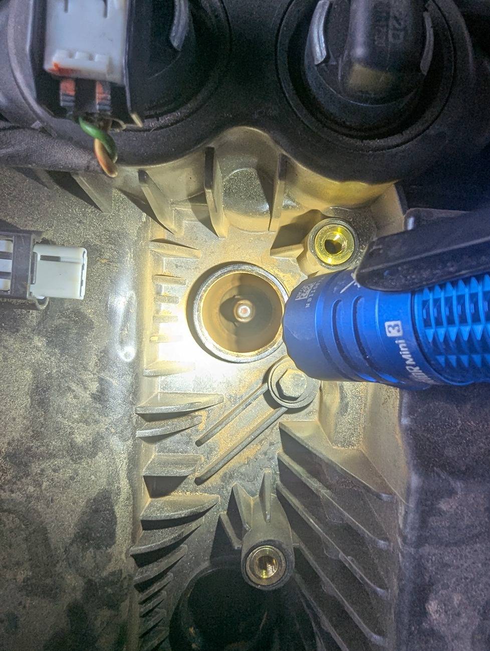

If you look in the holes you can see debris that looks like metal flakes from rust... Only took ~45 minutes and that included fishing the plugs in and out be cause my sparkplug socket seems to have lost it's little rubber catch thing inside it.
Zoom in here at ~230 you can see the chunks.
Edit: I started to wipe down the #1 boot but quit because it was more effort than it was worth...
Bought a used jcr offroad (I think) engine cover of fb market place for 50 bucks last week and installed it yesterday... Seems like it might help with water intrusion. I'll probably get some rubber edge trim to help direct the water away from the giant oval hole on top of the thing...

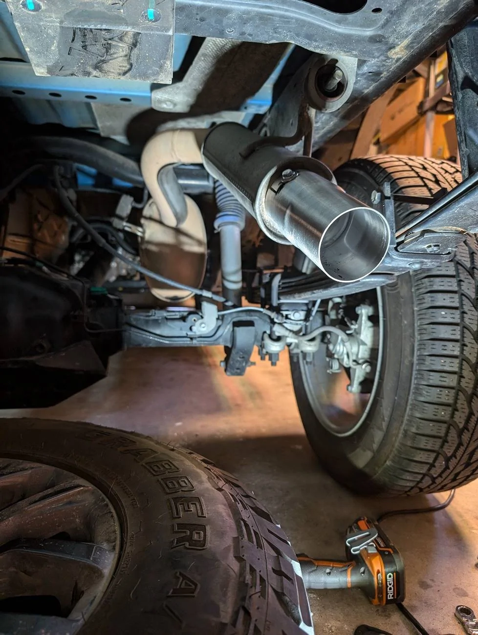

Also added a super custom exhaust tip, reused the unneeded adapter from the CVF downpipe (for those without flex pipes) and bolted it up. Does a better job pushing the exhaust away from under the truck. Very fancy, very cheap.
