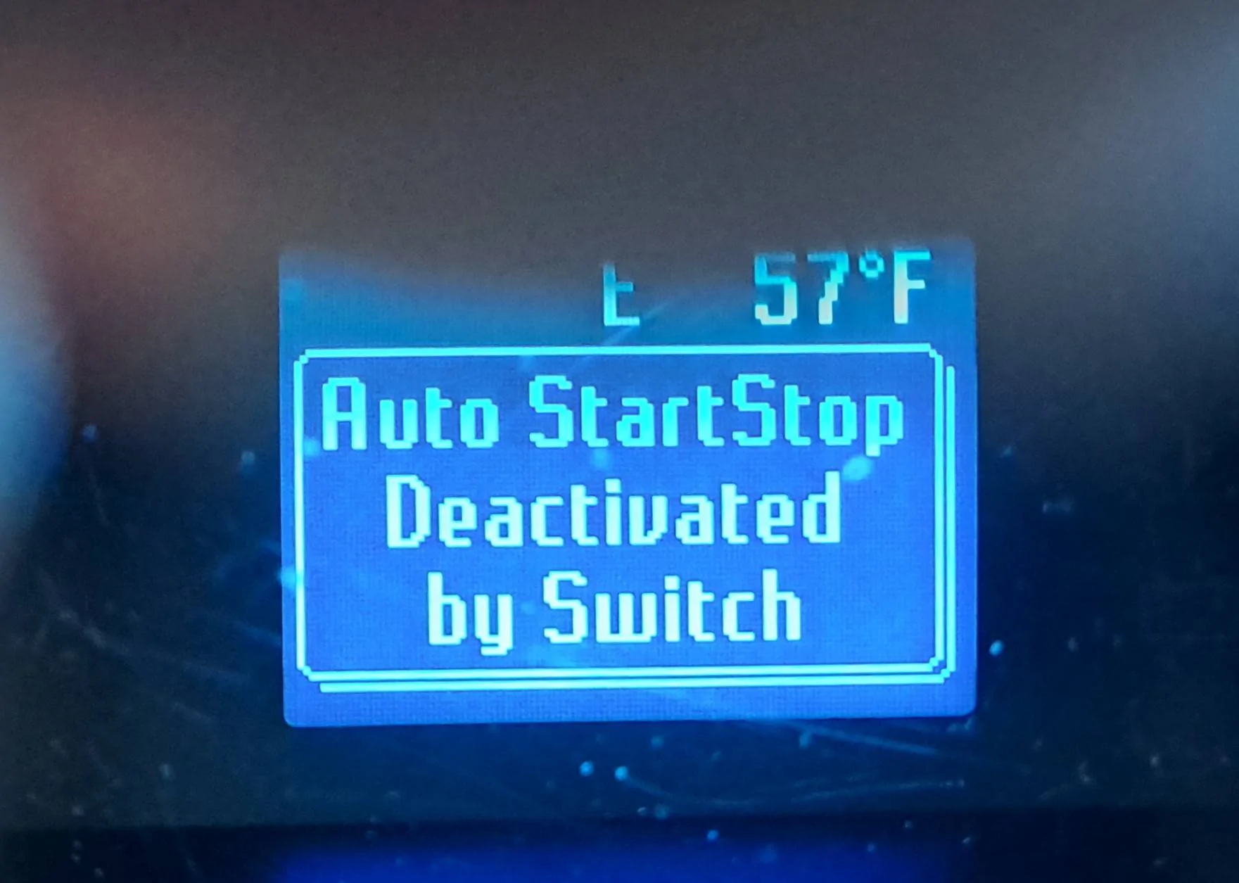

Installed the Autostop Eliminator! The install videos make it look so easy! ;) It wasn't that bad. :rockon:
I like that these give a notification of their on/off status at start up...

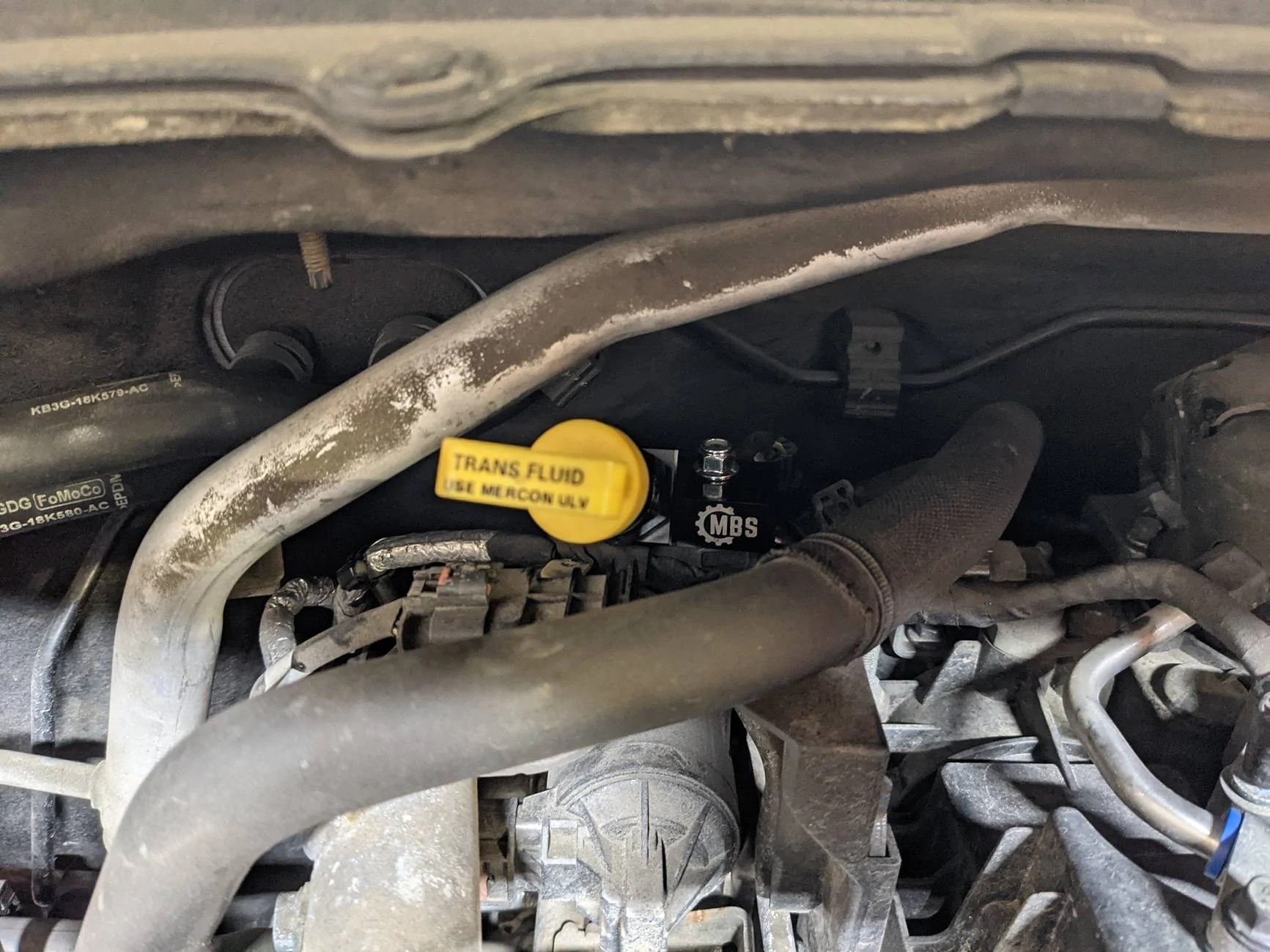

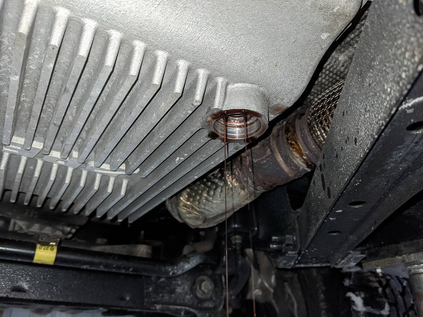

Finally got around to installation of my extended dipstick.
Along with the ppe pan, it made changing transmission fluid much simpler and neater than the first time. The included funnel worked great.
Not sure how you would be able to get the fluid to 200+ to check per manual though. Best i could do was 186 after idling in the barn for 30 min. Tried driving but it actually dropped to 174. I guess the fins on the pan must do something especially with as cold as it was outside.

Try driving it in 6th gear and between 65-70 mph for about 15 minutes on the expressway. That equates to around 3600-3800 engine rpm. It should heat up to the 205+ range. Always works for me

One you-tube video I watched the guy torque braked it in gear (on a lift) on and off several times to reach operating temp.

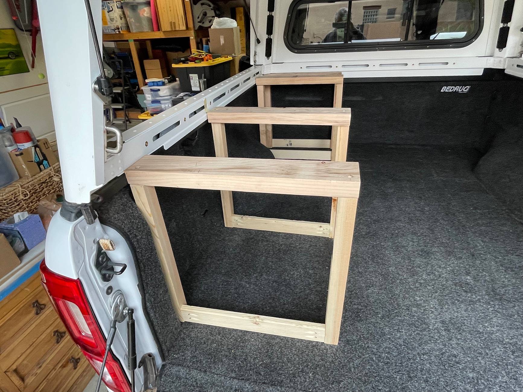

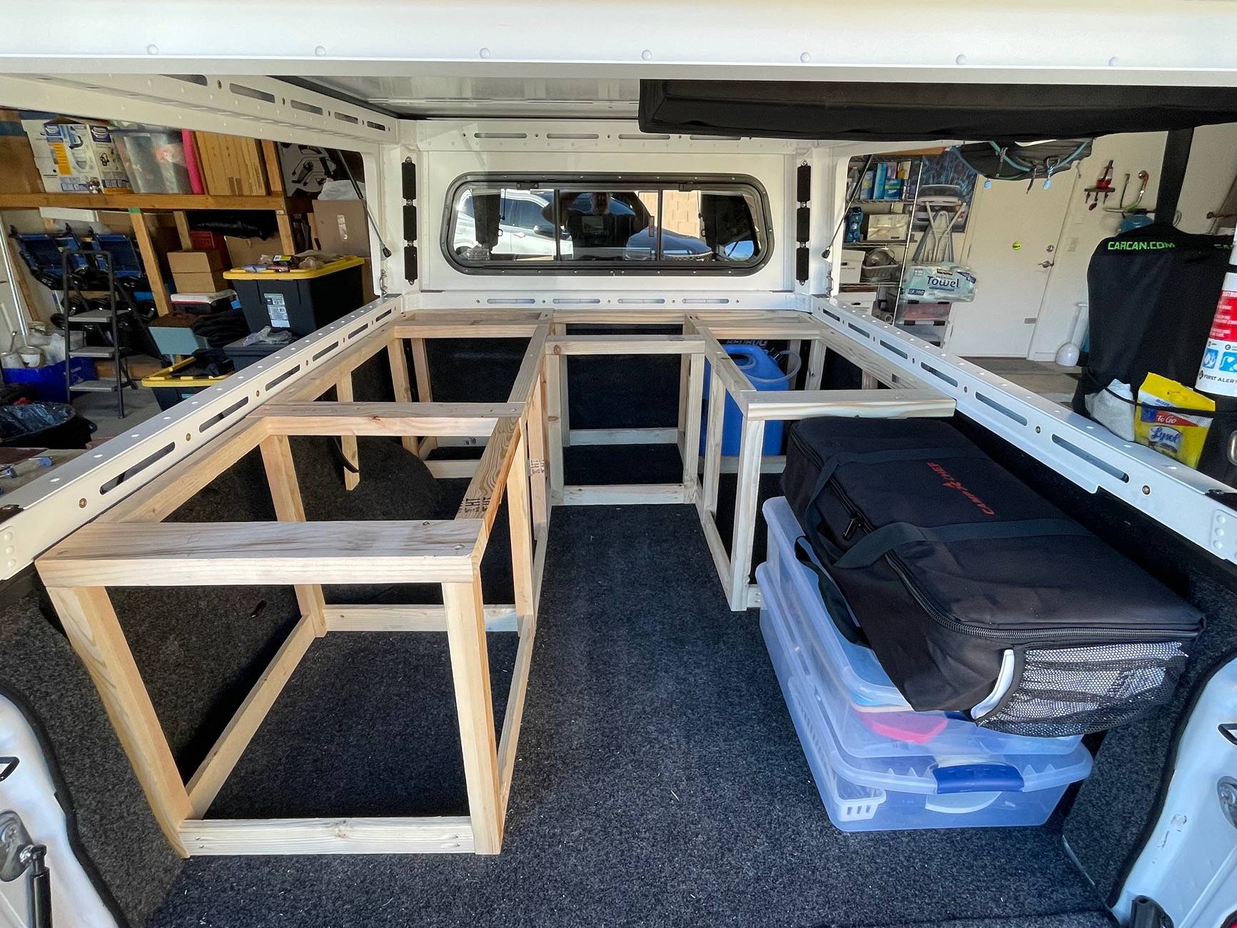

Started the interior build out of my camper. Tomorrow I'll finish the rails between the ribs, and Saturday I'll do the plywood and carpet. Eventually it will have a U-shaped bench like a dinette booth. With the roof moved forward over the cab and the tent popped up, there is 8.5 feet of head room, so it's not like a typical topper. Hence the bed rail height.
Updated today, framing is done. Now just need to install the plywood and carpet. The top panels will be hinged laterally so they can be easily opened from in or outside the truck.

Ill have to try these. Cant imagine 20 degrees would make a huge difference in level but would be good to know.

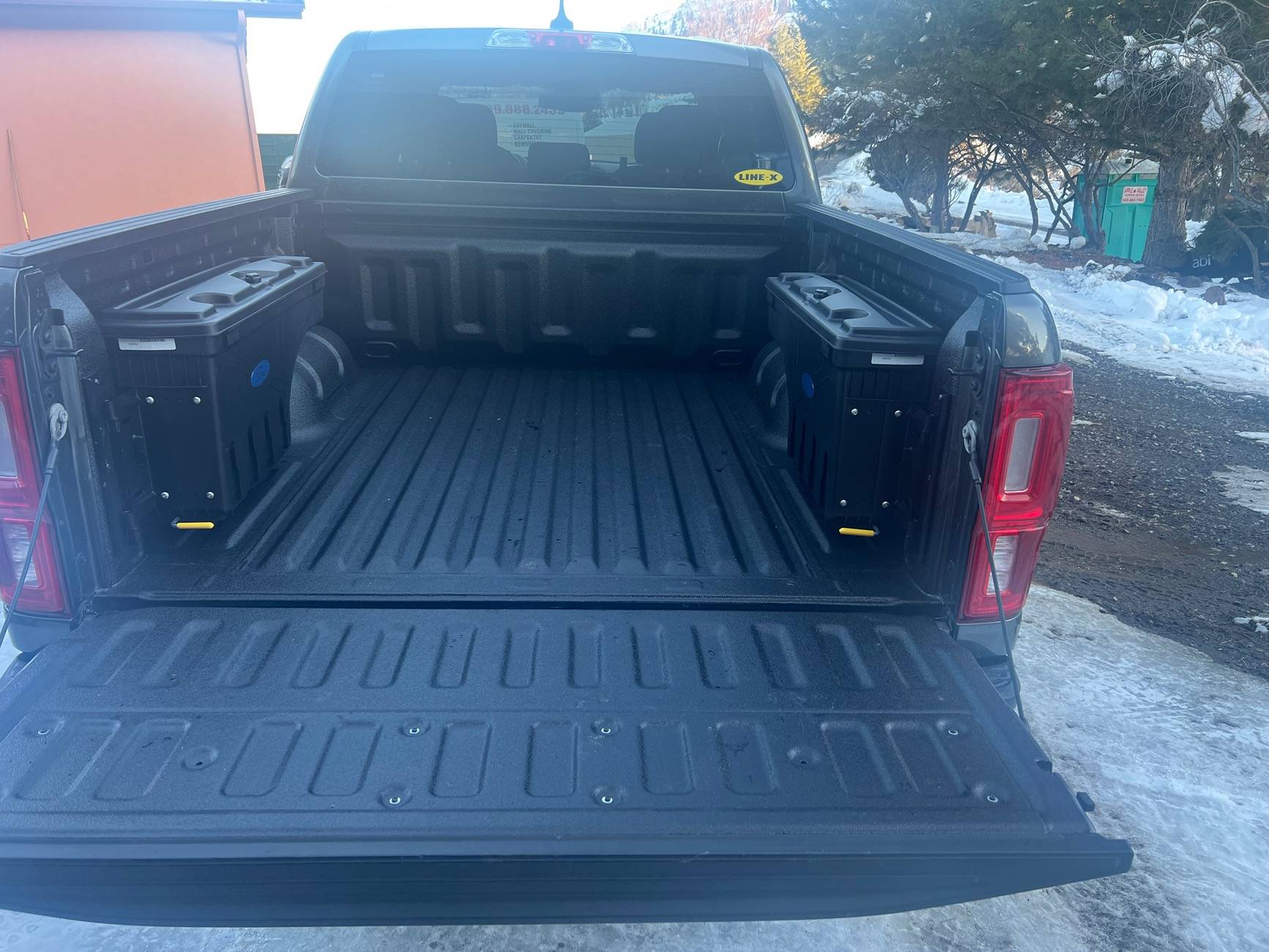

To add to my Line X which was sprayed in yesterday, I bolted in two swing out tool boxes today.
Gotta keep my back seat area clean which always seems to collect this or that…
Hoping tonneau clamps will clear the tool boxes…
The clamps will clear with plenty of room.
