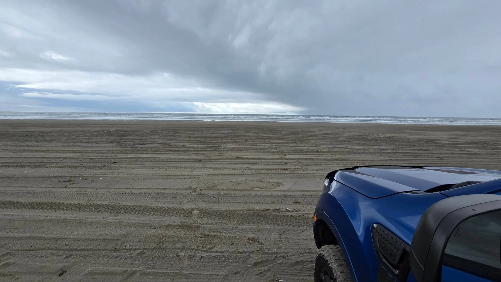

Flushed both diffs, the transmission, and transfer case last week.
Then yesterday took my Ranger and my drone out to Sunset Beach in Warrenton, OR Saturday. One of my favorite spots. I get to do donuts, winch/tow people out when they get stuck, walk the beach, and have fun getting video.
Afterwards I crawled under and power washed everything out (which I find pretty satisfying to do)
The only downside was the people with road rage on US26, but as someone who grew up in the desert (Nevada) well worth it for the beach.

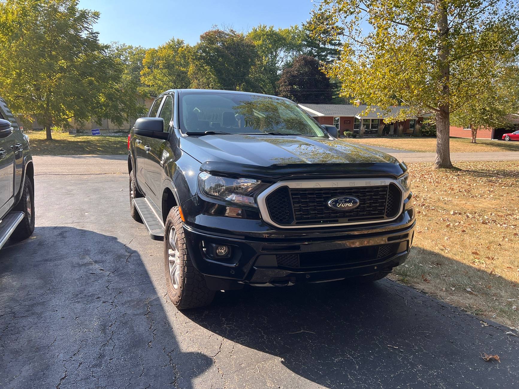

Well it was time to try and repair the paint damage to my front hood!
gave the truck a bath. Cleaned it up ? real nice ?
I got out my OEM touch up paint kit from ford and went to work.
I meticulously studied ChrisFix videos to make sure I knew what I was doing. Things started off great, and all I need to do was wet sand things down to make it look perty.
f%#k me, I did it poorly and it looked too janky for me to tolerate so I ordered an AVS bugflector and slapped her on there. Now the paint and clearcoat is on the hood and my shoddy craftsmanship is covered up by the bugflector.
I’m an office worker, not a paint specialist. And honestly, I think it turned out great!
shout out to @AzScorpion for the tip about putting the bumper pads on the bugflector and not the hood!

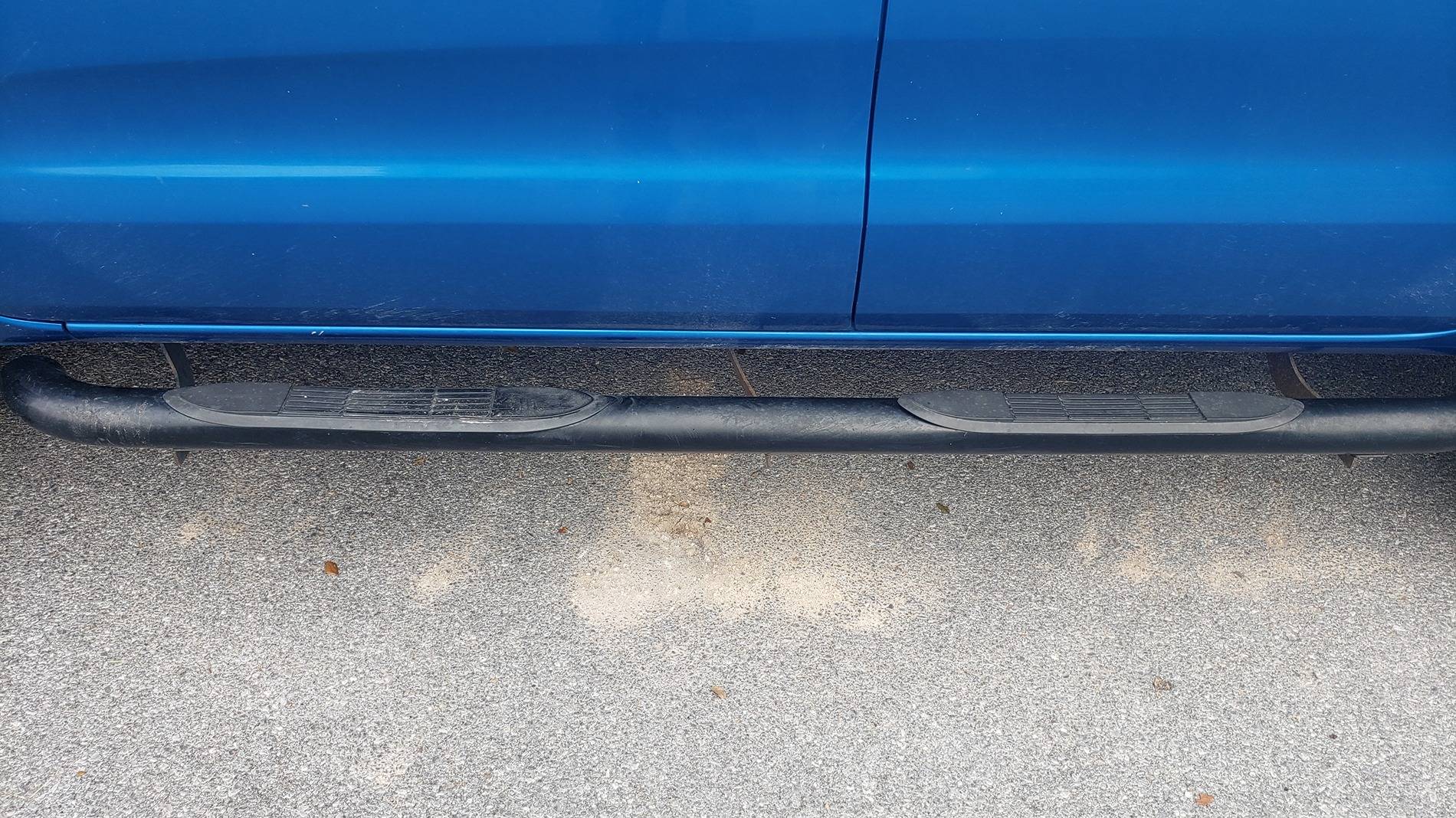

Washing off the mud from the hunting trips and then noticed this!! Bent the crap out of my running boards.
I tell you, if you do offroading, take em off! They hit everything!!! I hate em, but the short wife says she needs em.
