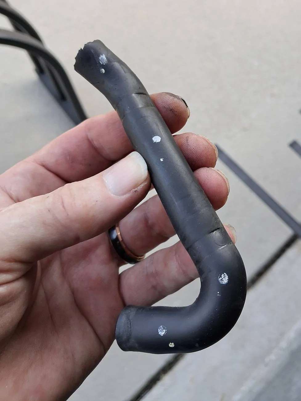

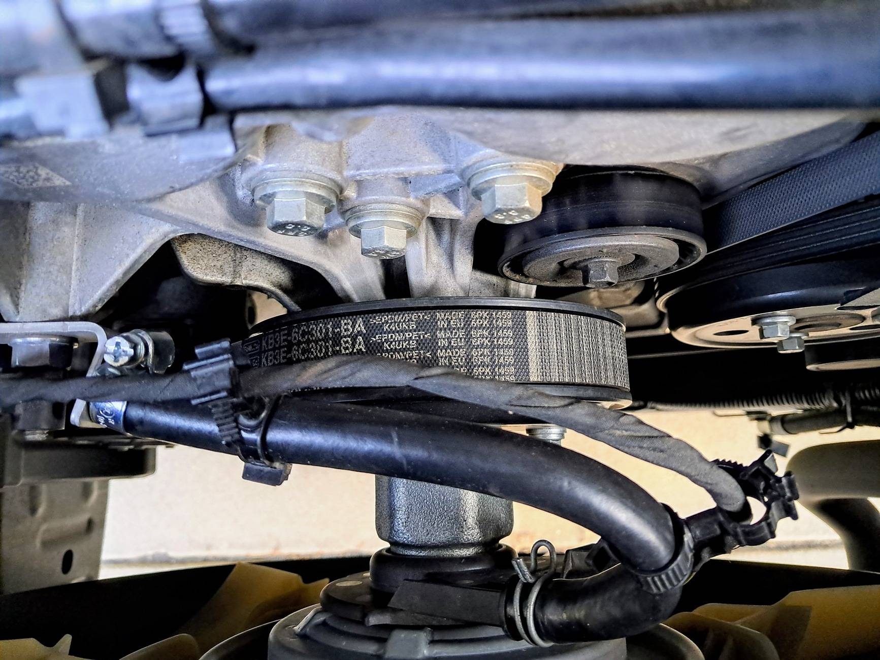

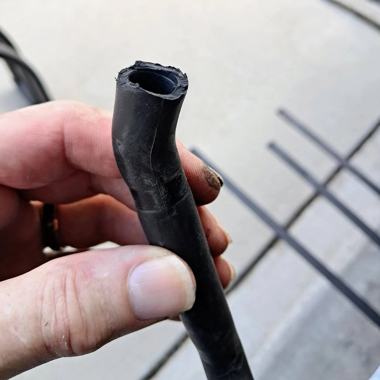

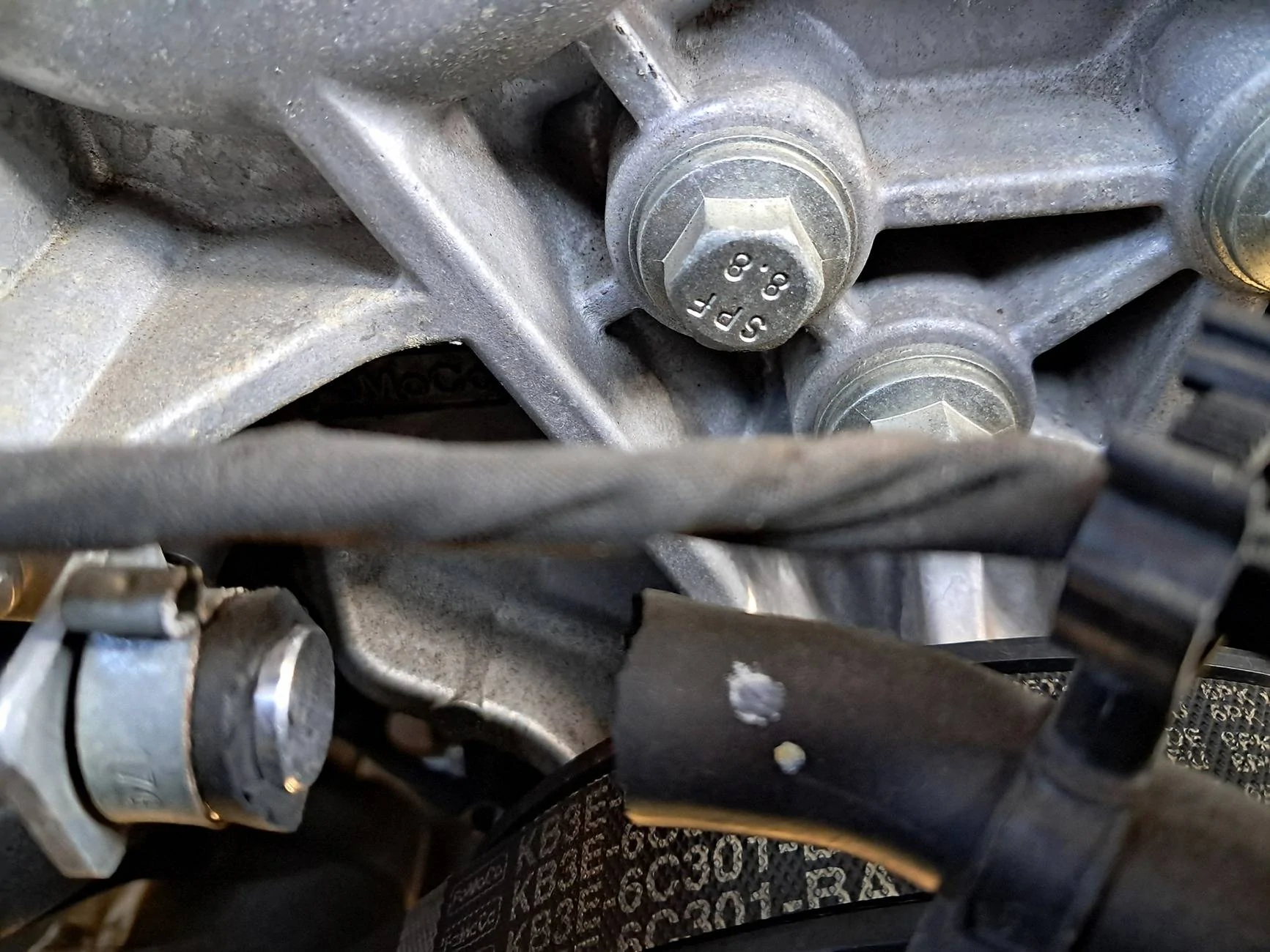

Today I was able to look under the hood and inspect my engine - lo and behold, the 'hose' that supports the fan wiring had broken.
I had picked up some fuel injection hose the last time I was at the auto parts store for this inevitably so I was able to resolve this before it disabled my truck.
Here's the fix:

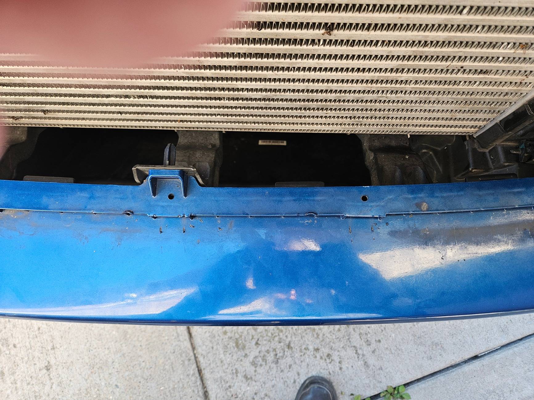

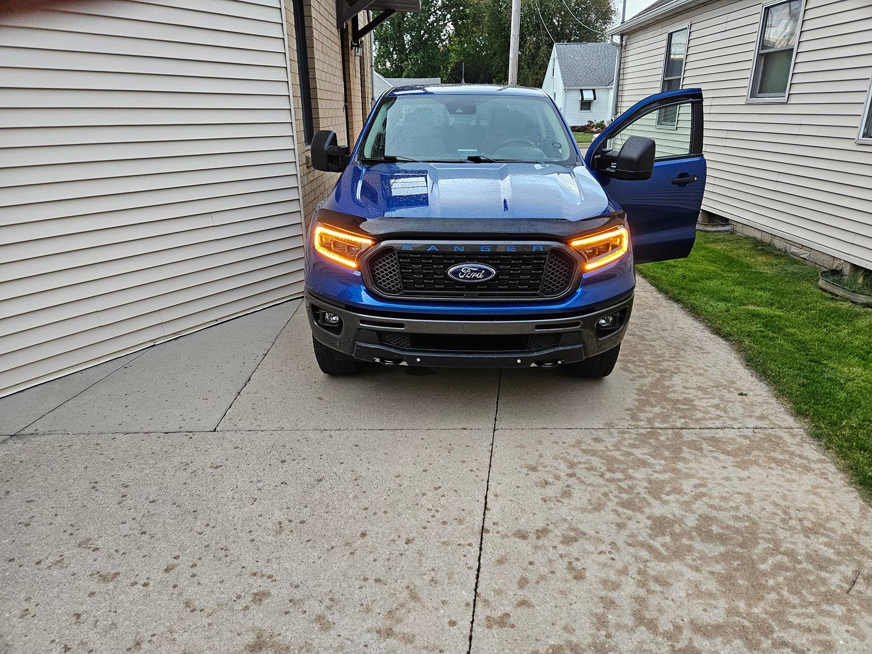

Finished up my headlight install today. For most part not to terrible. But man getting the grille out is a pain. Those bottom clips are a b@#$%h. I do come up with a way to make them super easy. Take a small drill (just big enough to push a small Phillips screw driver though). Now drill a hole just through the upper bumper centered on the area of the clip. Then once you have the side clips loose simply take you screw driver and press down on the clip. Instant release. Wasted about two hours pushing down on those clips with no success .
The other major stumbling block was the outside bolts on the upper bumper facia. Nearly impossible to get up in there and see what you doing, not much wrench swing space either. My solution was to pull the bumper. I know bunch more work. But now you can get at those bolts with a long extention just like inside three. Anyway got the lights in (that part was a piece of cake) and the upper bumper facia back on and called it quites for the night.
Hey, when 71 you don't work fast!?

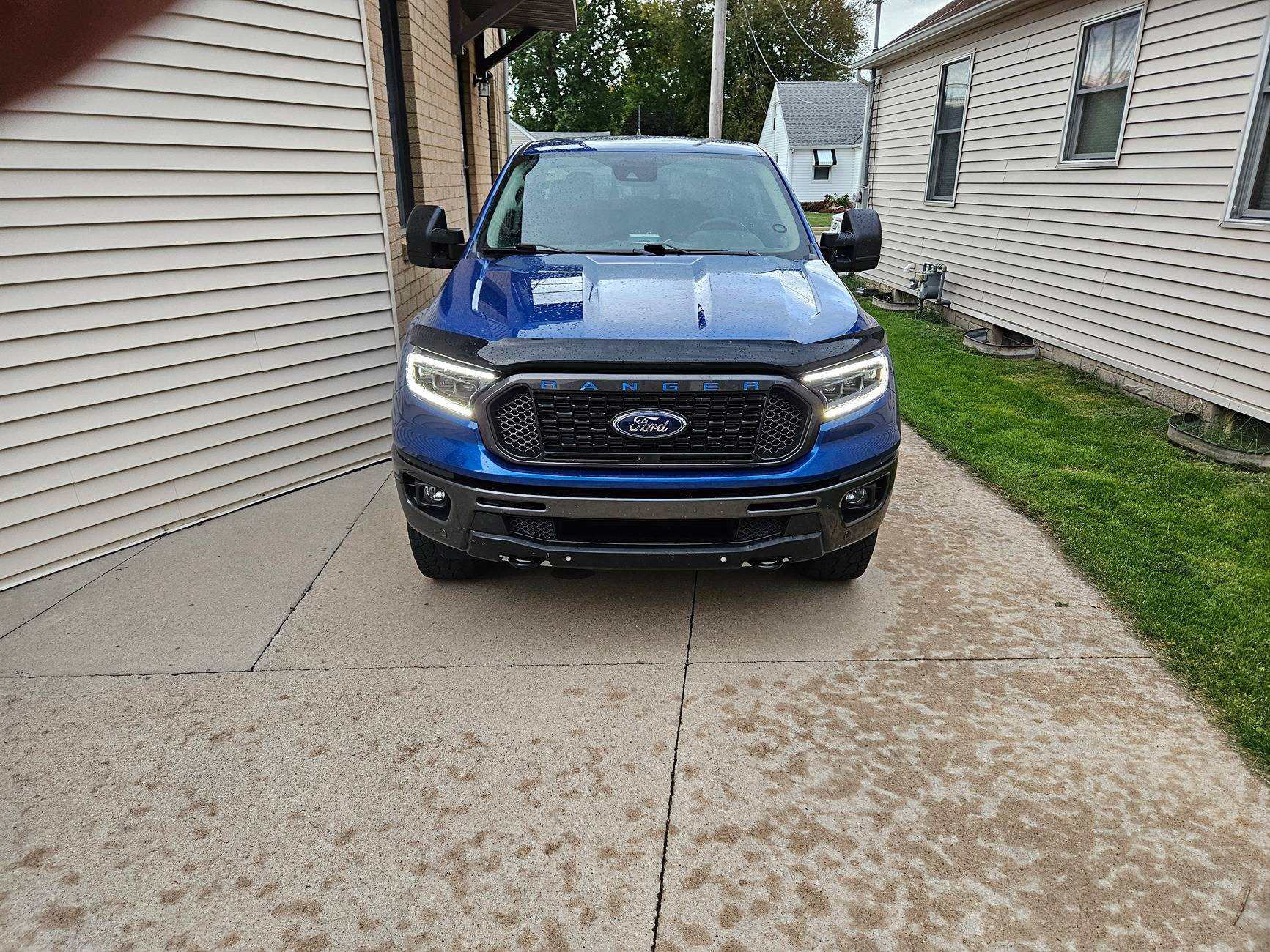

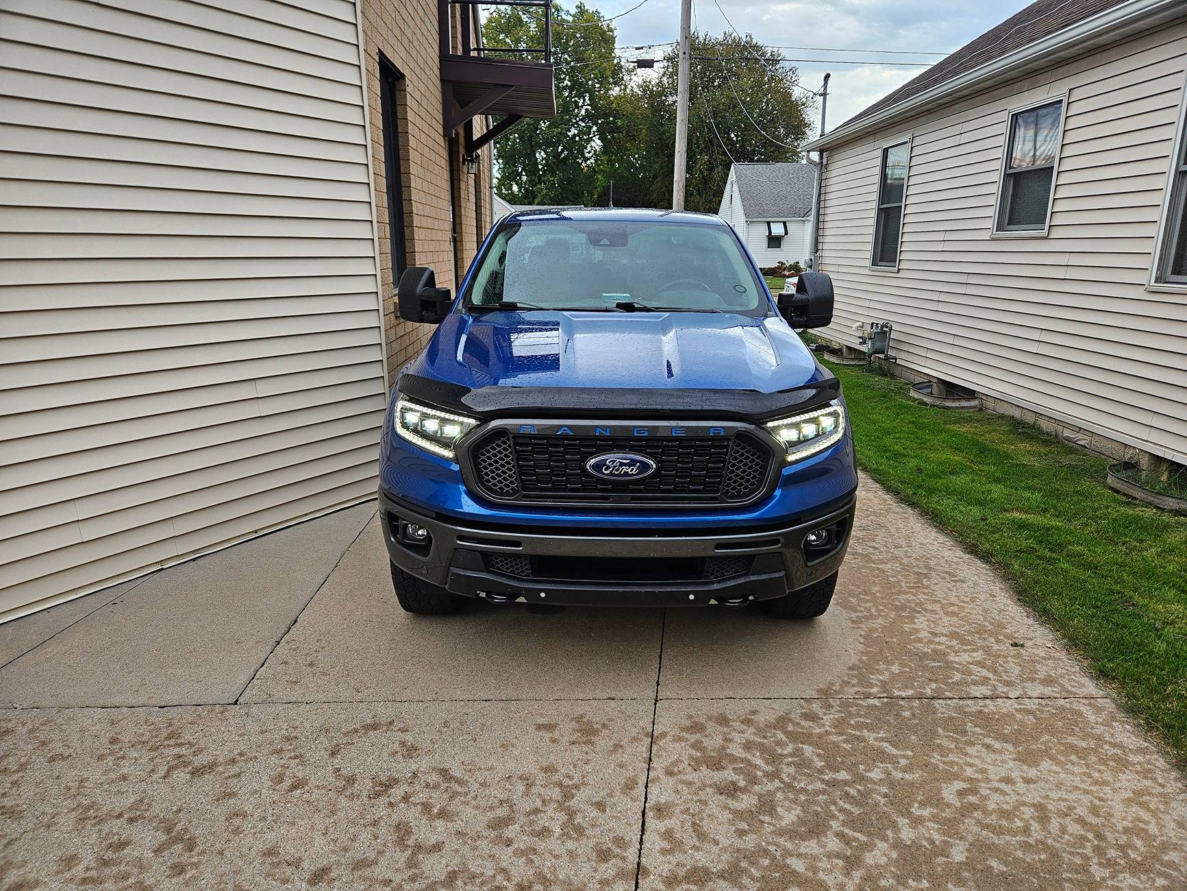

Today finished up a few loose ends and got the bumper back on. and adjusted the lights. Love of them, will be much better than the old halogen ones, even with the illegal LED bulbs. Didn't need to go into Forscan or anything. Only thing is I had my old ones set to include parking lights with DRLs. That part doesn't work, May play with settings in Forscan, to see if I can get that back.
The last picture I had the 4-ways on. They are sequencial just like the turns.
These are the OLM lights. It seems Coplus that makes these also makes the lights for Morimoto.
