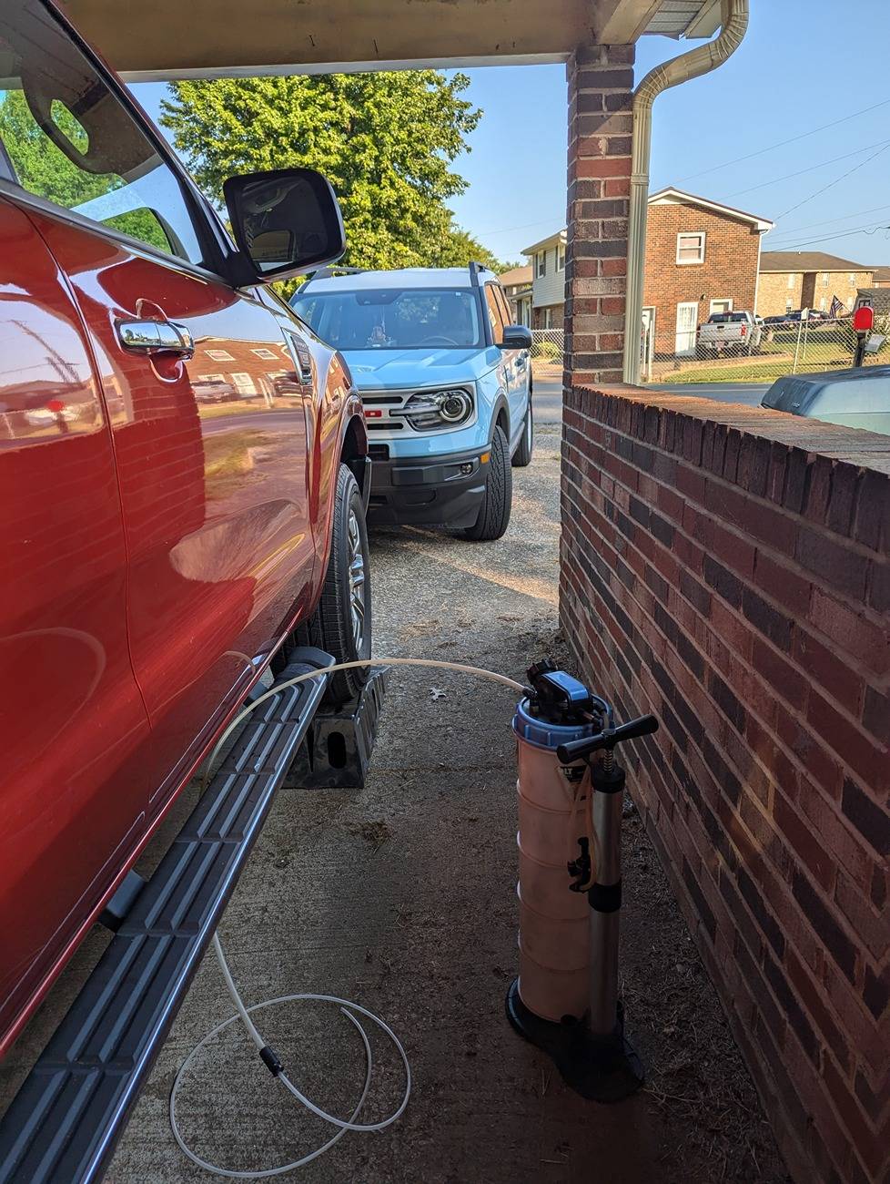

Well right now this post is what AM I doing for my Ranger today. I am sucking out my trans fluid to replace it and the filter. Also installing a new pan with a drain plug. The vacuum pump is a pump and vacuum unit from Harbor Freight, you can get this one, one that only sucks, or a pneumatic one. Depends on how this project goes, Barney will get a tire rotation and new brakes today. If not a good morning the rest will wait until tomorrow. The BS in front of Barney is my wife's ride, Betty.

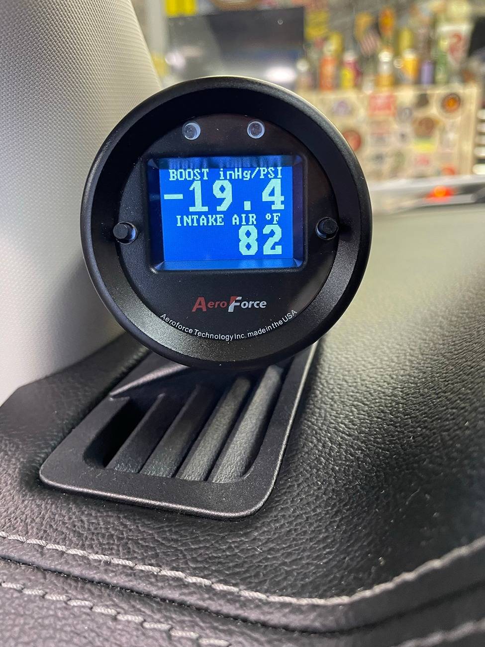

Installed a AeroForce Interceptor gauge & pod. Just a few thoughts regarding the installation
- You will have to make a hole in the defroster duct to allow the cable to pass through. My Dremel tool made short work of this.
- Fishing the cable is a bit of a challenge due to limited access. An old piece of speedometer cable did the trick first try!
- The gauge does not "snap" into the pod, nor does the small piece of foam included keep the gauge secure in the pod. I ended up having to wrap the barrel of the gauge with electrical tape until I achieved a diameter that was a gentle but firm press fit. At this price point I would expect something a little better, say grub screws to hold the gauge into position.
- The Interceptor gauge has more functions and potential displays, some parameters that I have no idea what they are. The instructions that come with the unit are vague, but AeroForceTech.com has full manuals that are free to download that go into great detail.

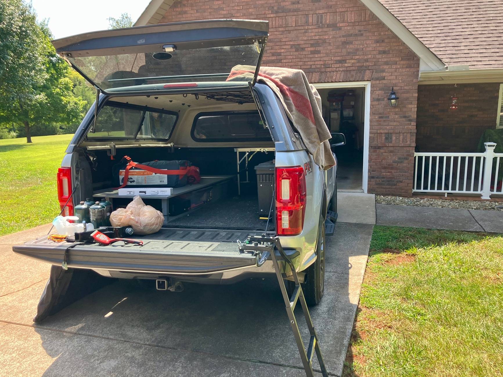

Cleaned out the bed in preparation for upcoming adventure. Stop in PA to camp one night (at Caledonia State Park - fly fish Mountain Creek) on my way to western CT to metal detect a couple really old farms for two days, then 2 nights camping at American Legion State Forest in CT (fly fish the Farmington River one of New England's top trout rivers) and then drive to Western Maryland mountains to bow hunt whitetails for a few days with a buddy. Road trip 5-15 September. Probably 2100ish miles round trip. Looking forward to Sepember temps in the NE!
