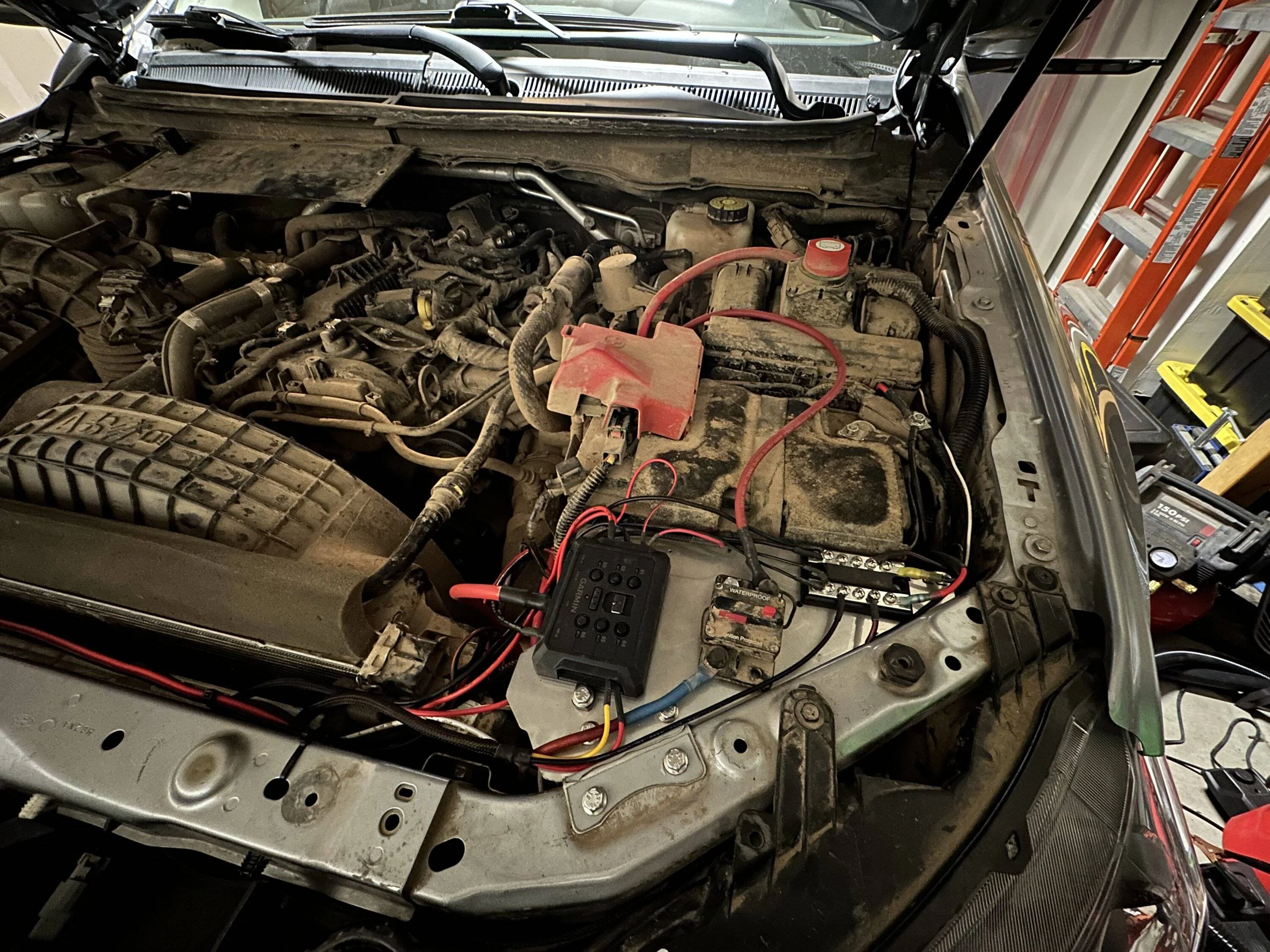

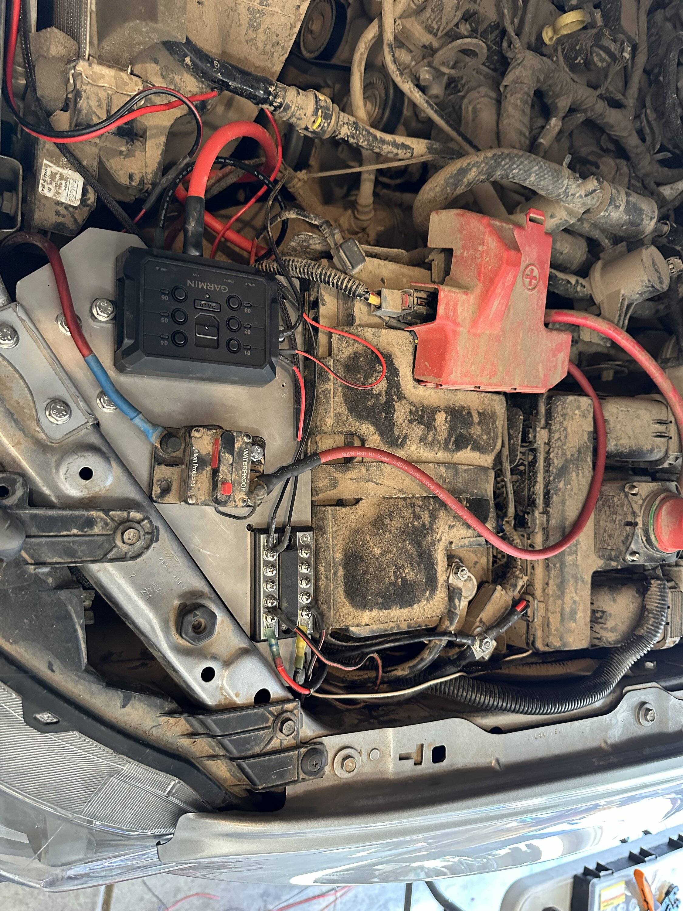

Received my Garmin PowerSwitch this morning and installed it. So far, its running my ditch lights and the trigger wire for my compressor. I still need to wire up my light bar and my 7" round auxiliary lights, but I ran out of time this afternoon.
The Garmin has 30a relays built in, which means I don't need the external relays for each device like I had. I was able to pull 5 relays out of the truck completely, along with all the wiring below. The whole point of this was to clean up the wiring and simplify my setup.
The Garmin works off bluetooth, from my phone (and CarPlay) to turn on and off the devices. What is really nice is that I can configure special buttons and program them however I want. I have one button setup to turn on all my forward facing lights. The Garmin also has the ability to configure based on trigger wires, meaning I can tap into the brights, setup all forward facing lights to come on with the brights automatically, then... when my auto-brights turn on and off, the lightbar/7" rounds/ditch lights will all turn on as well. Super cool piece of tech.

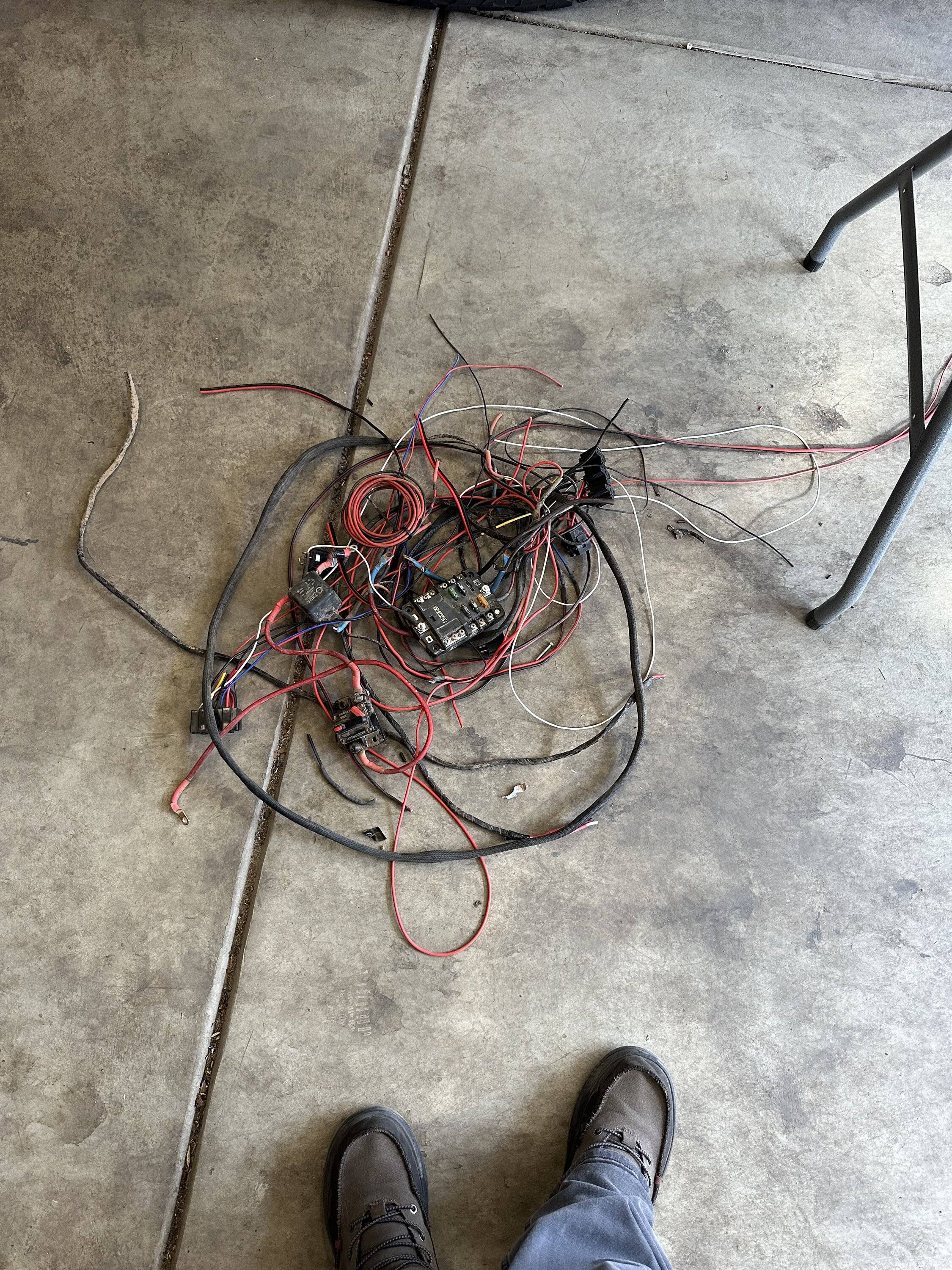

I got my PowerSwitch fully installed with all the items that were previously installed. (trigger for my ARB single compressor, 22" lightbar, 7" round aux lights, ditch lights). I still need to try and reroute a few small wires, but that's more nitpicky than anything. I plan to take a little video of the Garmin PS in action, but I need another phone to record parts of my phone, since its done via... phone (phone, phone, phone, phone, phone... there I said phone a bunch of times).
I still need to pull the cabling out from inside the cab, but I need an OE trim piece to replace the Lightforce trim panel, so that will have to wait. The above picture is the total wiring removed from the truck, to accomplish the same number of fused/relayed accessory items.
