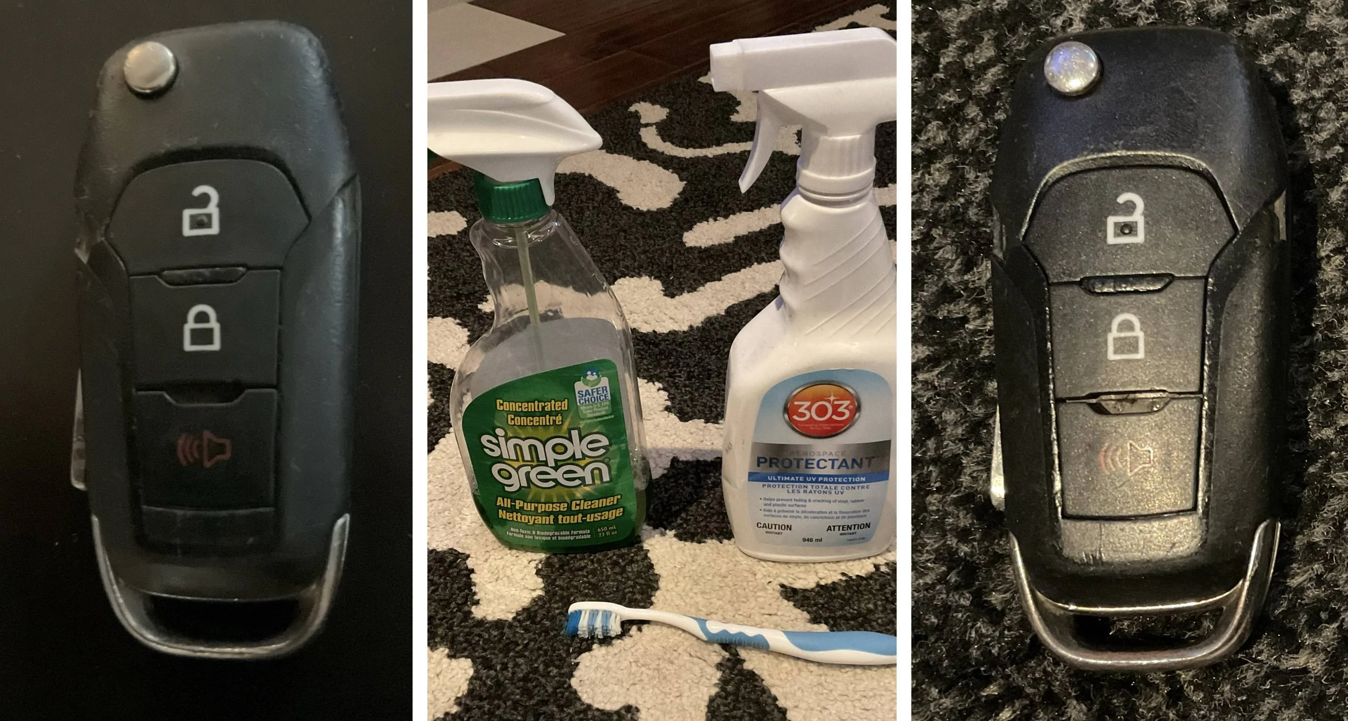

Great write up David - my fob is chipped, cracked, and very dirty. The tiny roll pin that holds the key in place is always working its way out and the key gets stuck…..in the closed position. ☹
I think it might be time to detail it. Now I know how to get it apart. ?
Edit: Done, used my spare key to open it up - the key seems to fit the slot perfectly. I think all that the 303 did was highlight all the gouges and scratches.
Clearly, @subquark is a lot gentler with his key fob than I am. ?

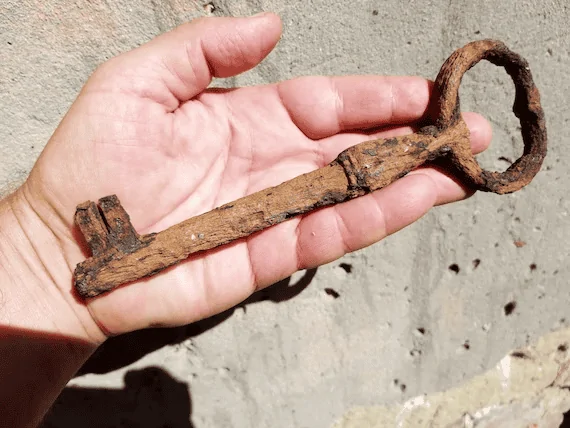

At this rate, my key fob will soon look like this:
Mine already does.
ok you cant show a key like that and not have it got to a pirates chest or some ghostly jail cell.... what does the key go to?!

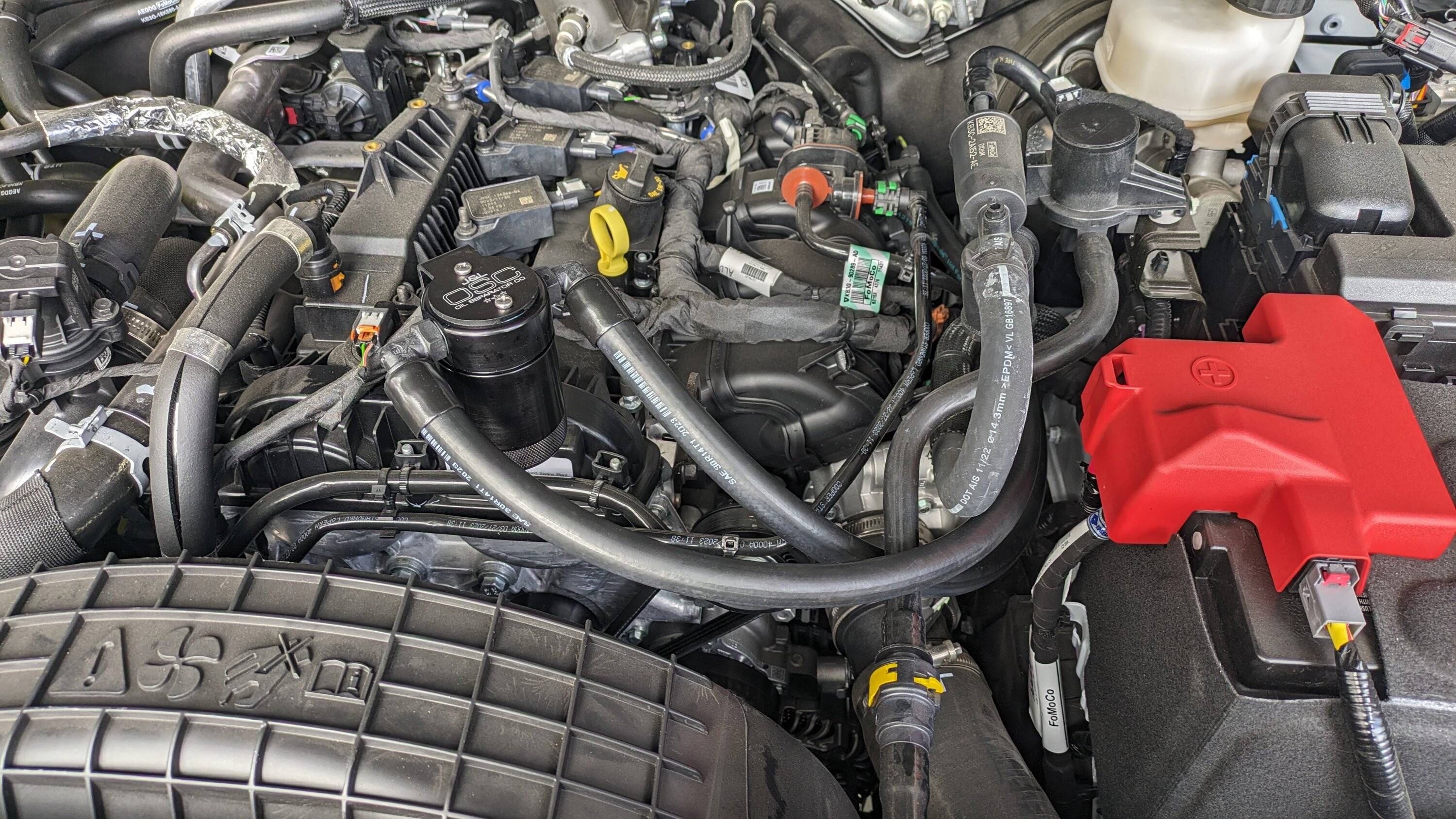

Posted this a while back, installed a J&L oil separator.
A member here said his mount broke 4 wheeling ?
Could have been a bad mount, who knows. However, it got me thinking about the precarious nature of the location they chose.
Should the mount give, or even the brass insert break out of the plastic stud on the top of the engine, there's really nowhere for it to go but into the serpentine belt and fan blades.
Wouldn't the hoses keep it out? You might ask and my answer is a pretty unconvinced maybe. Unmounted those hoses don't provide much support and to make the turn around the front of the engine there's enough slack to let it drop in with some jostling.
Especially if everything is warm and flexible. So I decided to move it.

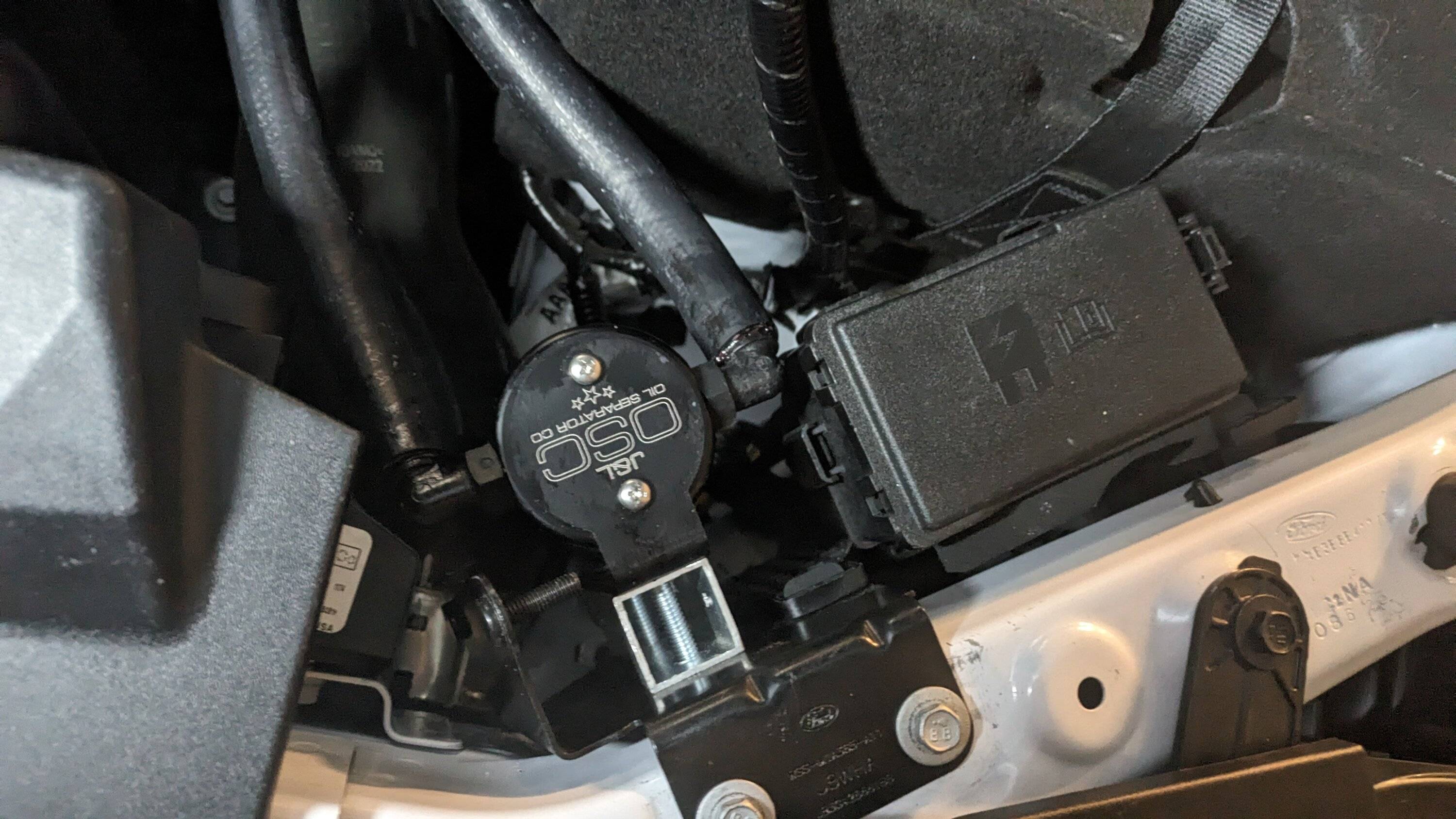

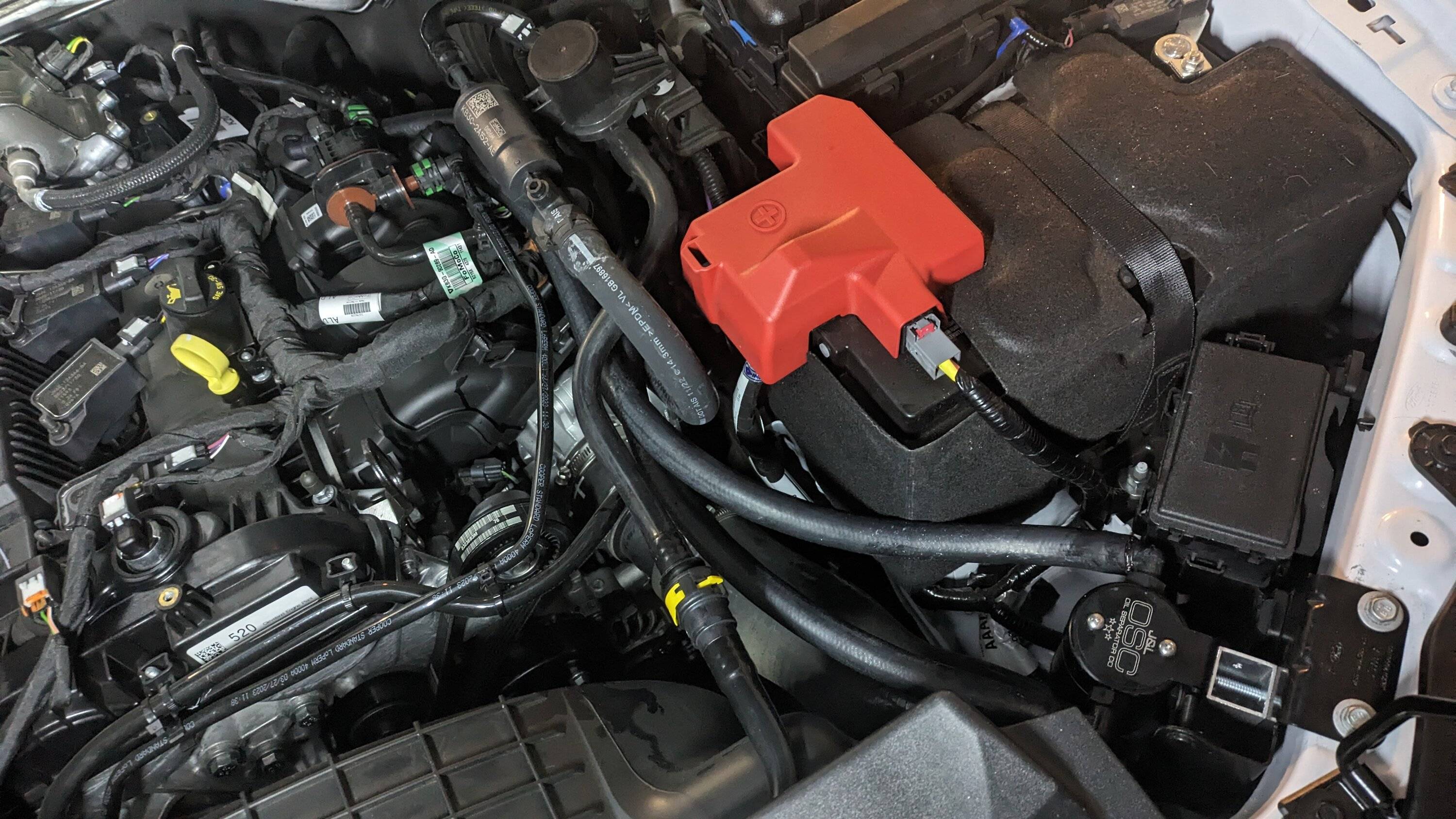

Here we are in the new spot next to the fuses and relay box for the upfitter switches in front of the battery. Used a piece of 1" square aluminum stock to position it properly.
Just removed the bracket first and drilled some holes for 1/4x20 hardware with nylok nuts and washers. By far the biggest pain was new hose. Buying it...easy, cutting the connectors out of the old hoses...easy. Getting the connectors IN the new hose, even with grease, good god what a pita.
But it's done and in a safer spot now.

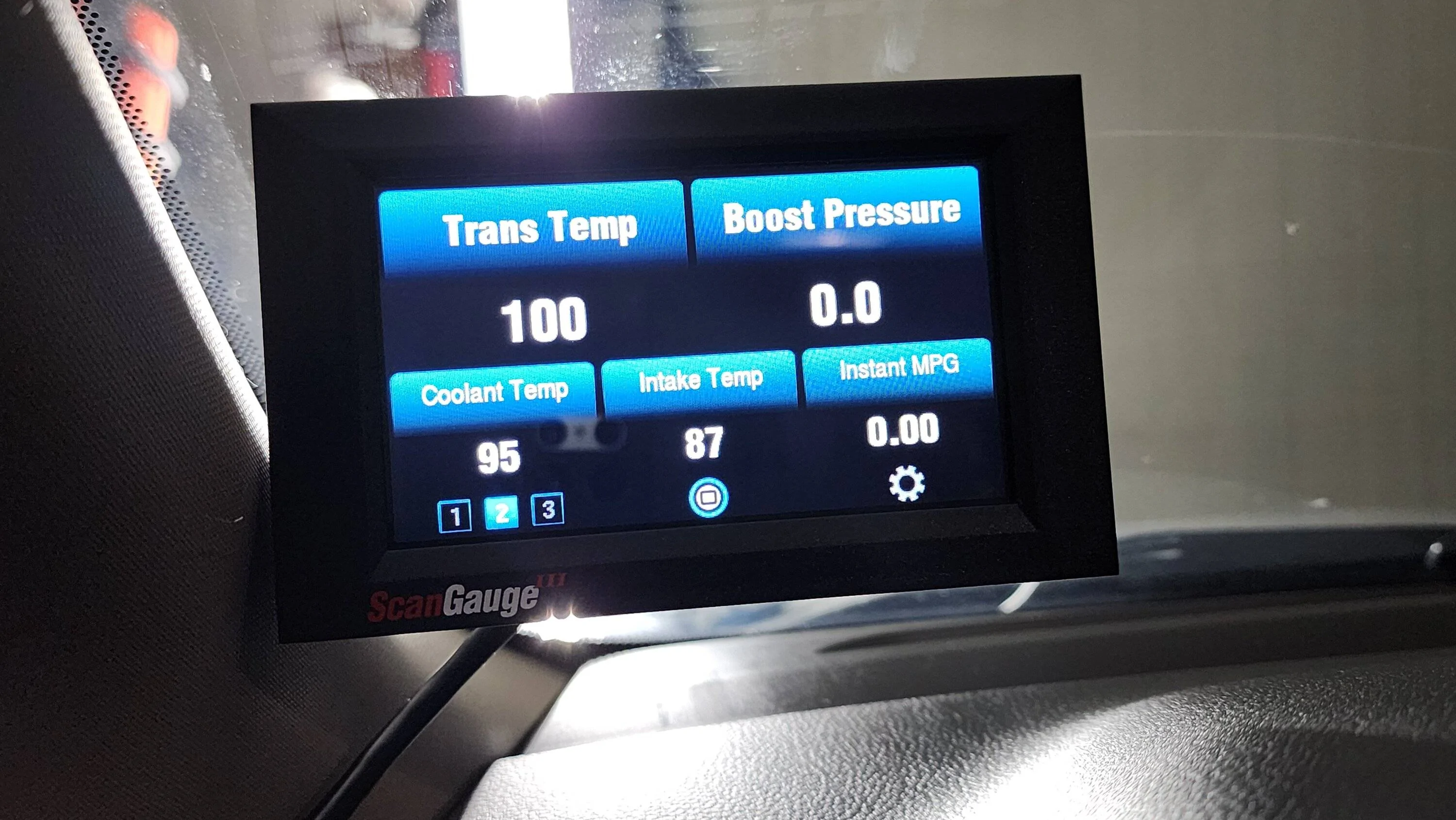

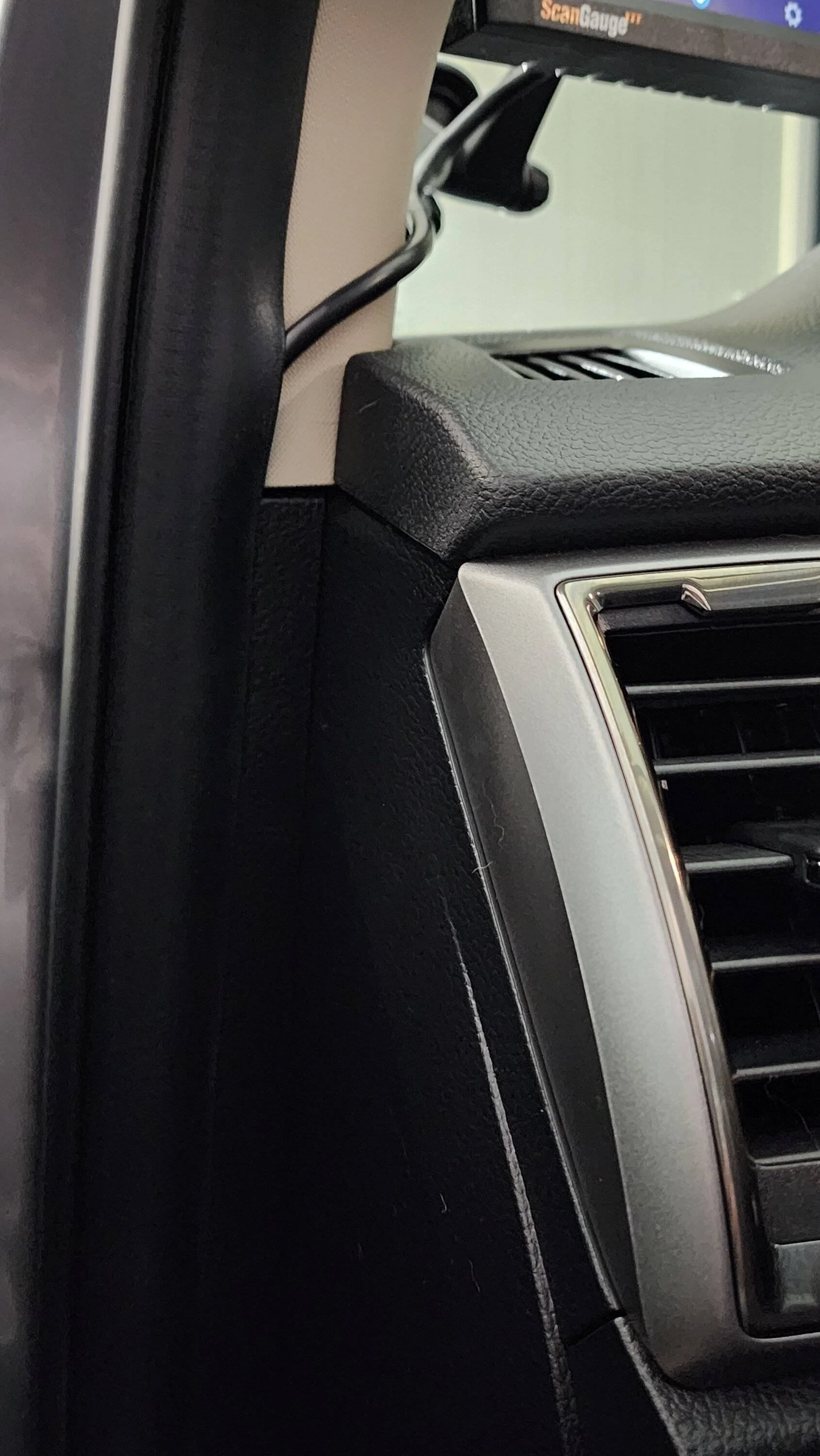

This was a couple of days ago, but I finally picked up a Scangauge 3. I'm making this post to tell you how great a purchase it was. I love it. I like seeing all the different parameters in real-time, especially the trans temp, boost, intake temp etc. And the capability I thought I would use least, the detailed fuel mileage stats, I use often already. It's just awesome. Scanning for "X-Gauges" is simple and the in-depth information you can display is just amazing. The mount is surprisingly solid while also being magnetic and it doesn't block my view of the road.
There is only 1 problem; now I want another one for my main commuter car. In short, I HIGHLY recommend procuring one at your earliest convenience.
The transmission has a temp sensor from factory or you had to add one for it to display?

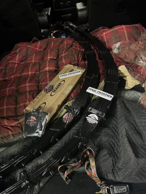

Massive shout and thanks to my friend walker of Final frontier Motorsports. Anyone is so cal area hit him up best times and prices around. C85 Chevy Deaver spring leaf springs received. Remember boys if you break it you better build it better. Btw this picture was taken of them in a expedition just for size reference.
The Scan Gauge 3 will monitor the factory sensors if available....
The Ranger does and the Gauge keeps track of trans and coolant temps.
