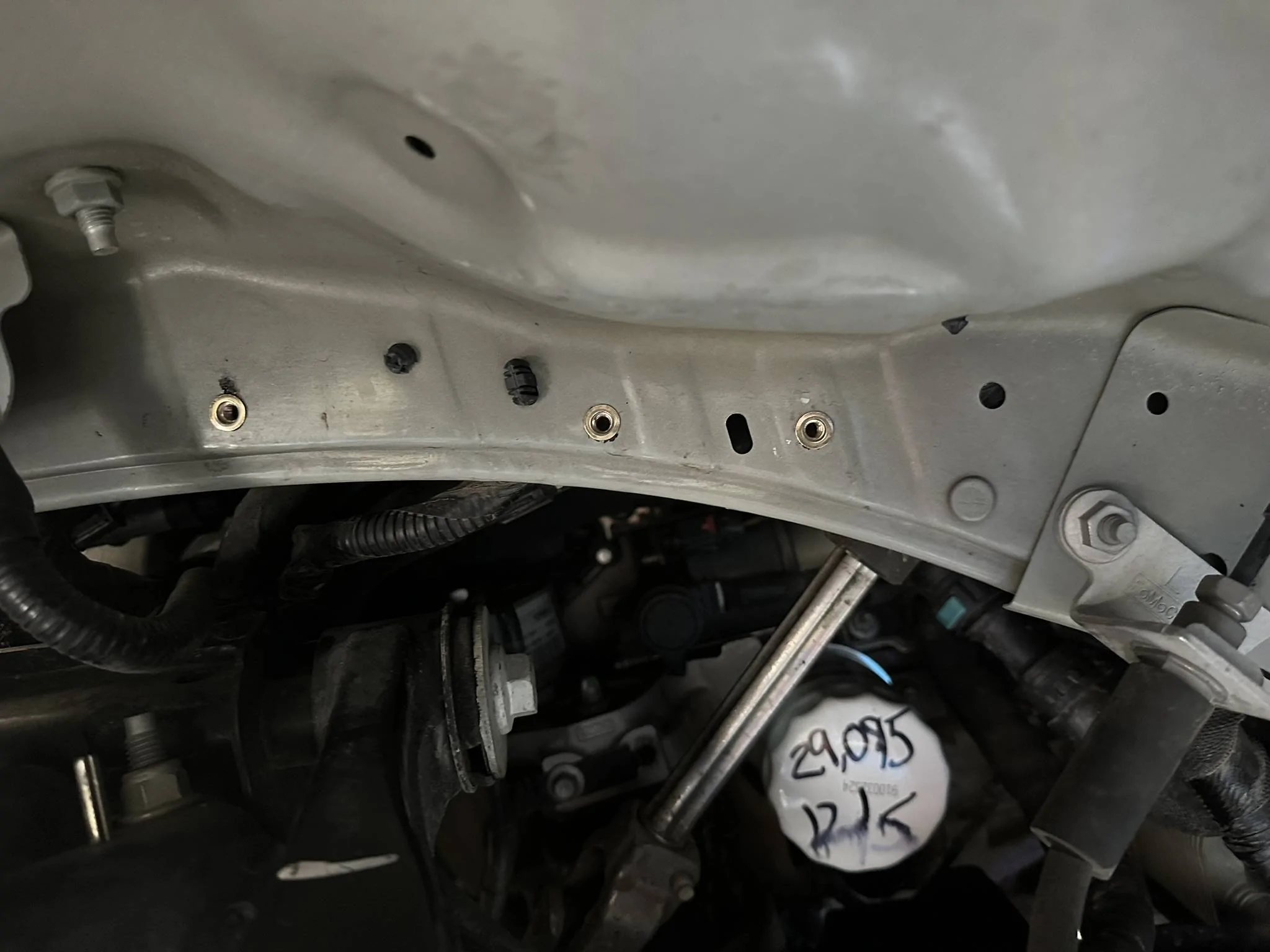

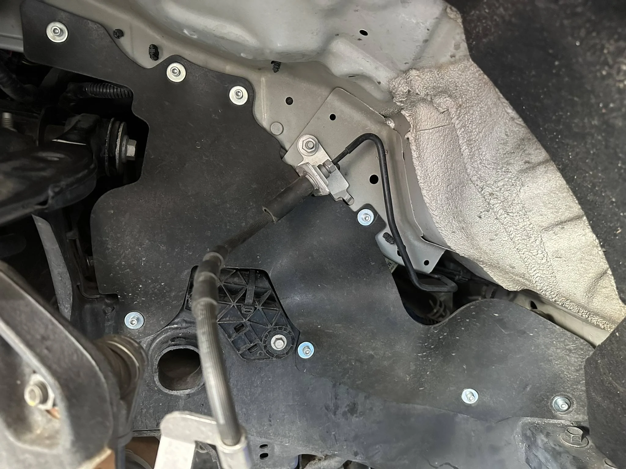

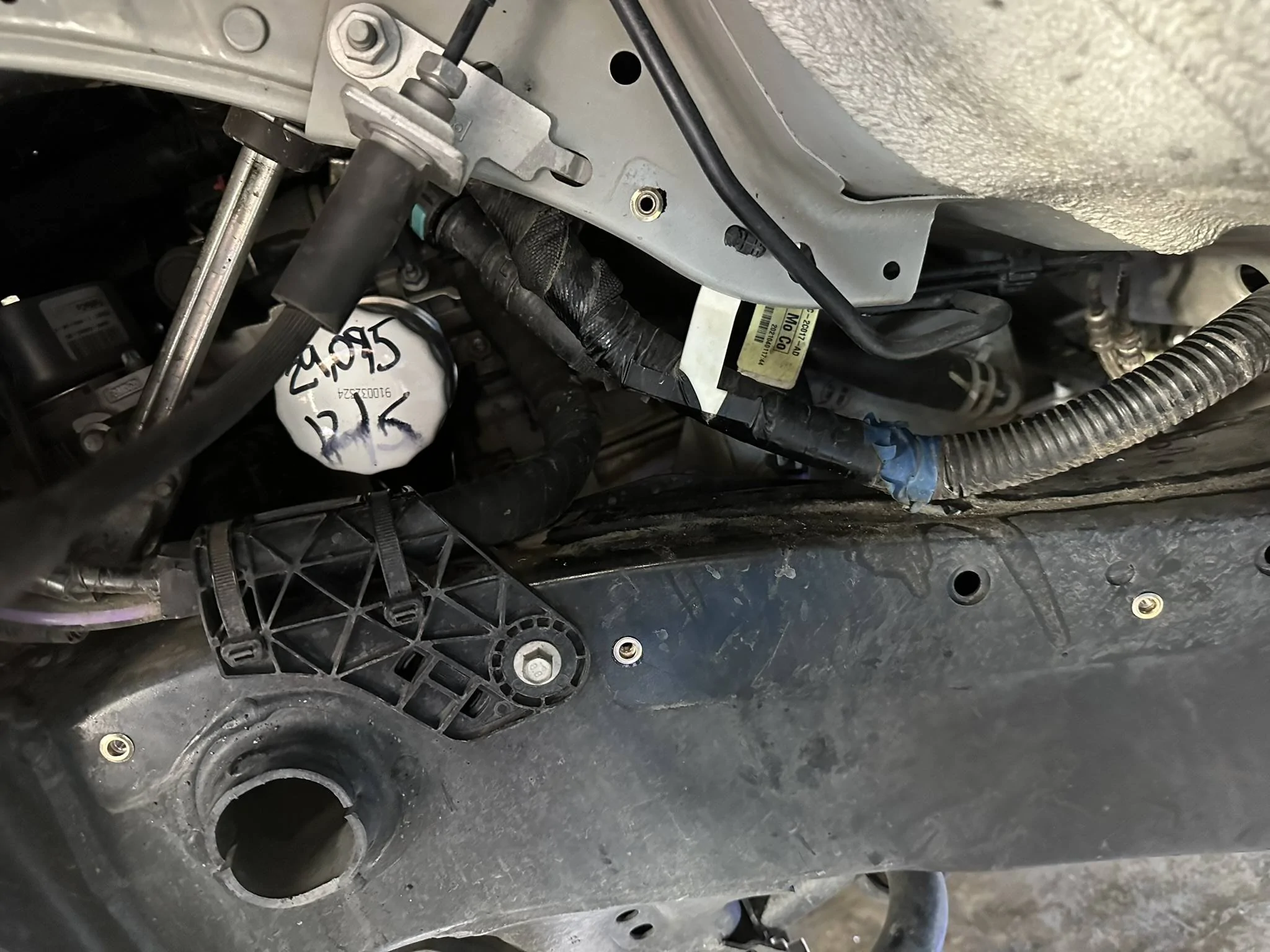

Well, I was just going to change the oil and rotate the tires, which I did, but I got fed up with the rubber flap clips, which was my fault, after some of the Ford screw/clips failed on the last oil change. I dug through the clip drawer and found some Honda barbed clips, stuck them in, it was fine. Until I had to remove them for this oil change, I had to mangle them out.
So I broke out the Nut Sert kit and put in 5mm steel inserts, I do want to get better bolts, the kind with the captured washer.
I know, would have been much easier to get the proper clips, but they are not so great even when they are new.
Did this to mine 3 oil changes ago. Used some plastic headed stainless thumb screws. No tools required, hold fine against the rubbery flap.
Similar, but I used some of the magnets some others have posted about...2 oil changes ago and they hold great.

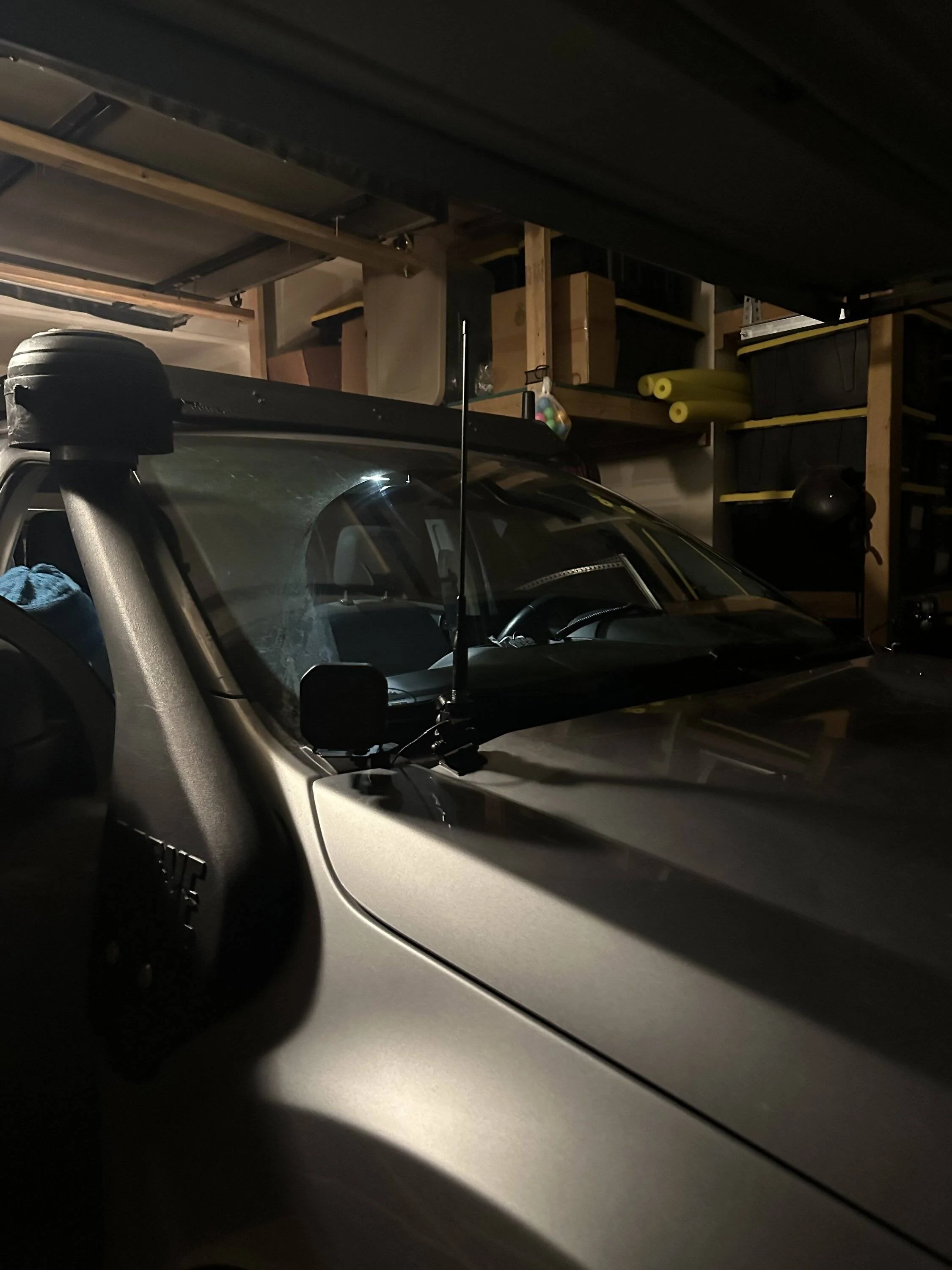

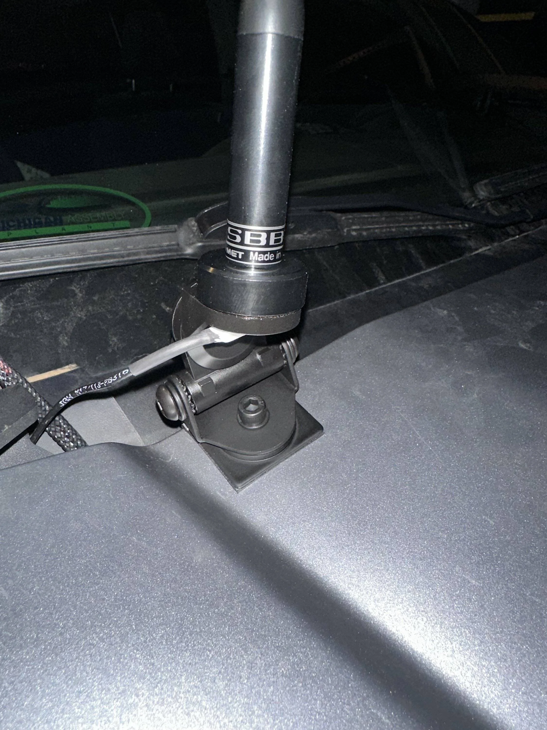

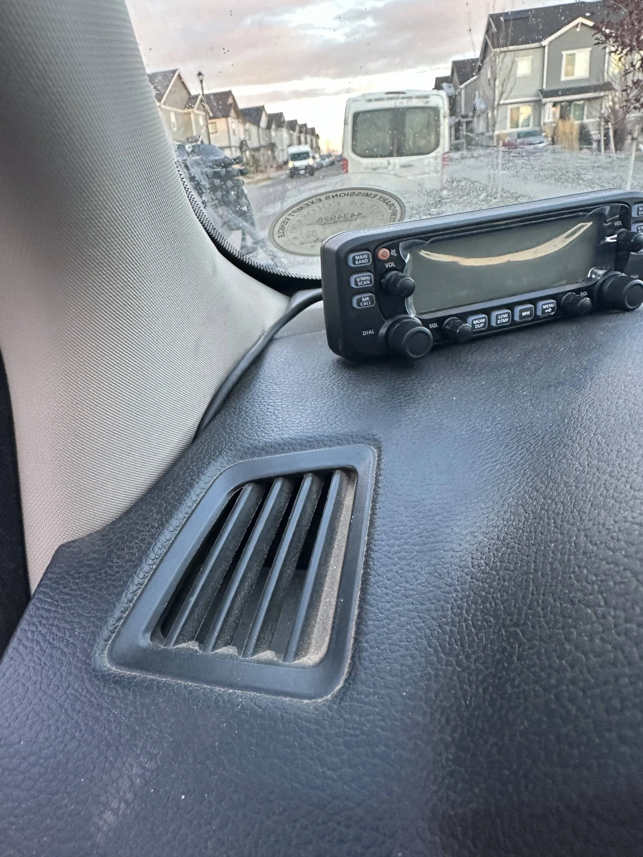

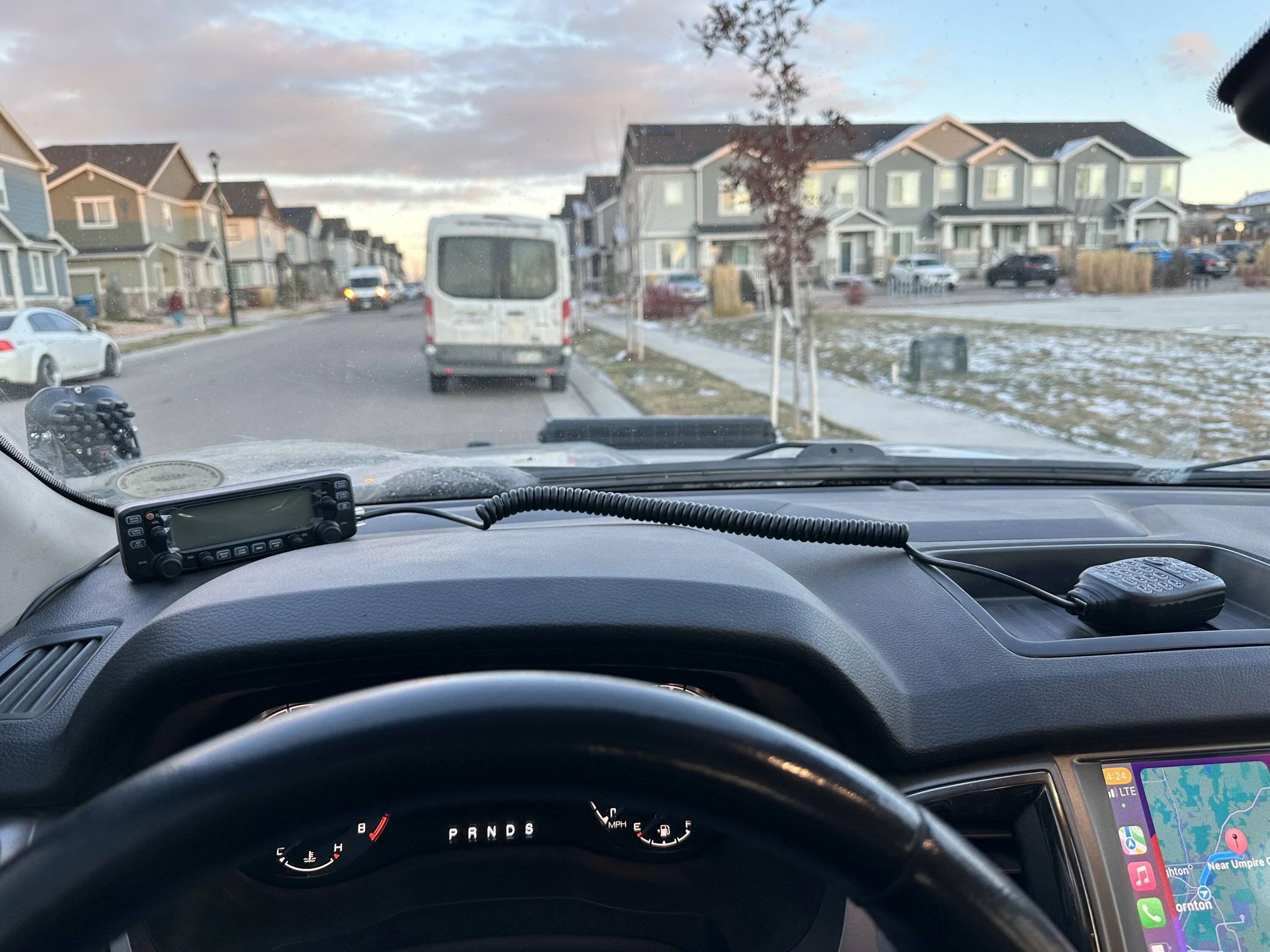

Got the Icom installed today. The mic is temporary until I find a better spot for it. I absolutely despise cables, so I need to figure something out. I’ll get a parts list and pictures of the antenna. I’m also working on a batter mounting solution for the face. The body is under the passengers seat.

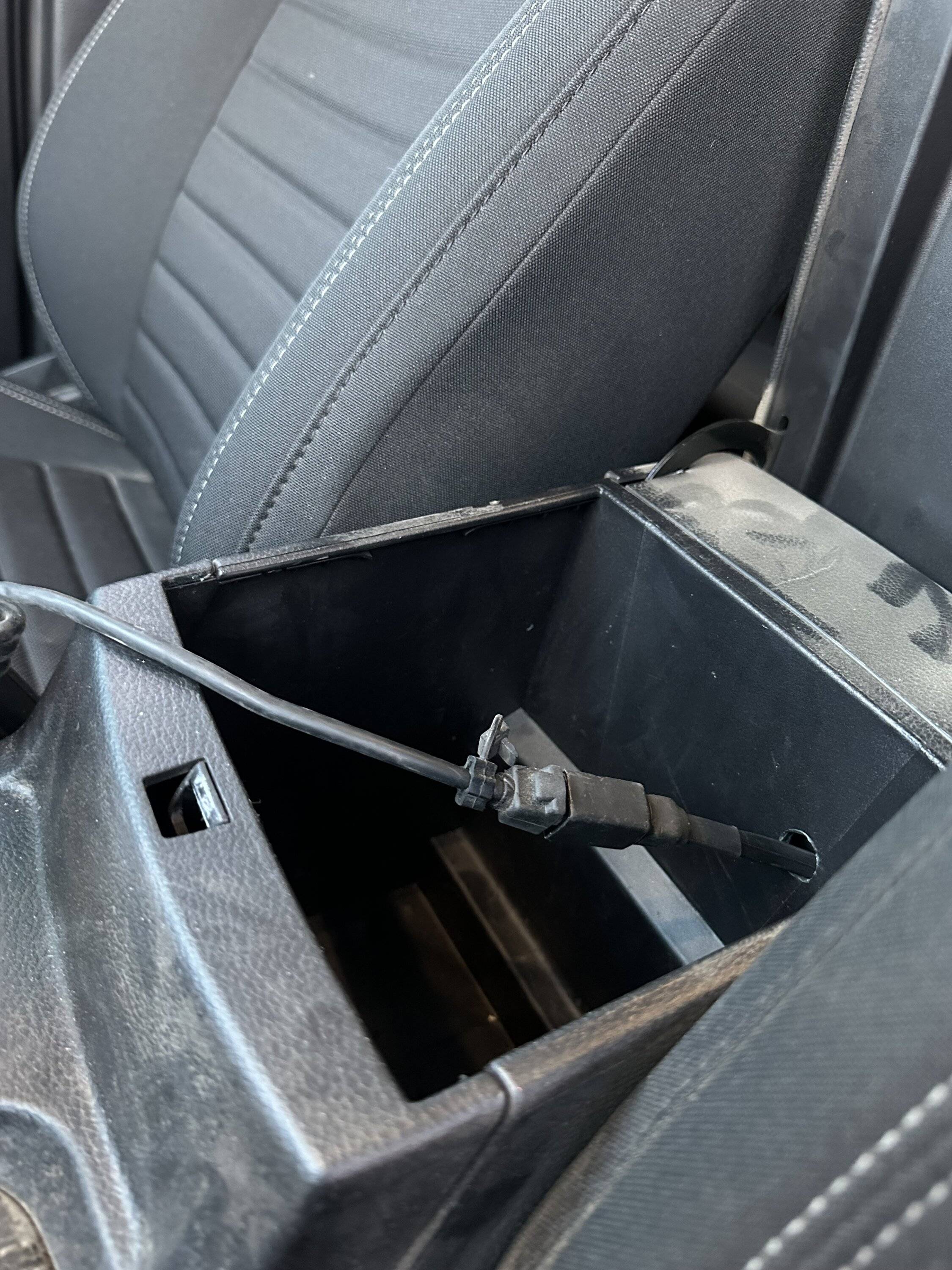

I also moved the GMRS mic cable to the center console.
This stays out of the way and does not interfere with the lid. I never used that cubby for anything anyways.
