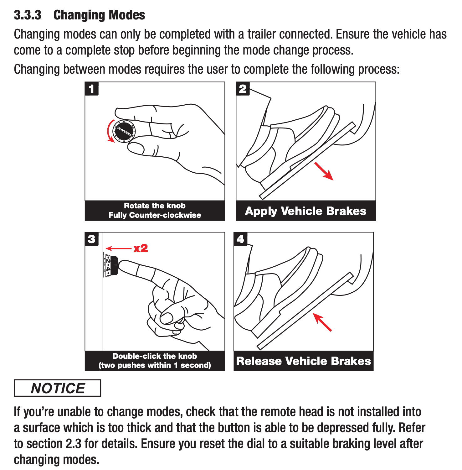

I just ordered one from my local dealership today. Thinking I might brave the install on my own. Have you had a chance to use it yet? Curious about how you change from proportional mode to driver control mode. My previous proportional controller had a brake strength adjustment knob but I could not switch between different control modes. Unless I am totally confused here, I don't think the proportional control will be ideal for offroad trailering.
From the operations manual:

I haven’t used it yet but reading the manual it seems pretty easy to swap between “automatic” (or proportional) and manual. There’s also a manual gain setting that applies to both for braking types.
For me, integration with ACC and ore-collision braking was the selling point.
