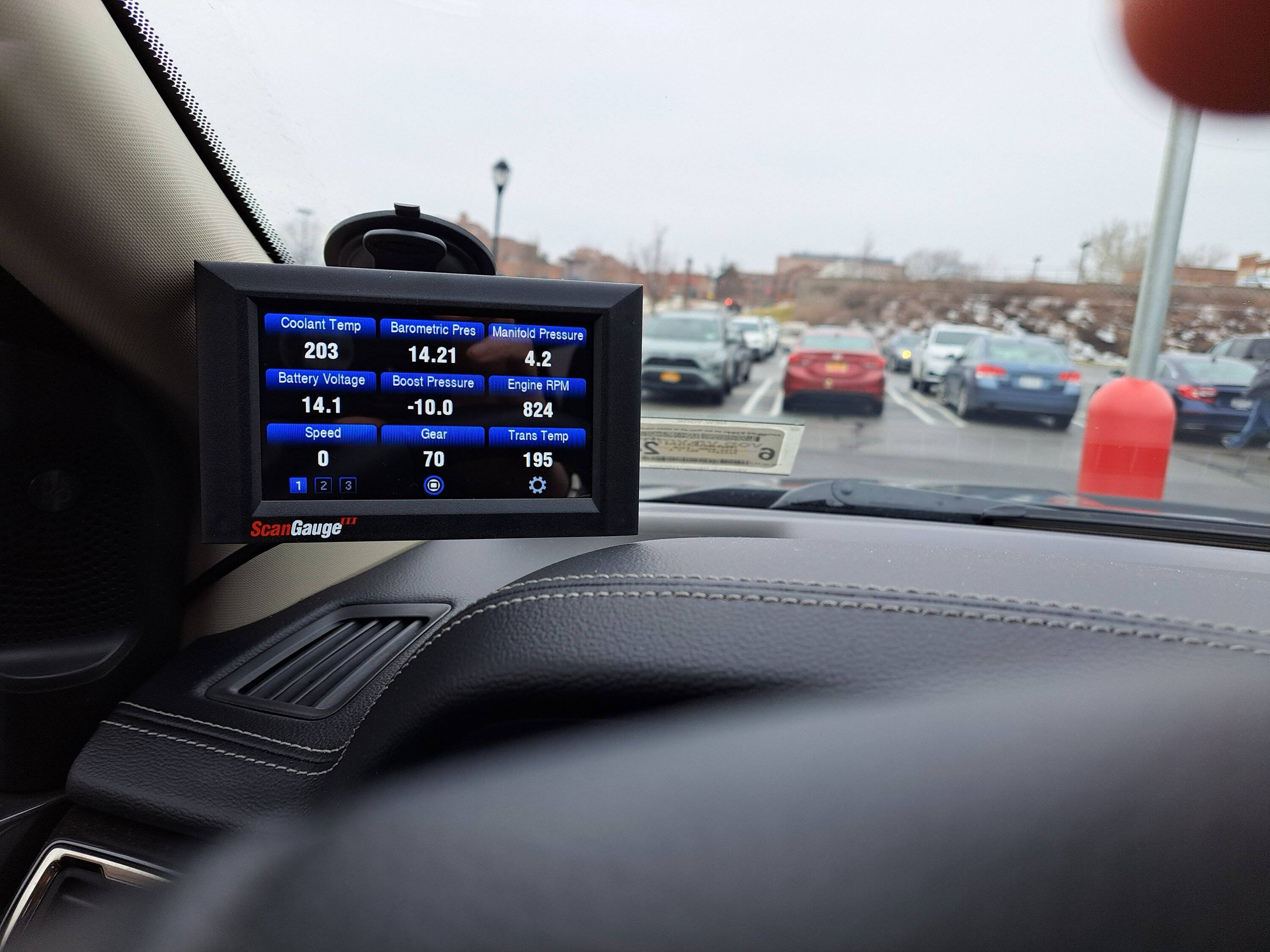

Temporarily mounted my Scan Guage III and went for a ride. Works nice but haven't found an oil pressure Gauge in it yet. Still have to set up the screens.

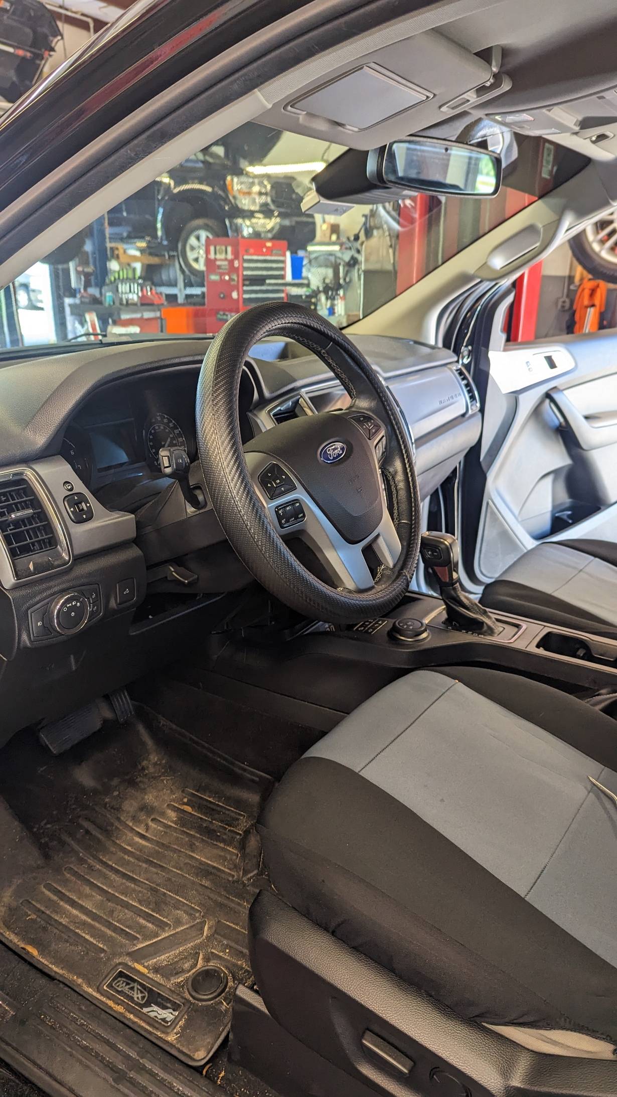

No kidding! And according to the owner of that truck I wrote, he HAD to get it fixed or get rid of the truck because having functioning HVAC in a company vehicle apparently is an OSHA requirement.! I gotta say, the tech that handled it impressed the hell outa me. He did a quick and clean job of it.
This was my first ranger dash and it honestly want bad

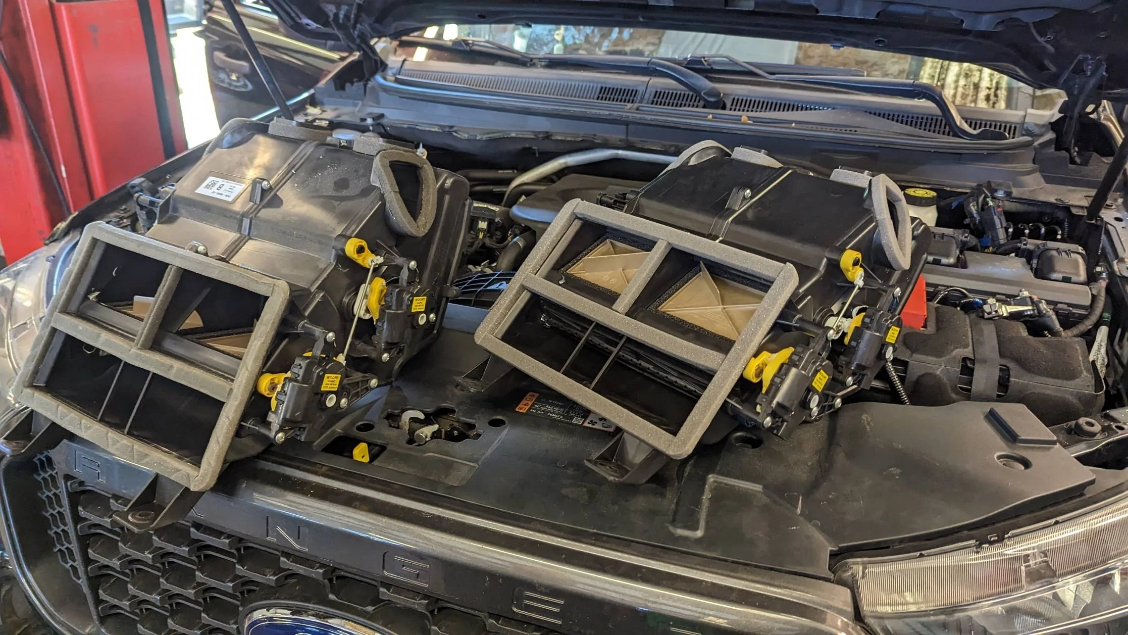

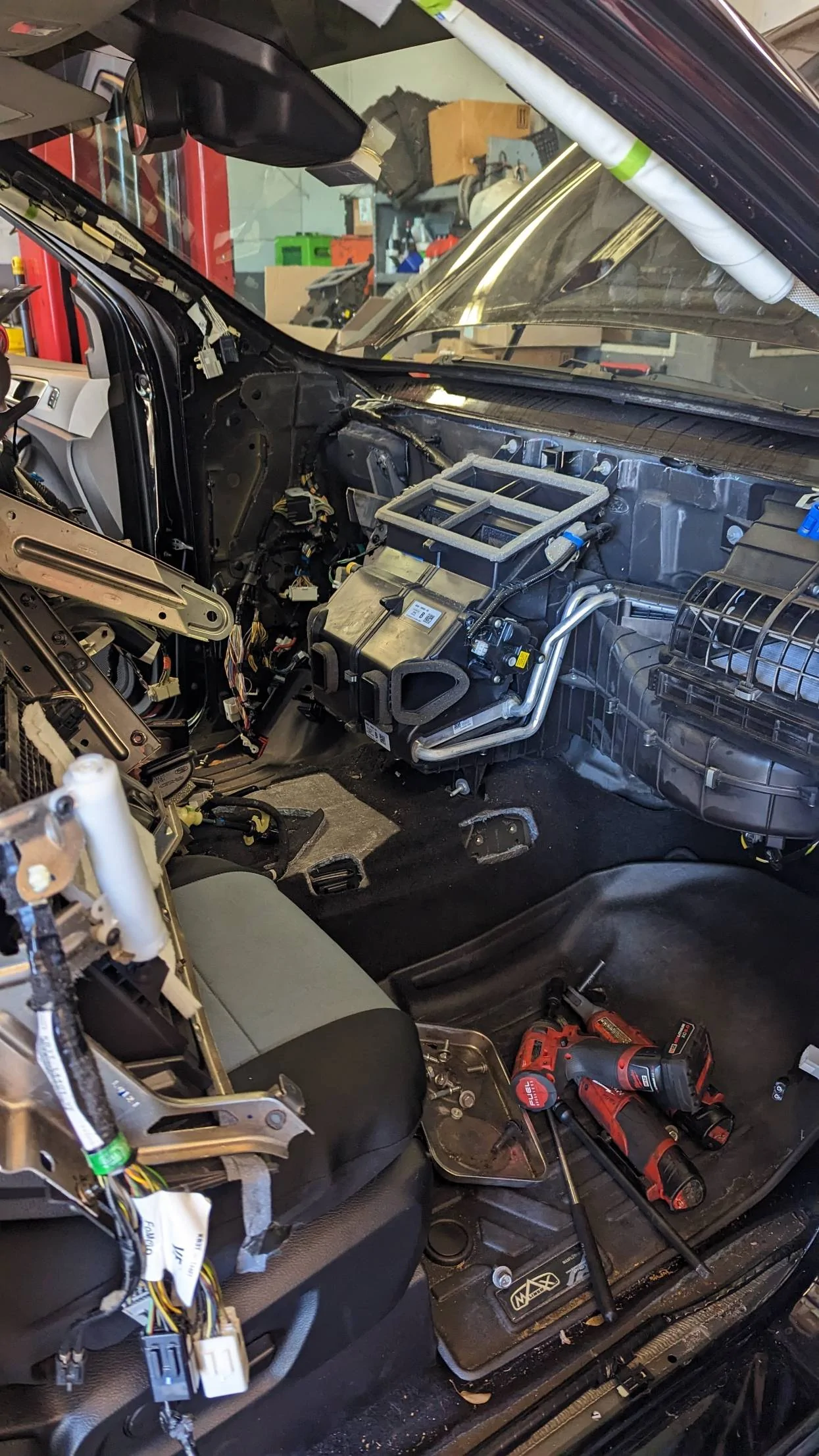

Bit of a project today on ranger. I did the original service on this truck before I bought it and I didn't notice the mode door making noise until a few days after I had bought it, everything worked fine but when I shut the truck off I could hear a buzzing noise. Traced it down to the mode door binding plus it was setting a B1086:07 code which is for Air Distribution Damper Motor component fault, which is a bit misleading as the motor works fine but because something was binding it could not move freely.
So while I still had my 60 day warranty I pulled the dash and replaced the whole upper air box assembly. Wasn't a horrible job took right at 4 hours, I was able to get the air box out and back in without evacuating the AC or removing the heater core which saved a bunch of time. Everything back together working great and I can tell a difference when I select full floor mode.
Tell @scorp, it was a damper problem..
Sorry Ed....there is no gauge or readout for oil pressure on the Fords....not the gauge, but it's the lack of info from the truck's puter.
Thanks, I can quit searching. Surprised they don't have an actual sensor. I love the gauge. Just have to move it to the center tray when it warms up so the clips are a little more flexible. I am afraid where I have it wouldn't be good if the airbags went off. Thanks for recommending it

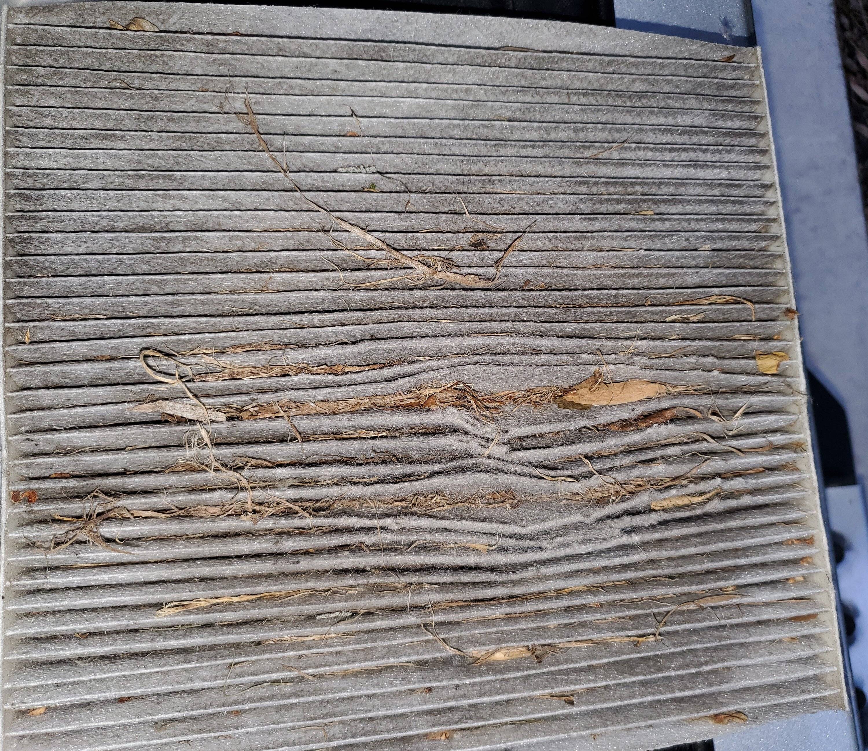

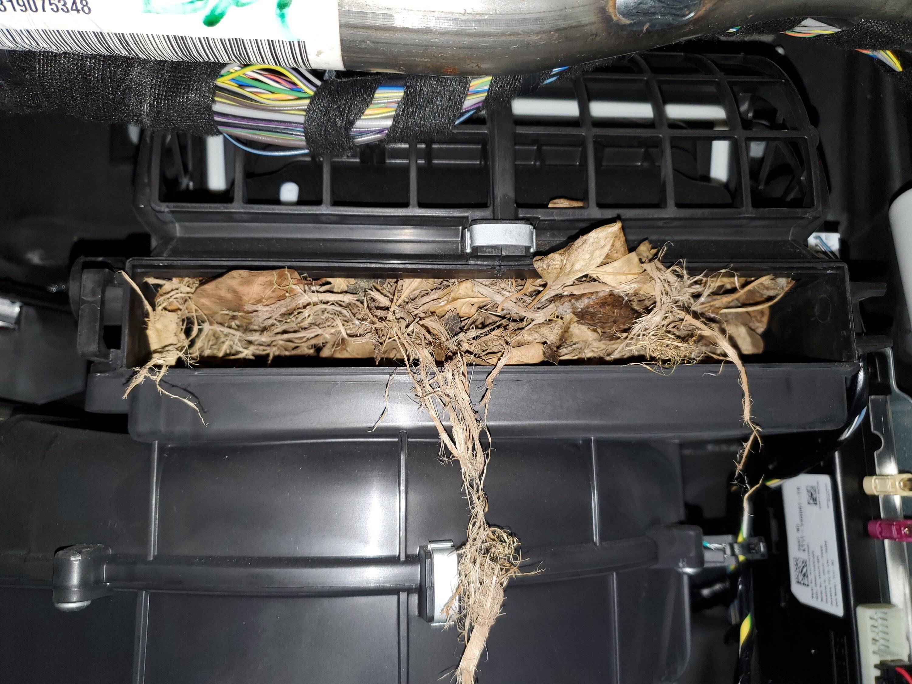

Well today I cleaned out the mess a squirrel left.
Yesterday I saw a young squirrel running around the front yard. Today my wife saw him go under the Ranger and disappear. She went over and knocked on it but didn't see him come out. I decided to check around for damage. No signs under the hood so I took it for a short drive to possibly eliminate him if he was in there. Ran fine and no squirrel. Crawled around underneath and didn't see any signs of him. Guessing he was so small and quick that my wife never saw him come out from under the pickup. Then I thought about the cabin filter. The little bastard was in and out of there a few times I would guess. Luckily, he didn't fully chew through the filter. Spent a couple hours cleaning the leaves and debris out of the fan using a short piece of garden hose attached to the shop vac. Then spent another hour taking off the cowl cover and putting a piece of old screening over the holes into the cabin. I'll be doing a more permanent fix this weekend along with replacing the cabin filter.
Also hung some Irish Spring under the hood as it has worked in my boat and old VW, but I don't run them with it in there. My wife is taking the Ranger to work in the morning which is only 10 minutes away, so I'll see if it's melted at all tomorrow night.
Thank you to all those before me who have shared their fixes!
Forscan can read the engine oil pressure, if that helps.
They do have an engine oil pressure sensor and it can be displayed in Forscan.
