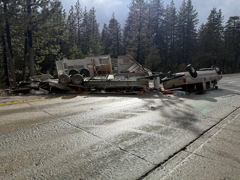

looks like the hitch stayed coupled, this from the RV fails site and apparently happened this past weekend. Seeing how many posts there are in RV fails makes me wonder what % of RVs get into accidents as well as serving as a reminder to tow safely - both in driving style and having the proper setup.
A flip like that usually occurs for only a few reasons.....
Trailer started to sway, for any of several reasons (improper loading, wind gusts) and driver couldn't control it, or hit truck brakes instead of just hitting trailer brakes to stop sway.
Trailer had a tire blow out or axle/spring gave up the ghost.....
But the trailer swaying is the usual culprit and the natural response is to hit the brakes on the truck which only make it worse.....activating the trailer brakes only will solve the problem.
Kind of one main reason I like the older type brake controllers with the separate lever....easy to activate and very controllable.

good to know but hope I never get in an uncontrollable sway situation - but I've seen fools out there towing and the trailer is swaying and they just keep on at the same speed. Also have stayed in parked when the winds are to high to be safe.
