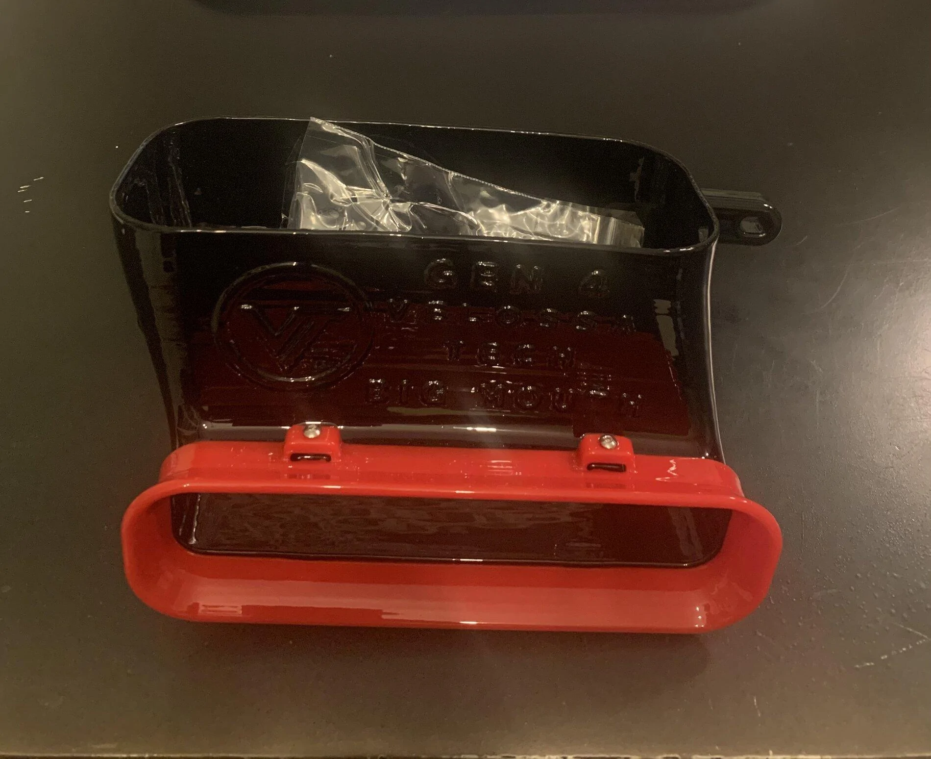

Is everyone who installed this seeing MPG increases??
Well, by now there's plenty of them out there.
What say you?

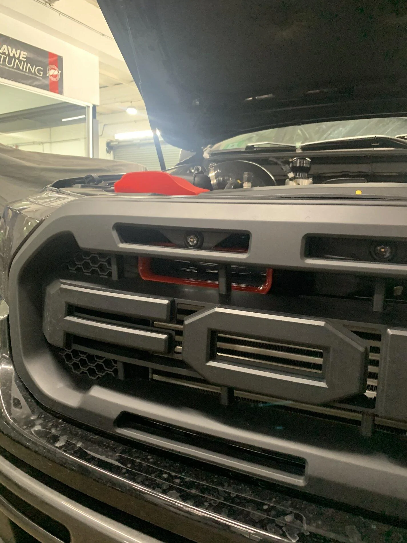

I'm curious as to why your install seem to be without issue while prior posts suggest fitment issues with respect to previously installed Raptor lights.
Could this relate to the different type of ranger grills (e.g., XL, XLT, Lariet, Raptor)?

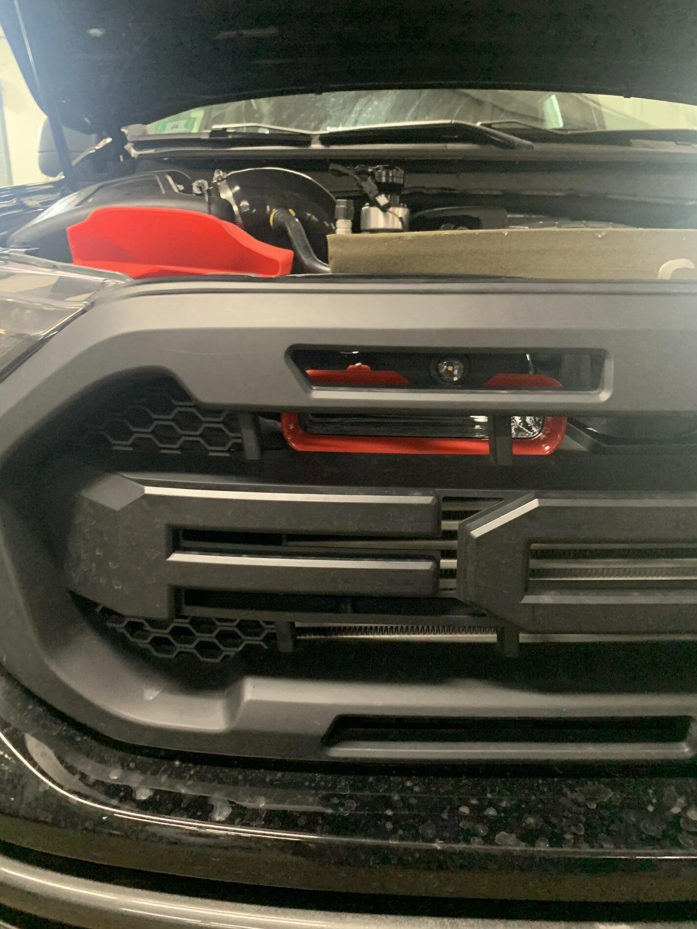

I installed the big mouth first, then I put the raptor lights on after while it was all apart. That way the end of the bracket didn't hit the big mouth whilr positioning it.

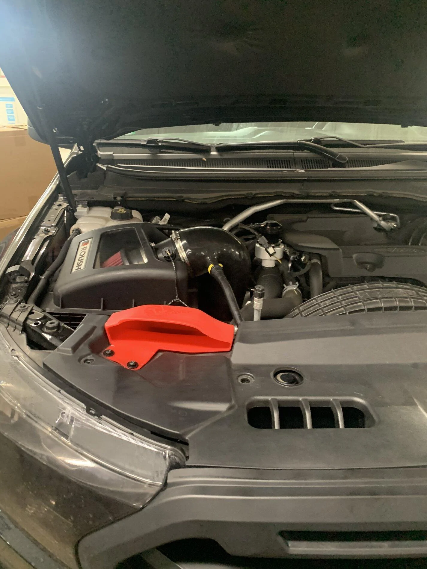

I did. I can't say the Magnum provides any tangible benefit, but comparing the stock Ford 'horn' to the AFE piece side by side I can only speculate it makes for a broader more consistent benefit when combined with the Big Mouth - which did gain better highway MPG's by itself. I'm using stock Ford filters and a tune.
At this point I've modified the air intake system on my truck with the Velossa Tech and aFe parts along with the Mishimoto intercooler charge pipes. Whether the catch can and GFB DV+ contributes much to this I can't guess - I haven't fully rationalized what the tune and exhaust contributes to overall performance.

I was disappointed with the 100.00 - 120.00 cost for a piece of plastic. However, when I did a quick calculation for the 2mpg improvement and today's gas prices and I figured it would pay for itself after about 10,000 miles. It now seems reasonable.
However, I would still like to hear back from others who installed this with the Raptor lights, especially those with a Lariet. I purchased the Raptor lights 5 days after I bought the truck and I'm waiting for warm weather before I install.
If the feedback sounds good, I'll place my order.
I have a Lariat with Raptor Lights and the Big Mouth…..a little bit of a pain to install but not horrible and the one raptor light does block the intake slightly. I have the Raptor lights from 5 -Star. No idea if my MPG improved or not. I put it on right before winter gas. I do a combo of highway and city driving and average right around 22mpg and I don’t have a heavy right foot.

Thanks for your reply. What kind of pain did you encounter?

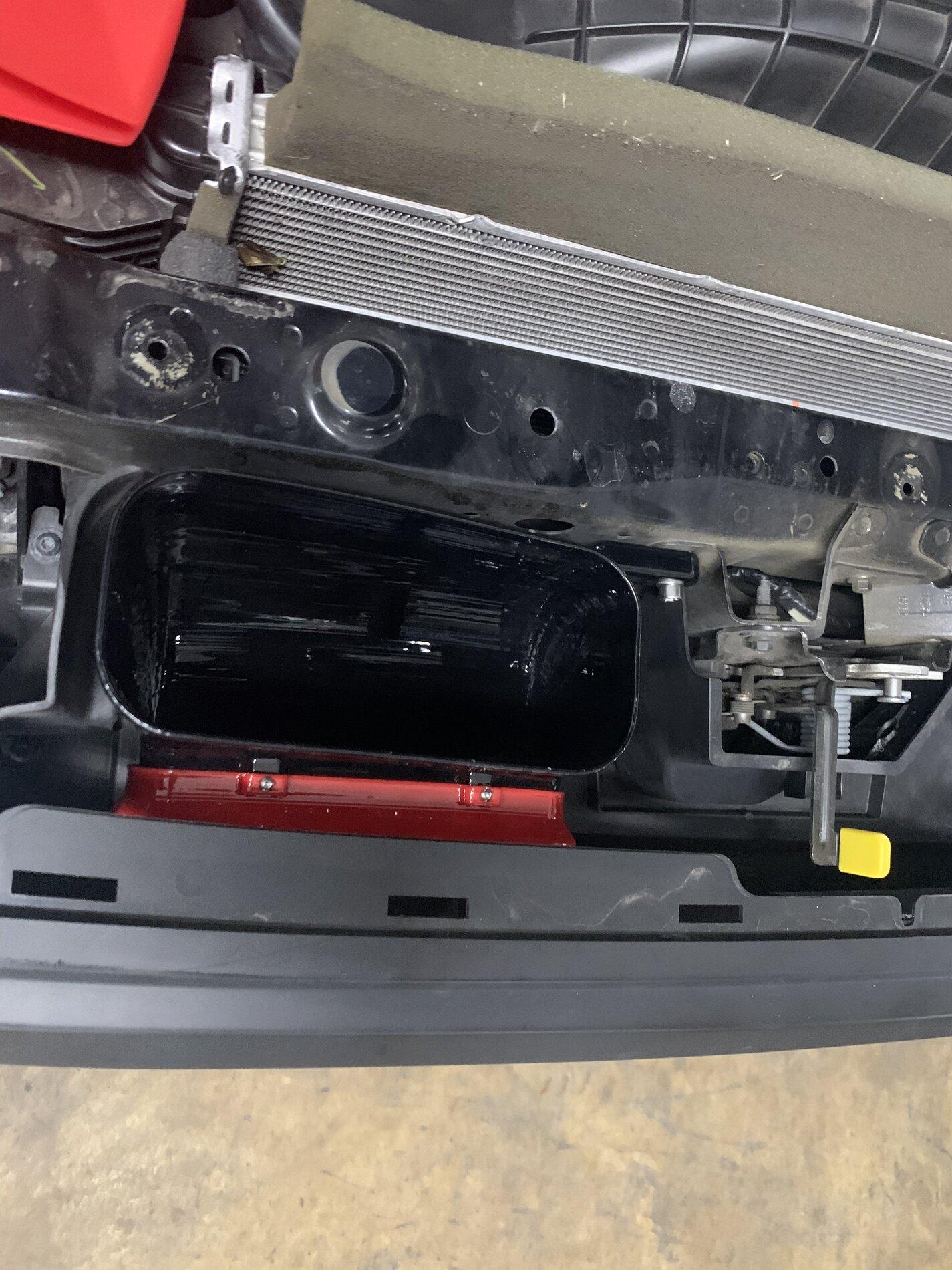

Government wanted summer blend active and changed over by May 1st this year. Pretty sure I’m on my first tank of summer blend now as the differences is noticeable.
I also opened up my apron hole to the Velossa oval size. Then added the aFe intake and there is a definite difference.
Days ahead will show a mileage bump for sure, just how much remains to be seen.
That looks familiar. Lol
Yep. Compare the aFe to the Ford part and you wonder why Ford had so much blocked off? The Ford intake horn is a two piece and leaked like a seive when I tried to measure the liquid volume. The aFe Magnum holds a Magnum of liquid- no kidding - and is a one piece molded part.
In spite of that I gained no better gas mileage, but I'd have to believe there was some net benefit.
I mean opening up the hole like I did.
