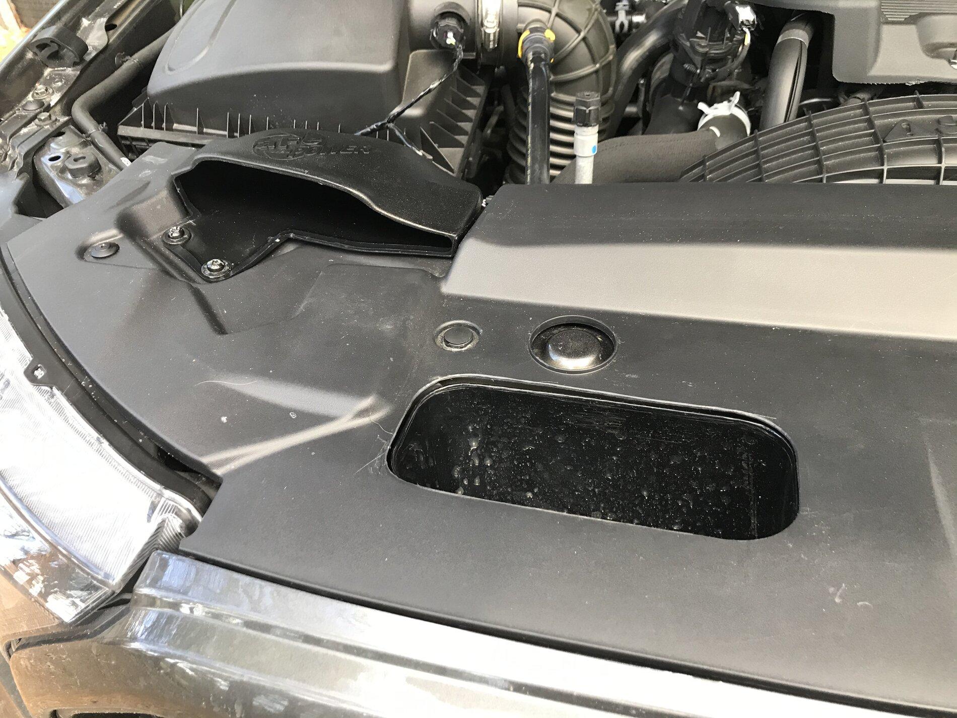

Government wanted summer blend active and changed over by May 1st this year. Pretty sure I’m on my first tank of summer blend now as the differences is noticeable.
I also opened up my apron hole to the Velossa oval size. Then added the aFe intake and there is a definite difference.
Days ahead will show a mileage bump for sure, just how much remains to be seen.

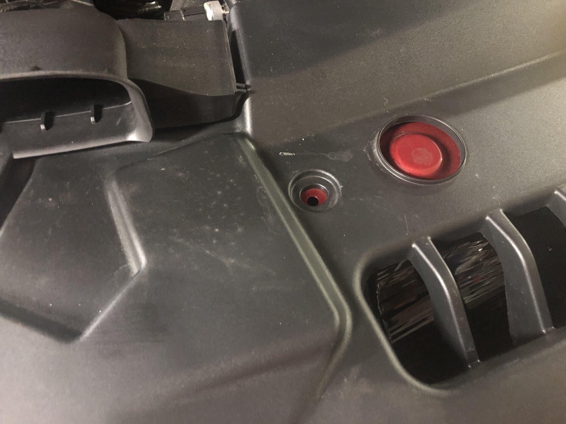

For what it’s worth, I recently noticed under my hood a small trace or evidence of dirt/airflow into my stock intake snorkel. I did not see any other traces anywhere else. I installed a Velossa Tech a few months ago ??‍♂

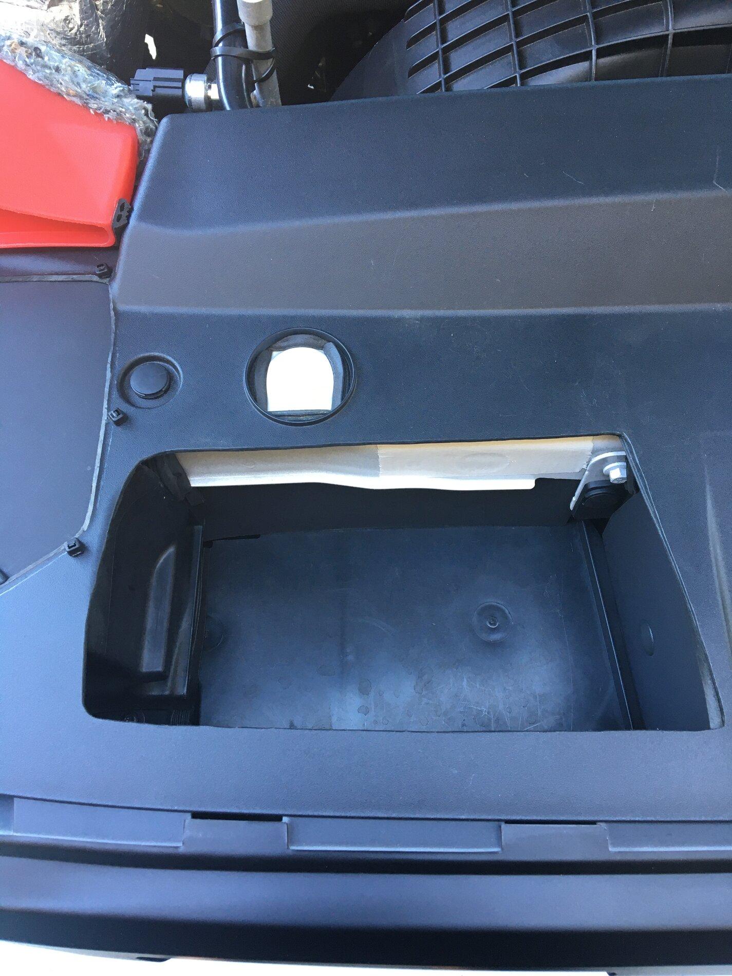

Also makes no sense why the 1/2in hump between the cowl air hole and the snorkel which narrows the airflow space between the hood and the cowl down to a measly 1/2in slit. It’s there to keep any intake noise down, same as other manufacturers building resonators into the airflow path. Ford just build it into the design of the cowl vs making it flat. So I remedied that with some kydex.

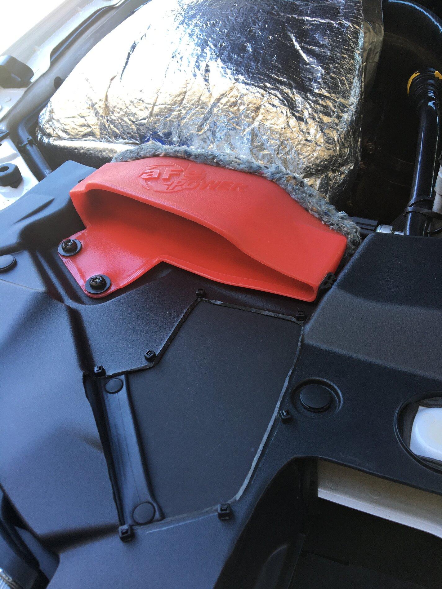

Also with some materials like Kydex, weatherstripping, plastic push fasteners, and paint matching duct tape you can can really open her up to create a Ram air type β€œbox” vs scoop, doubling the size of a cowl modded to take full advantage of the large outlet of the VT scoop.

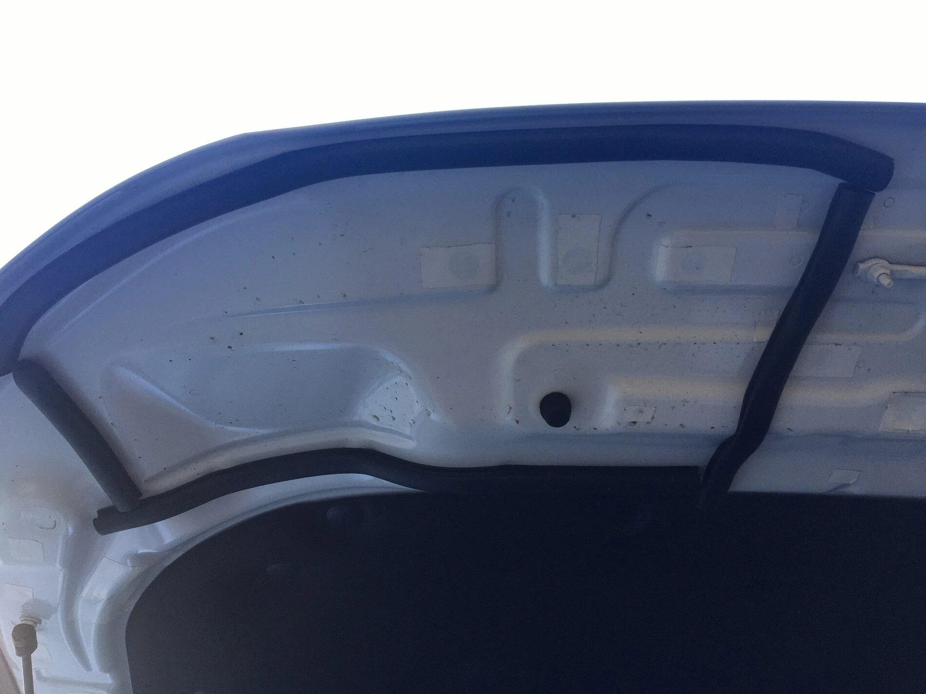

Does it work? This pic of the underside of the hood shows how much air during rain is getting directed toward the scoop. The beautifully constructed aFe scoop then smooths any turmultous airflow, allowing the airspace between the hood and cowl to become a β€œcold air plenum” vs a part of the airflow path as it is in stock formation.

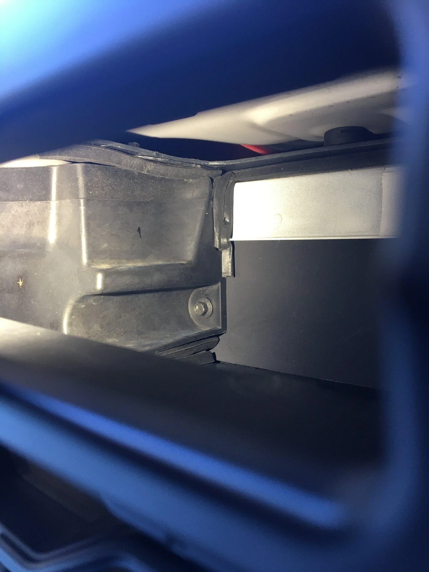

Here’s a shot of how much easier it is for air to now reach the scoop with the hood closed and a hogged out cowl with restrictions minimized. Before removing the resonator hump in the cowl and maximizing the air hole in the cowl I could not see the red of the aFe scoop.
Something to consider, the VT scoop inlet is half the size of the outlet so that it will accommodate the underside of an unmodified cowl air hole. There is room on the inlet side to make the scoop inlet as big as the outlet, maybe a future version will be that way someday. I’ve owned a VT scoop and it’s a well made piece and for those who don’t want to cut stuff up it’s worth it IMO.
