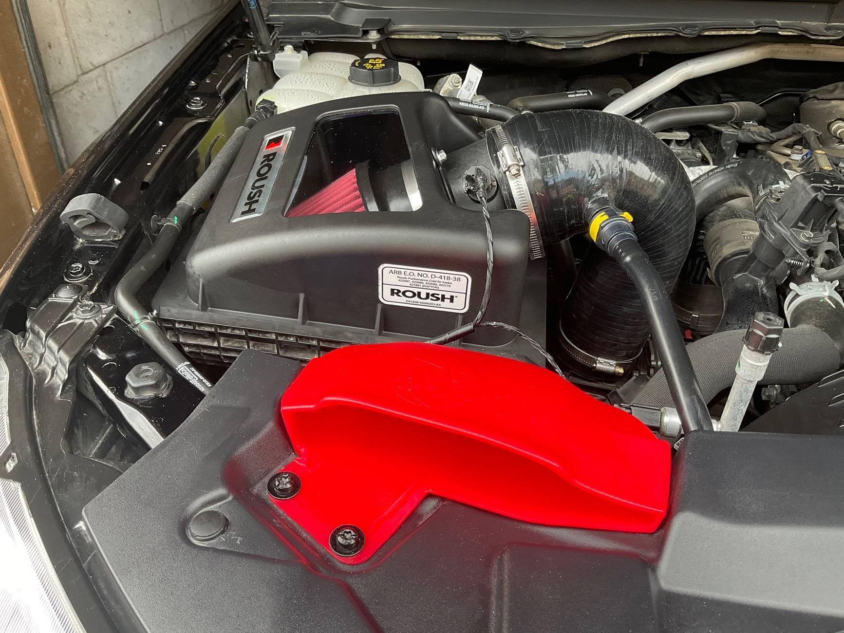

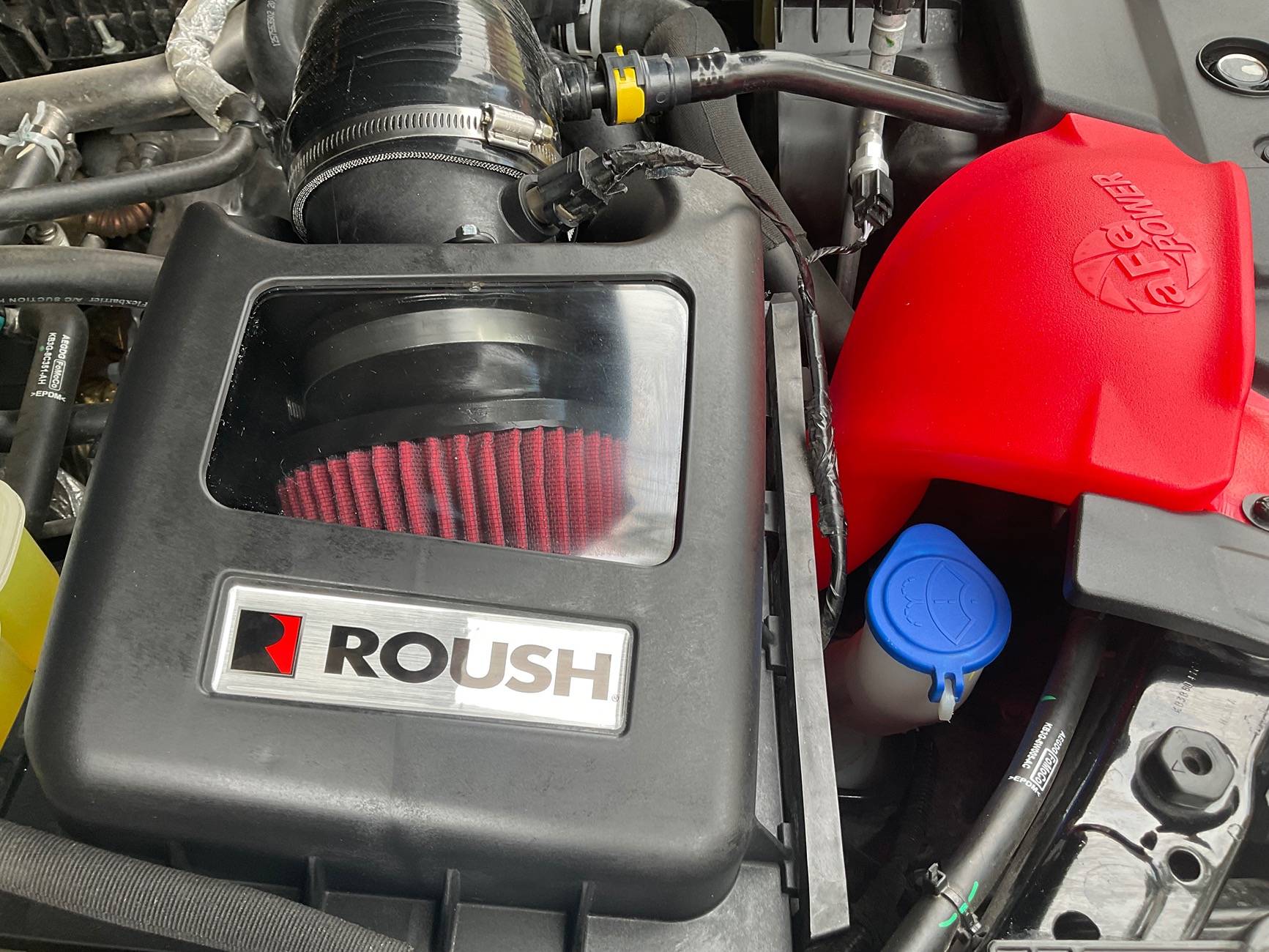

Neither the AfE or the VT does that, not even in combination. If your hood is fluttering at highway speeds something is damaged already or modified in a bad way. Especially if you are getting water blasted under the hood. As for 'blocking the radiator' let's acknowledge that's not what is in front - it's the intercooler and the VT doesn't block it, even my thicker CVF intercooler.

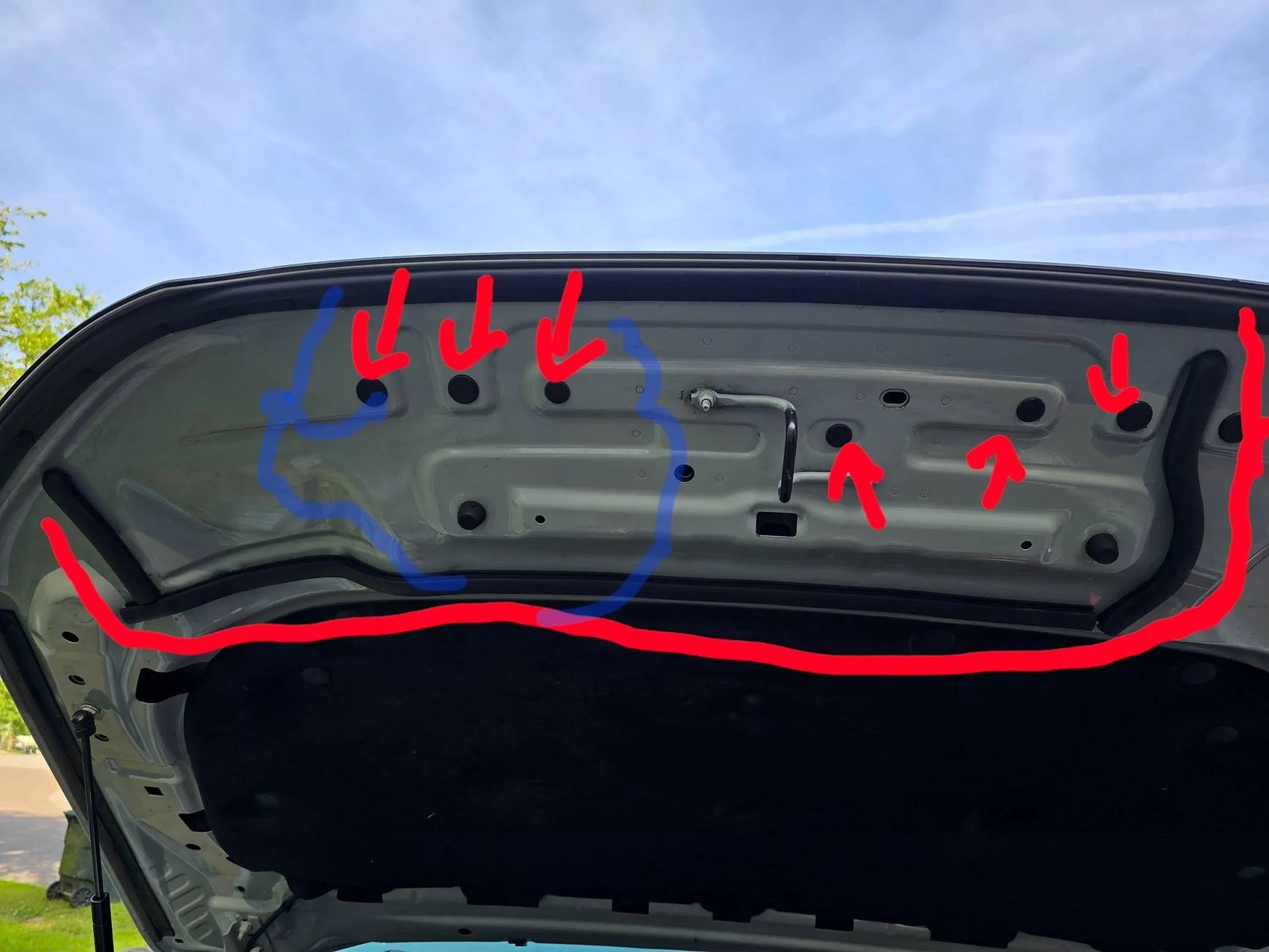

Running through those big southern rainstorms, water enters the VT and makes a nice splatter pattern above it show casing where it's putting pressure and inducing water potentially. Key word potentially, any front end scoop has the potential to do that. Heck my 85/86 F-150s feed from the grill too.

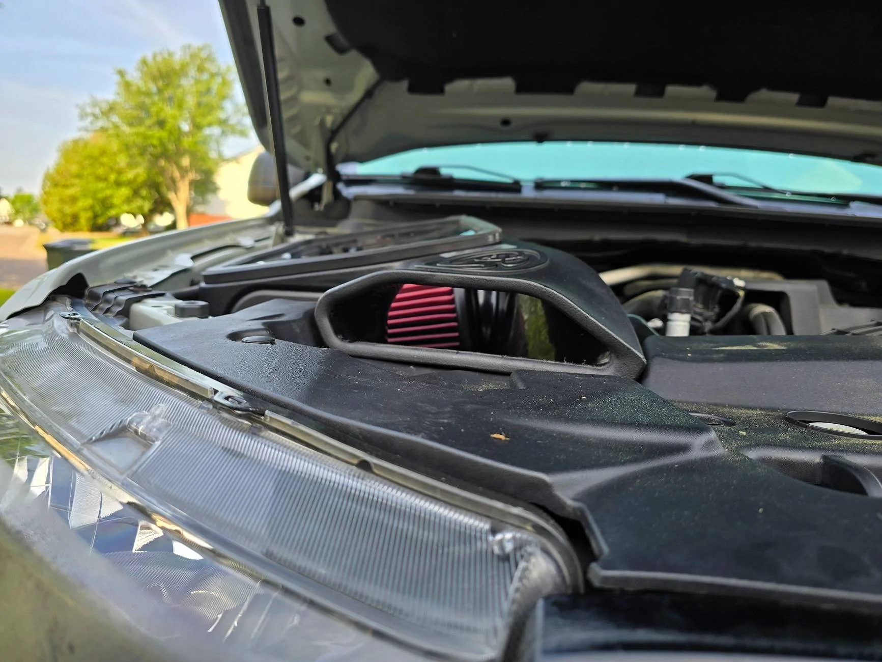

If the hood remains sealed then effectively the VT scoops air and the seals on the hood create another tube directing the air into the air box intake.
I want to scan this and make a 3d printed connector. That combined with the VT and SBE airbox would give a continuous tube from the grill to the airbox.

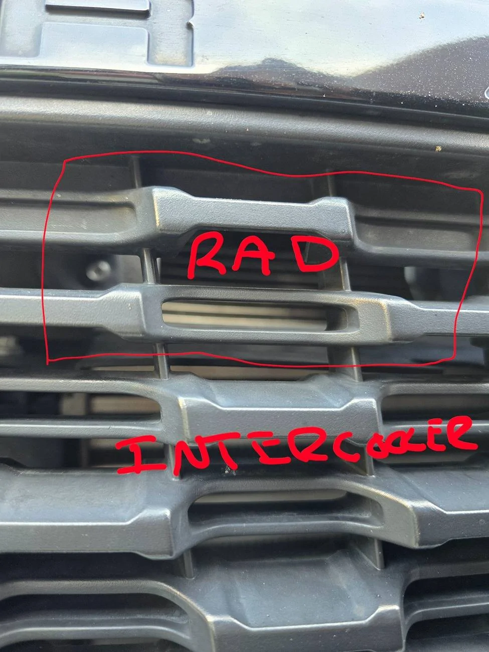

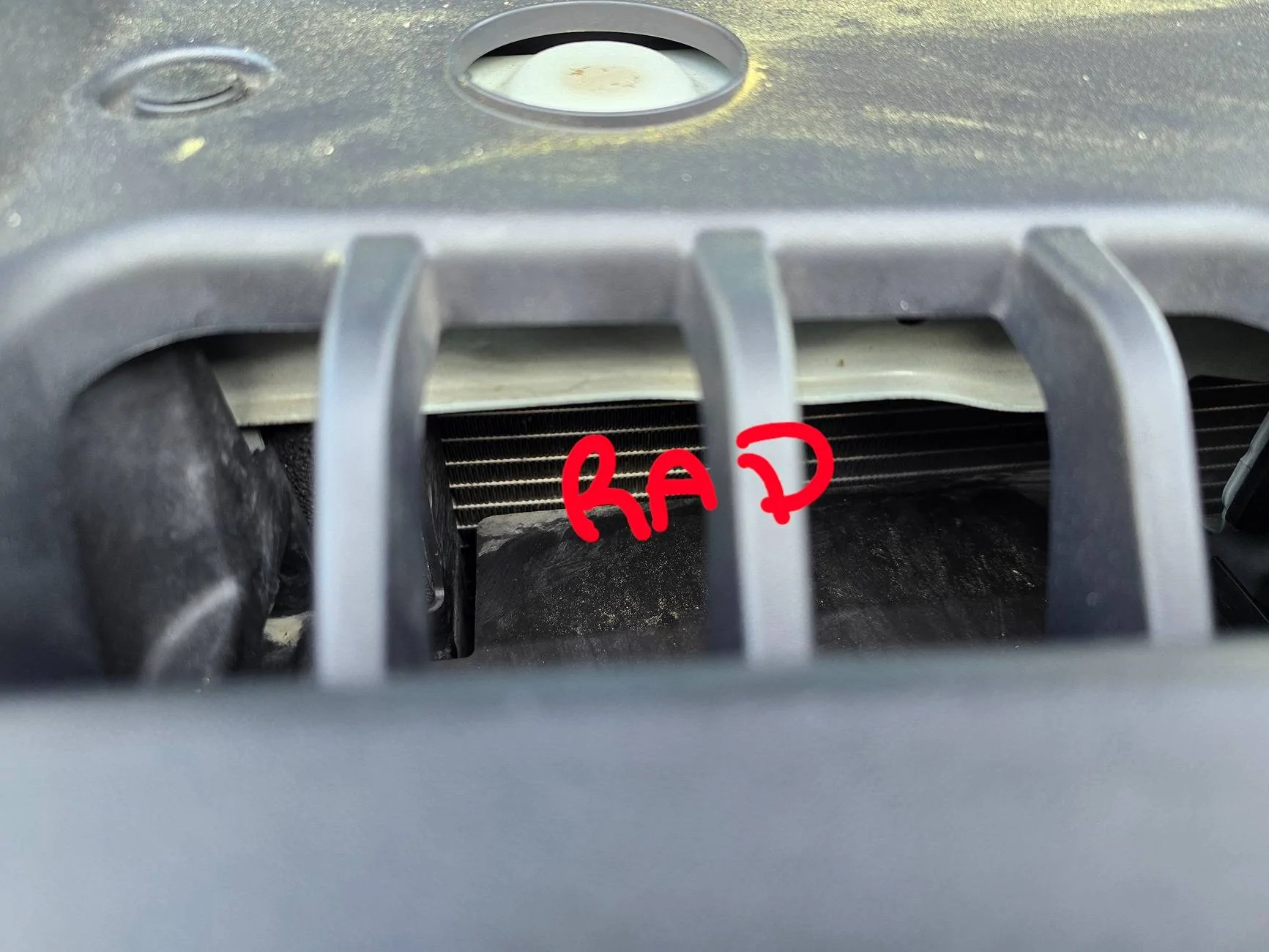

Now, let's address something you said before. The VT does block the radiator not the intercooler. It sits on top of the intercooler directing airflow through the radiator cover into the space created by the hood. This is why your big chunky CVF intercooler is not impacted by the VT intake. Above that area there are holes in the hood. I plugged these (red arrows. The blue mark is where I was getting water splatter.
