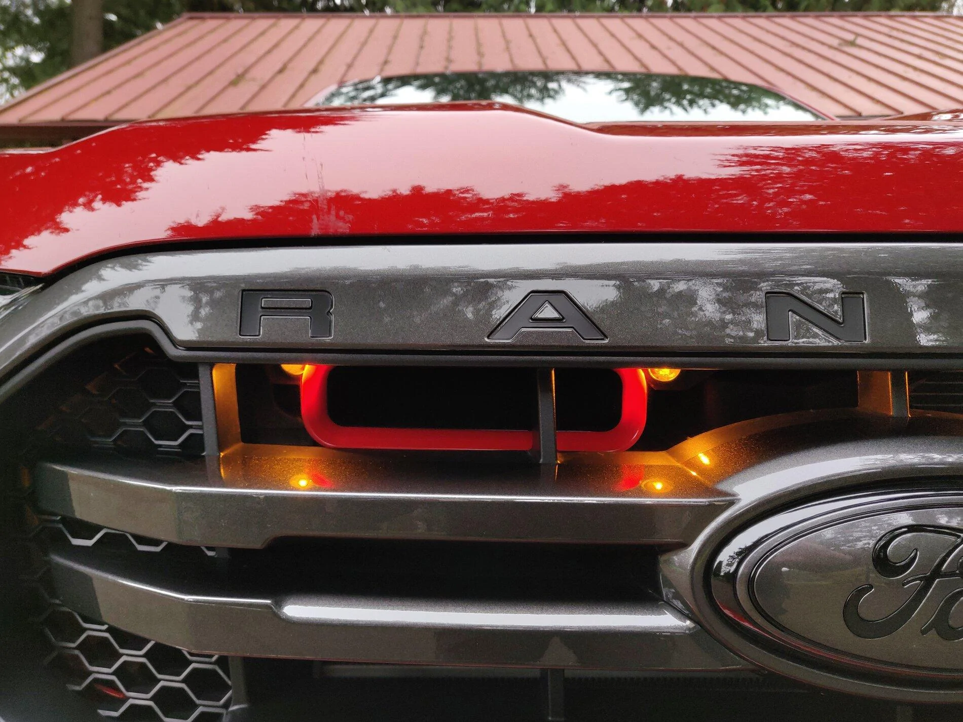

You are correct, it doesn't fit with the Lariat grill lights without modifications. In addition to dremeling the bracket, I had to use some L-brackets I had laying around the garage. Initially I tried bending the bracket tabs backwards but ended up breaking one off. At that point I just cut off the other one off and McGuivered things with the L-brackets. This moved the lights up and back a little bit but cleared the Big Mouth. It's a hack job but turned out OK. There is very little room back there making it a bit aggravating. Attempt at your own risk.

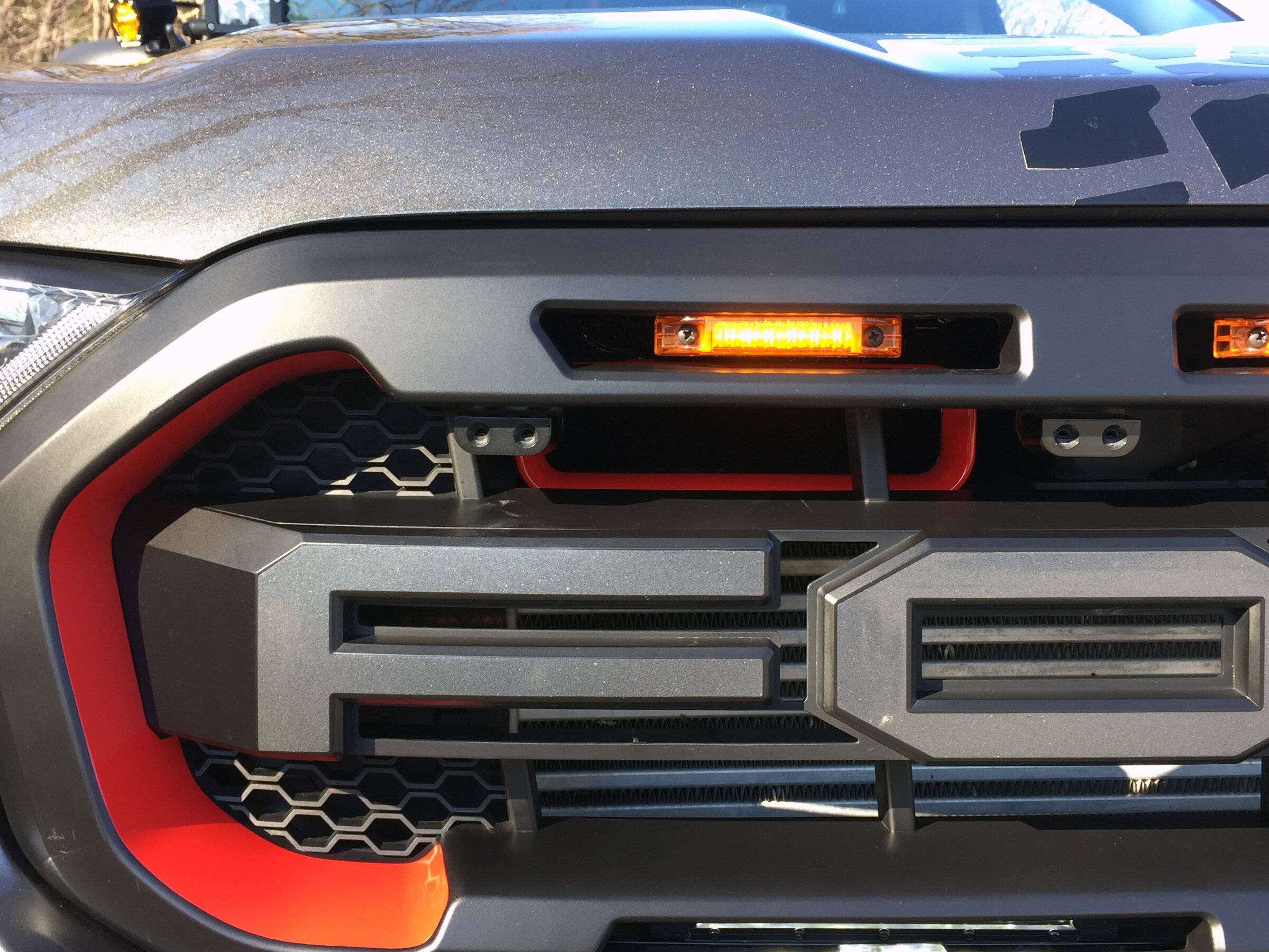

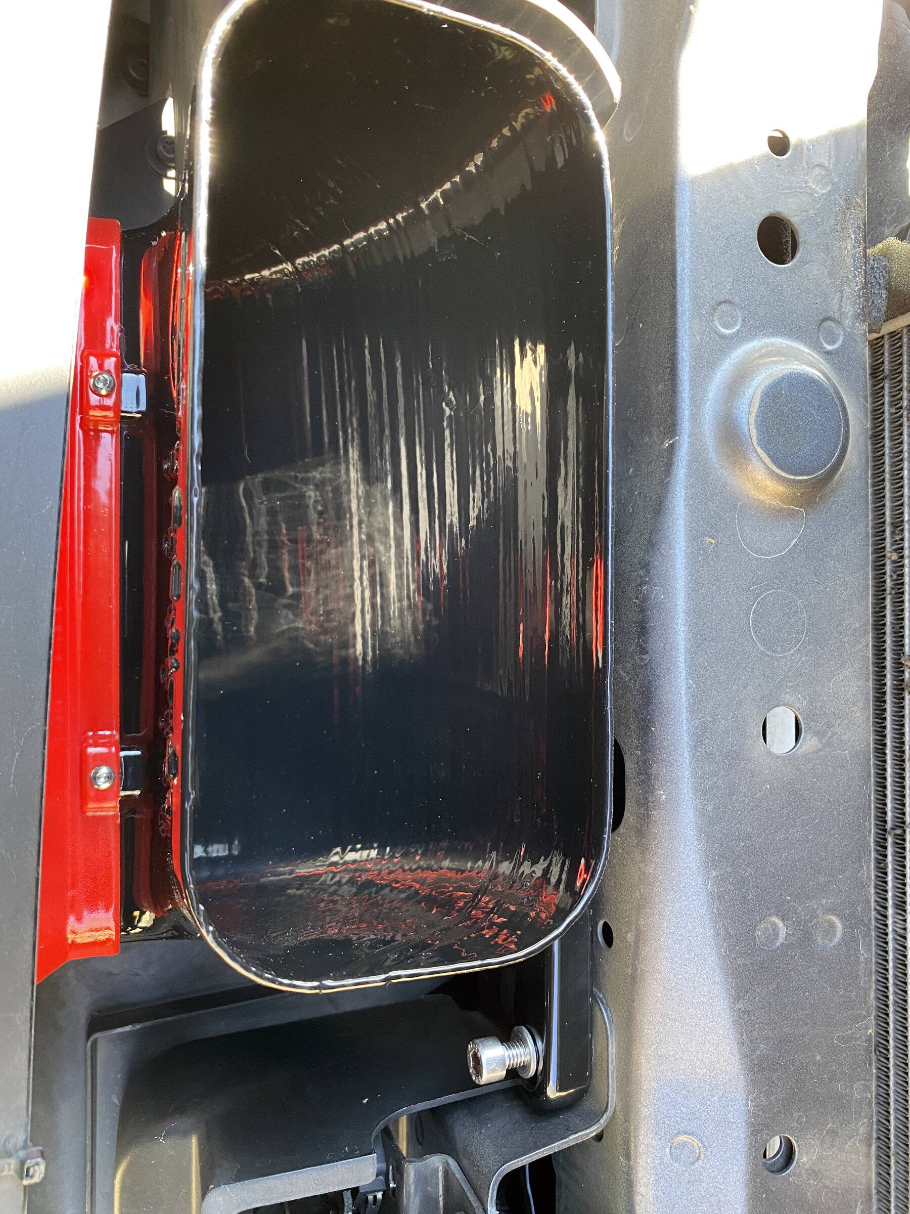

Fit on my lariat with Raptor Lights. Maybe not as wide open but it fit. I have the 4 white LED Raptor light kit from Stage 3 Motorsports. Excuse the dirt, we've been getting hammered with snow in NE Pa.

Would someone mind posting more of a top down view of their install? I would like to get a better idea of how this intake is routed from the grill to the air box. Thanks.

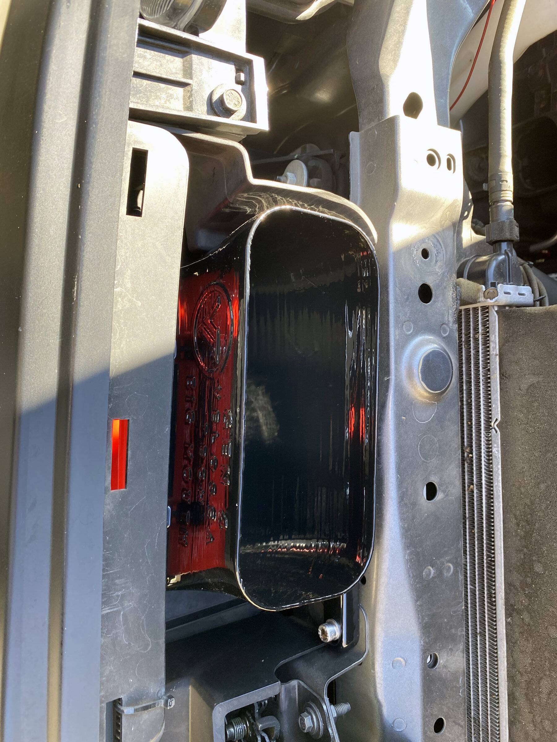

How does this direct air to the intake snorkel?
Looks like it just directs air up and over the core support.

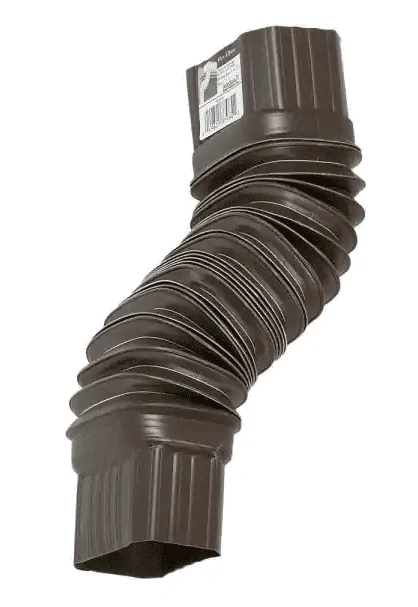

I can't believe they found a market for a couple inches of plastic for $120 something dollars.
I bet the mark-up on that is awesome for their bank account.
I've considered making something out of $10 in PVC piping of some sort and painting it.
Home Depot - <$5
