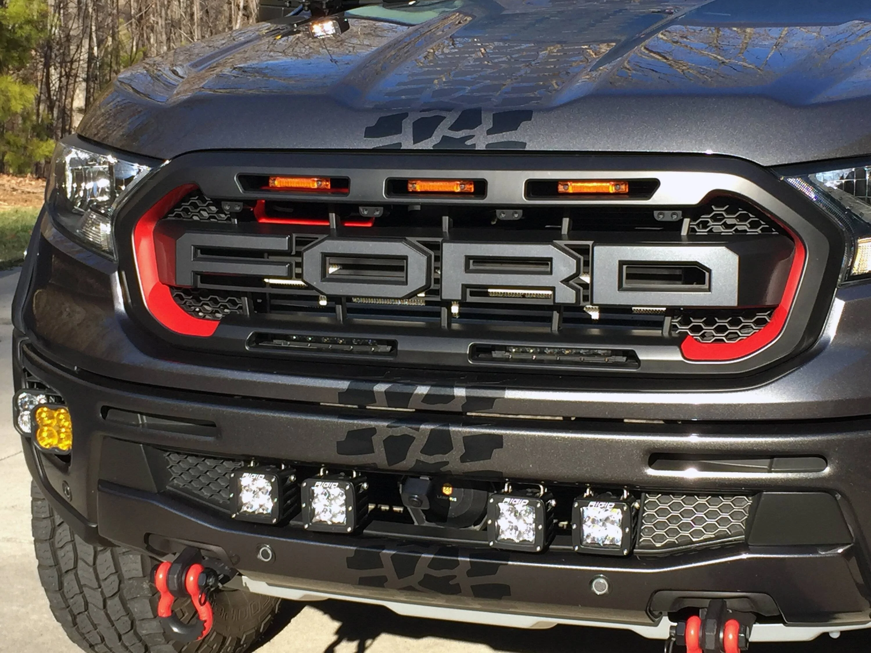

Looks excellent! I went with black so it isn't very noticeable and it's obscured a little by the grill light Still seeing mpg improvements even with winter gas.

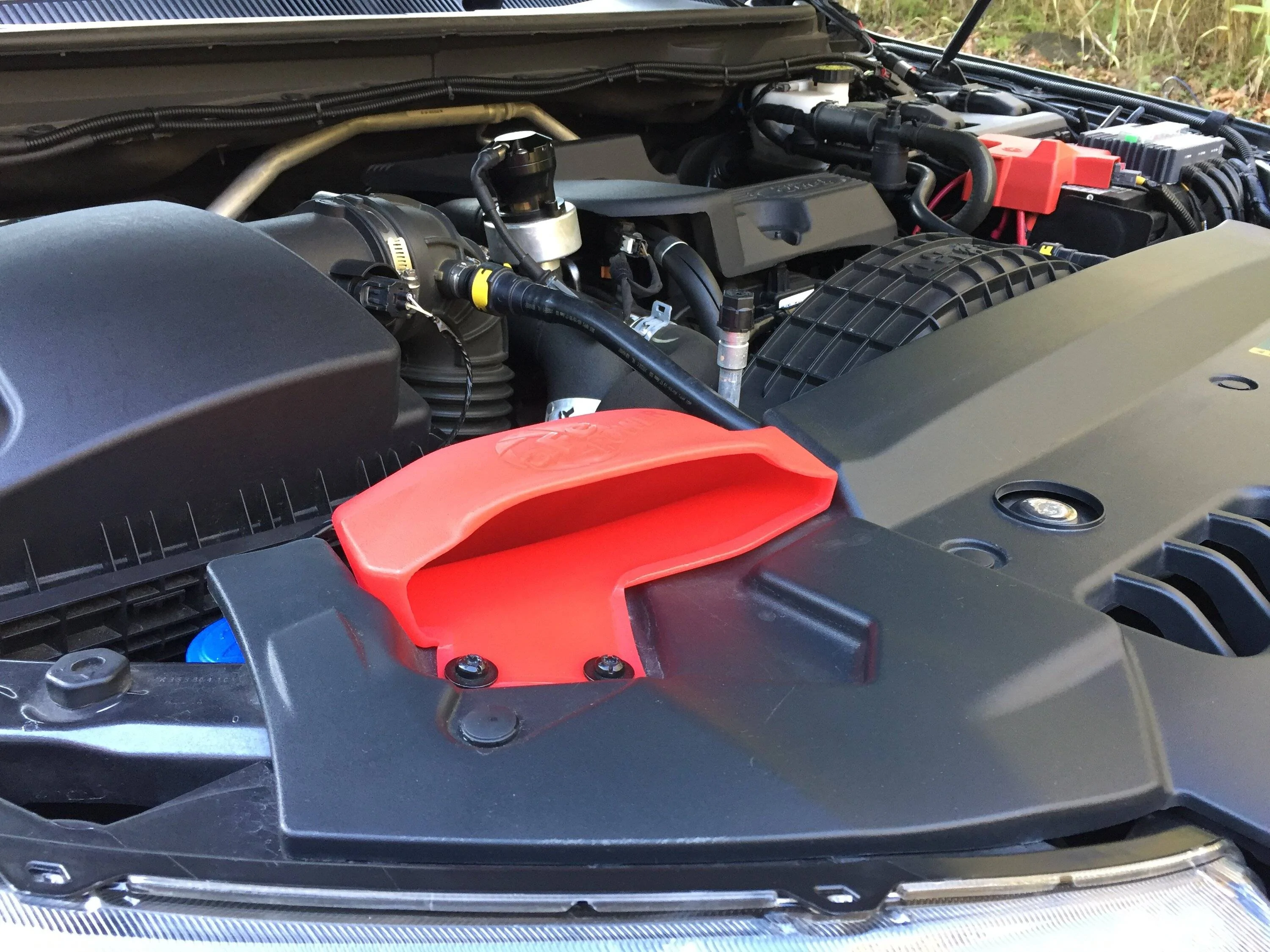

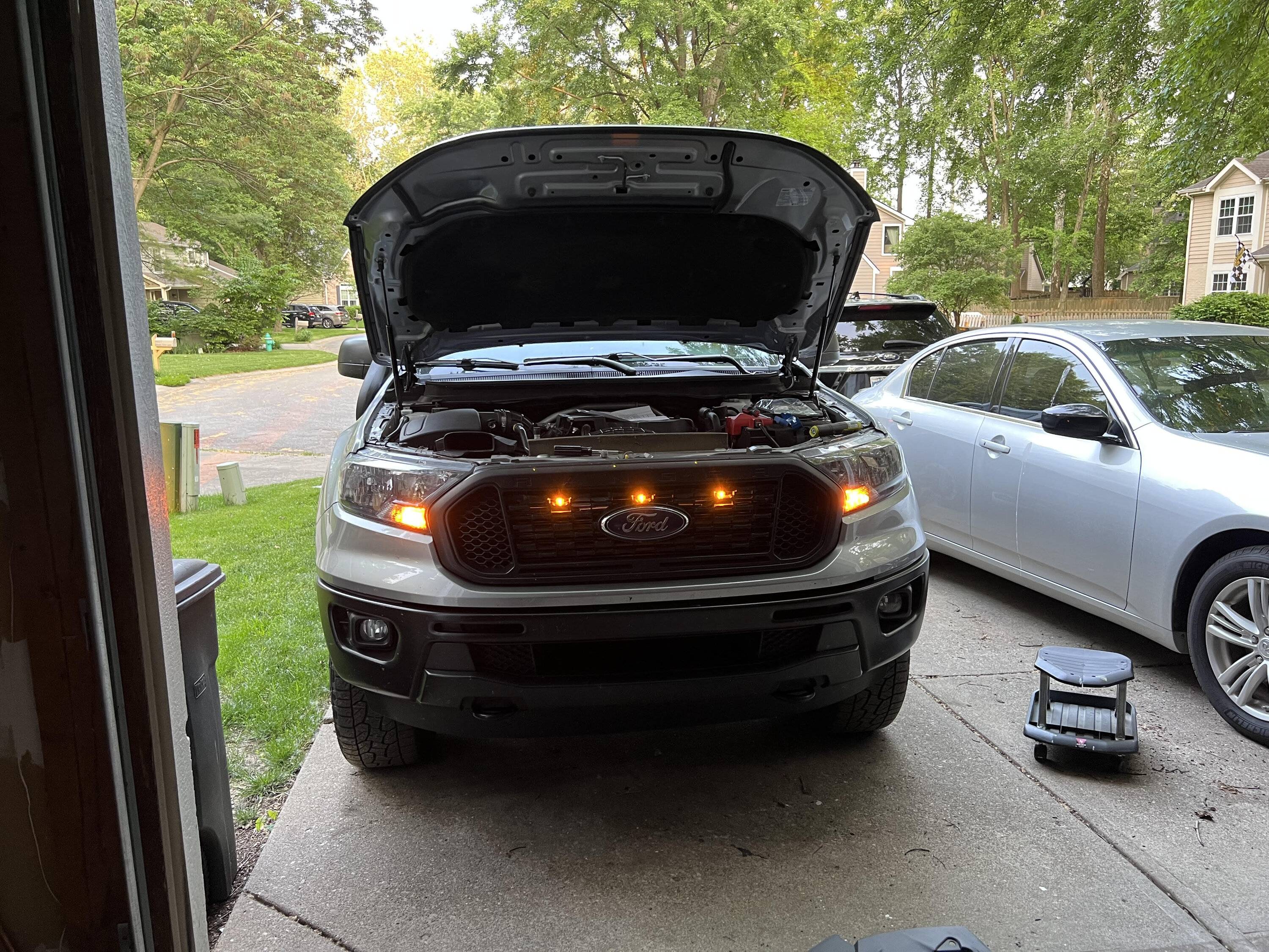

So, I do have the 3 light version from CustomAutoWorks. Just wondering if this scoop fits with the light bar installed and on the XLT grill like mine.
Sorry I didn't know you already had one. lol I don't have the scoop but I would guess it should fit buy looking at this picture. It seems like there's a little room between the scoop and the grille and the light bar isn't all that thick. Hopefully TJ sees this and can confirm for you but he has an XLT so it should seeing as they use the 3 light bar too.

Ah all good. Hopefully someone who has my combo will chime in. Thanks

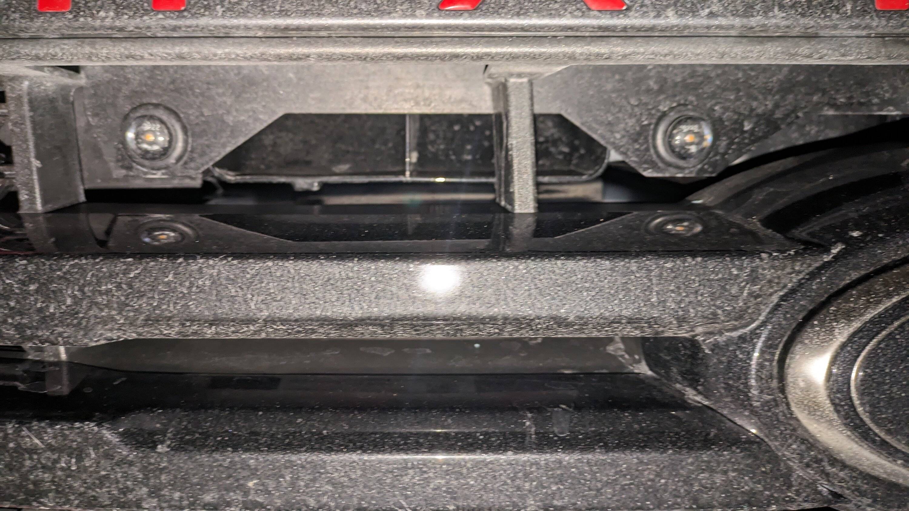

Doesn't fit with the mouth on it, the colored mouth comes off, then it will fit. It's a pain in the ass to install with the 3/4 light grill strip in place.
Get a 3 inch 1/4" drive wobble socket extension and a driver bit for the hex bolts that mount it in place. There are two, one is easy access from above with the hood open and top cover removed, the far passenger side bolt you need to go in through the grill with the extension

If you can post a pic how it looks with the lights. Thanks

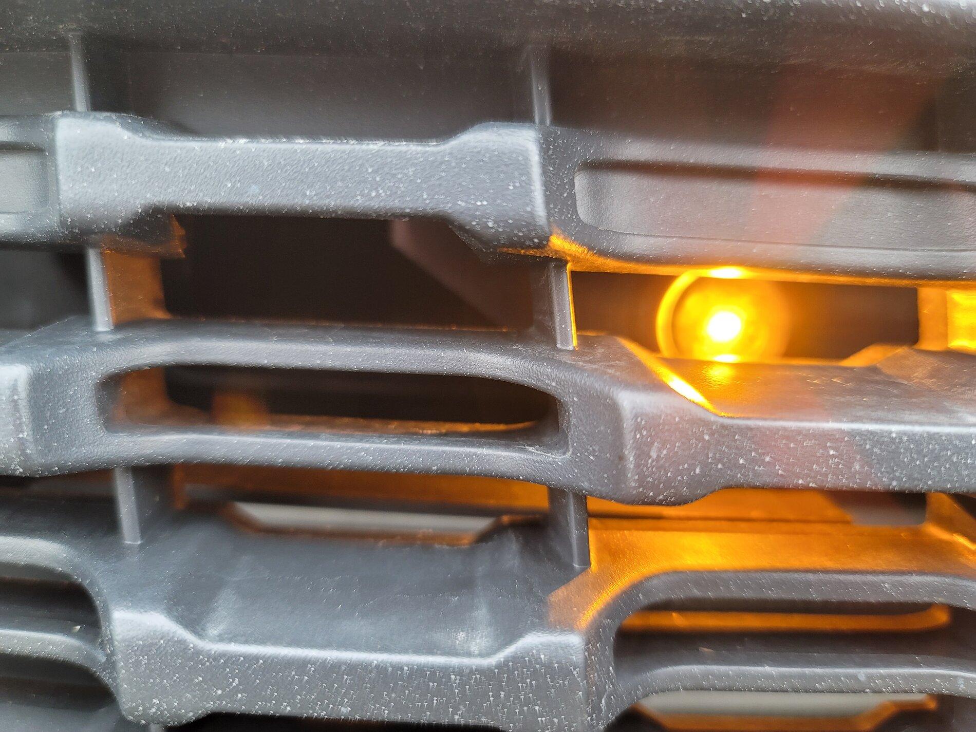

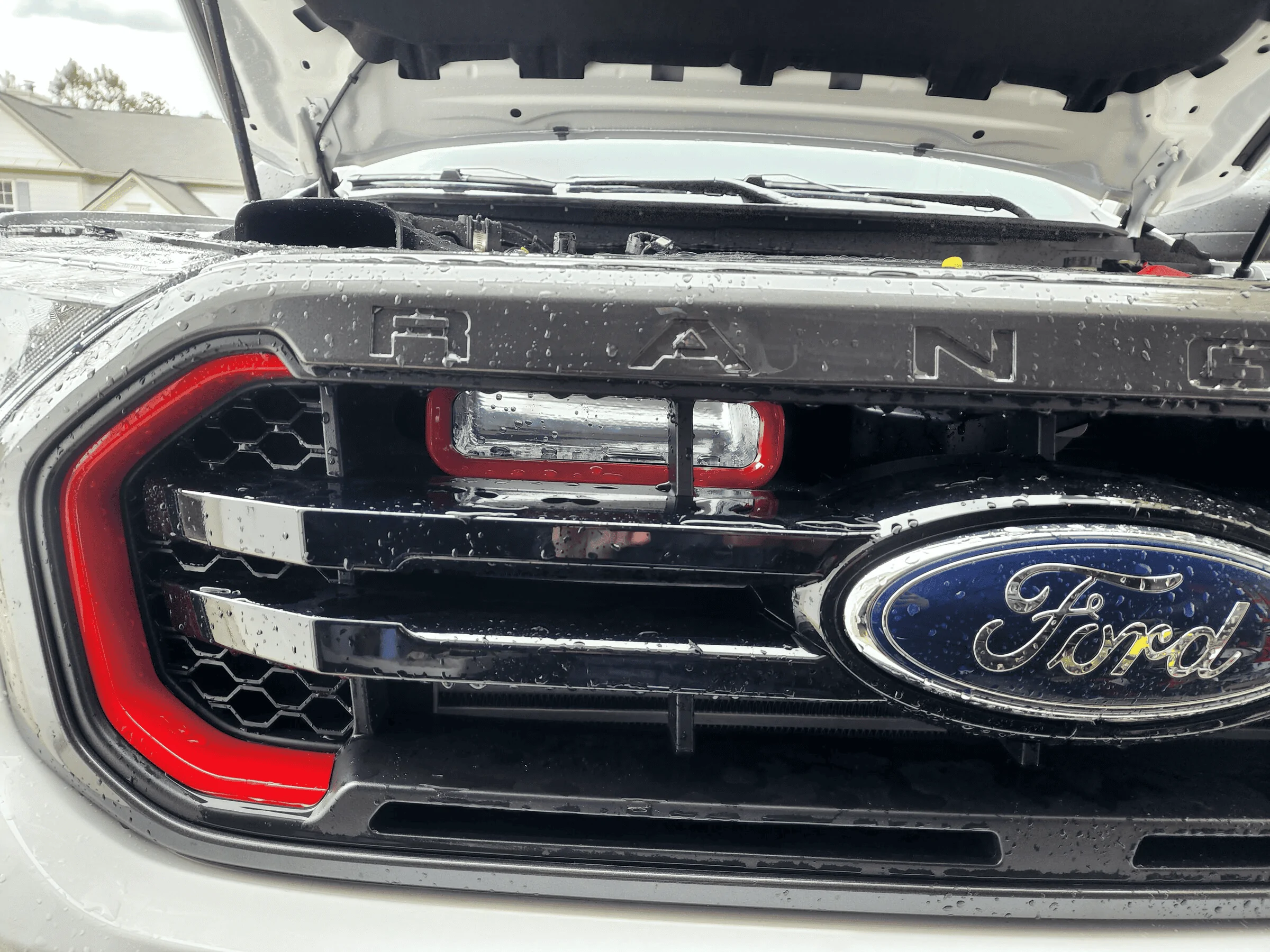

It's basically invisible behind the light bracket, which covers most of it
Better view with the lights off, I'm probably just going to remove this in favor of an open design intake and plan on an intercooler upgrade later this year

Thanks for the picture. Im holding off from putting this for the moment.
