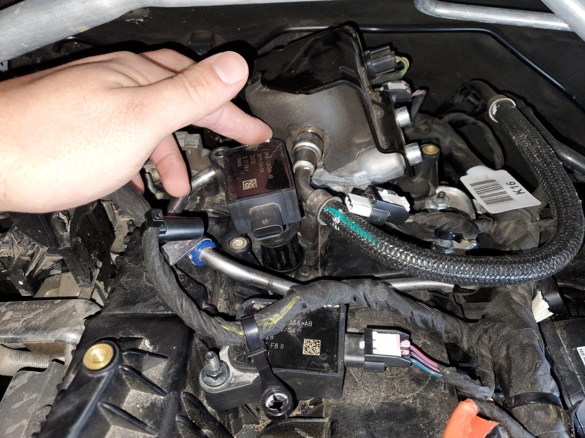

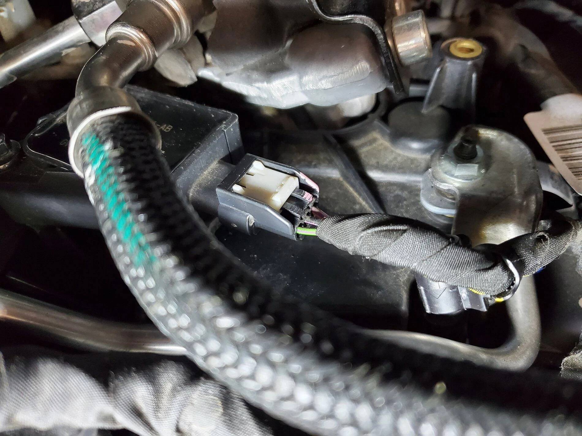

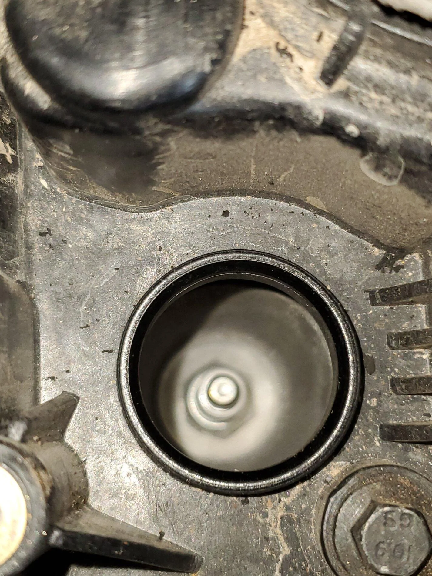

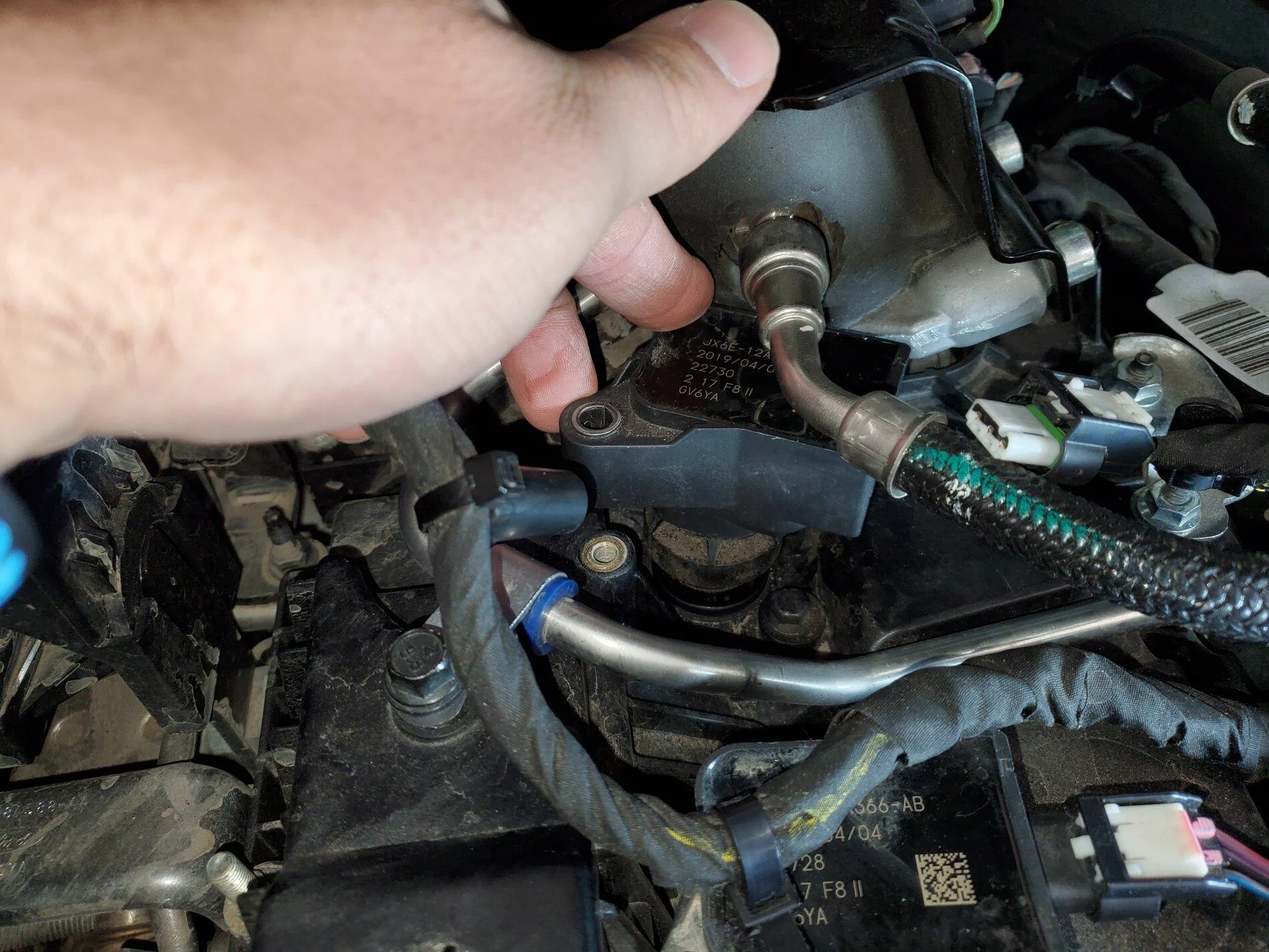

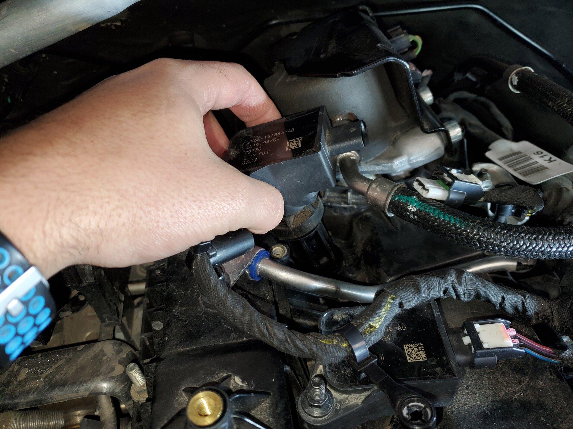

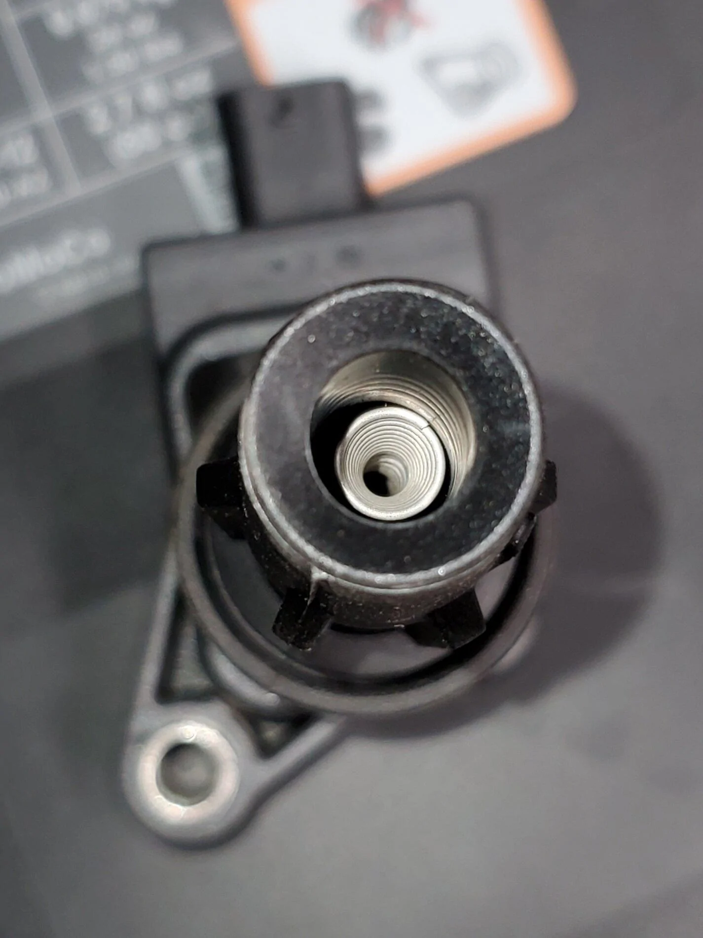

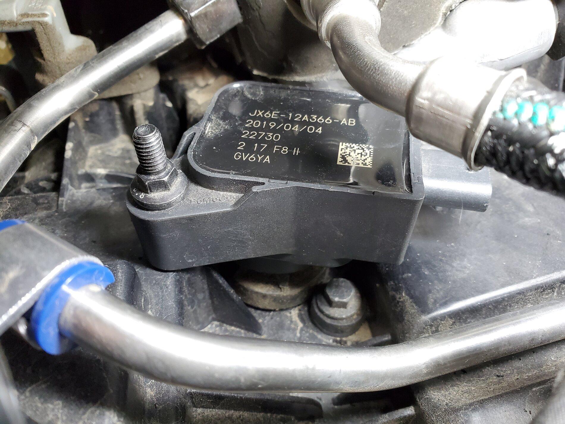

So pics in order,
Plug in, coil pack, fuel pump in the way, twist and go around hard lines, under the hard line, secured as far as I can go and that the but will go. You can feel its on the plug when you pull up it has resistance like its grabbing the plug. Coil plug attached.
That's how I did it too...push in rotate bolt back on...no problems...

nice place for them to put that fuel pump, that could have probably have been designed a bit better.
you said you swapped coils and exchanged the plugs and the problem has stayed on No 4 so sounds like the connector or wiring

Thats what I'm thinking. Because I swapped coils from 4 to 3 and the misfire stayed on 4. Swapped plugs, swapped back to factory plug in known good working condition, still on #4.
Shit. Maybe I'll have ford look at it. I didnt do anything that would void my warranty. Its not tuned, yet. I was going to upload the tune after confirming the plugs were running well.
So wiring or the plug is my bet.

I did put the factory plug back in number 4 only, and still misfiring.
With all the combinations tried to this point it makes the connector or immediate wiring close to it suspect. Seeing that you swapped coils it doesn’t sound like a bent pin in receiver
Also look closely at connector and make sure each crimp is intact and seated all the way in
