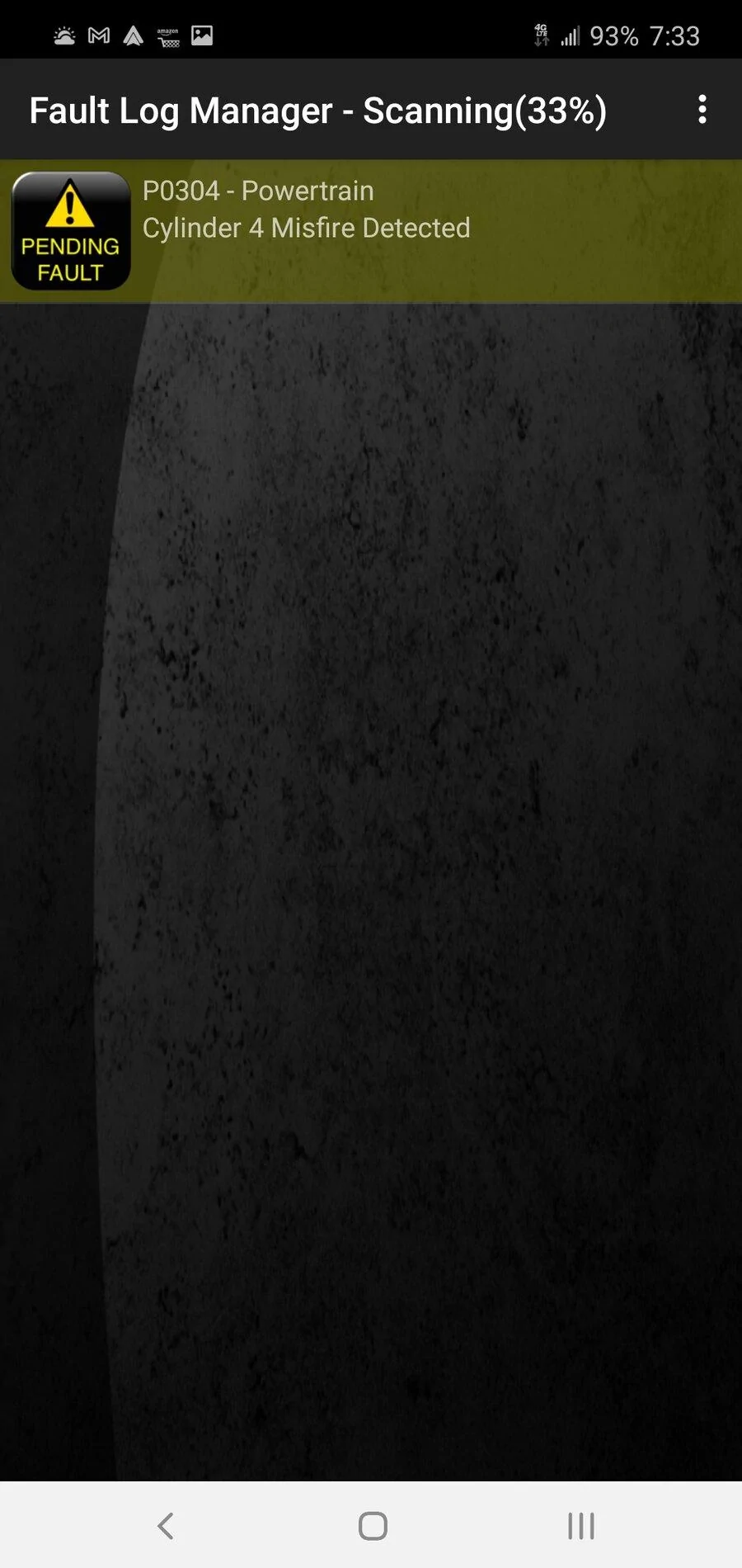

Urgent please. Which cyclinder is number 4 on the ranger?

Professionally speaking at this point when all attempts made here to isolate misfire, this is where scan tool comes into play to check the cylinder imbalances.
This way you can adjust fuel trim in all or individual cylinders to diagnose injector issues. Then pull out the bore scope and compression gauge for mechanical problems.
There's no chance anything dropped down in #4 is there? All nuts/bolts accounted for?
Yes, let the pro's handle it from here. Good luck and keep us posted.

I changed my plugs last night with the NGK Ruthenium's and had no problem what so ever getting around the low pressure fuel line. Rotating the coil there is plenty of room to get it out and remove/install the plug. I also gapped at .028.....
If you have not figured out what's going on yet definitely re-install the old plugs and see if that makes any difference, then start your troubleshooting sequence.
BTW...what plugs are you trying to install? just curious...

I agree on all the above but irs above my knowledge thats for sure. I know nothing fell inside for sure. All parts accounted for. Plugs are not chipped or dropped into the hole. Not cross threaded, etc. So I called the dealership and left a voice mail letting them know ill be having it towed there later.

I bought ruthenium hx like you. Cyl 1, 2, and 3 are running fine. 4 isn't and exhaust smells terrible. But no white smoke, headgasket kinda smell so thats a plus. Maybe a bad injector. Filled up at an oddball gas station a few days ago but have driven on it for a couple days.
Mine are gapped to .0275 very close to yours.
Did you reinstall the old plugs to get back to square 1 and see if it still misfires?
I take it that no misfire was occurring before you installed the new plugs right?
Just trying to get up to speed on the situation.

I’ll echo what others have suggested, which is to let the pros tackle this. There’s only so much people can do over the internet.
For this misfire, are you certain that the #4 plug is seated properly? You torqued them to spec right?
I don't ascribe to this but I do know at least one mechanic that will say once plugs are installed then removed and reinstalled the sealing of the crush washer can be compromised. I've not experienced that when regapping plugs on my Saabs - which I have done multiple times (run copper plus it's a cap discharge ignition that wears em fast) but I do torque em down several lbs tighter when reinstalling. Could be that the initial problem was a coil not fully seated then the removal/reinstall caused a sealing issue ?

yes the factory plug came out nicely, new one hand threaded the whole way until seated and torqued to 12 ft/lbs.

So.... not going to jinx it yet. Came home from work. Started the truck to back it out of the garage, it was misfiring right off the bat.
Went to pull the coil pack off plug 4 and swap it with number 2. (I've only swapped it from 4 to 3) and I'm not even kidding, the rubber boot just felt like it sat down better on top of #4, meanwhile I tried this 6 times or more last night.
Cleared the dtc and restarted the truck. Instantly I could tell its back to normal. No vibration, nothing. Its been idling for 10 minutes now and no misfires.
So my guess was I didn't have it seated right. I was working in a super flipping cold garage. Tired. Had an epidural steroid injection in my back two days ago so I'm all sorts of broken.
So maybe its fixed. Ill take it around the block.

Glad to hear it all worked out. Sorry you had to learn the lesson the hard way. I'll keep it in mind when I decide to do mine. I'm sure it will help others too. :clap: :like:
7,083
37,188
30 minute drive and all is well. Thanks everyone for helping and the reassurance, the shop manual info, etc. I appreciate it.
