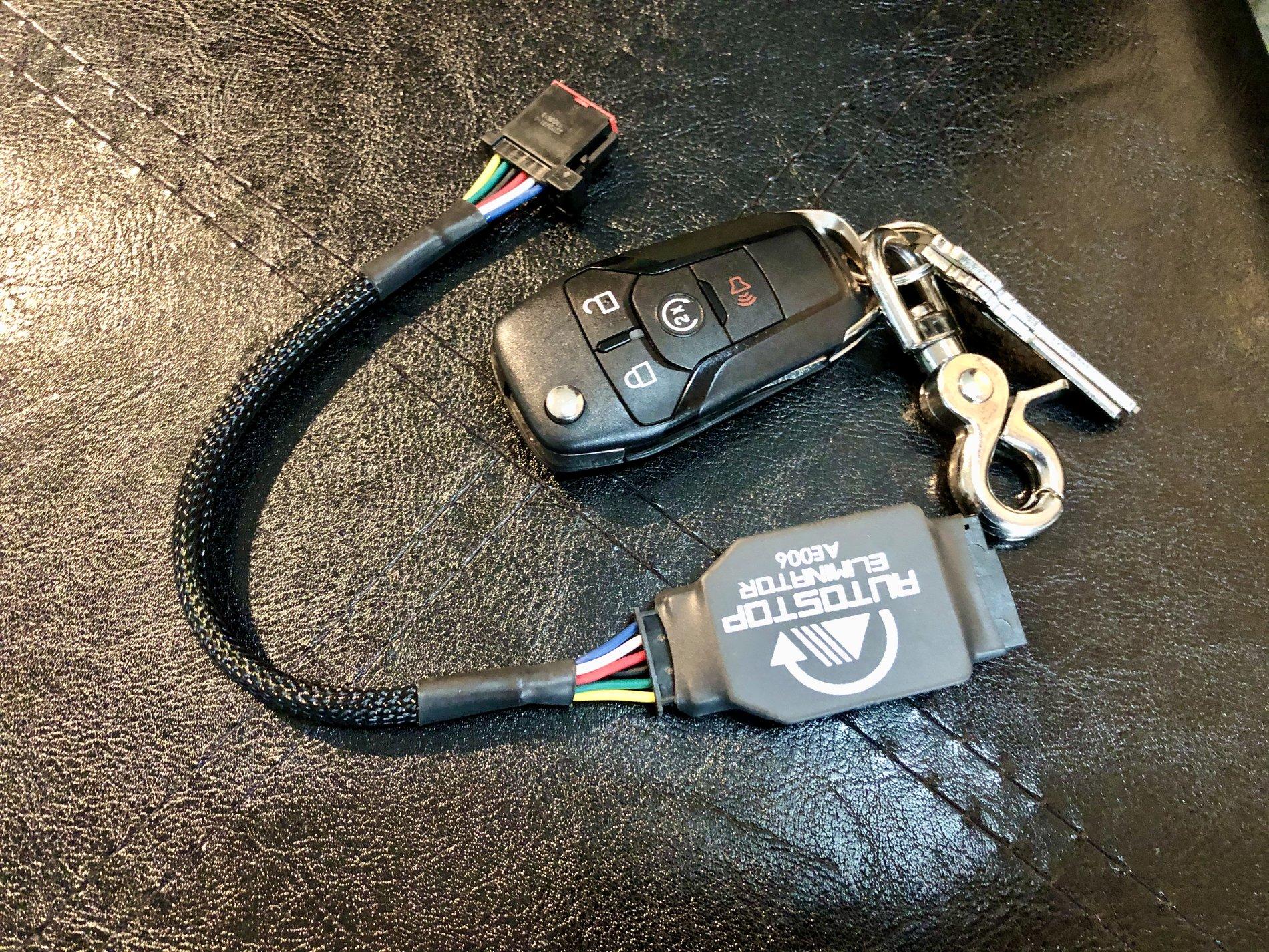

Allows you to keep it active when you want, off when you want. 1 press before you shut truck off. Done.

I assume there is a connector to the console switch. I don’t have a wiring schematic of the switch, but, if 2 wire terminal ends could be swapped in the connector, would that connect power when ever the ignition is On, thus always having the switch Off all the time, and if you wanted it On, then you could flip switch on console, thus turning On the auto/stop feature.??
I assume that is what the auto stop eliminator does?

Auto stop remembers which position switch was in last time truck was turned off. The on restart it keeps the same setting. Forscan would be a good option if you plan to never change much. But auto stop plug in would be a faster easy option.

I know it's an expensive alternative, but I bought the 4D Tech eliminator (Version I). You're paying for the convenience and safety of a quick standalone flasher, that doesn't require any tools.
START / STOP ELIMINATOR (RANGER)
Just seemed easier than pulling the dash apart to keep the button operational. The process takes 10 seconds and you just toss the CANOpener in the console. If I ever wanna flip the programming back to operational I can. Even on the road. No computer. No nonsense.
I probably would have tried FORScan, but I'm still a bit of a chicken in the as-builts.
They make a different version (Version II) which you plug in-line with the ODB port. I already have the remote start back there... I thought it cleaner to just program it off. Truck says "Auto Start/Stop disabled due to Vehicle Charging" in the cluster when stopped.
