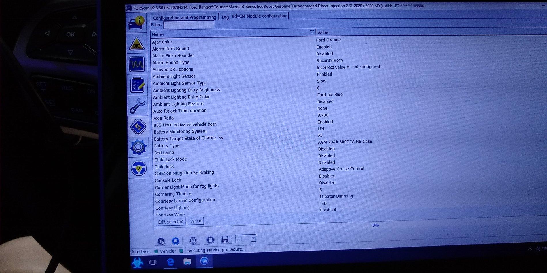

I don't get the codes -- I get the spelled out names .. Like this:
And I've looked in all the modules except the ones marked "as built" (which I have been told to stay away from)...

The “bdyCM as built” section is where the code is to turn off auto start/stop. You’ll have to edit it for it to work.

I mentioned leave that alone if you're not sure what you're doing. In the original forscan thread where we listed changes by as built you can look up how to change it through theas built.

Then you will either have to buy the $80 auto start/stop eliminator, or plug something into the 110 outlet in the rear console.
Or just edit the code as explained in the Forscan wiki.

If you look at what you need to c change in as built you can try it under that tab. You just find the line of code listed and change the single digit.
