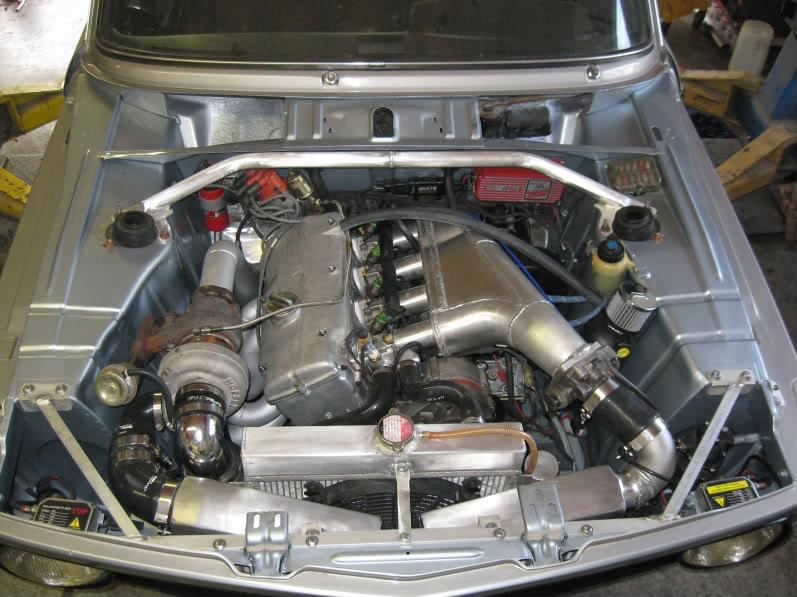

We've had a few turbo cars ( I've even built one from scratch, pic related ). My wife has a stick shift VW Tiguan and the only time you notice lag is when you are in the wrong gear. Put the Ranger in sport mode and have it in the right gear and she moves just fine and promptly.
