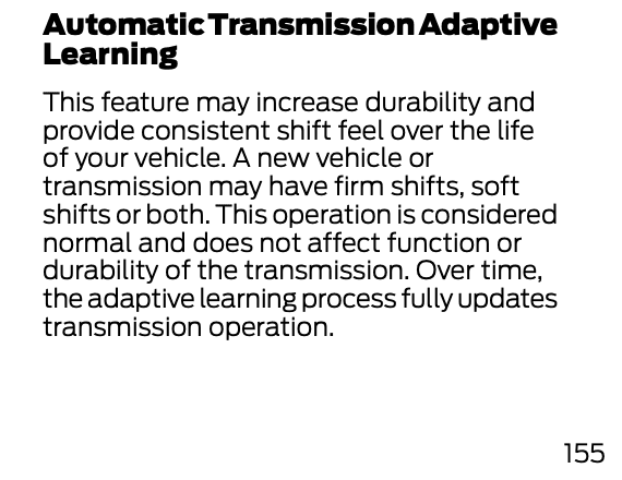

This is right from the owner's manual, page 155. I remember also reading that the adaptation process does not have anything to do with how you drive, but how the mechanicals of the transmission are operating, and change over time.
