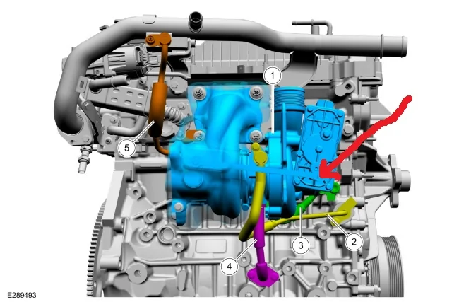

It's the turbo charger wastegate valve cycling. It is a normal condition. You should see the lever move when you hear the sound.

While I concur- it’s the wastegate actuator cycling - it’s abnormal to cycle like this @ idle, try turning off AC and see if it continues plus verify visually it is the actuator- as viewed from RT Front (Wheel House)
I know mine does not cycle like yours does and I think the actuator is hunting for commanded position.

Mine cycles 2 times during the high idle period when the engine is cold. It makes the same noise as in the video. After the idle slows to normal idle, it doesn't do it anymore.
