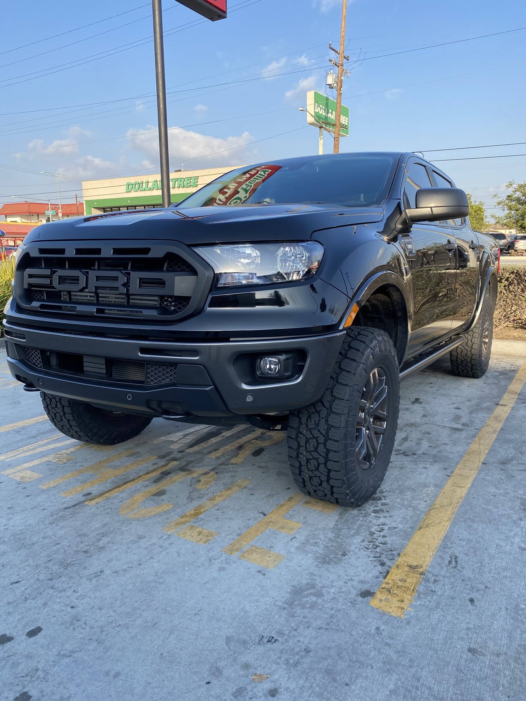

I just installed a 2 inch level kit on my Tremor and upgraded my stock tires to some 285/70/R17 Toyos. Does anyone know if I also needed spacers?? I only cut some of the Crash arms for clearance so far..

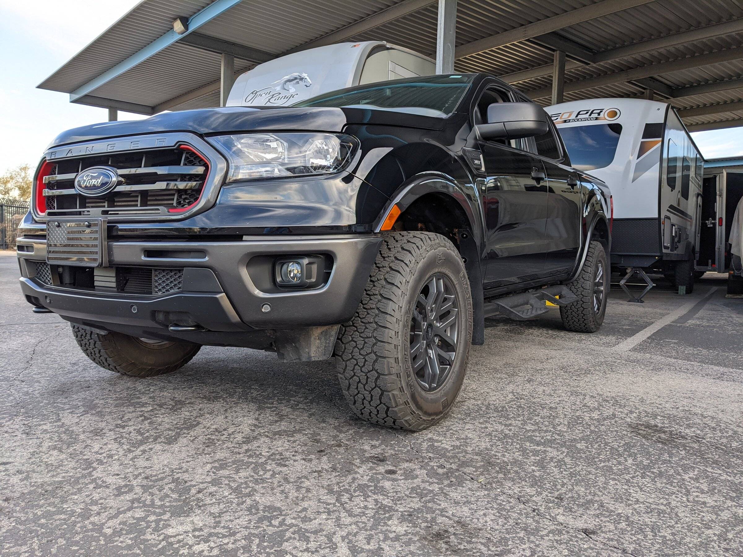

Here’s a before and after.
also decided to remove the step bars and see how I feel about it :)
I tried removing the side steps but leaving the bar like your picture but my wife and young boys were having a hard time with it, I am not even lifted at all outside the Tremor stance ?
That said, looks good. Those toyo have grown on me a lot. Do you have an angled shot? Something like this angle? BTW, I have a 1" wheel spacer on stock tires and stance in case it helps you picture the spacer a bit.

I was in the same boat as you lol took some convincing but I got them off. and they approve haha my daughter likes having to hop to get on. And I can honestly say it looks a bit more aggressive without the steps. Here’s somewhat an angles shot so you can see better ??

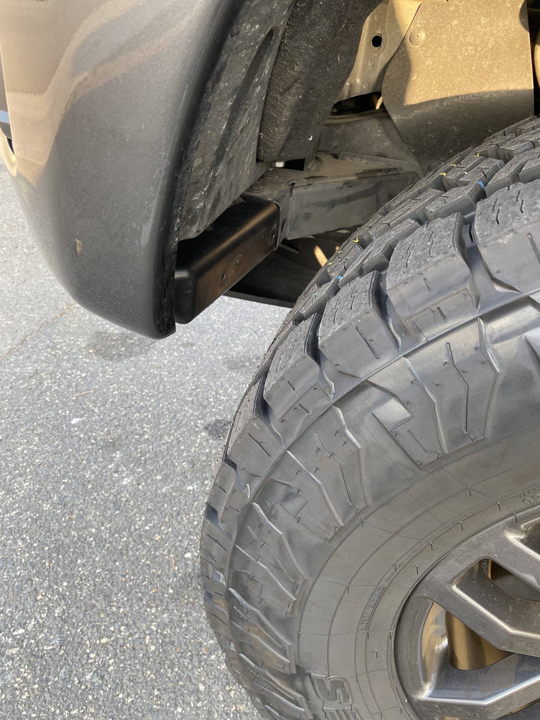

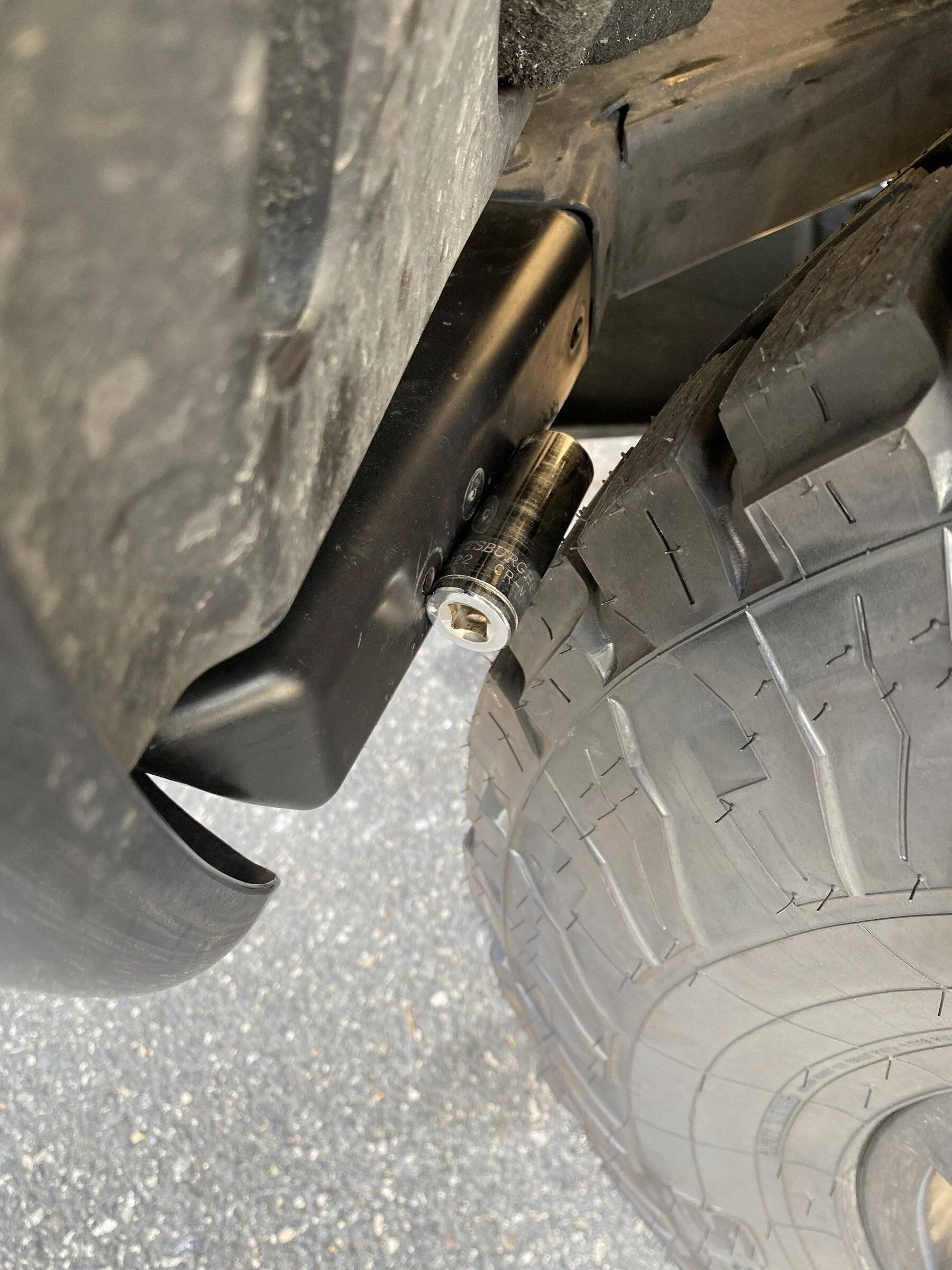

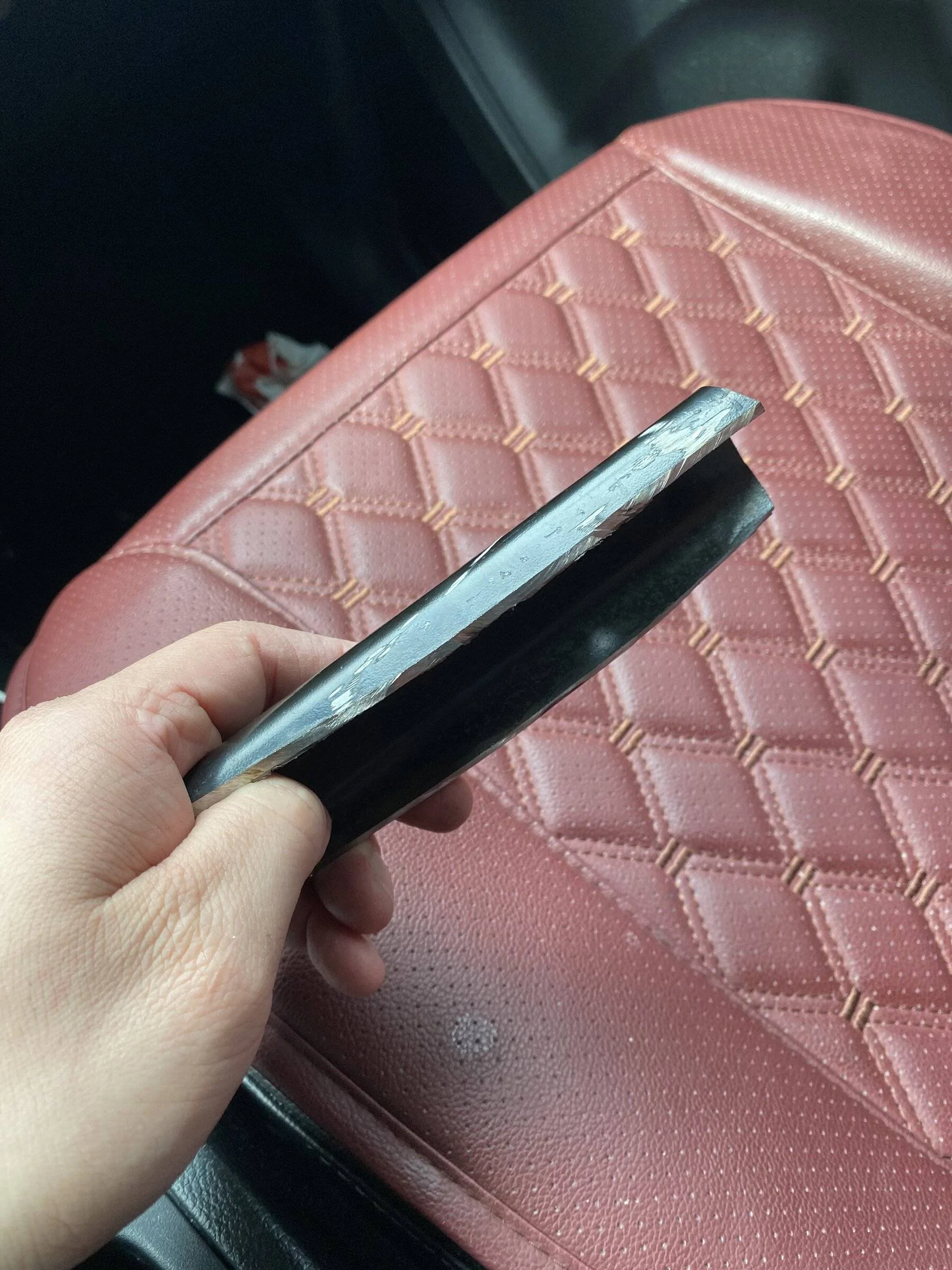

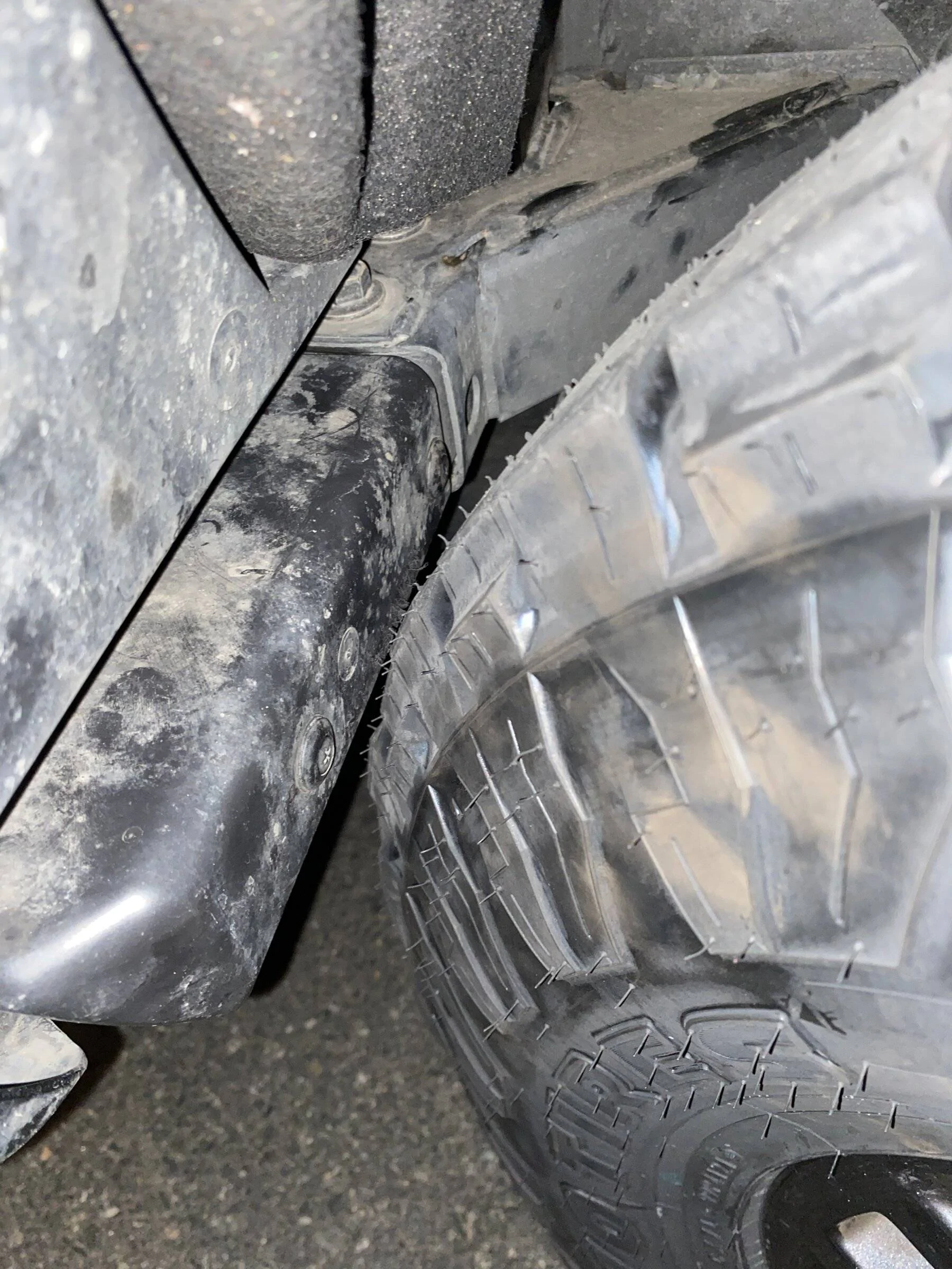

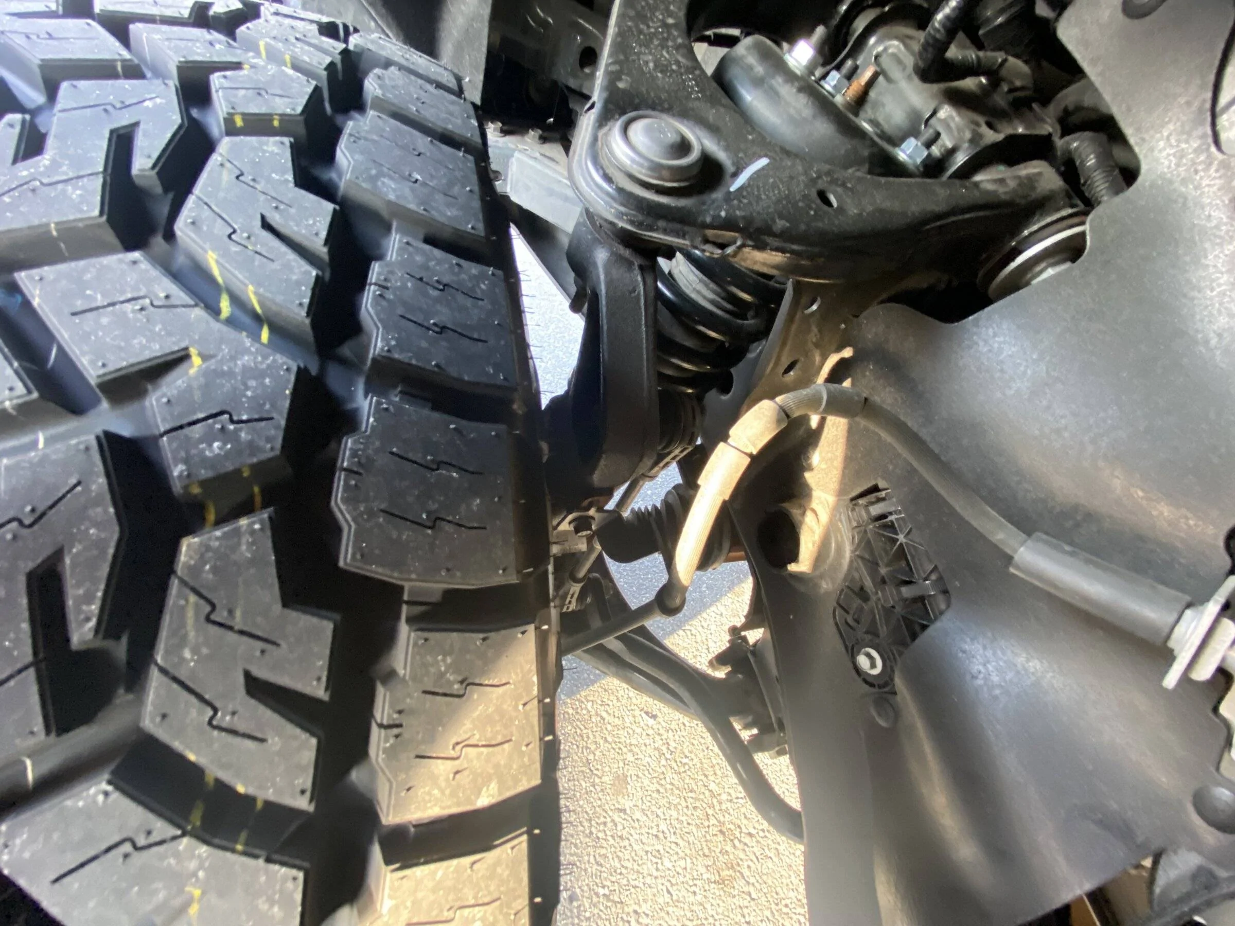

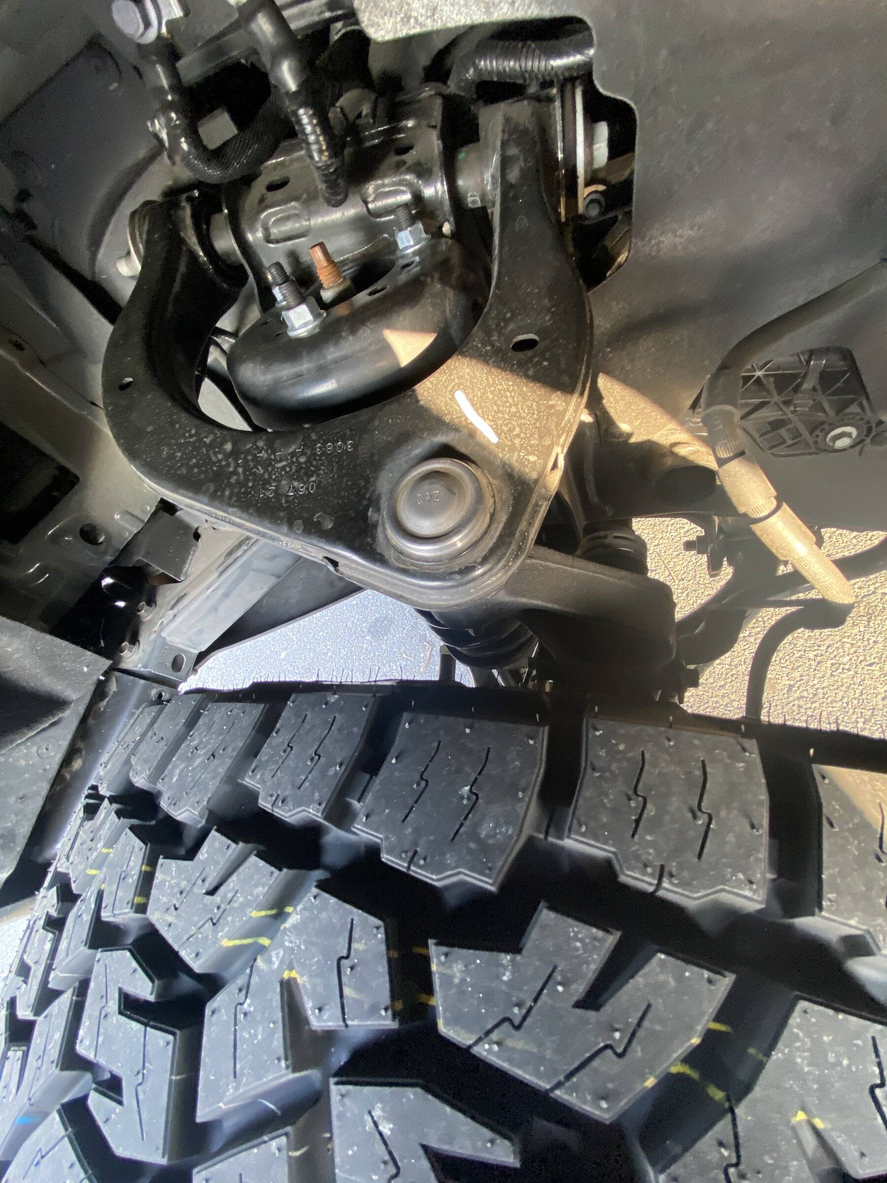

Here is a picture of how it sat with new tires before modifying the crash bar and after. Also a piece of the crash bar that was Grinded off. Also took pictures how it sits by the Knuckle. This is only with a 2 Inch level kit.
It’s kinda hard to tell what you did to the crash bar. But it looks like everything is good from a wheel offset perspective
Basically just trimmed it with a grinder so it’s thinner by the wheel. Also ended up putting the plastic cover of the crash arm back on so it wouldn’t look like I cut it lol but I will get a better picture for you without the plastic cover tomorrow when I’m able use my tools to remove the cover ?? Hope this helps some..
