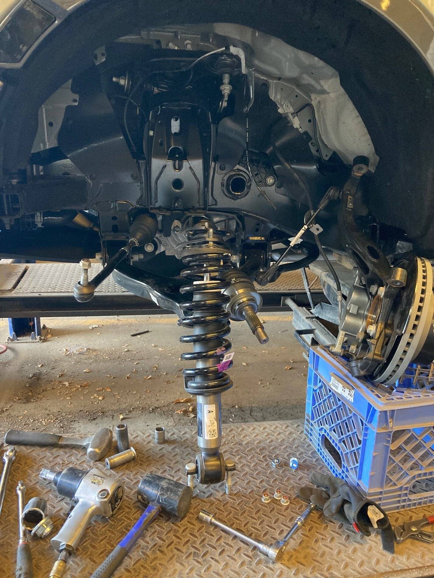

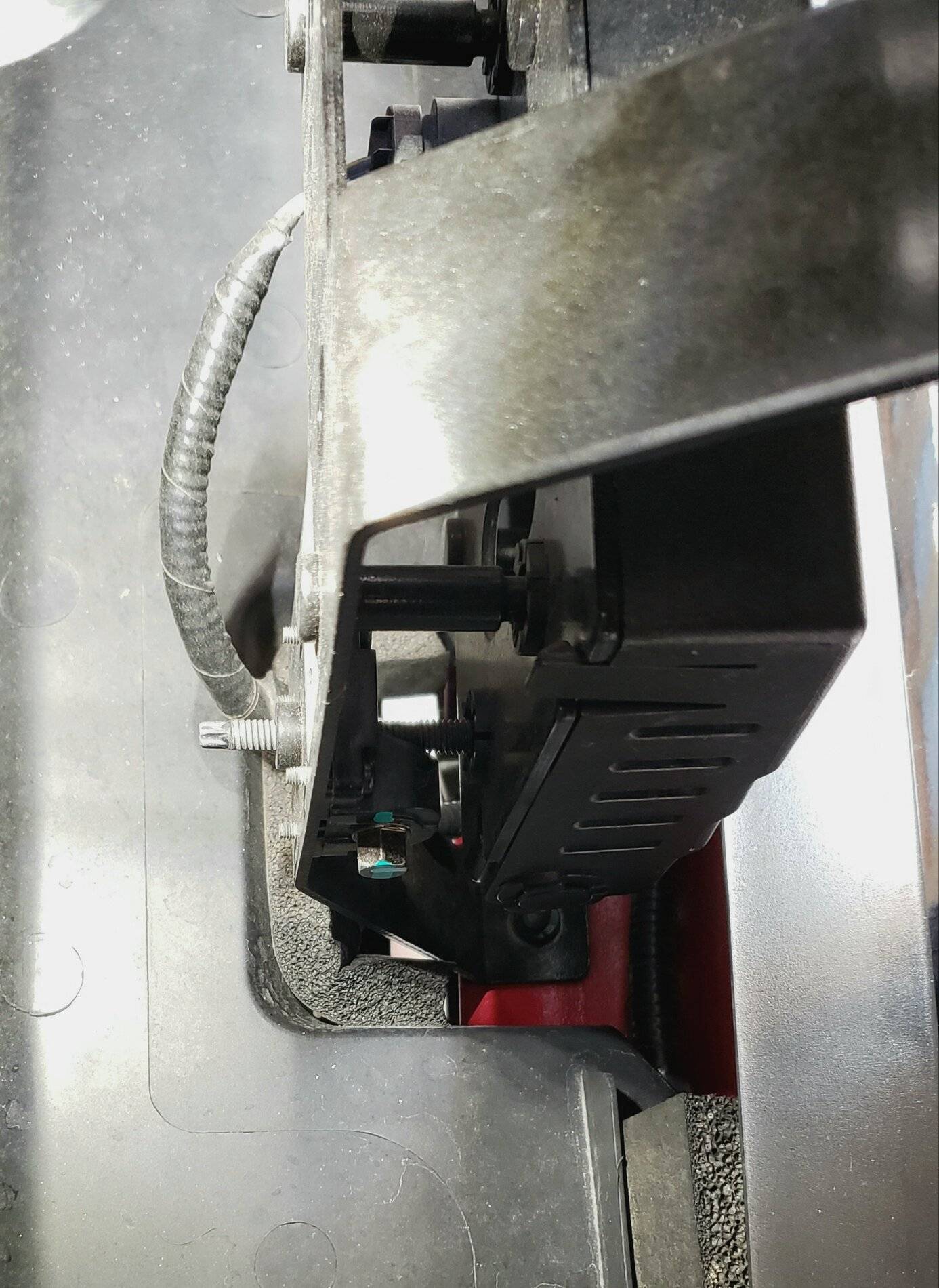

Neither one of these mods were "easy". The silly Ford "intrusion bars" had to come completely out - why these are on the Rangers and not the Raptors I haven't figured out.
Cutting them out wasn't fun - but with a combo of a sawzall and 6" grinder, I got them off in a couple of hours. Should be plenty of room now for bigger tires once I wear the stockers out.
The 2" level kit I got from Ranger Lift Kits - but I can tell you his "how too" video didn't help much. I basically had to pull the entire front end apart (see pic) to get them out / in. Which if I would have planned on that going in, would have been a little easier - the first side took me 2 and a half hours - but once I had it all figured out, the second side took about an hour. Luckily I have a buddy with a lift and a 6' long pry bar - which was still needed with everything taken apart.
The other pain, is that no one wants to do the alignment, due to the lane assist / adaptive cruise control on the Tremor - apparently, after an alignment, they should recalibrate those sensors / settings. Went to 3 shops, and none of them would touch it. All of them said "take it to Ford". My friendly Ford dealership is over a month out for an alignment. I found an independent shop that can do it, so I'll be getting that done in the next couple of days hopefully.
Overall really happy with the trucks stance / look now. But man, never put spacers on a vehicle (and I do it to anything I've driven in the last decade) and had to do a bunch of cutting / cussing to make it work.

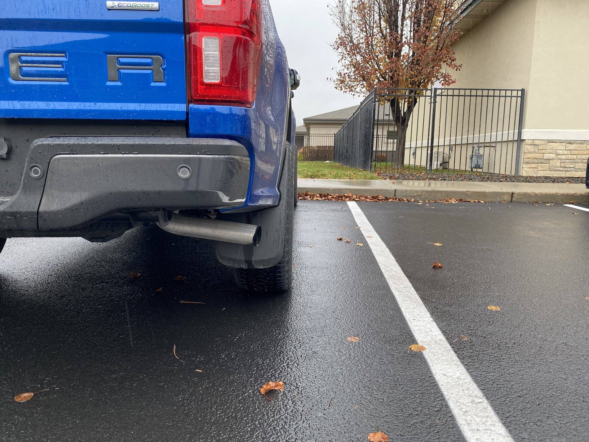

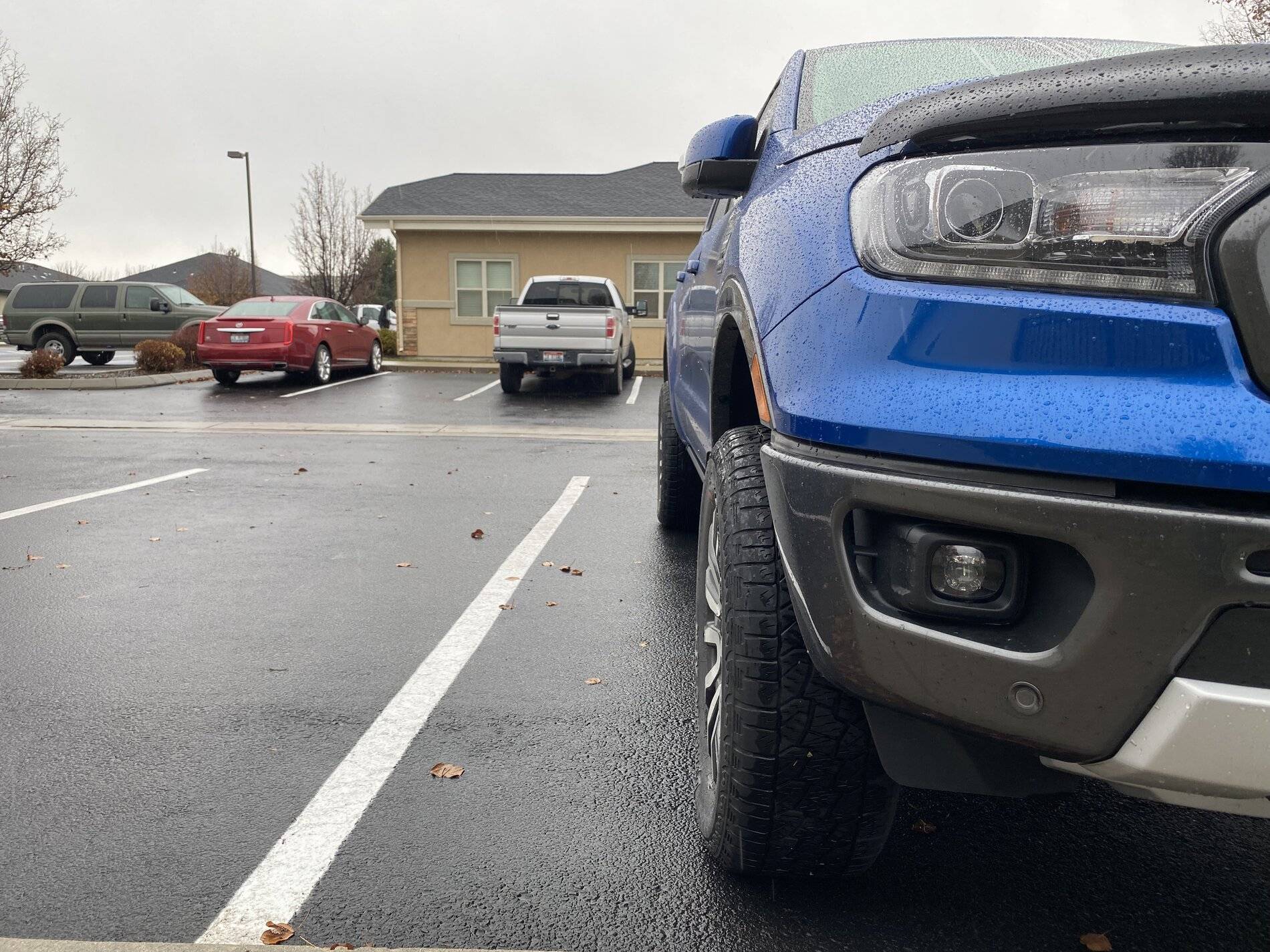

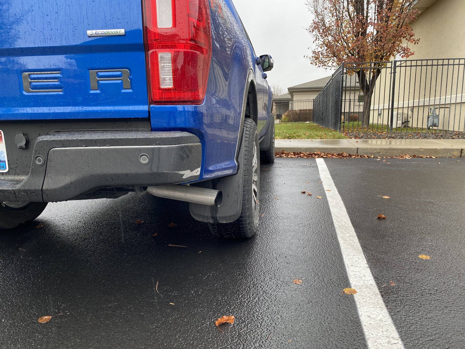

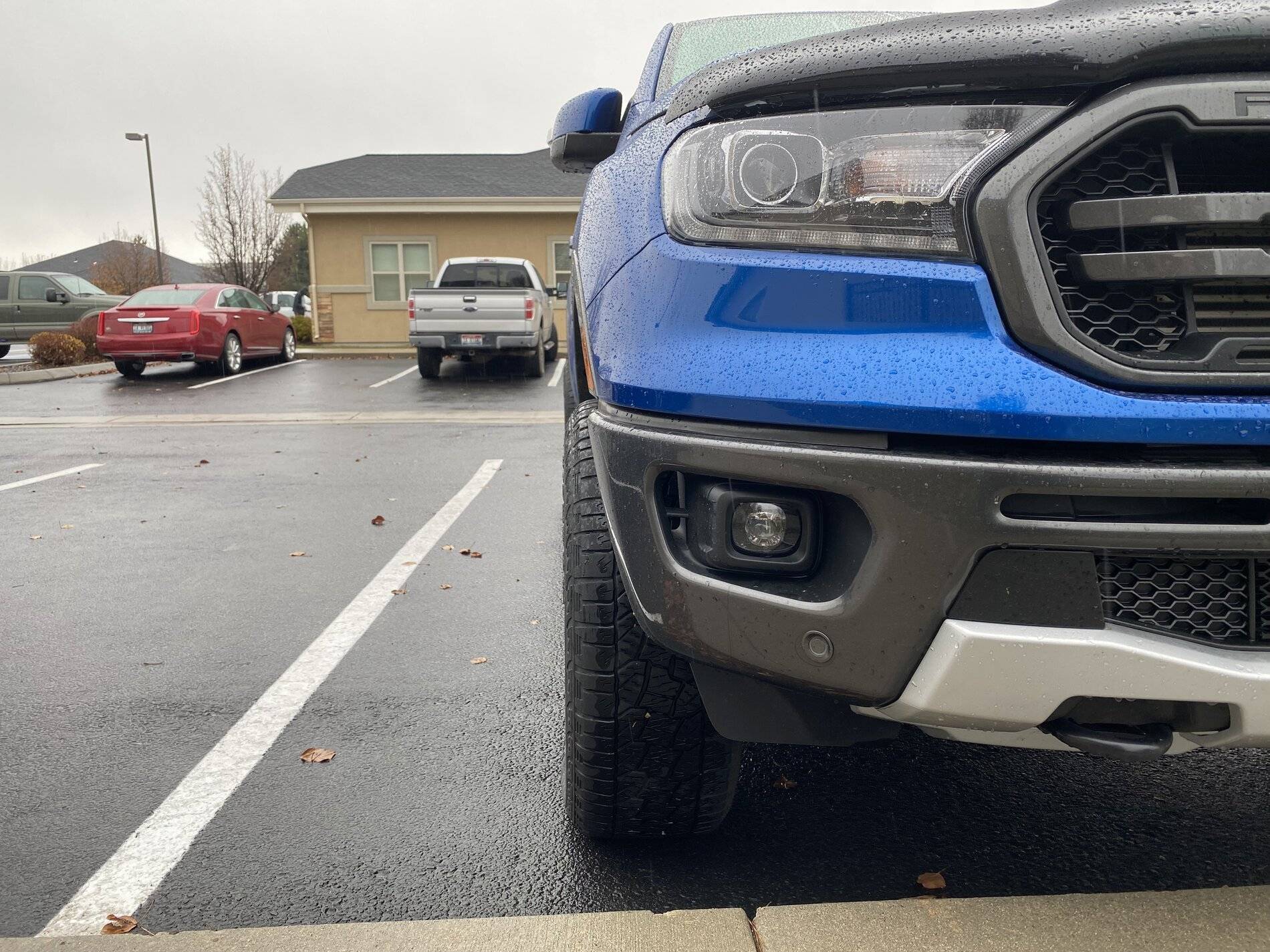

Someone above asked for a side view of a truck with spacers. I have 1.25" Bora spacers installed, with factory tires and wheels. Here are a few pictures and short videos that show the stance, from front and rear.
And no problems? I am debating spacers as I got some fender flares to put on and a friend said I would be highly judged if my fender flares stuck out inches further than my tires. But I don't currently have the money for all new tires and rims as well. Appreciate your post.

I had no issues at all while I had the spacers installed. When I got new tires a few years ago, I went with both a taller and a wider tire, and with the spacers they stuck out way too far, so I removed them. They were great with the factory setup.
