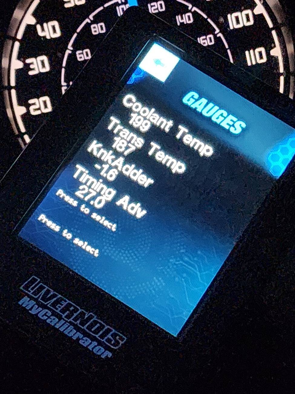

If you were good before and nothing has changed, I would enjoy your trip and not be concerned about it.
I found that the fluid level is sensitive to temperature, how it's been driven prior to checking and especially if it's on flat ground when checking.
I also found that if you put it up on a hoist to check the fluid, you need to rack it like it sits on the ground, if you just rack it on the flat of the frame, the front end goes up in the air first and the fluid will be a little low compared to how it sits on the ground.
But really, everything affects the fluid level, just ride the height alone, heavy loads in the bed, towing loads, no loads, lift kits, leveling kits and lowering kits, there are many things, that's why it's a range.
To me, the important thing is, you just want to make sure it's not too low, that's when shifting is affected.
