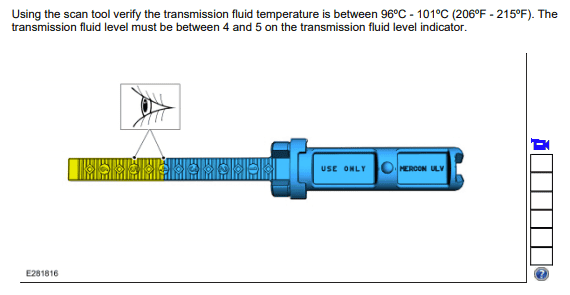

My son and I just changed all the fluids, my son is an A-Tech for GM. The transmission was definitely about 1.5 quarts low from the factory. Drained 5 (slightly more) put 6.5 back in to get it to between 4-5 on the dipstick….the dipstick that apparently a dipstick designed! Lol.

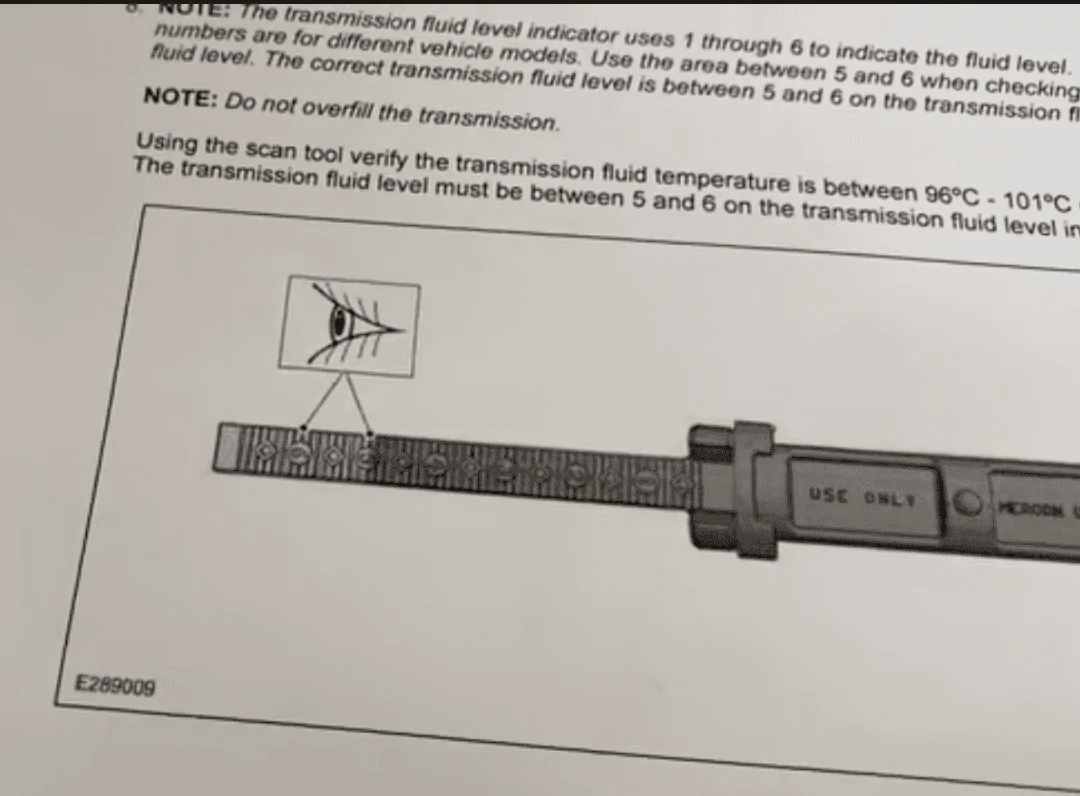

My understanding was that between 5-6 was full hot. 4-5 would technically be overfilled if I read it correctly. Sorry for the bad screen capture below as I captured in it from a YouTube video from a ford tech.
We checked it while hot with a scan tool hooked up to it to monitor correct trans temp for accurate measurement.
Interesting indeed. The screen grab I had was from a ford service manual supposedly. Now I wonder which is correct. Appreciate the screen capture!
