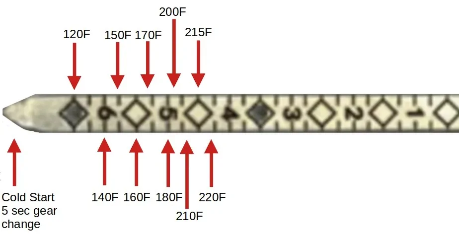

Before filling CHECKING make absolutely sure your transmission fluid is hot, between 206F - 215F. You won't get it there by simply driving your truck until it is hot. You'll usually be at 195F - 200F and that 15F makes all the difference in the world. ULV has a dramatic expansion rate. It is very easy to overfill the transmission....
And you won't know it until you do hit the higher temps, when the fluid foams up and pukes out the transmission vent. Foaming fluid is not good for an already fragile transmission.
I started my truck and let it idle, tracking fluid temps vs time using a time piece and a ScanGauge III, which reads off the transmission's internal sensor. It took almost 39 minutes to reach 180F. I also tracked my fluid temps while driving a 40 mile round (shopping) trip, I stopped for 30 minutes at the 20 mile mark, then drove the last 20 home. When I pulled into the driveway my fluid temps were just reaching 175F. This was sustained speeds up to 55mph from most of the trip - 2 lane state highway with 4 of 5 stops / stop lights each way, but largely rural highway.
These are my results calibrated on the FitzStick (MBS Dipstick). These are definable/repeatable measurements taken on a 75F day (Truck sat 10 hours overnight, initial fluid temp (key on engine off) started at 77.9F.
The first measurement was taken after starting the truck, immediately shifting through the transmission from park to drive and back to park, then immediately taking the first measurement. The fluid just touches the tip of the dipstick...no more than 1/8". It didn't make it to the bend.
The Fitzstick makes this check very simple, accurate, and quick. The ScanGauge insure you know the exact temperature of the fluid.
Forscan may work as well. Disclaimer: I haven't tried to do this with Forscan, but I suspect you can see the temps using it.

I wanted a definable repeatable easy to use process to check the fluid level. Best to check on cold (overnight) startup, run through the gears to insure fluid is in all passages.
So start the truck on level ground, immediately run through the gears at 5 second intervals, then back to park at 5 second intervals, then hop out and check the fluid. Should be just on the tip of the dip stick up 1/8".
This equates to being on the middle of the diamond between 4 and 5 at 215F and all the other readings on the dipstick at their respective temperatures. It is dead center in the normal range at the high end of the temp window. This was intentional on my part.
I had real time monitoring using a ScanGauge III hooked up via the OBDII port reporting the transmission fluid temps.
For the lower temps I started from a bone cold truck that sat two days before I fired it up. I timed the temps at 10 degree increments and measured the fluid levels to achieve the dipstick settings you see on the image that I provided. This on done on a 75F ambient air temp day, with fluid temp at 77.9F key on engine off, then the clock started when the engine started and timing and measurements began up to to 190F.
2 days before the lower range temps were measured I has set the high range by power braking the truck to increase the fluid temps to 220F, and insured the fluid level was midway between 4 and 5 at 215F. I then monitored the fluid level as the temps slowly dropped to 195F.
I did not move the truck during the entire testing period.
