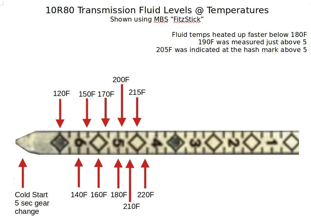

Looking forward to that update post! A little catch up here......I dont post much, just a Sleazy watcher LoL. I also just installed my MBS dipstick on my 2020 Lariat with 43k. (bought used 2 years ago with 40k ) Love My Ranger!
First....totally second all props to mike and his amazing dipstick kit! From fit and finish to price you cant do better! if any part of the install was tough it was from fords end.
Second my transmission has been amazing and yes it doesnt get used hard at all. But im in the minority that likes this tranny as mine is acting for now just as it should. I did add the FP tune and I feel the tune and Tranny relearn made it even better!
Now after a few checks I too am sitting right at the 6 plus line. about the 150 to 160 degree area. I am not sure exactly what to do. Ive read before other being right there and maybe this is a full boat at full operating temp and adding anything would be a mistake.
Everthing shifts so good I dont want to mess with it but I feel Like adding a half quart might be good.
Let us know what happens.
You are right where you need to be...
I appreciate that TJC but I was using the temp thing to show where I am on the stick. I'm not sure what the trans temp is. The trucks up to operating temp so I would think I'm low. Maybe not though.

It is really hard to get the trans up past 170 or so without driving it for a long time or winding it up or something. I'll bet you are probably OK, but buying a cheap bluetooth OBD2 dongle and installing TorquePro would be a good idea to know what the trans temp is to be sure.
It is going to be below the engine coolant temp for quite a while. Eventually it will rise to 195F-200F but it takes time. Use the cold start measurement to quickly tell if you are in the ball park. Quick, easy, and accurate.

After realizing that I made a short trip 10 min to get engine up to temp, id put money on the fact the trans was at low tempo when I checked it. So like you said I bet its in a good range.
