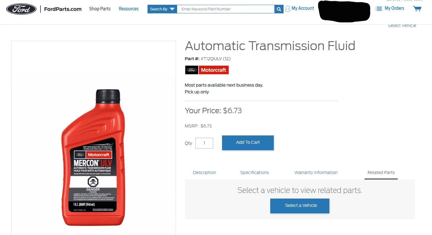

I think I paid all of $7 for a quart of Motorcraft Mercon ULV at my dealer.

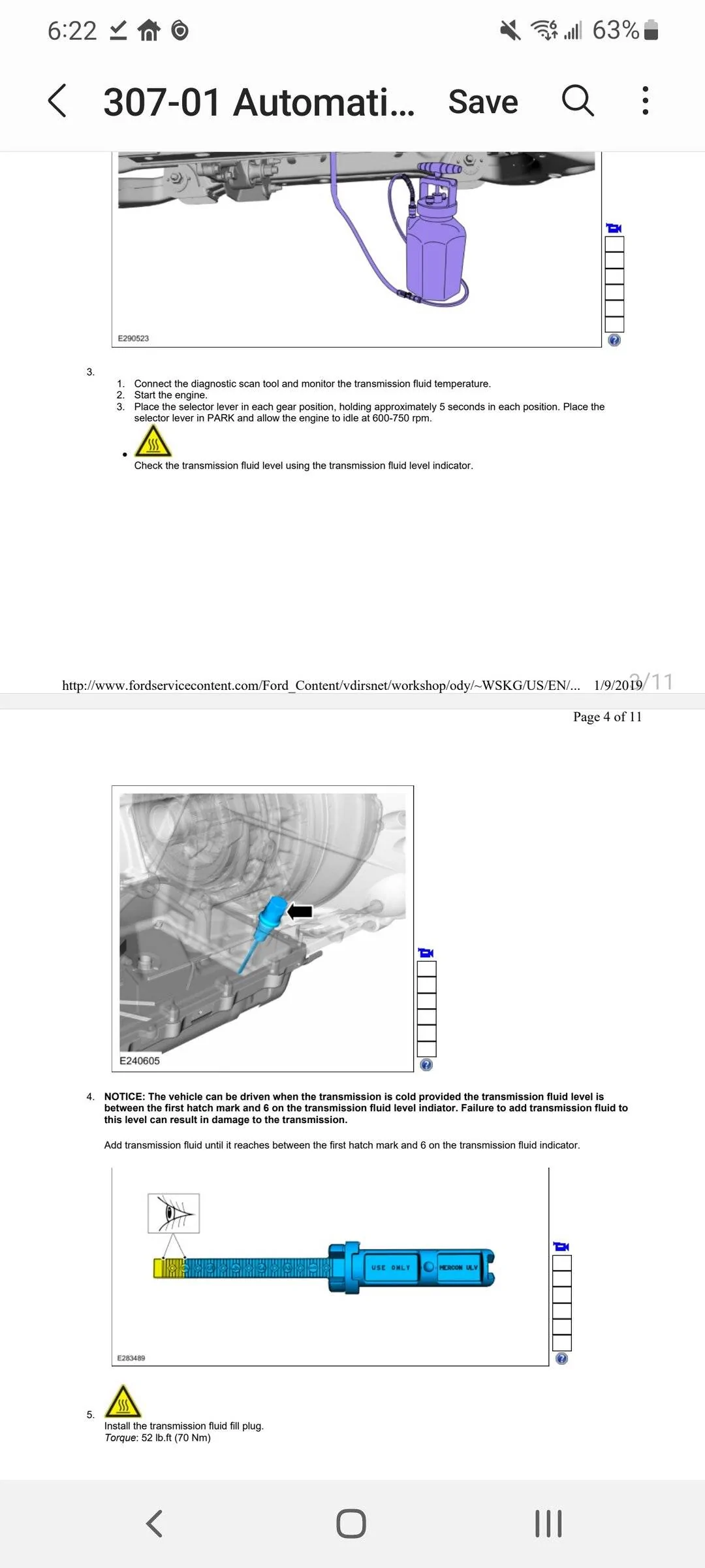

Doing some further reading on the fluid check procedure, it seems like the service manual indicates the fluid would at least be on the dipstick when cold. If that's the case, then I'm definitely low. I had planned to top it off myself, but now I'm wondering if it's better to take it to the dealer just so it's on record.
